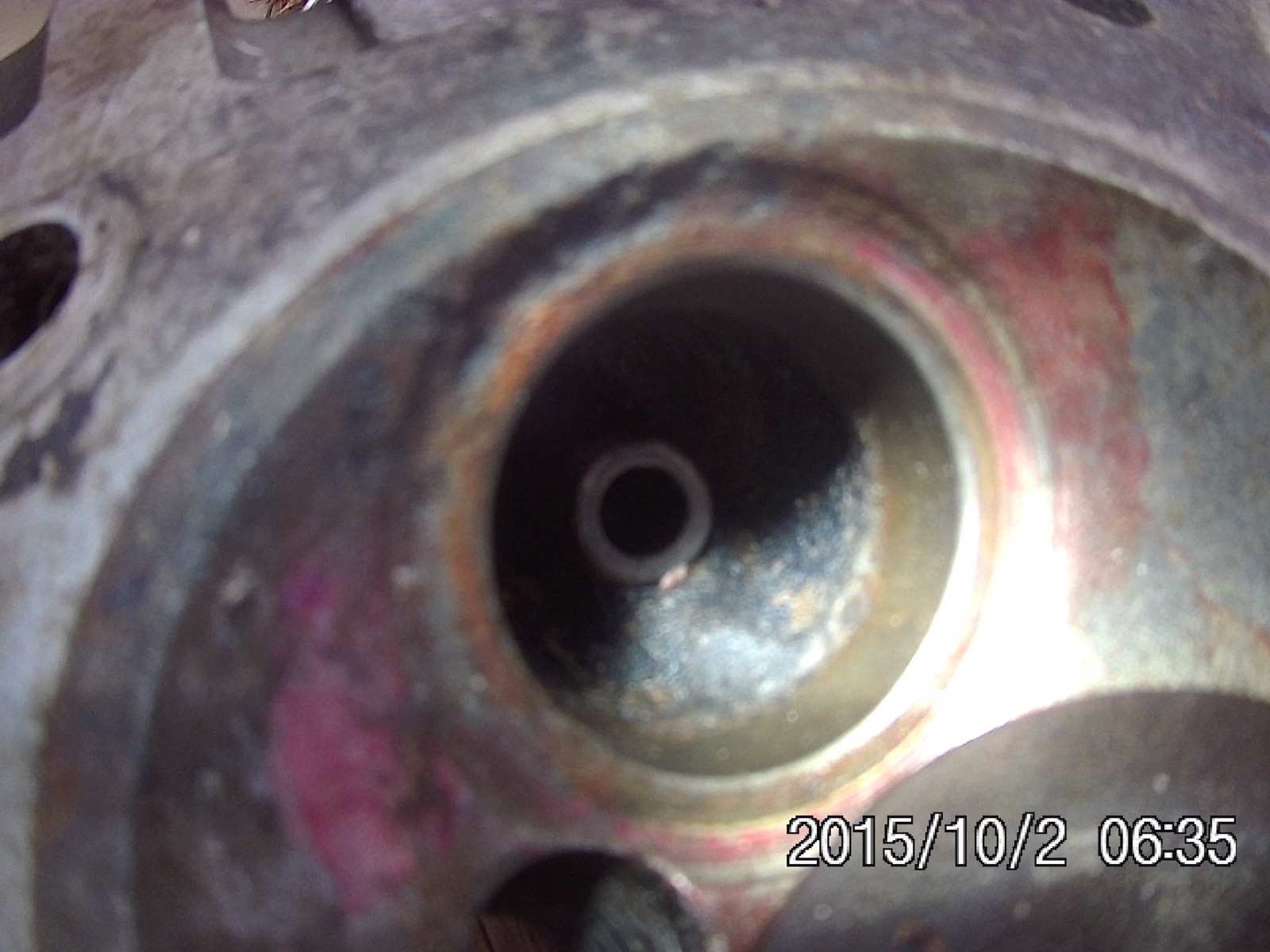

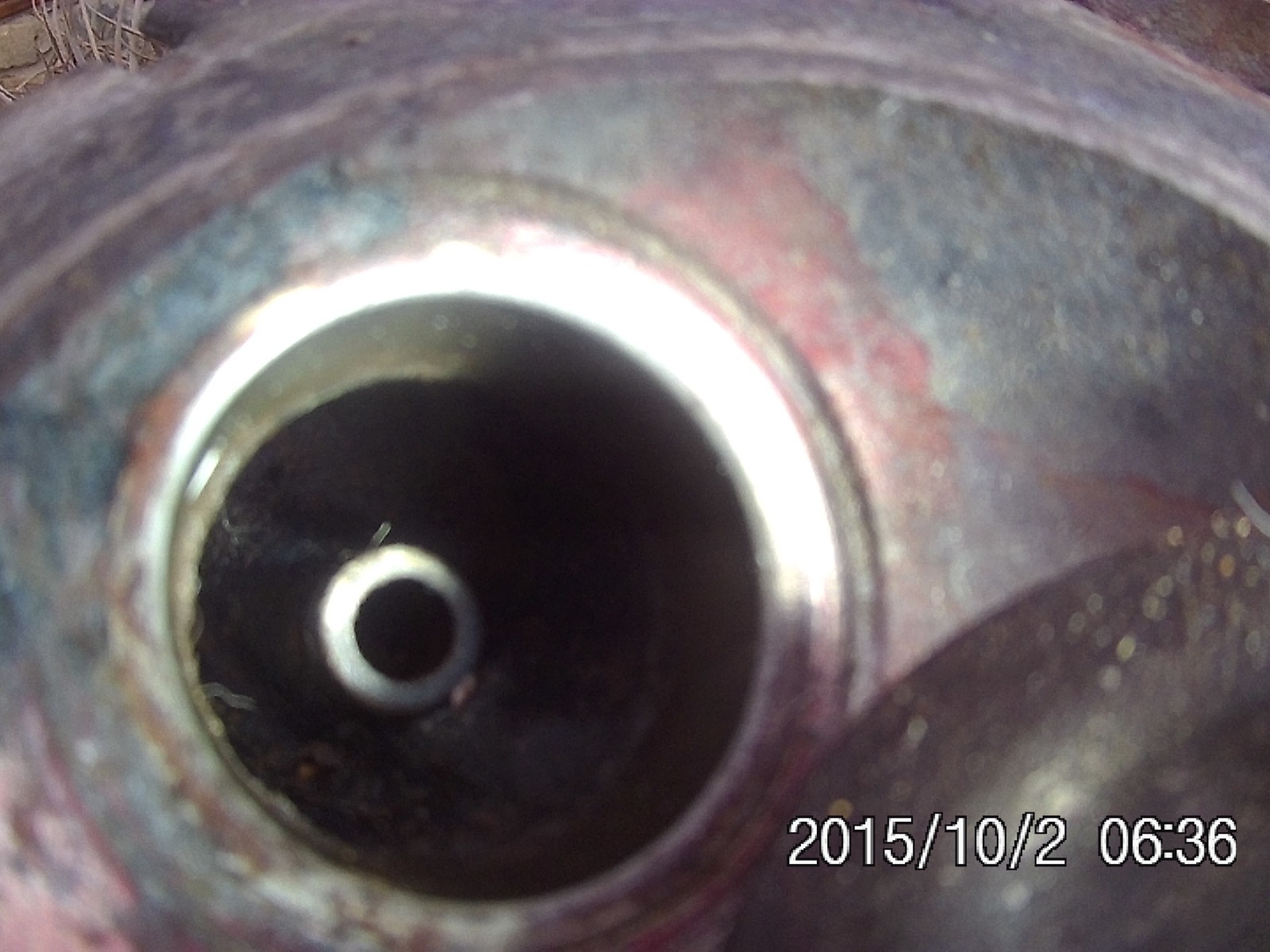

18 Aug 2018 03:08 - 18 Aug 2018 06:30These seats are pressed in.SWest wrote: Always thought they were.
Easily replaced when they are too worn.
