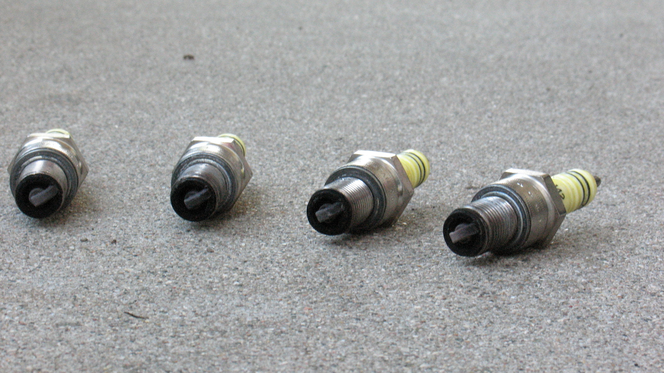

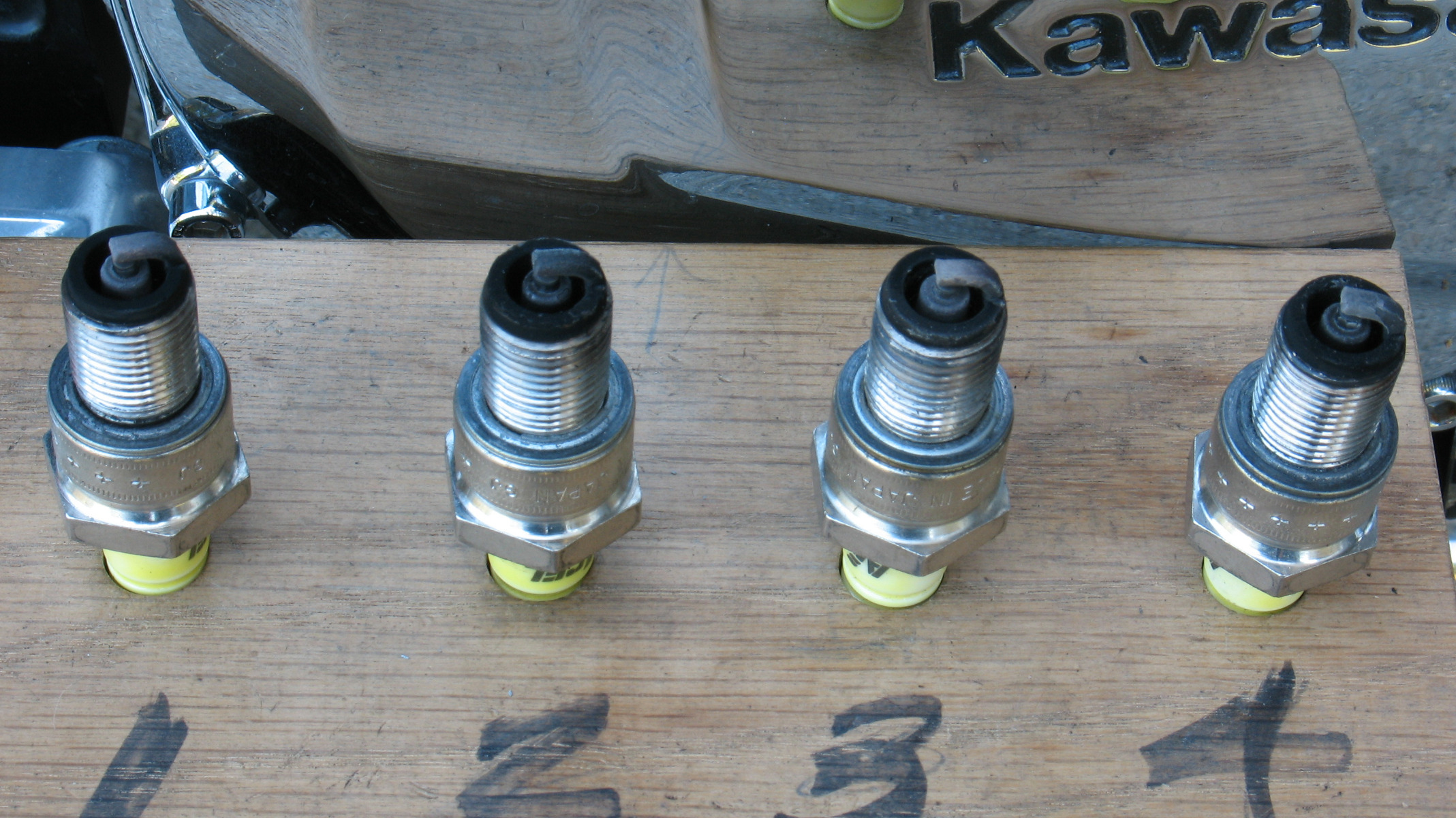

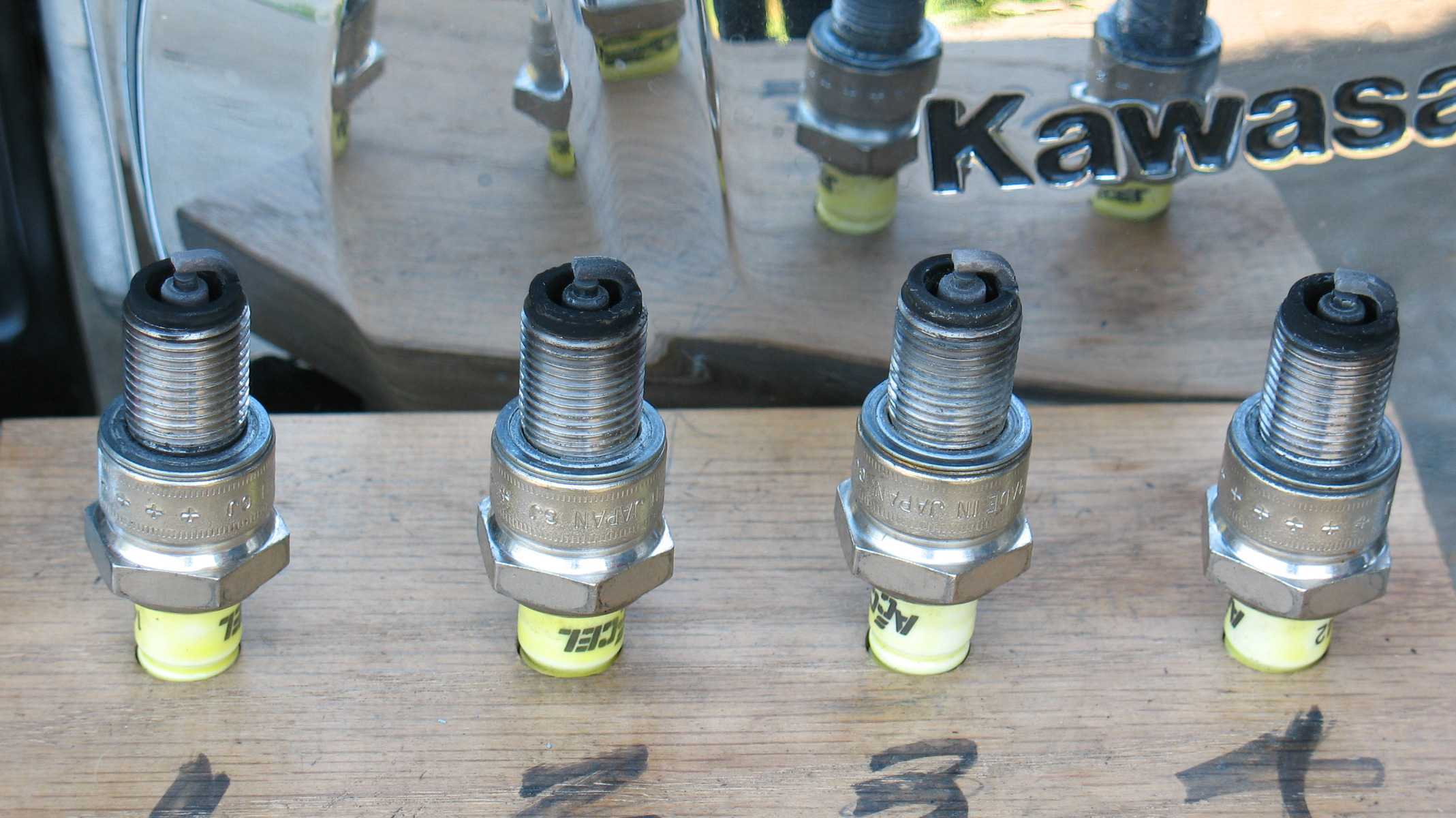

Removed the plugs and took these pics in response to Steve's post. The carbon may be partly from running half a tank of mid-grade fuel, but likely some oil there too.
Played around with various air jets after that, and have .7 in now instead of .8. Had short 30mm stacks for the last couple hundred miles, and now have the 70mm set back on.
:huh:

Not too bad. When my valve guide seals were shot I had to go down on the pilots to burn the oil. You've got lots of time left. B)

You have a oil carbon build up or a little fat air/fuel condition on yoΓΊr spark plug colour.

Looks fat to me. What main jets are you using. Remember, get the mains right then go to the air jets, the needles then the pilots. If you're giving it too much gas, the rings can "wash out" and you'll start burning oil. Not long ago you had that coveted tan color. :unsure:
