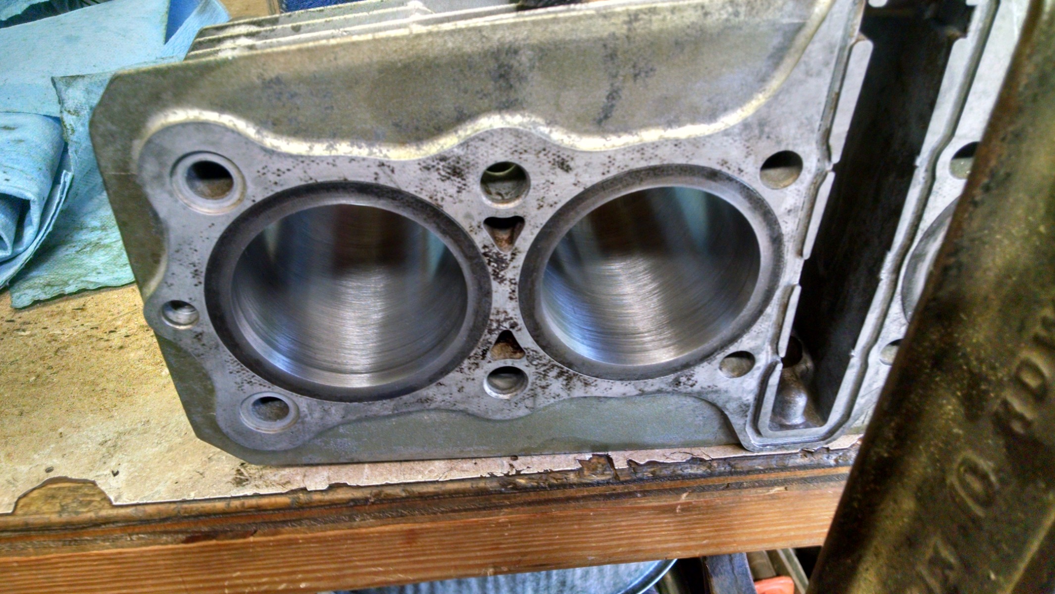

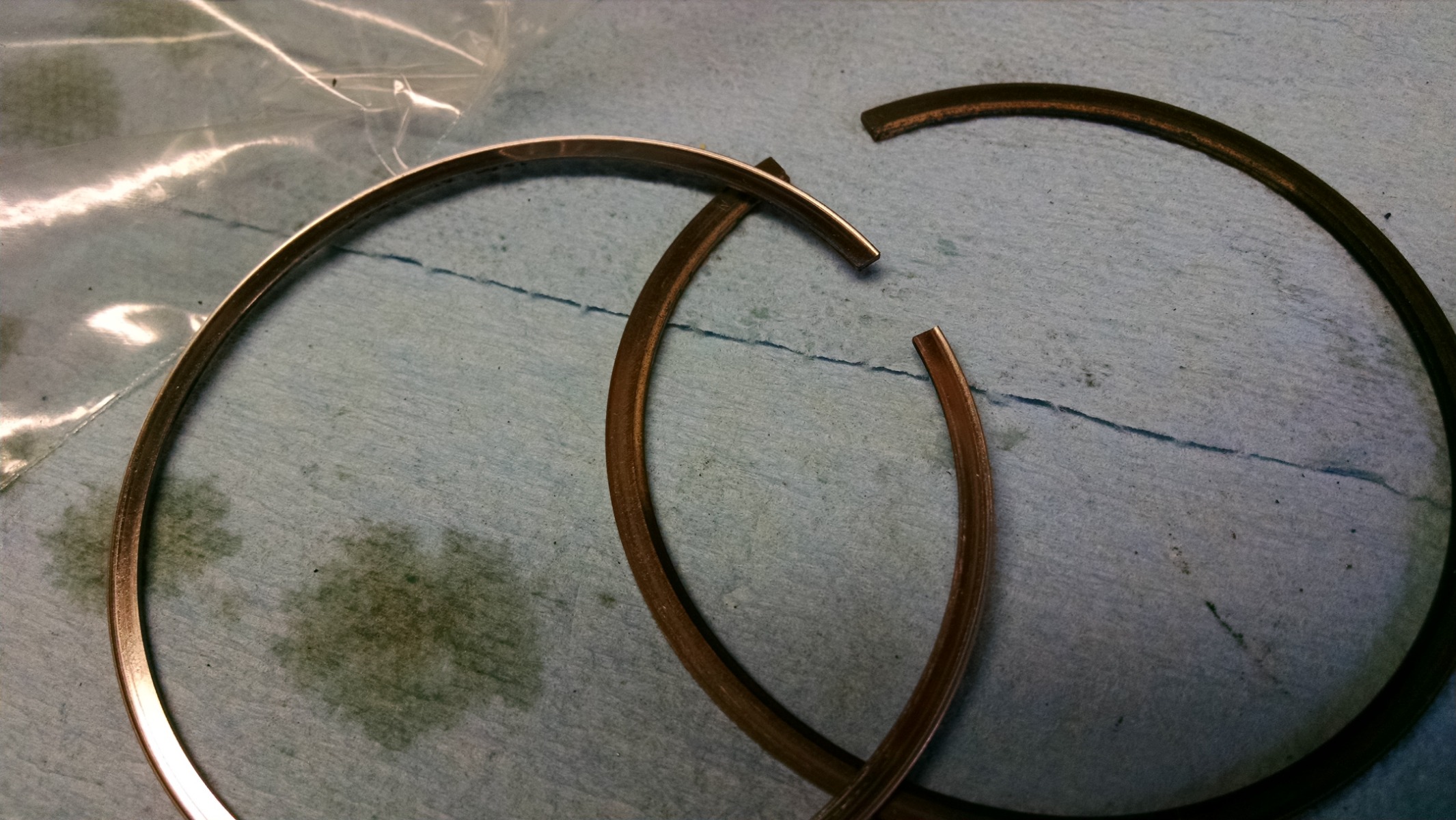

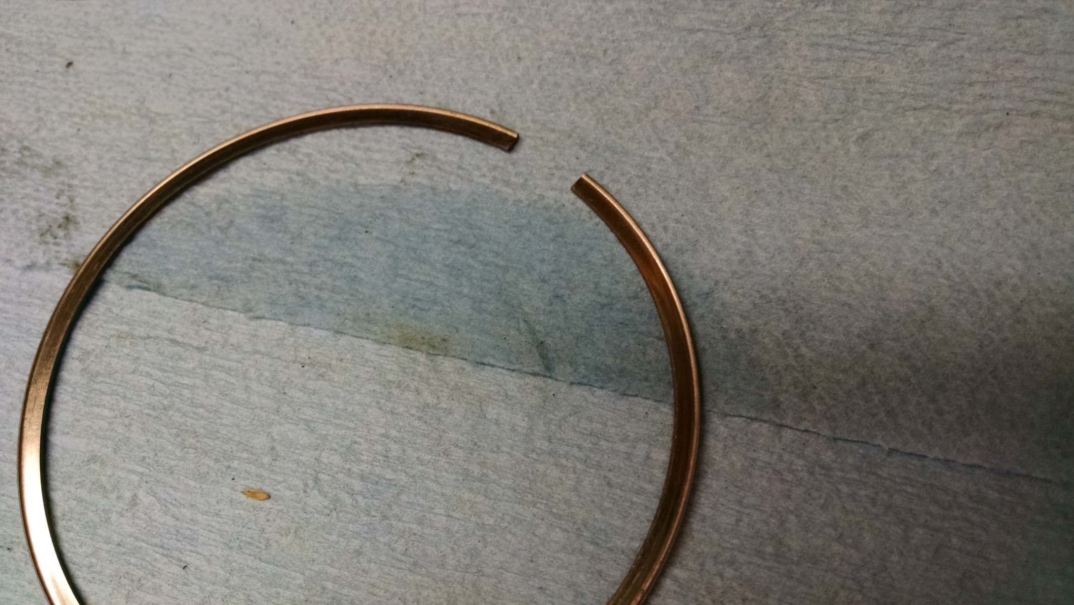

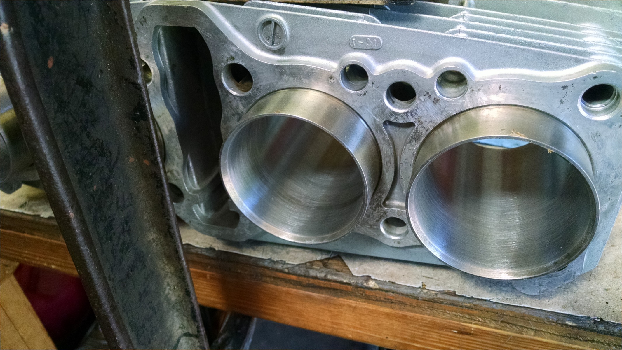

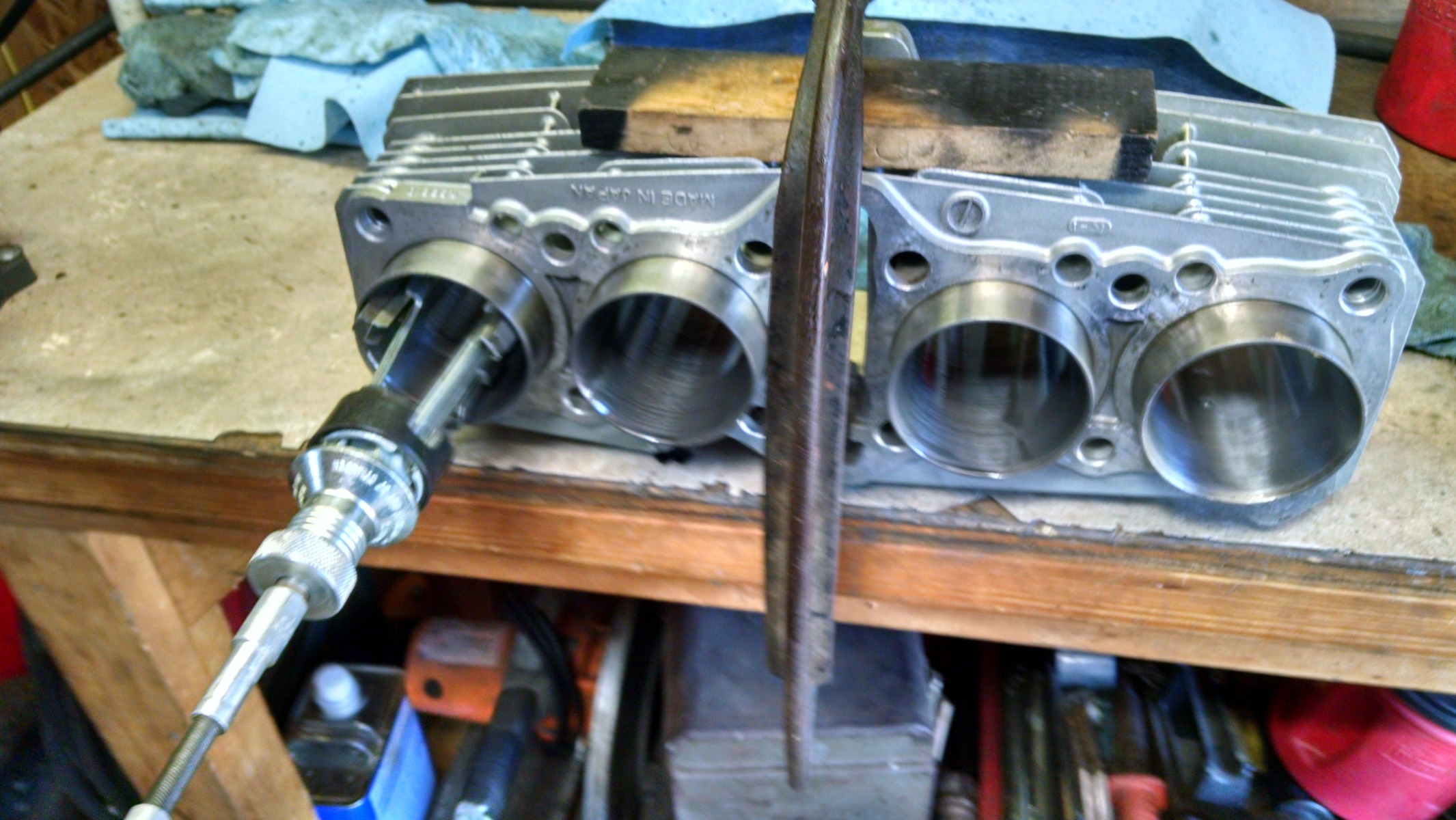

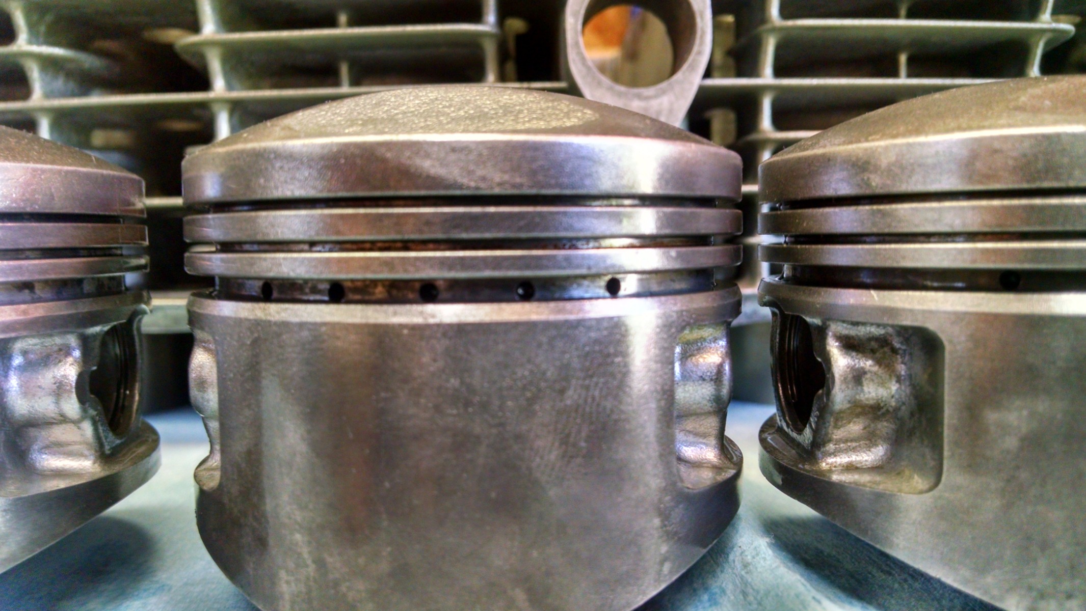

My rings had `20K when I replaced them last fall. The top compression rings had worn into a T shape. I've never seen that happen before.
The bike ran like a bat outa hell, and the oil consumption was reasonable, I only tore it down to fix the oil leak, but it did huff a little blue smoke when first starting it after it sat a few days.
I tried to focus on the top ring, wear but my phone always has different ideas other than what >i< want.
The bores looked acceptable, with only a slight upper and lower ring ridge. It cleaned up nicely with a high quality craftsman cylinder hone.
You can see the lower ring ridge on the left and the hole on the right cleaned up with minimal honing.

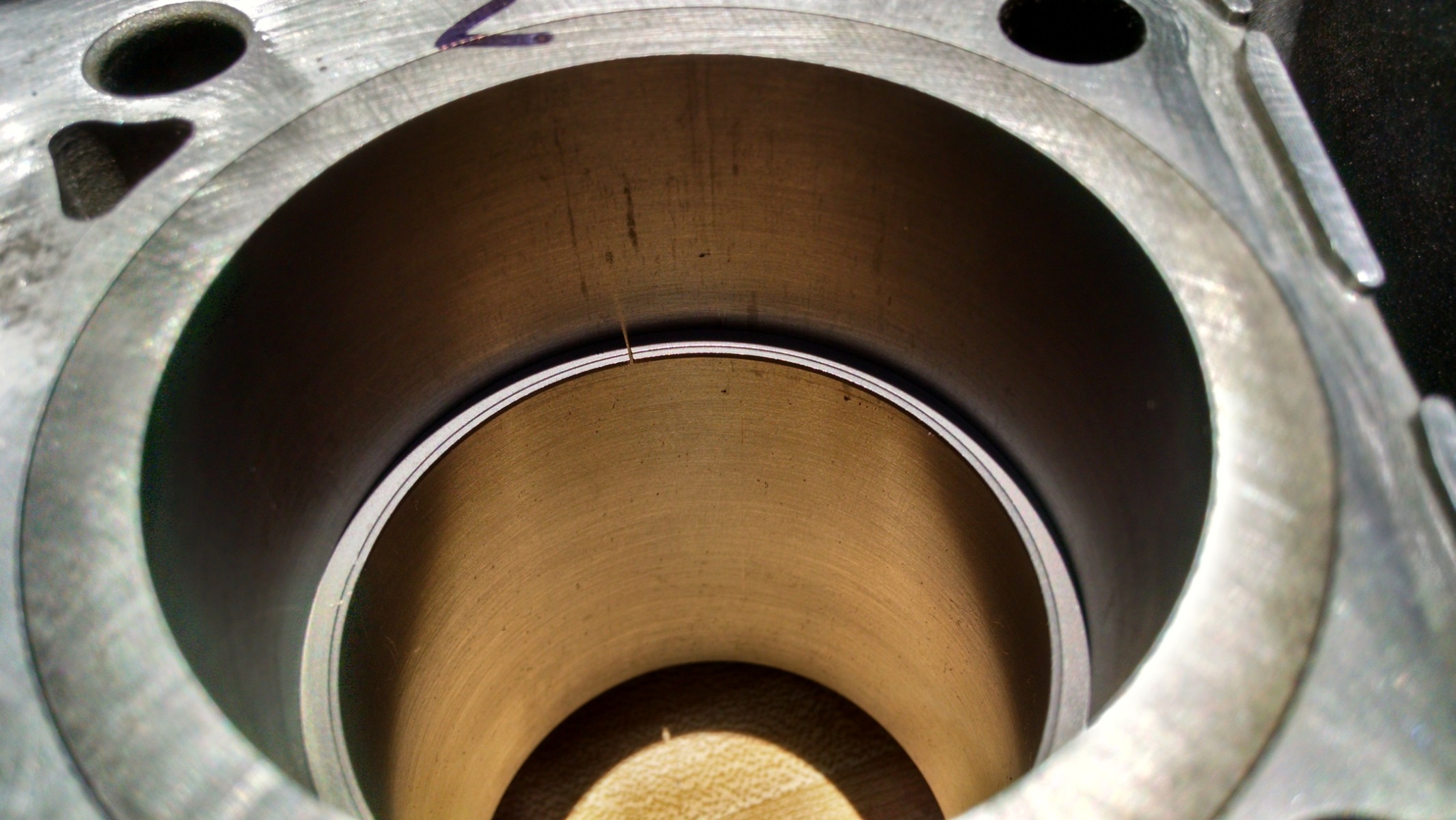

Unless corrected, that dark ring wear area in the cylinder wall would be the place where oil would get past, and also cause new rings to wear prematurely?

17 Aug 2018 00:47 - 17 Aug 2018 00:55daveo wrote: Unless corrected, that dark ring wear area in the cylinder wall would be the place where oil would get past, and also cause new rings to wear prematurely?
Correct. The upper and lower ring ridge areas. (for lack of a better term) is the area where the piston / rings change direction from the down stroke to the up stroke, and visa versa. The ones on my jugs are not that bad, and honed out with a light session. Also the ring end gap was on the tight side when I checked them, but I swear I do hear a slight piston rattle until the bike comes up to temp from a cold start. Nothing excessive, and my bike is ALWAYS set on "kill".
The hole on the left is not completely honed out yet in this pic.
1981 Kawasaki Kz1000K1

That cylinder needs bored and new pistons

17 Aug 2018 04:44zukdave wrote: That cylinder needs bored and new pistons
That motor runs great. It's not getting bored anytime soon,

Re: Top End Time?
17 Aug 2018 07:02old_kaw wrote: My rings had `20K when I replaced them last fall. The top compression rings had worn into a T shape. I've never seen that happen before.
That groove on the 1 ring is supposed to be there!

17 Aug 2018 10:44 - 17 Aug 2018 10:45z1kzonly wrote:old_kaw wrote: The top compression rings had worn into a T shape. I've never seen that happen before.
I was wondering. That makes perfect sense. The NPR rings I replaced them with did not have that "Groove" I just assumed that it was wear, but then again, I can't imagine a ring wearing that badly on the sides, and not eating the mucho softer piston groove up too. The closest I can describe it is a cross section resembles a "T" shape.
