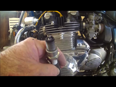

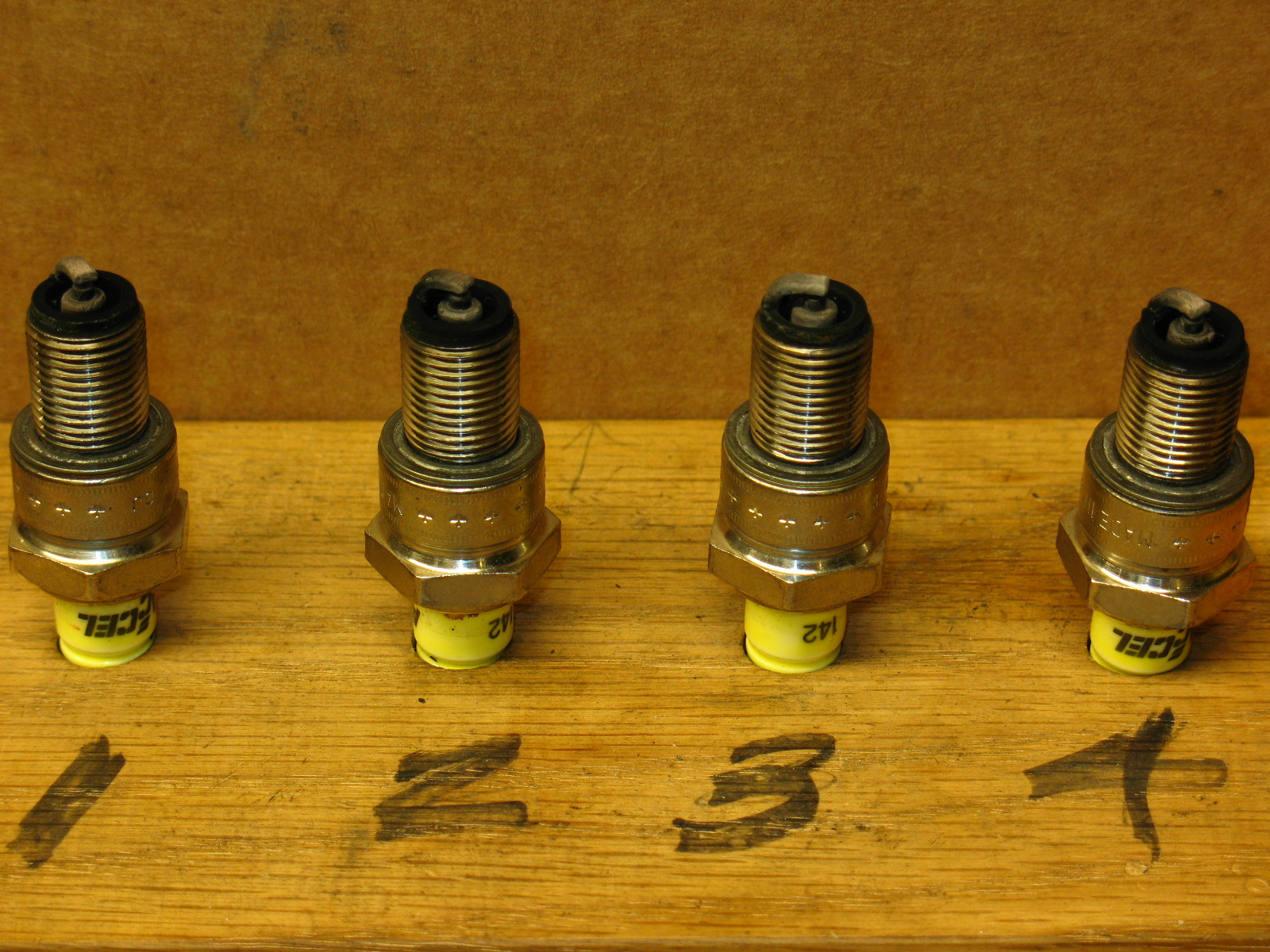

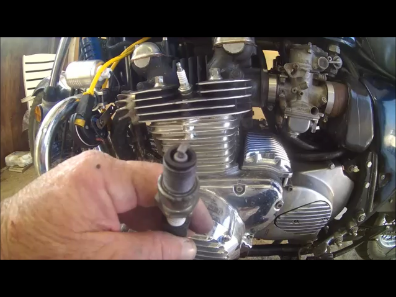

10 Aug 2018 06:06Scirocco wrote: You have a oil carbon build up or a little fat air/fuel condition on yoΓΊr spark plug colour.
How much oil your engine need on 1000 Km or 600 miles???
A rough guess, the engine averages 1 to 1.5 quarts in six hundred miles, maybe more depending on how hard I push it.
1982 KZ1100-A2/1170 sleeper π
- daveo
- Posts: 3174
- Thanks: 899
Re: Top End Time?
10 Aug 2018 06:26SWest wrote: Looks fat to me. What main jets are you using. Remember, get the mains right then go to the air jets, the needles then the pilots. If you're giving it too much gas, the rings can "wash out" and you'll start burning oil. Not long ago you had that coveted tan color.
Coveted but elusive the tan color be.
RS34 carbs have 125 Main, 17.5 Pilot, .7 Air Jets, and needle clips in third slot.
Thank you.

16 Aug 2018 08:53 - 16 Aug 2018 08:58SWest wrote: Looks fat to me. What main jets are you using. Remember, get the mains right then go to the air jets, the needles then the pilots. If you're giving it too much gas, the rings can "wash out" and you'll start burning oil. Not long ago you had that coveted tan color.
Just realized the 17.5 Pilot Jets that I thought were installed were actually 20.0's. So the 17.5 are in there now along with 0.7 air jets, and a brand new set of plugs.
Runs way better, and that highly-coveted color is starting to come back again.
Thanks again Steve

Re: Top End Time?
16 Aug 2018 18:20
Now the carb jetting is correct or close to it the base of the plugs are cleaning up meaning the oil burning is being reduced maybe even stopping.
