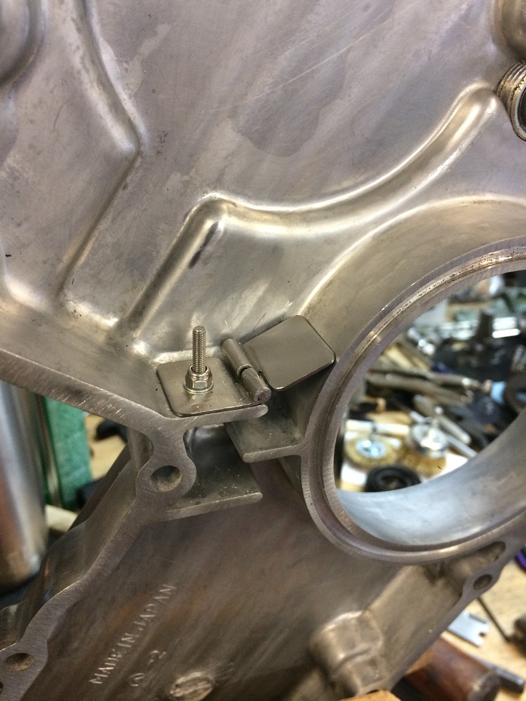

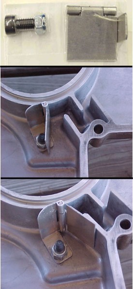

This is the way I'll do it. (good idea) Maybe bend the bolt so it won't open too far.
kzrider.com/forum/11-projects/539557-76-...ild?start=700#730229
MTC Gate
MTC Gate
Last edit: 13 Dec 2016 06:16 by SWest. Reason: add pic

Re: Engine oil surge issue
13 Dec 2016 17:28Swest, I have a similar one on my Z1R but I drilled (I was young a stupid then/ bite me)two holes further down on the outside wall - aligned with the sprocket. I have to admit it does work great with no leaks for the last 30years. I also had a screw to prevent the gate from opening too far.650ed wrote: See link below for MTC gate. Ed
store.schnitzracing.com/mtc-oil-pan-gate-kawasaki-kz900-kz1000/
I am making a similar one to the MTC gate for the GPZ but I will be screwing the bracket into the oil filter area therefore eliminating any leakage issues.
Once I finish I'll post some pics, in the next week or so.
13 Dec 2016 18:53Bozo wrote:Swest, I have a similar one on my Z1R but I drilled (I was young a stupid then/ bite me)two holes further down on the outside wall - aligned with the sprocket. I have to admit it does work great with no leaks for the last 30years. I also had a screw to prevent the gate from opening too far.650ed wrote: See link below for MTC gate. Ed
The only concern I have with that is the oil filter area is pressurized so a better chance for a leak. Probably won't matter but I like Naked fun's idea better.
13 Dec 2016 19:23
Swest, I thought the same thing but with careful threading and using thread lock it should be ok, I'll see how I go, I might still change my mind. :blush:
