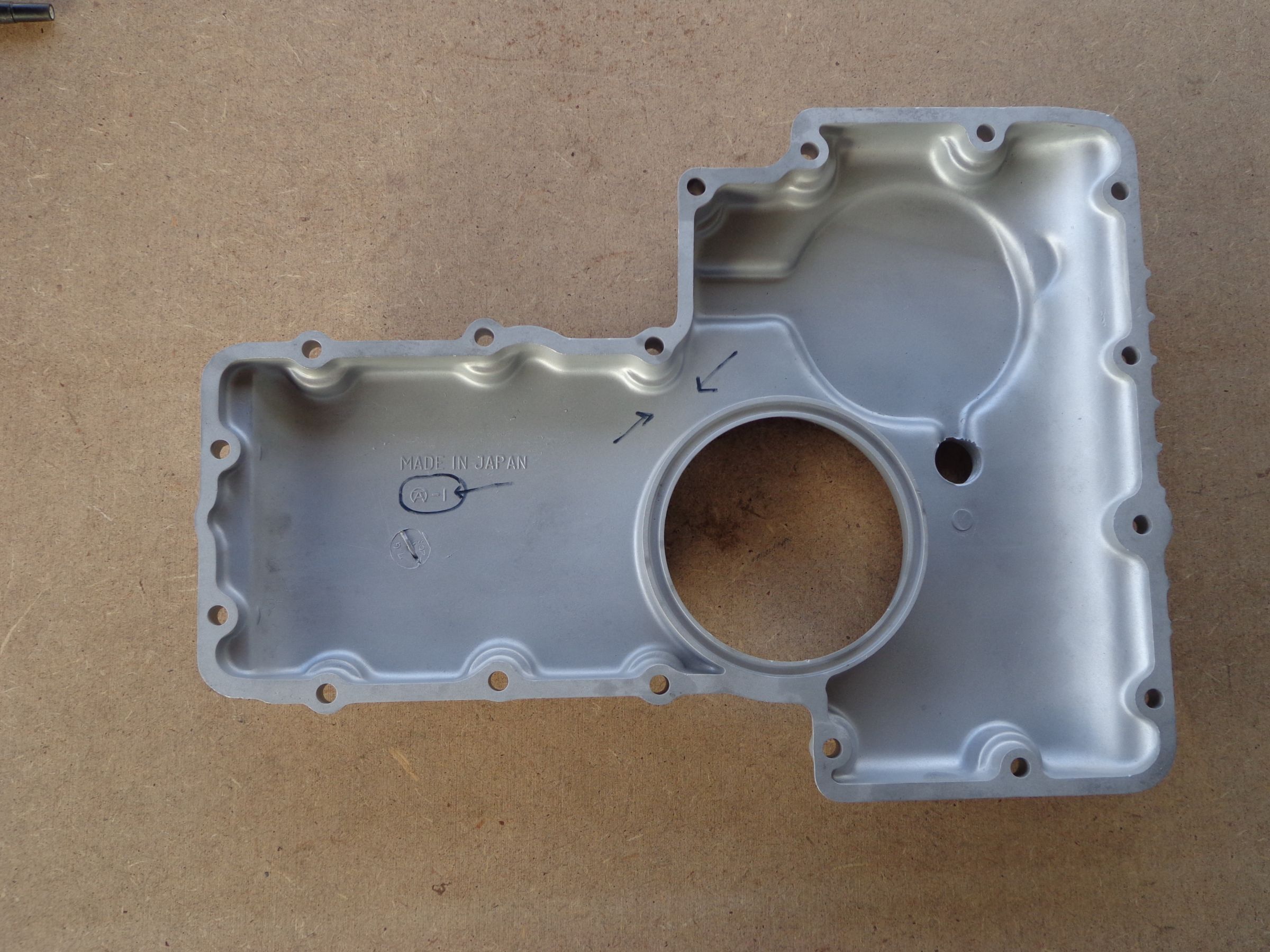

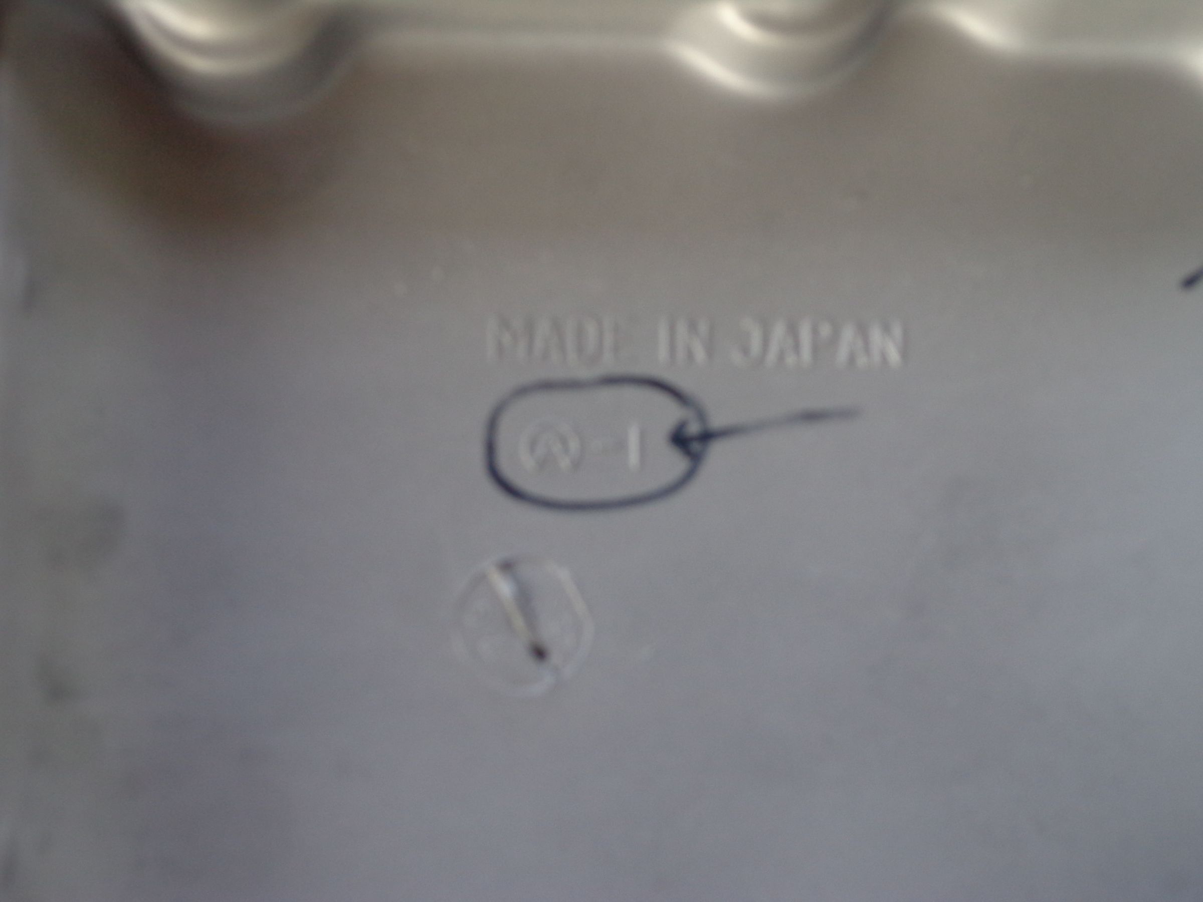

I just happened to sell this one this summer on ebay.
It went to Japan? Maybe a true restoration? Guy must have been anal? Unless the ribs were different on bottom?
It sold for $30 bucks. Inside cast mark had # 1

A Hinged Gate was the ticket to cure oil starvation under rapid acceleration Like ZED said ..
