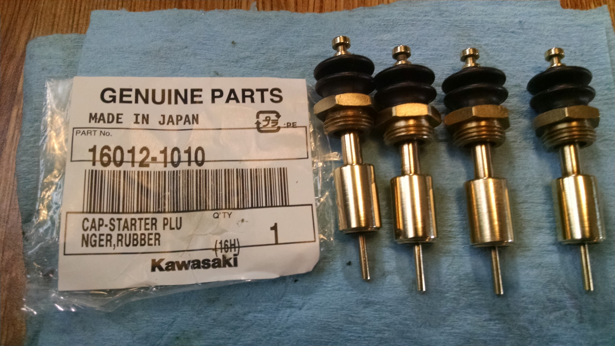

I also went through my carbs last January, and replaced the starter enrichment booties on all four carbs, My bike is like a caged animal, it wants to GO. Although it has always been so, it is even more now.
Those bootie things are pricey at ~15 bucks each, but the cheap replacements aren't like this and are just dust seals, not boots. I polished this stuff up in my cordless drill.

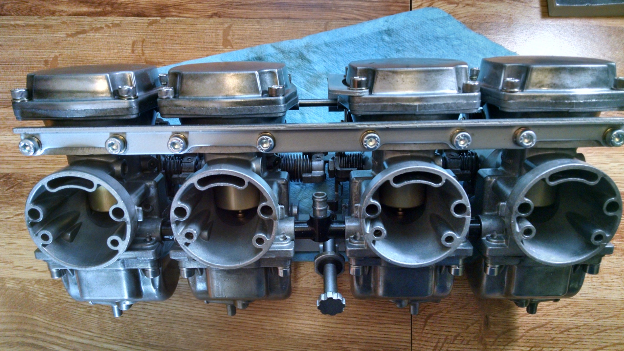

Notice I soda blasted the carb bodies, polished any brass I could get to, and bought a bunch of metric stainless hardware from fastenall. (it was 19 degrees here) I think it's cheaper to buy the Z1 screw sets (did that too), than to piecemeal the screws / washers, but it's soo gratifying. lol Fastenal also has some meaty small flat washers that look great ( gold looking plated).
I just got some new spring clamps too.
I did see that you did a lot of carb swapping, so something is probably out of whack in the fuel / air department too. 2 1/2 turns is too much on the idle mixture screws, I think my manual lists 1 1/4 turns as initial on the CV carbs. Normally on the idle mix adjustment, you want to main idle down as far as possible without dying, then adjust the screws in until the rpm's go down, then back out until they go back up, and I usually go ~1/8 turn out past that. If this makes any sense to you? I think mine are around 1 3/4 now. Not really critical as long as the bike idles ok and is not acting stupid at stop lights etc.

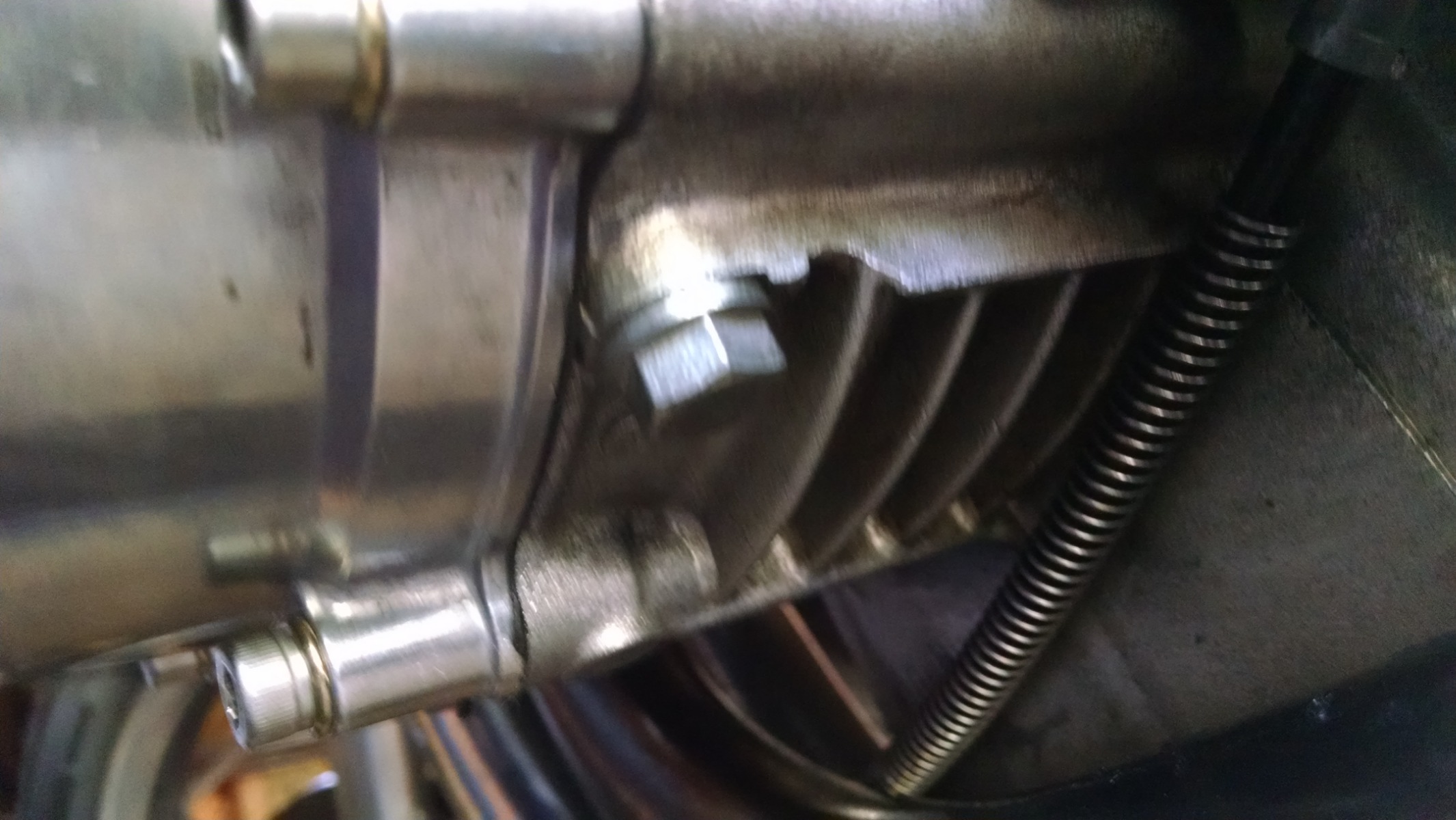

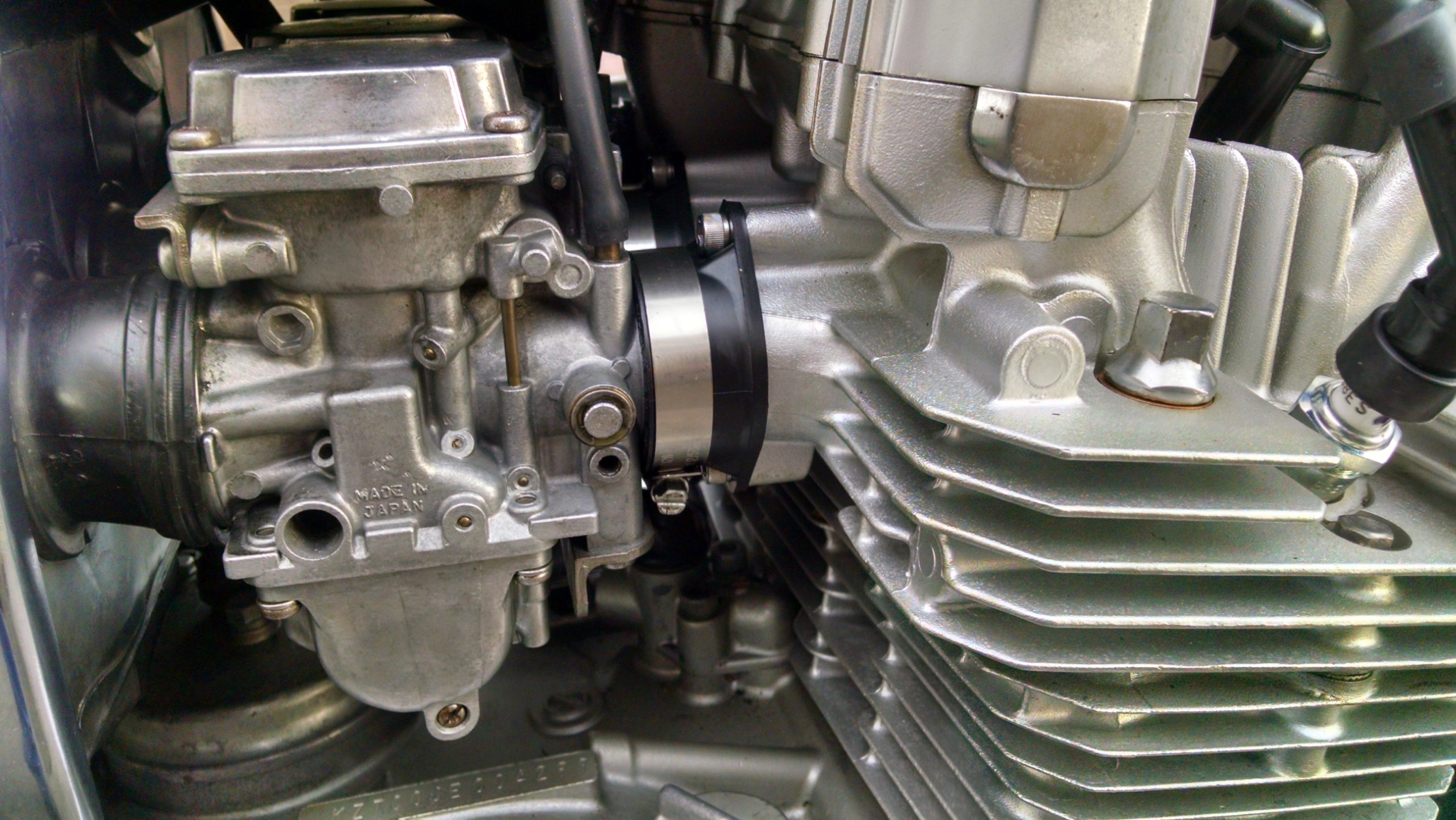

Just a wild guess here, but a stock air filter would probably fatten up the fueling a little. It really doesn't need any help breathing,, I bet at this point just running right would probably be a blessing. It 's not like it's some super duper racer, it's a old cop bike.
The reason I was asking about the cracked case, it because that area does look a little weak, and I noticed the other day, I have evidence of somthing hit that area on my bike, weather it might have been from a floor jack at some point, or hit it loading on a trailer, or curb, OR? I don't think mine is cracked, but I would like to clean up the area, to prevent any cracks from forming. It may be time for the bur on my die grinder. I really do hate to touch it, because everyone knows if a little is good, a LOT is better. lol
I took this pic today.
Not all that bad, but the jagged edge may give it a place for a crack to start.
