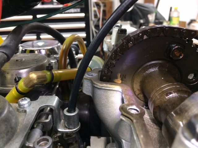

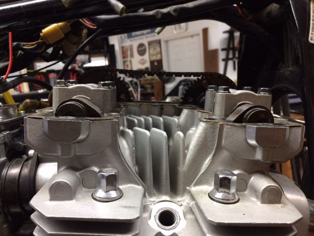

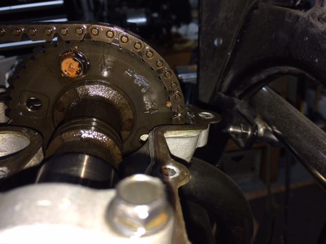

Re: KZP engine rebuild
21 May 2018 10:02
back on this after getting my café bike done and the H1 back on the road.
Just double checking the timing. How does this look? The timing mark is T for 1-4, the exhaust sprocket is a little high but the intake sprocket lines up just fine and there are 44 pins between them.
