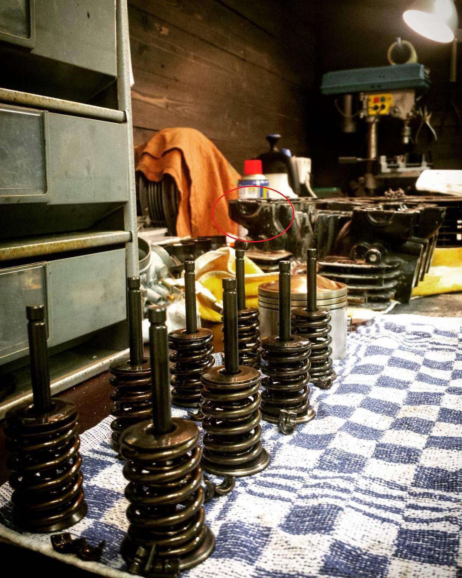

I checked the cylinder head and it had no cracks, so I'm "safe" there. Gonna use it as it is, valve guides are not moving so all i gotta do is lap, put proper valve guide seals and rebuild the head and recheck for leaks. Not yet decided on the new rings for pistons, though.
