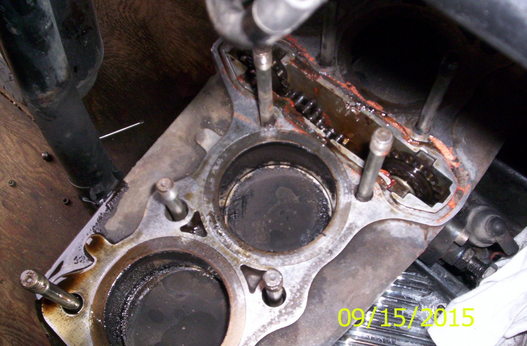

I just did the head but my plugs look like that bottom cylinder after running it for 10-20 minutes.
