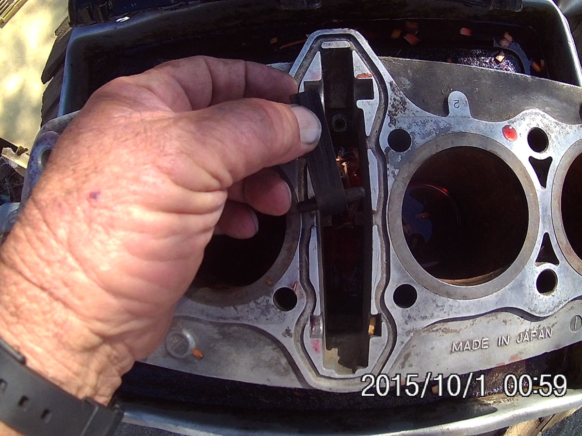

Re: Z2 750 crank (Bossie the Kaw)
19 Dec 2017 11:38
Using my old early 70's Snap-0n light gun, mine does the jiggle a lot more then when I use my other much newer strobe, the Craftsman light. No idea why.
However, I've noticed that I can jiggle the weights a little now where the springs don't seem to hold them as steady any more.
Could be the weights are moving around the pins or the springs are loose... ??
Only about 42,000-45,000 miles on my advance mechanism but I bet I'll be doing the same thing this spring.
Bruce
1977 KZ1000A1
2016 Triumph T120 Bonneville
1977 KZ1000A1
- Posts: 23777
- Thanks: 3042
19 Dec 2017 13:45
The spring ends get loose. Made a big difference and the knock has all but gone away. It was making the engine stumble at idle. Also the bolt was slightly bent. Going to try and time it again.
- missionkz
- Posts: 1612
- Thanks: 182
19 Dec 2017 15:51
Bent bolt.
I noticed that in your previous video but I thought it was an illusion from just the cam lobe itself oscillating.
Bruce
1977 KZ1000A1
1977 KZ1000A1
- Posts: 23777
- Thanks: 3042
19 Dec 2017 16:43
It's the second rotor. Should have replaced it long ago. :whistle:
