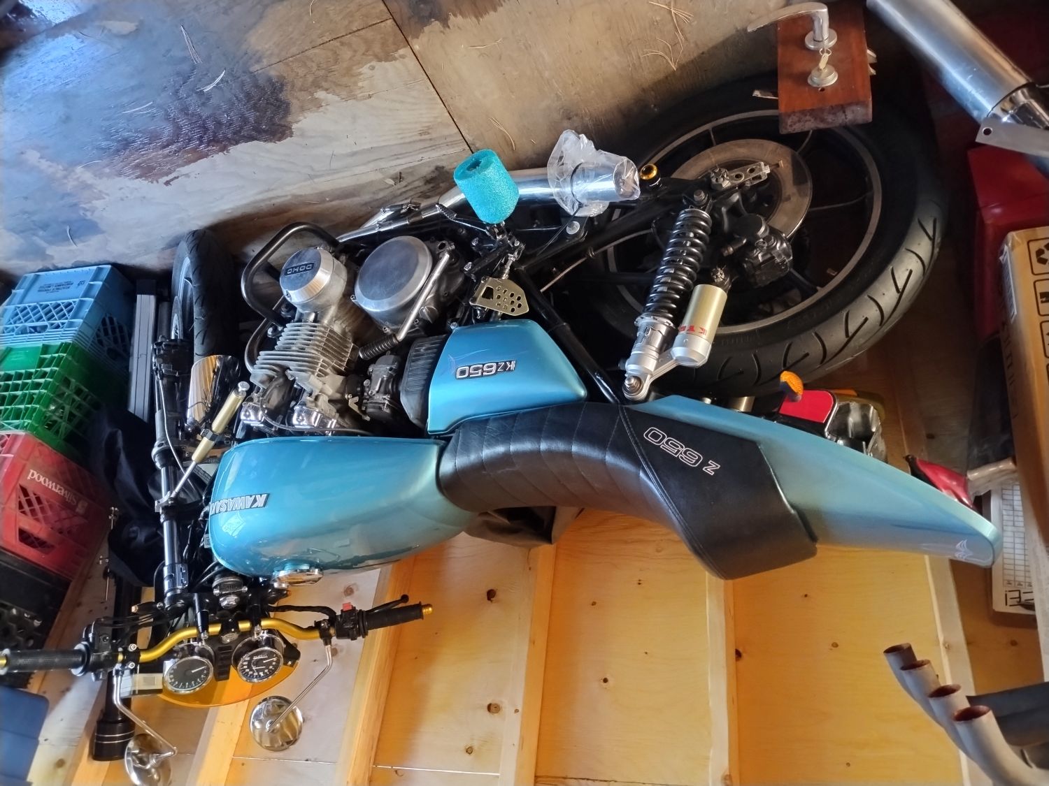

The 650 has taken a back seat since the arrival of other Kawis over the years.
I still have her, tucked away in a back shed.

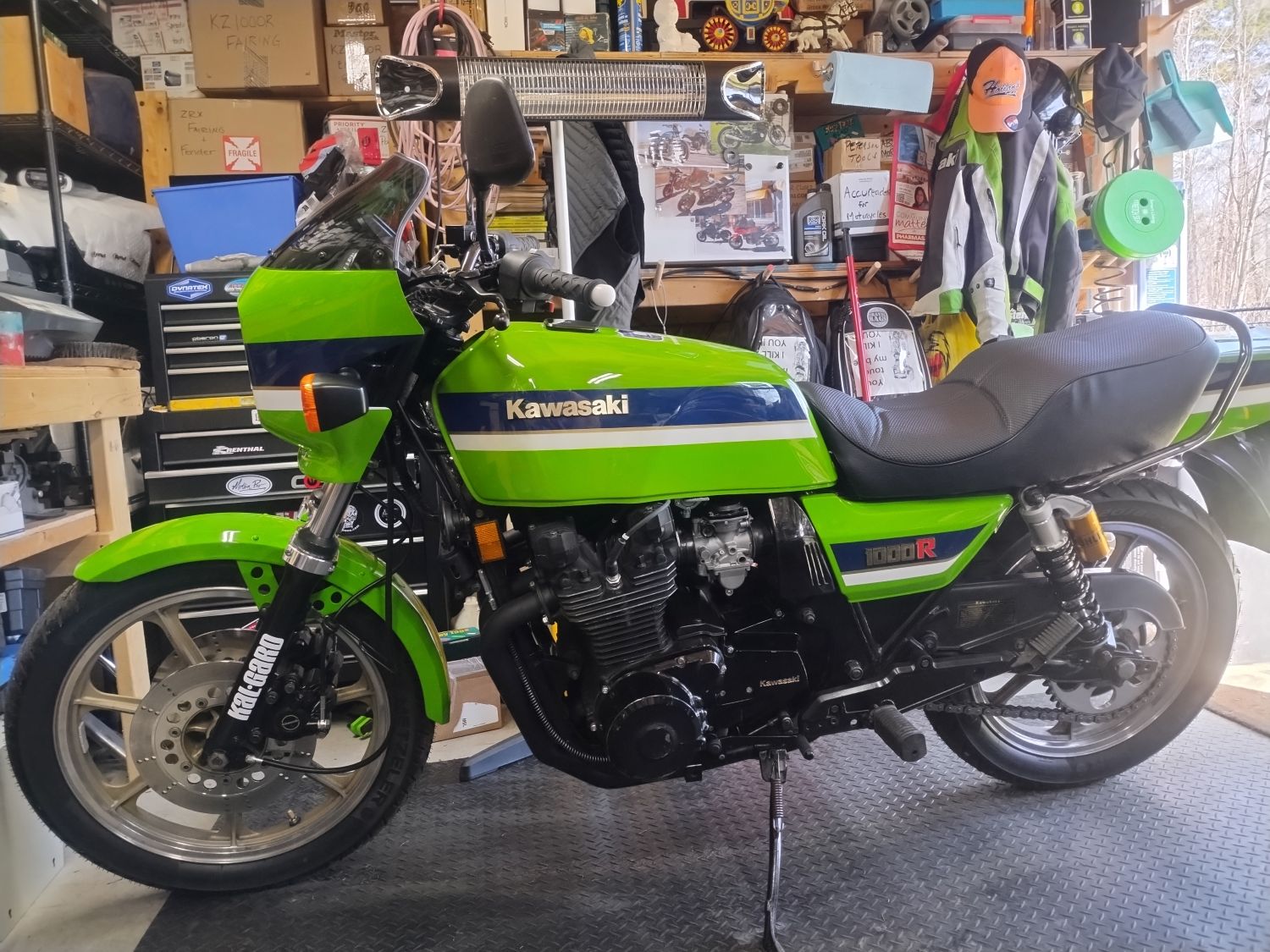

Got the no power issue sorted on the 1000R.
A main power plug was loose and had come undone under the seat.
I crimped the female side a little to tighten the plug, and all seems good to go.
Today I had some time, and good enough weather, to try and start her.
Success.

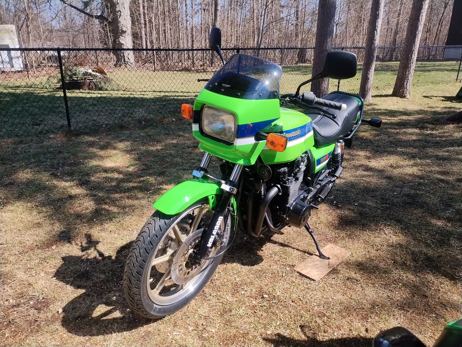

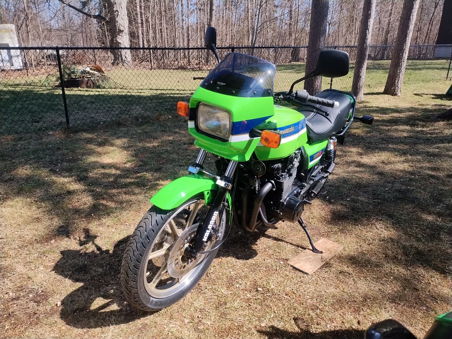

Today was a very nice day weather wise.
I started up the 1000R, and decided to take her for a short ride.
Fill the gas tank up, and see how well she rides.
It will be her first ride this season.
The RPMs are still hanging up a little.
Turning down the idle speed adjuster helped.
The gear shifter was a bit high, but that was easily fixed when I got back.
There seems to be a bit of a stumble at idle too.
I would like to ballance the carbs at some point.
The engine seems very strong, with a constant pull.
I haven't brought her up into high revs yet, only getting to about 6000 RPM in second and third.
Speed limits are 50-70 KPH along the route.
She handles well, although I only did one block, a big square, 13 KMs.
A good test.
Gives me some confidence in her.
I may be riding her to get Certified.
About a half hour ride on country roads.

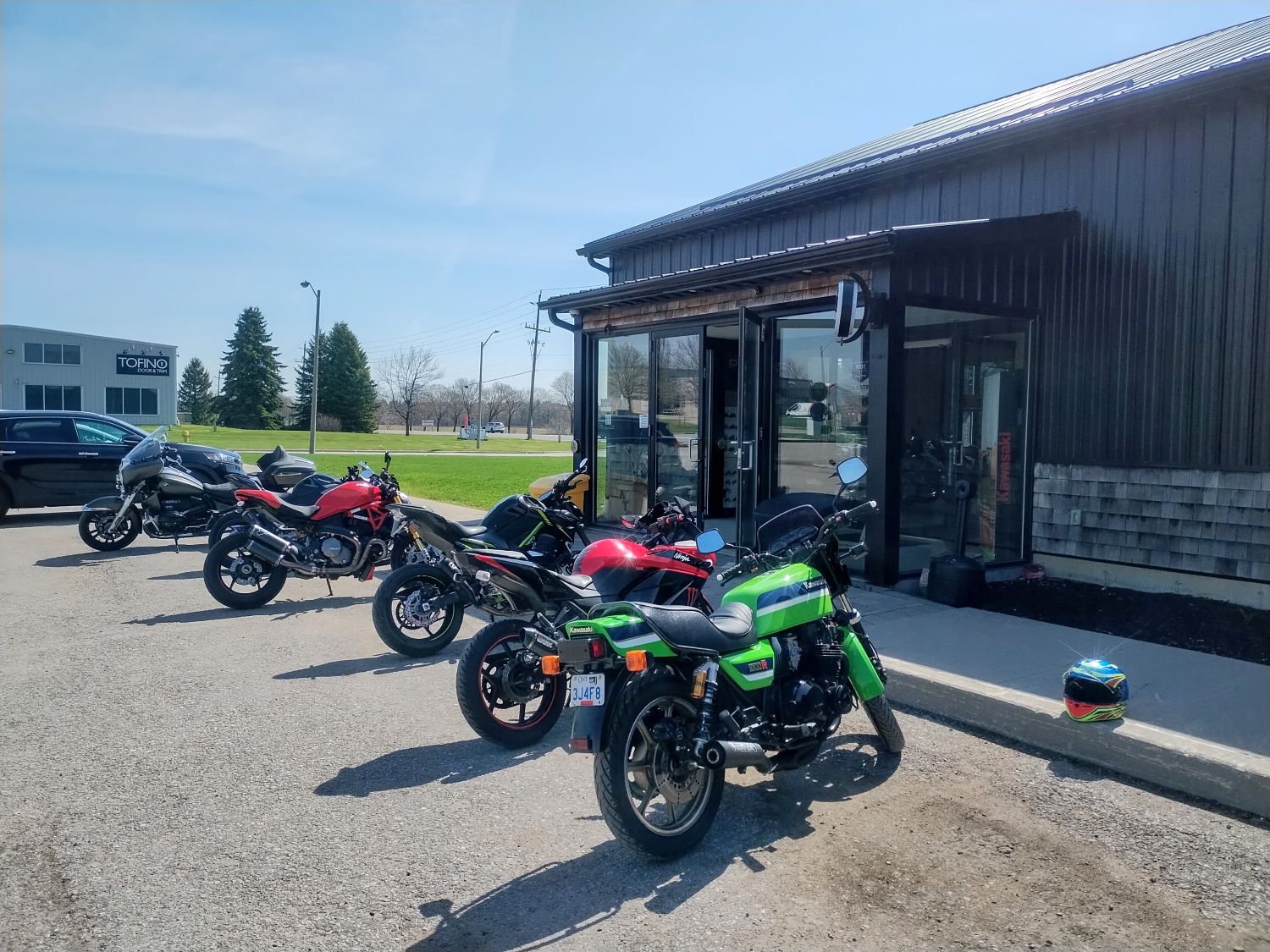

May has come around again.
It was at the end of last May that I bought the 1000R.
Today I took her to get Certified.
There's good news and bad.
The good, she passed!
The bad, the battery died on the way home.
I stopped for gas, and she wouldn't start again.
I got a boost, and managed to get home.

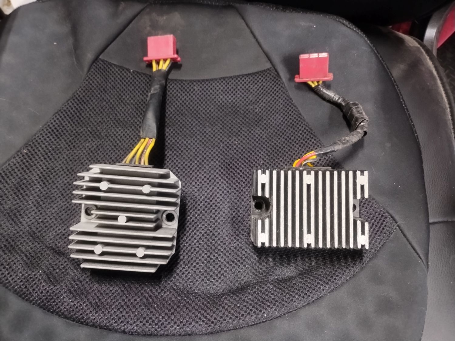

I tested the two Reg/Rec today.
Both read similar, 15-16 volts with the ocasional 17 volt spike, with the bike running, reading taken from the battery.
The manual says that's too much.
I did have the headlight fuse removed, and it did drop a little when reinstalled.
I asume the Stator is Okay if I'm getting those voltages?

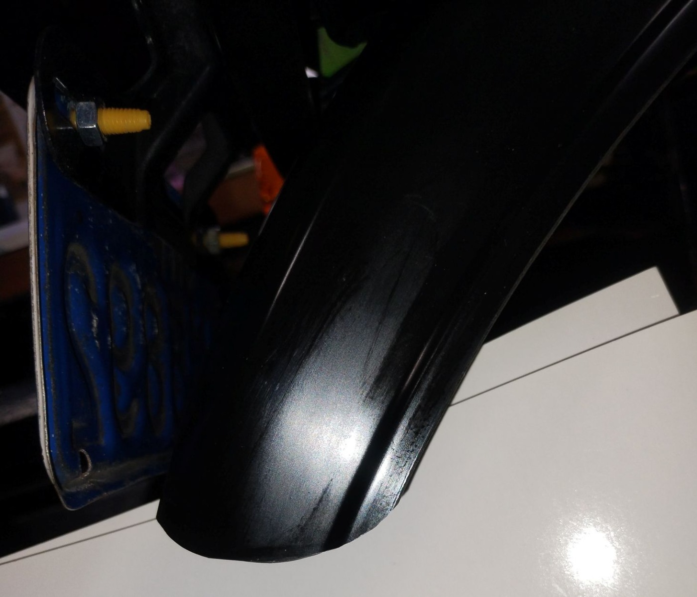

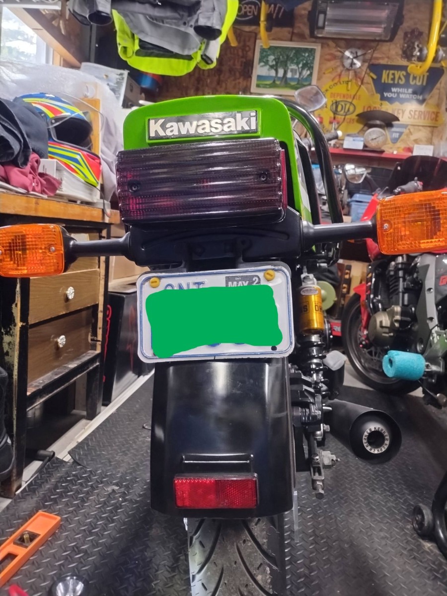

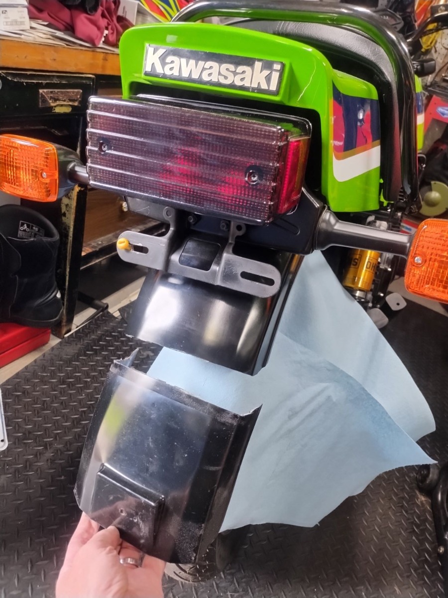

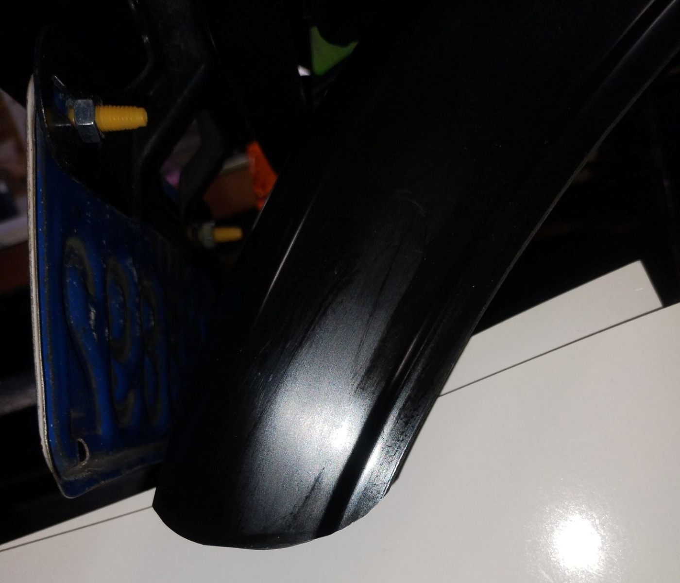

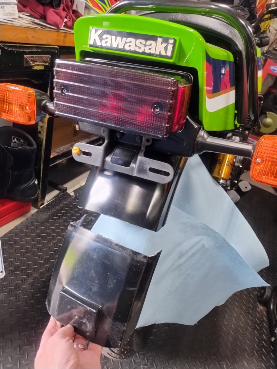

I trimmed the rear fender today.
It was a Euro version, and I shortened it to what North American models used.

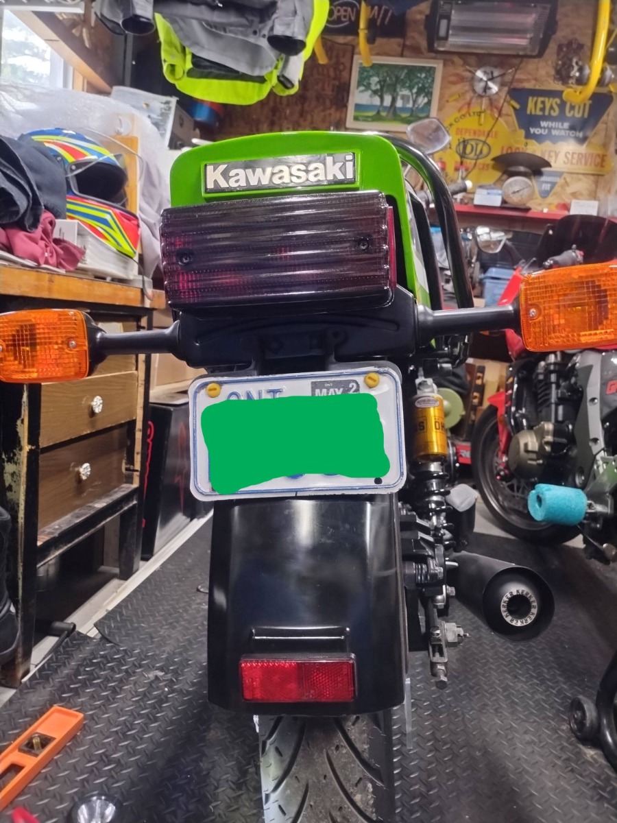

- Mcdroid
- Gone Kwackers
- Posts: 6881
- Thanks: 519
Re: 1983 KZ1000R2 Project
06 May 2026 12:06
You should be able to salvage and sell that rear fender reflector...looks better this way.
Michael
Victoria, Texas
1982 GPz750
1977 KZ1000A
1978 KZ1000A
1982 GPz1100
1975 Z2A
Victoria, Texas
1982 GPz750
1977 KZ1000A
1978 KZ1000A
1982 GPz1100
1975 Z2A
The following user(s) said Thank You: rstnick
- Posts: 6729
- Thanks: 4244
06 May 2026 14:05+1You should be able to salvage and sell that rear fender reflector...looks better this way.
- rstnick
- Posts: 4683
- Thanks: 577
06 May 2026 17:40 - 07 May 2026 12:59The reflector, It's not original, it's a Harley one too I think.
Doesn't fit the rectangular area it was sitting on, but I had a hard time finding the exact size.
There is a spot just under the tail light, for a reflector, I think.
Two mount holes, compared to only one on the end of the fender.
I found a reflector to fit on eBay. Comming soon...

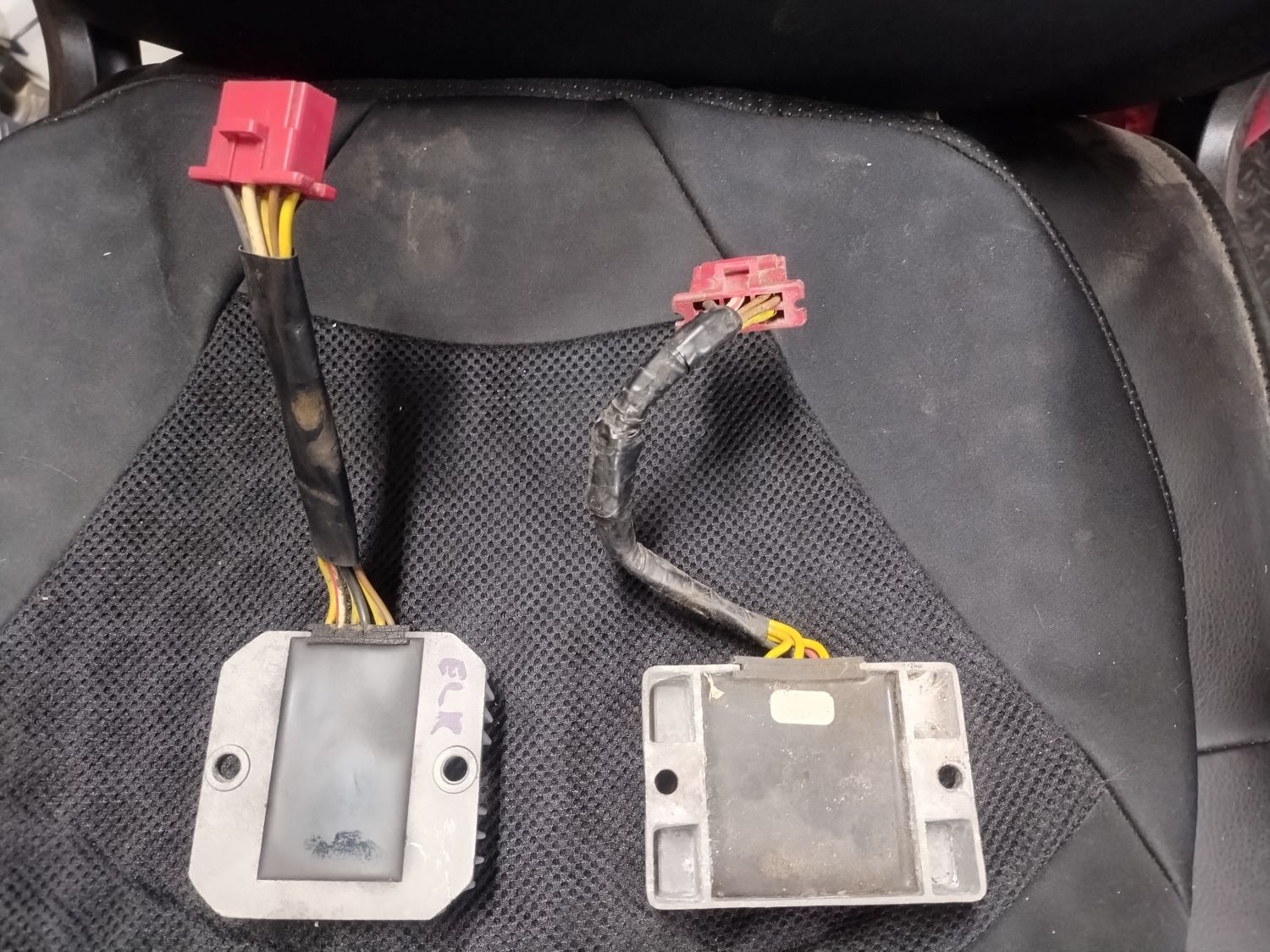

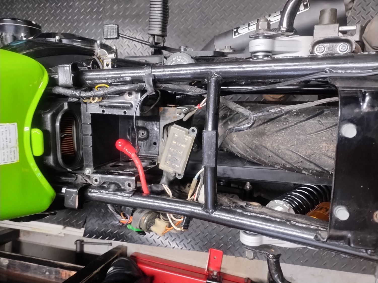

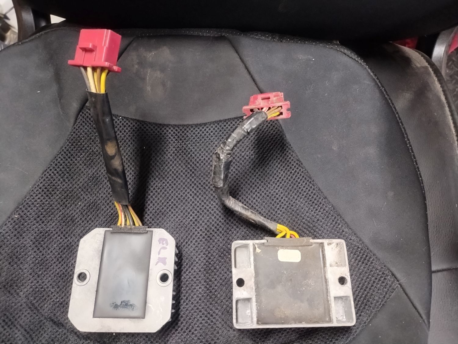

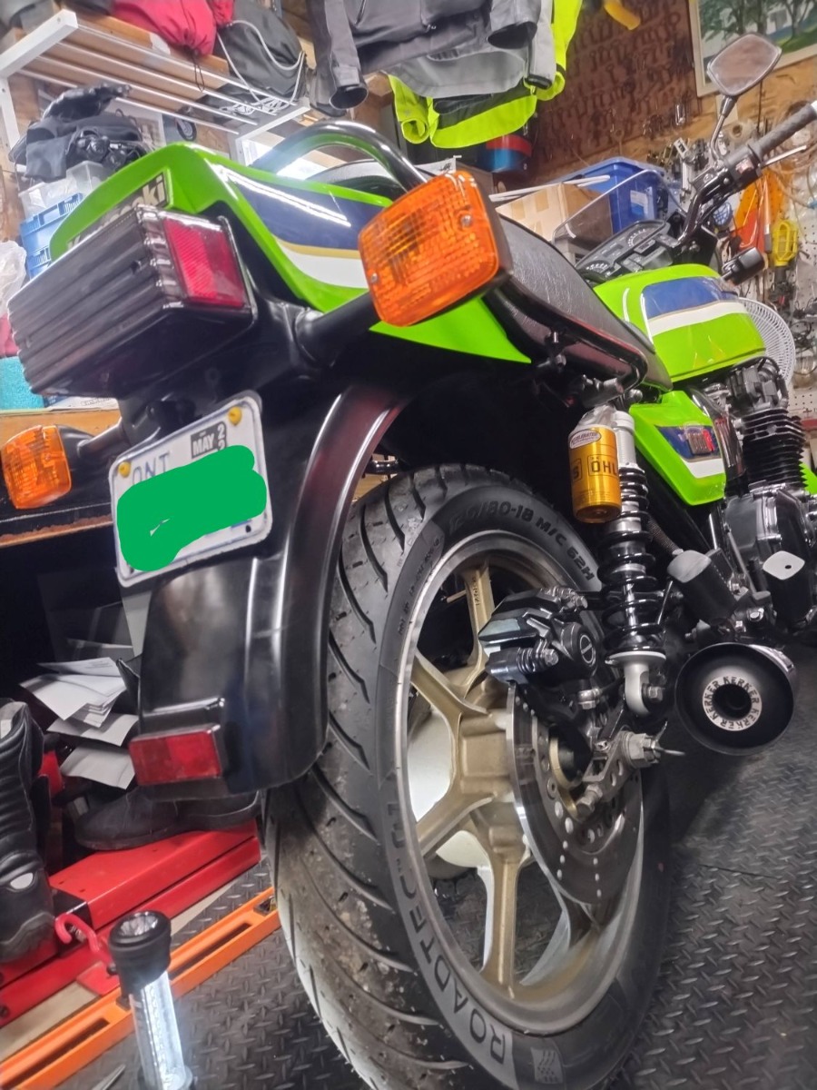

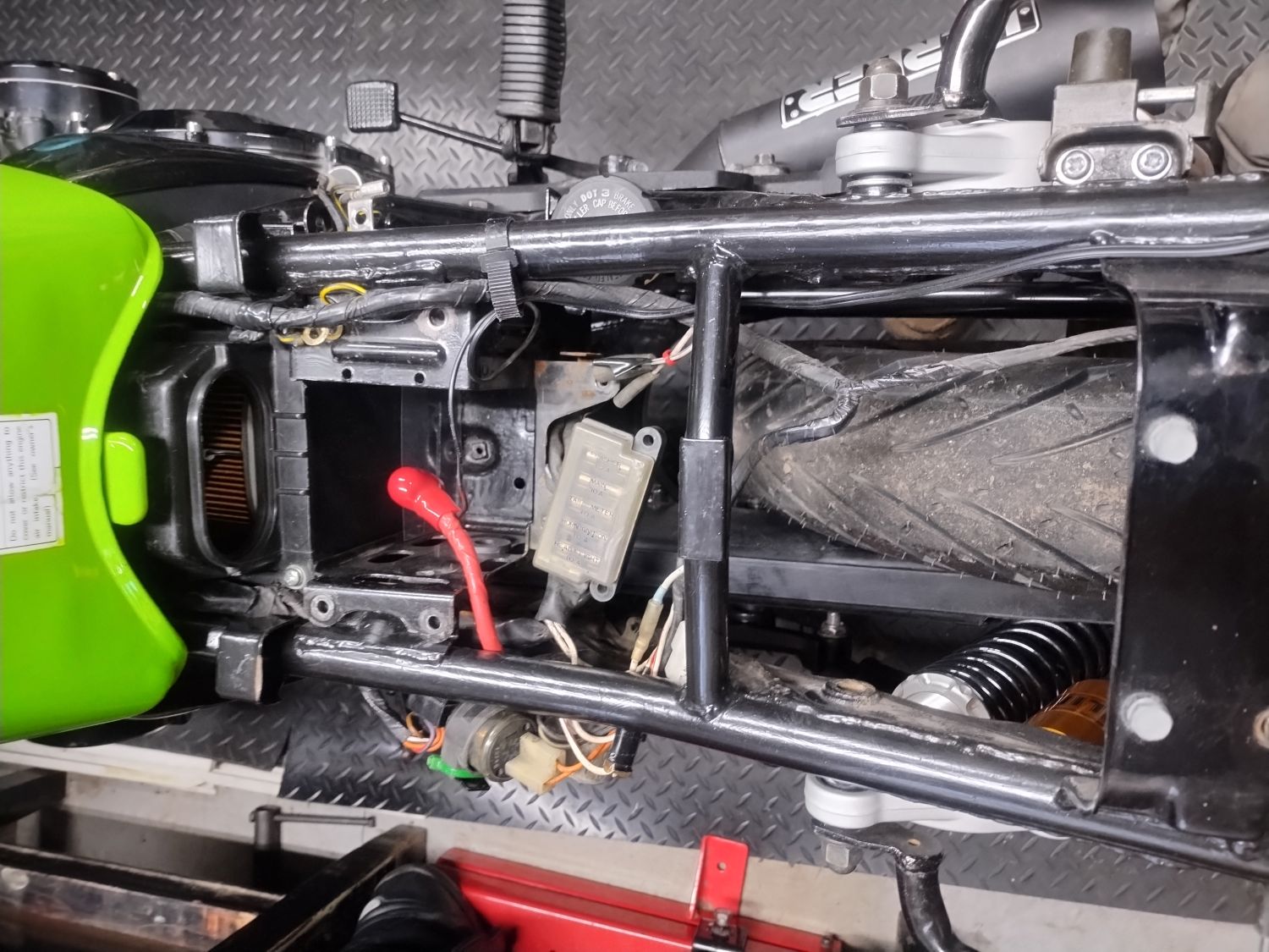

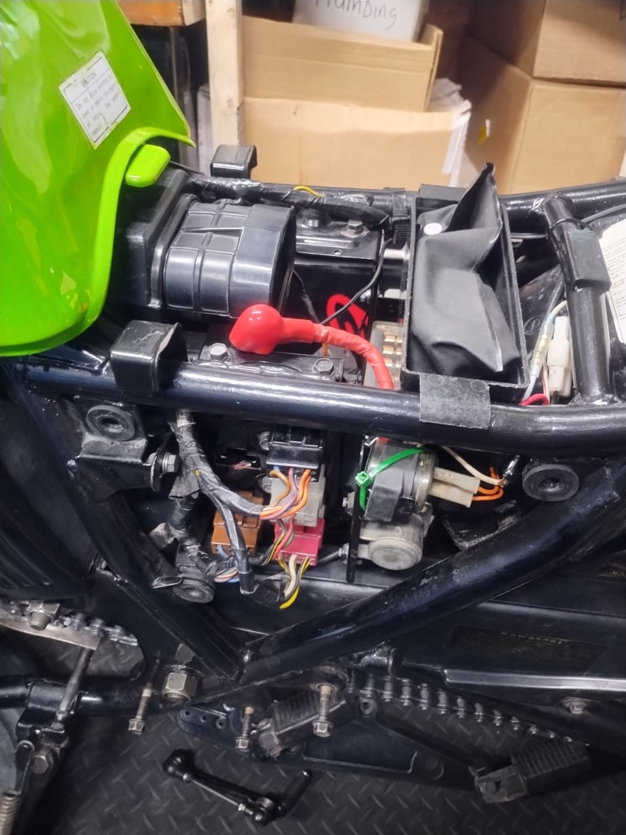

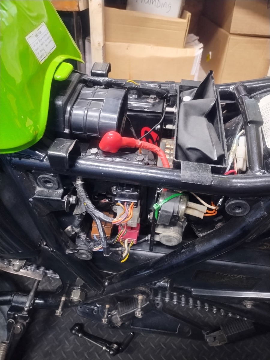

I have ordered a new R/R, so have proceeded to remove the one on the bike.
A bit of a task, as it's buried under the battery box.
15 bolts later, and the battery box is loose, and the inner fender removed.
The R/R I removed, on the right, does not look anything like the stock one on the left.
The mounting holes don't line up, and the red plug has been spliced on.
I also removed the baffle from the Kerker exhaust, and removed some of the packing.
I think she will have a little more of a growl at lower RPMs now.
Also fixed the fender trimming, giving more of a radius, to the coner.
The cord on my rotary tool was stretched to it's limit the first time, not allowing finese.

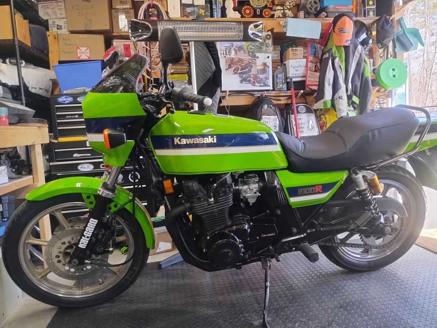

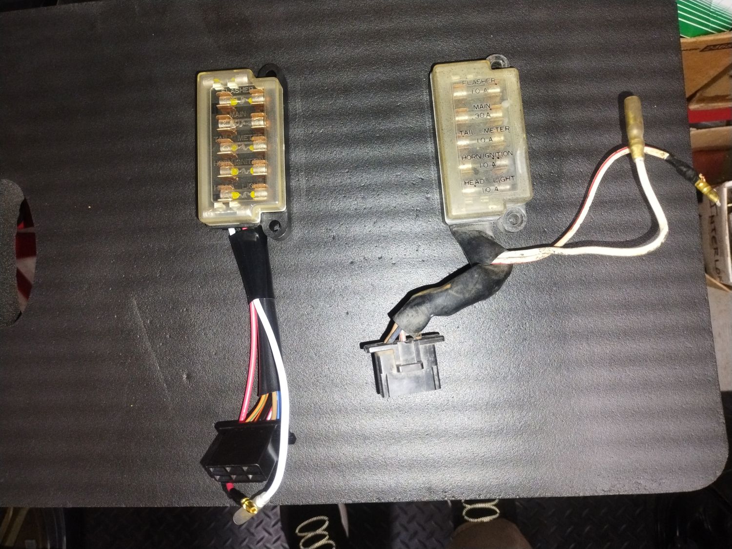

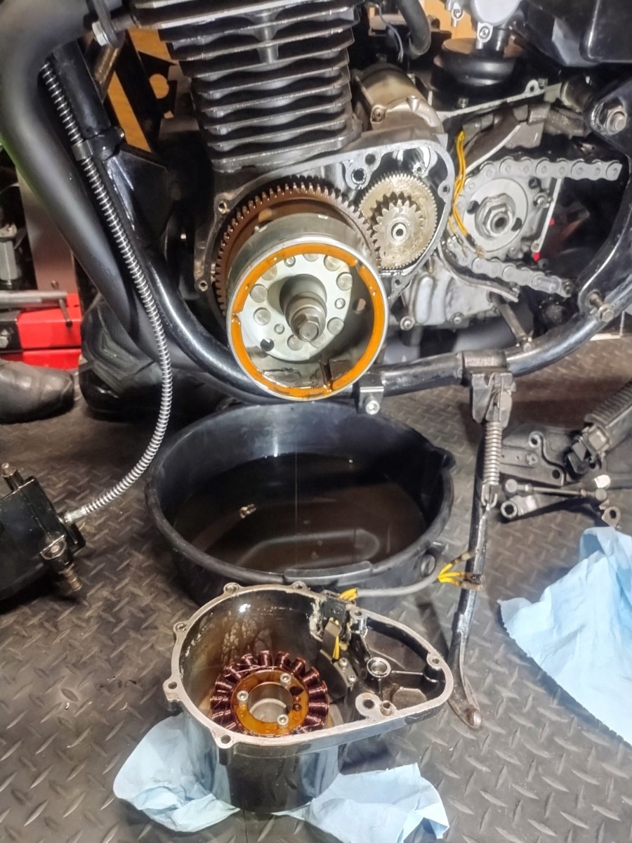

The long awaited OEM Fuse Box came in.
Installed, and electrical bits buttoned up.

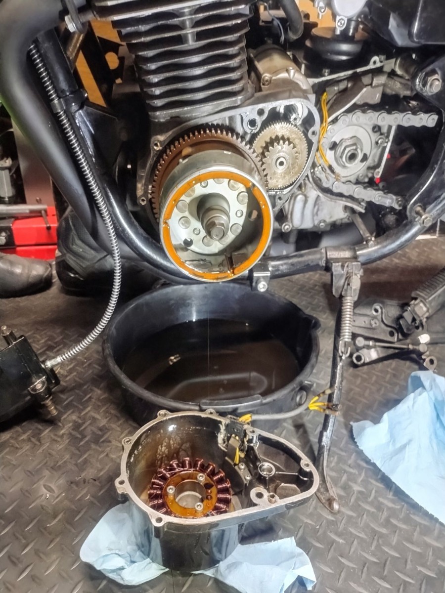

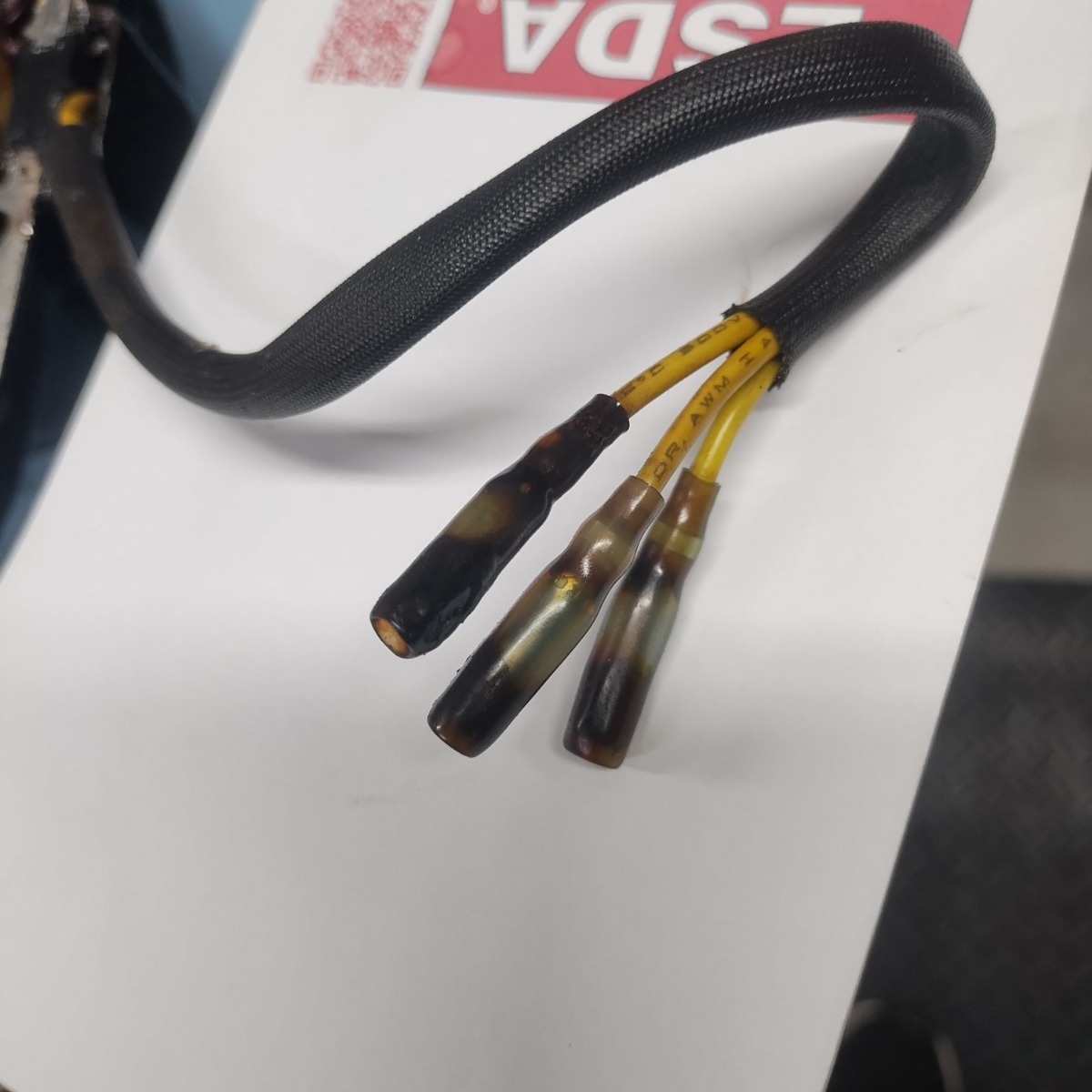

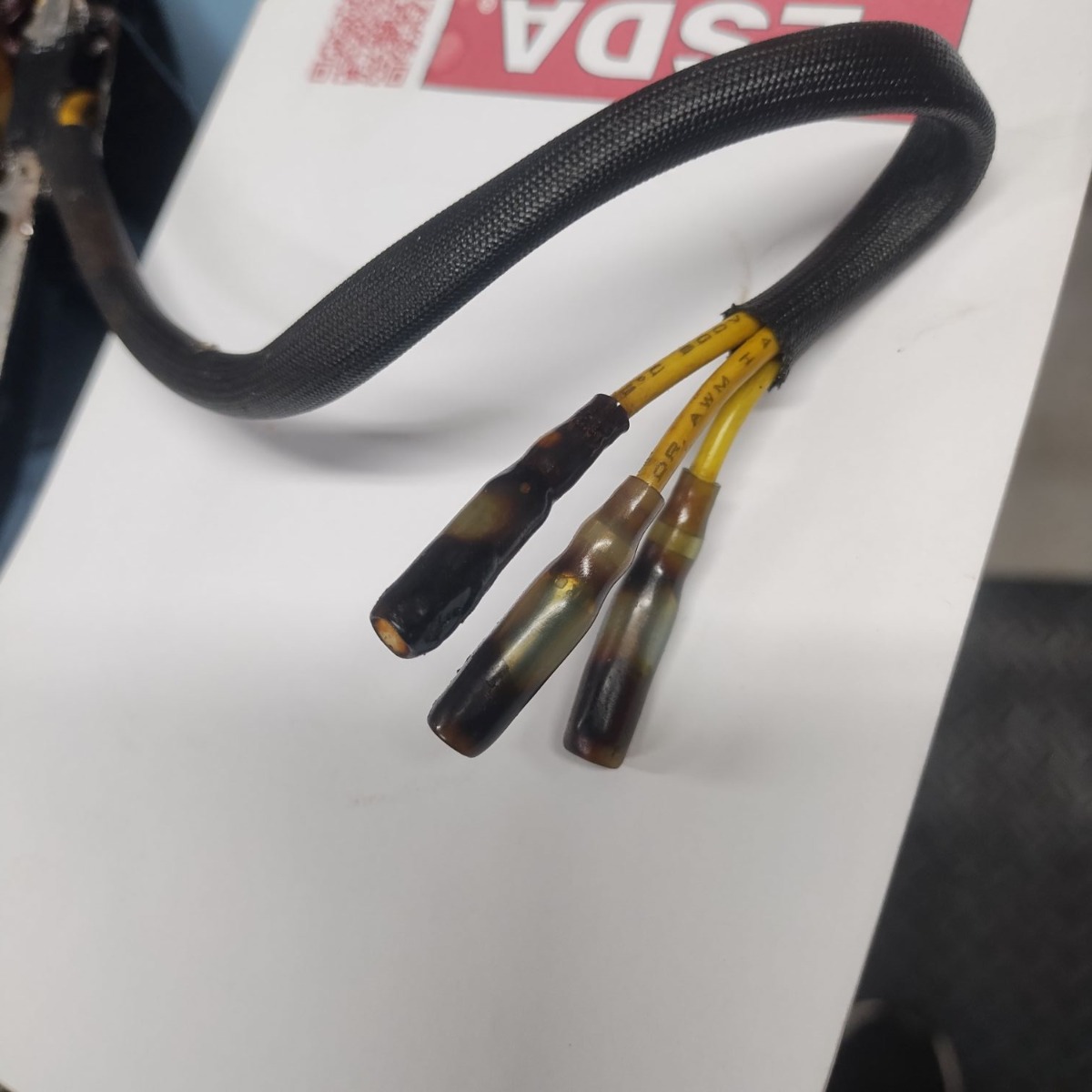

I ordered a new Stator while I was waiting.
The female plugs on it were well cooked.

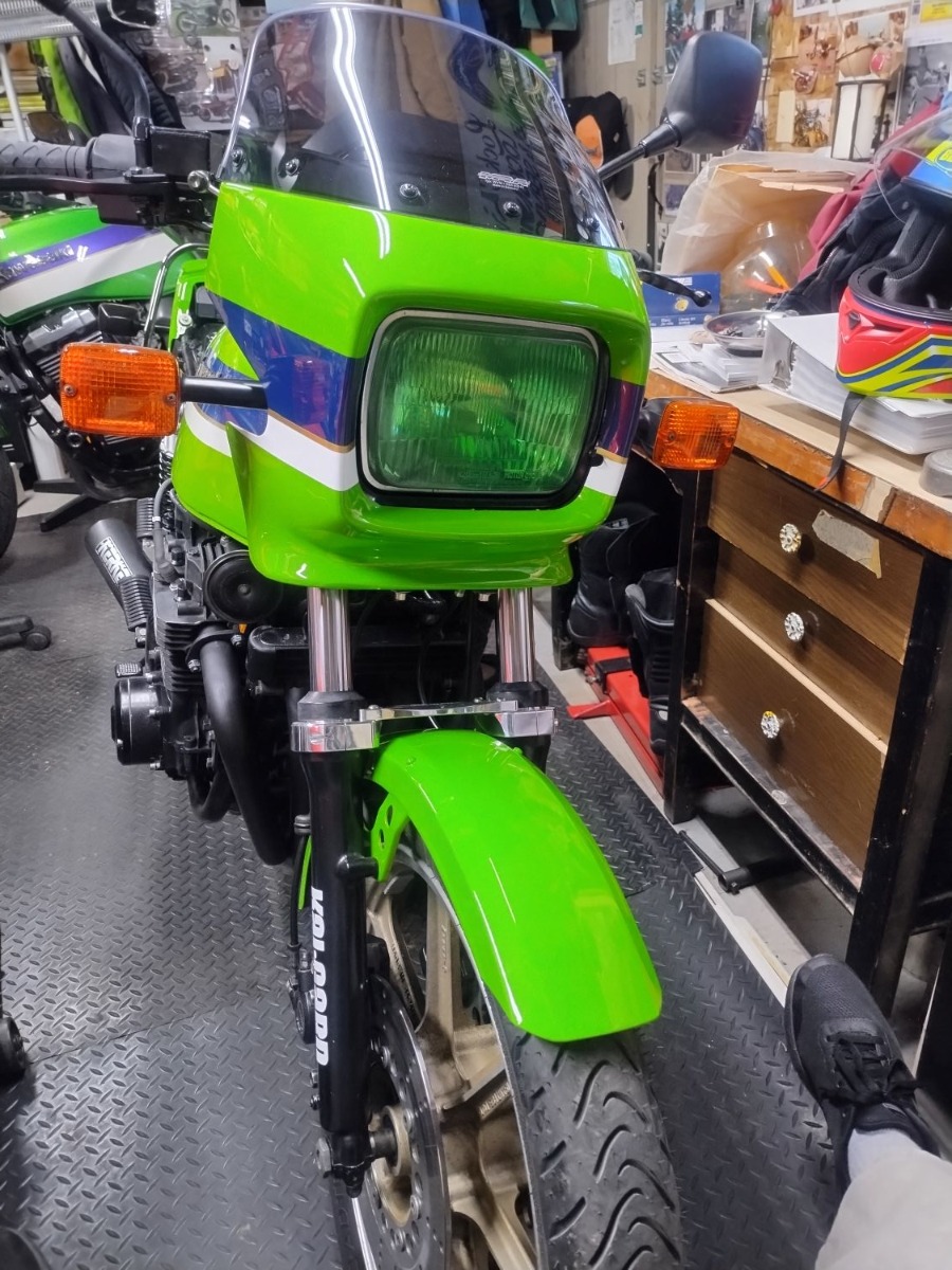

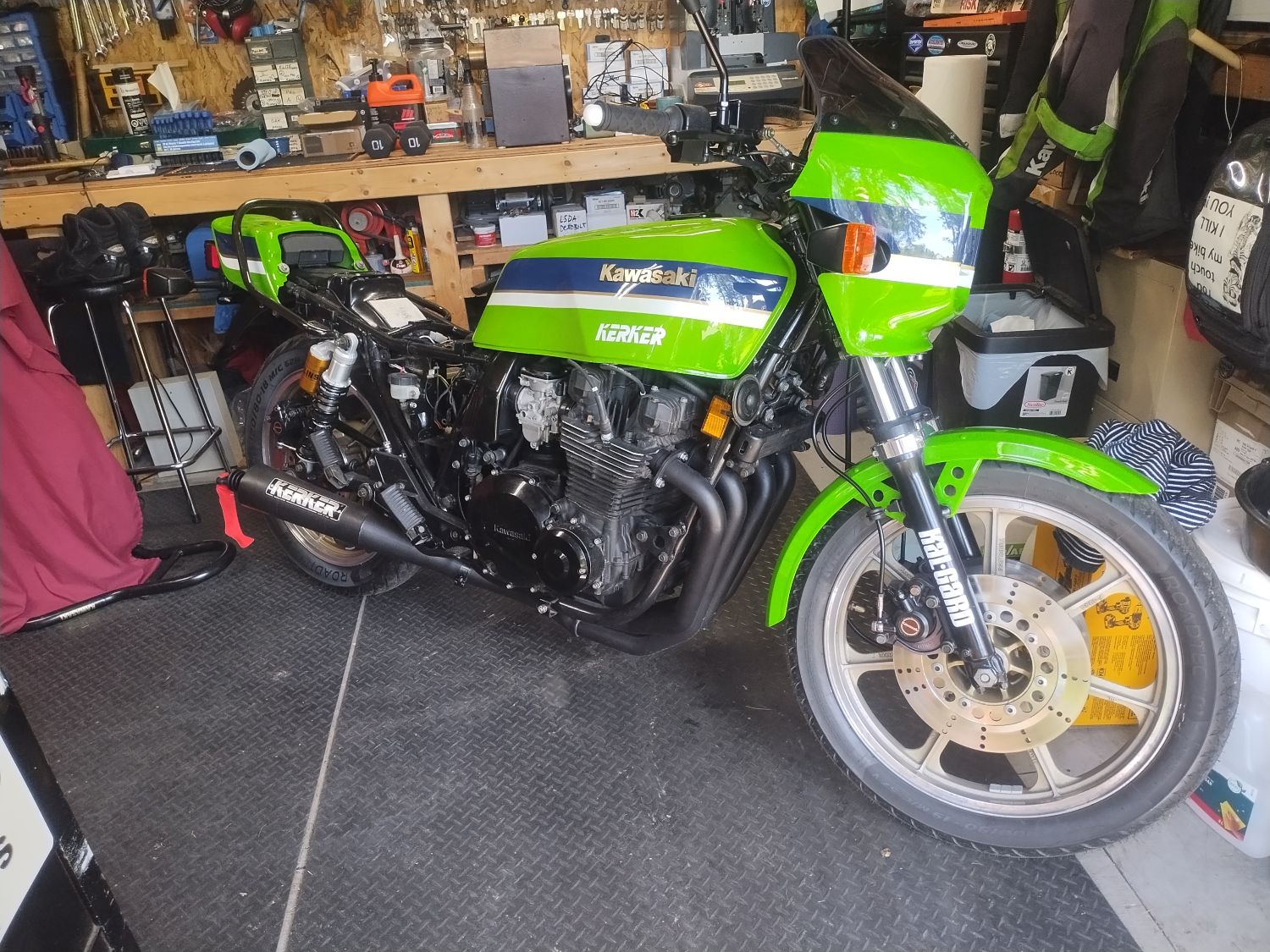

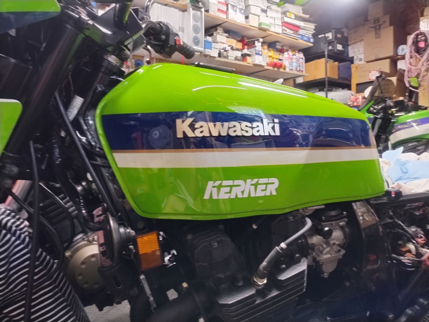

Added some go fast, Kerker decals, to the gas tank:

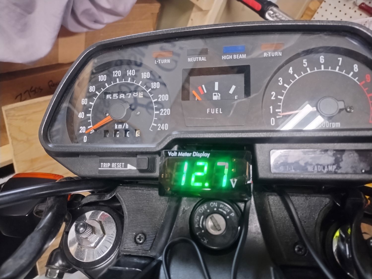

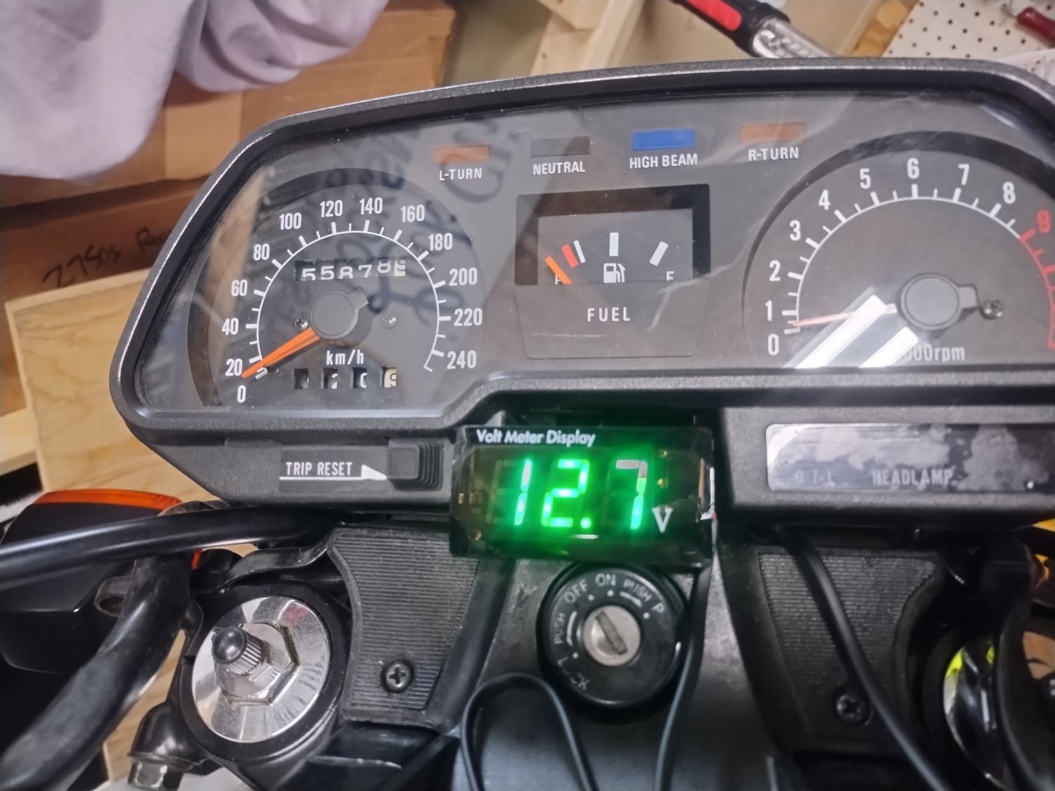

A Volt meter too, to monitor voltage.
