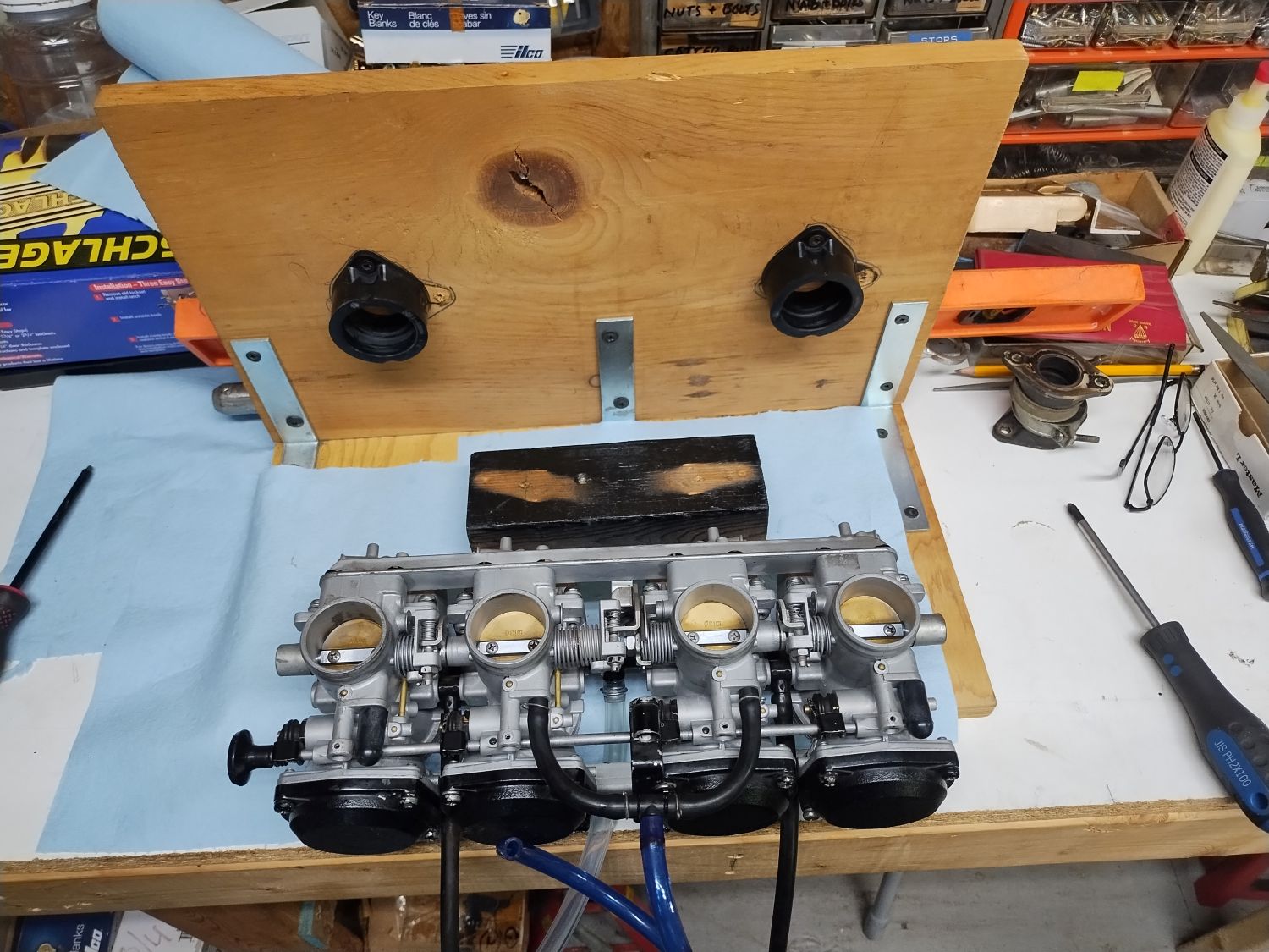

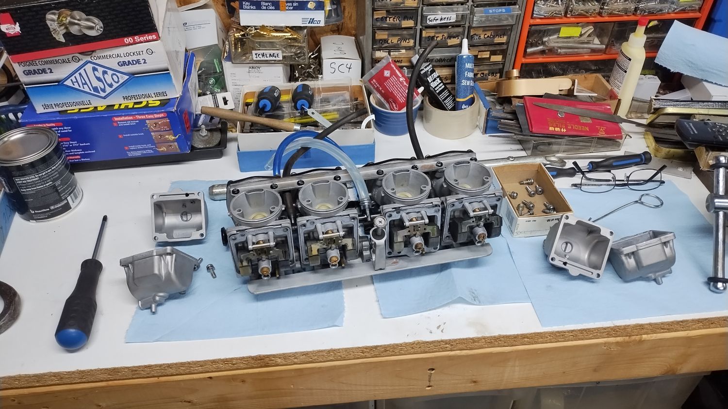

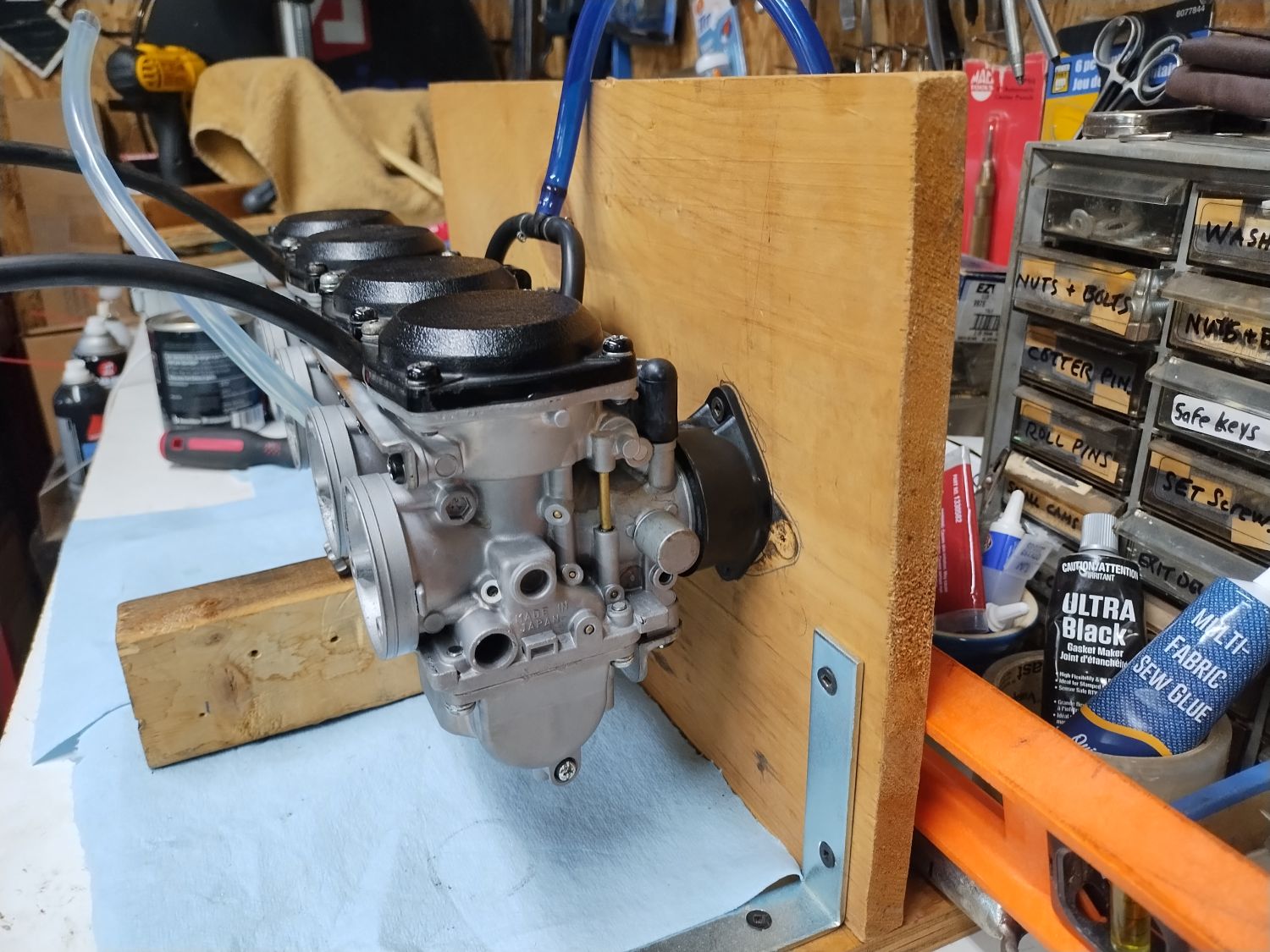

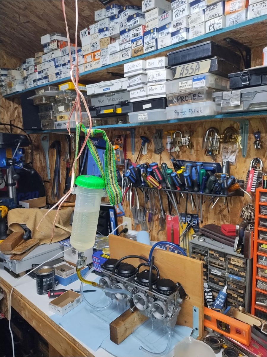

I had this carb stand set up for the KZ650 carbs.
Having some extra carb holders for these BS34 carbs, it's easy to set up the stand.
Add some gas, and as suspected, the fuel levels are high.
Adjust the tangs on the floats a little higher, and the fuel levels look better.

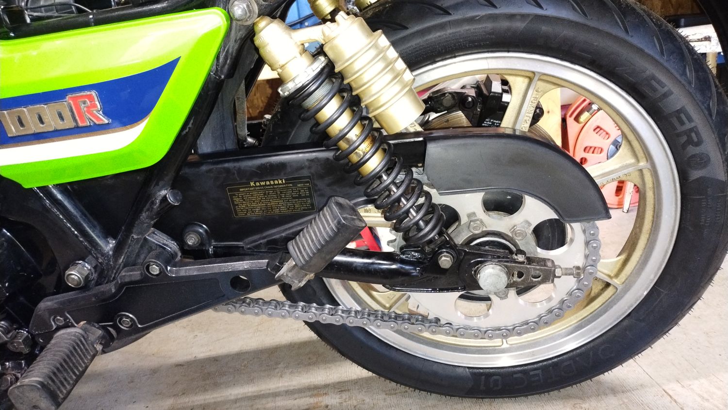

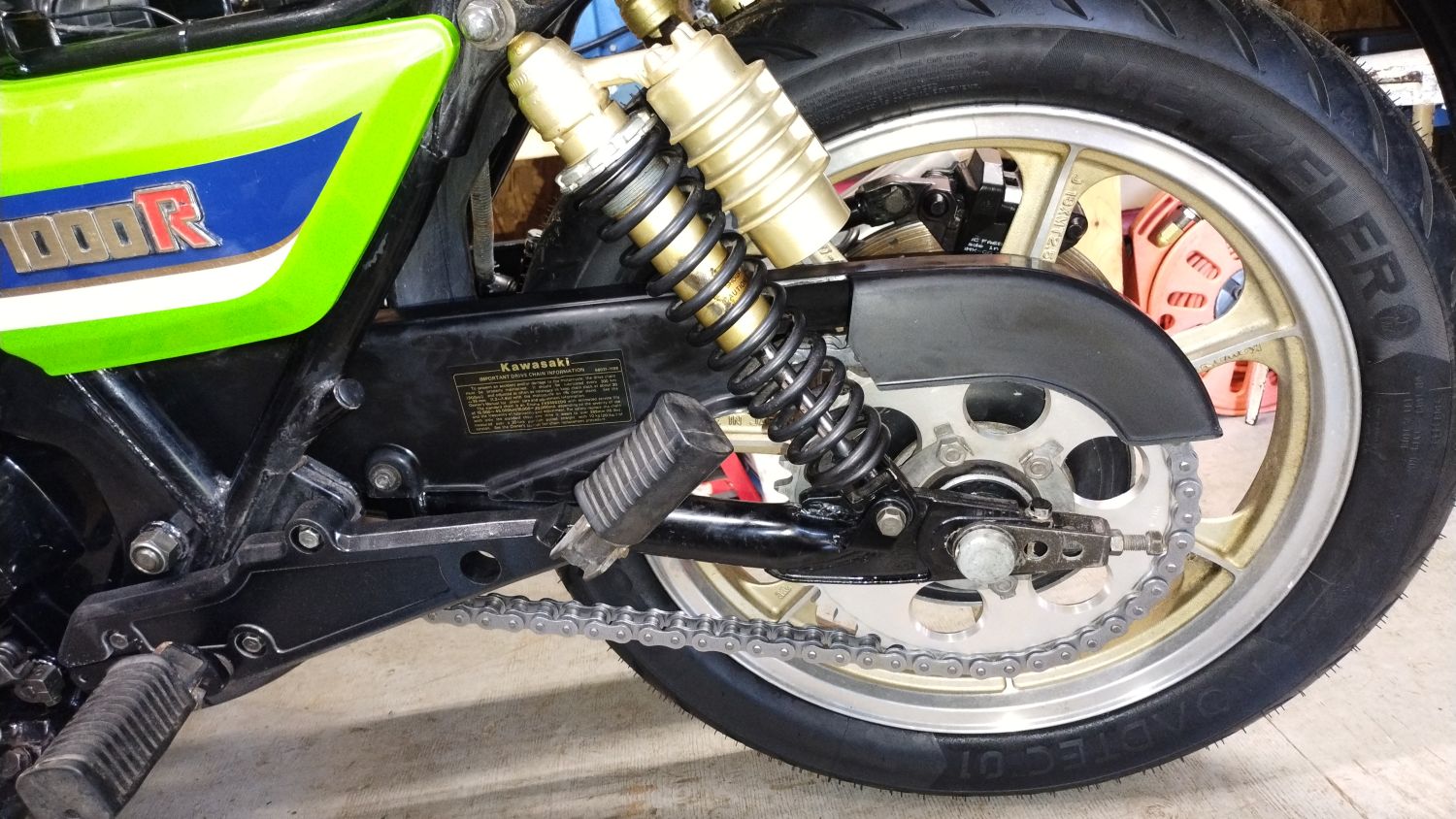

The test fire today didn't go any better.
The RPMs were high again, around 4000 RPMs.
Putting my hand over the air intake slowed her down.
Pulling the choke would make her die.
I pulled the carbs again, after checking the fuel levels while the carbs were on the bike.
3&4's levels were high.
Adjusted again, and reinstalled.
Test fire tomorrow.
I bought a chain guard and dash off Jay from California.
Unobtainable anywhere else.
My dash was broken around the mounts, and the bolts did not fit anymore.

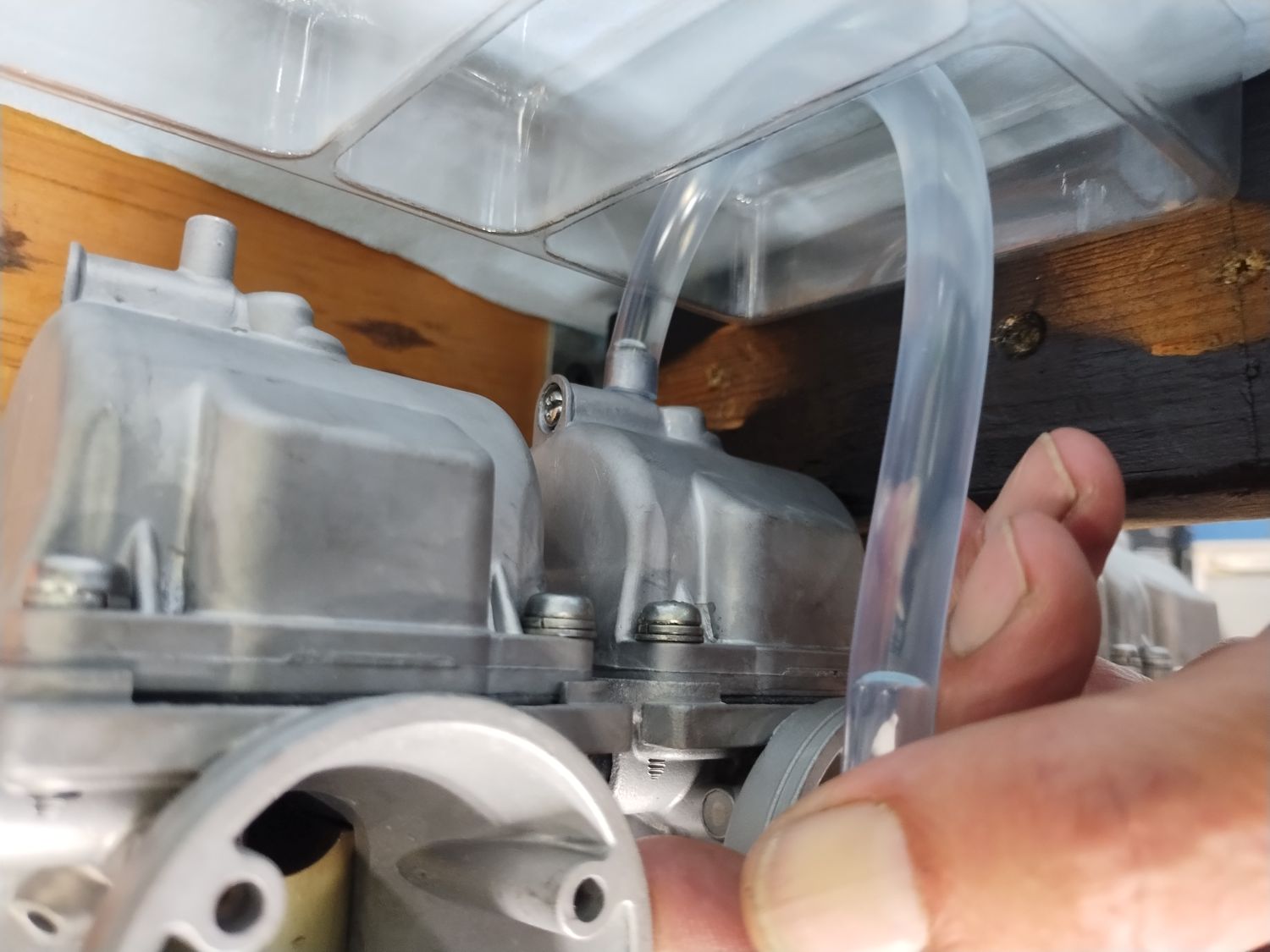

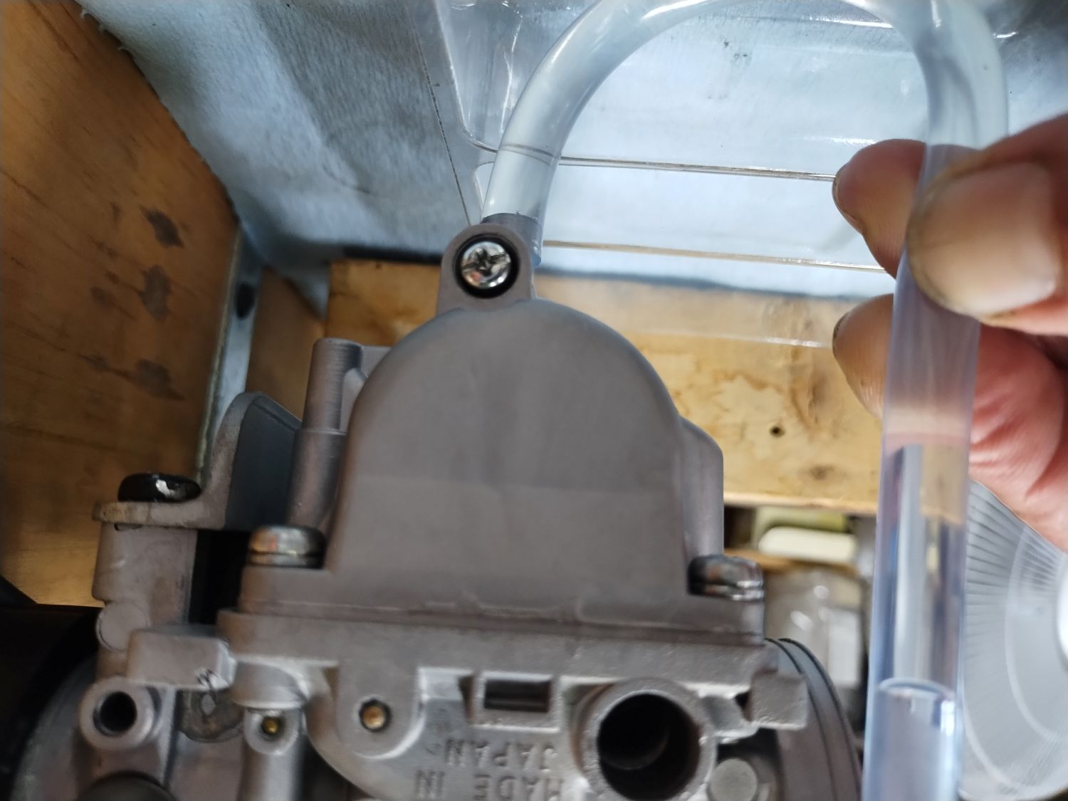

I had sent the carbs off to a friend's, Steve.
He had a look at them.
I picked them up today at his place:
He said they looked good.
He got them to stop overflowing.
Using the spec measurement of 18.6mm, he set the float heights.
Basically bending the float tangs more, in the direction I was going.

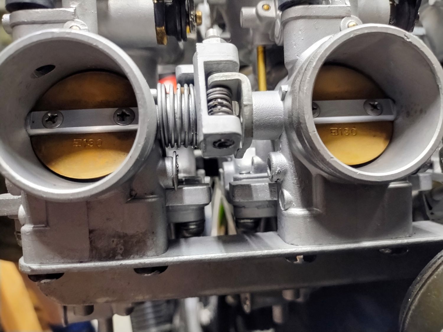

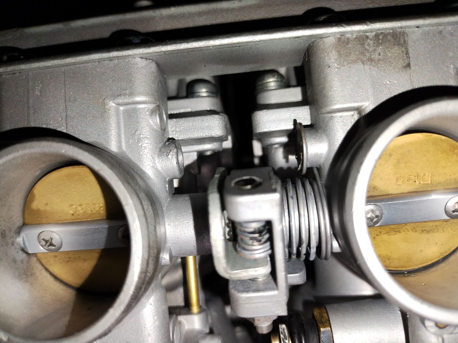

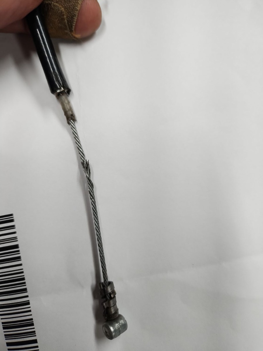

He did say to me, make sure the butterflys are closing, that you hear them shut.
Sure enough, as I was installing the carbs, I checked the throttle return and the butterflys were not closing.
In my attempt to shorten the outter sheathing of the cable, I nicked the cable.
I do have the old cable.
It'll have to wait until tomorrow...

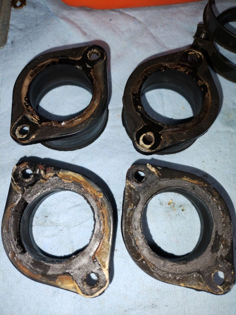

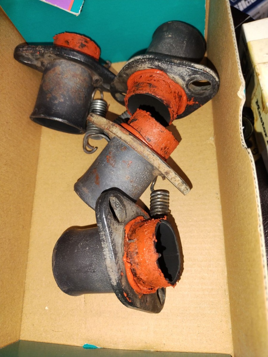

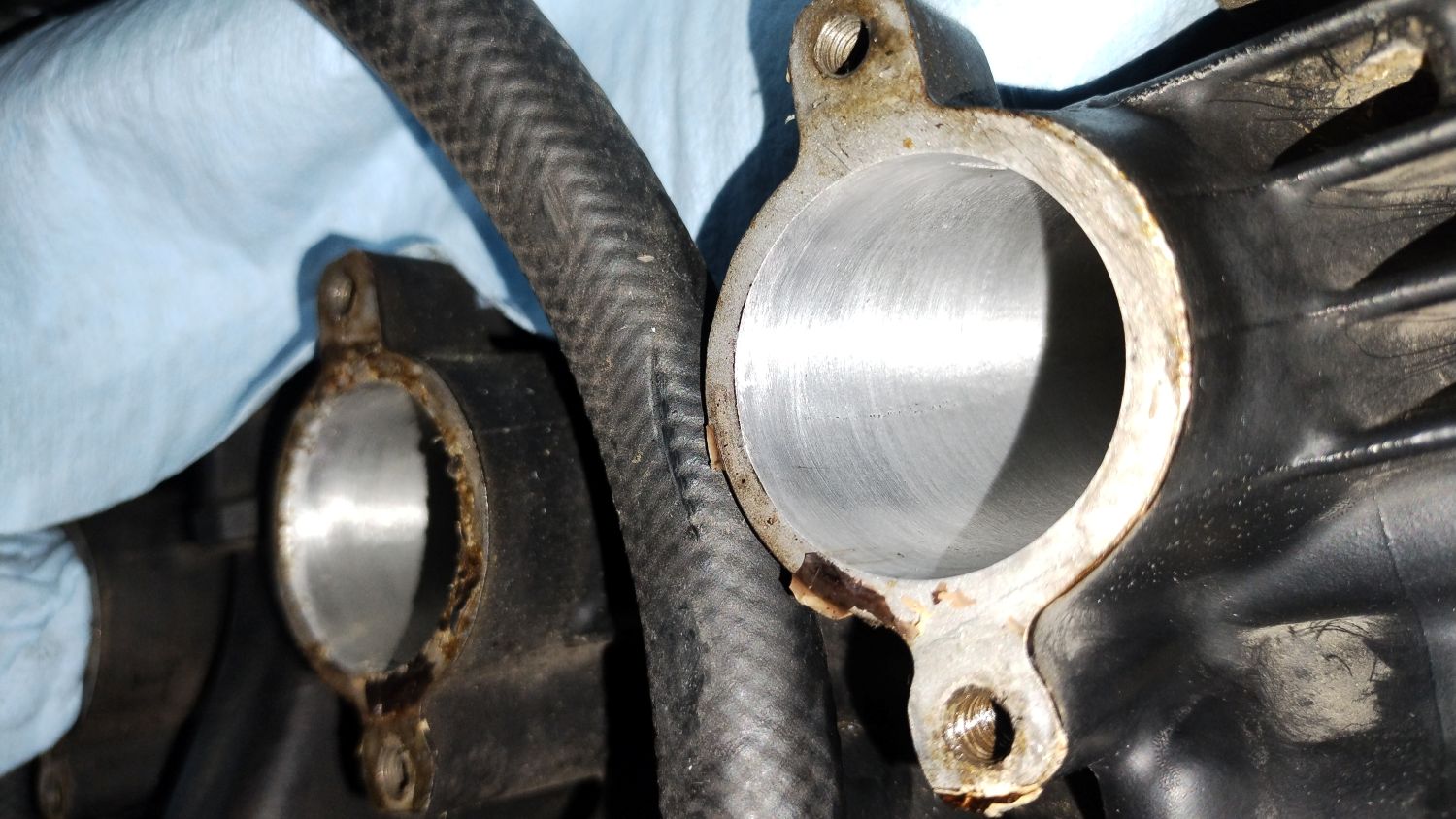

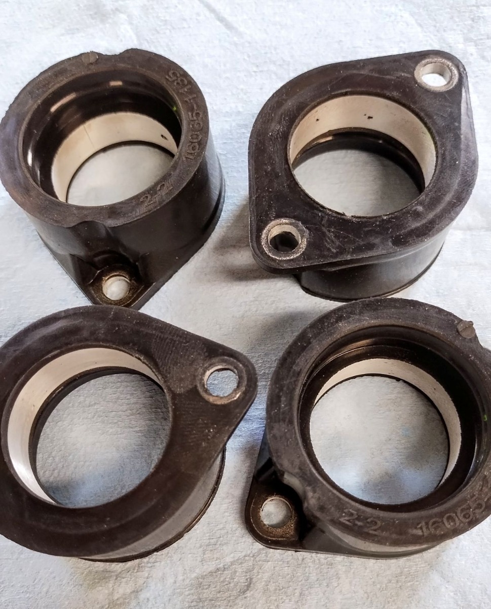

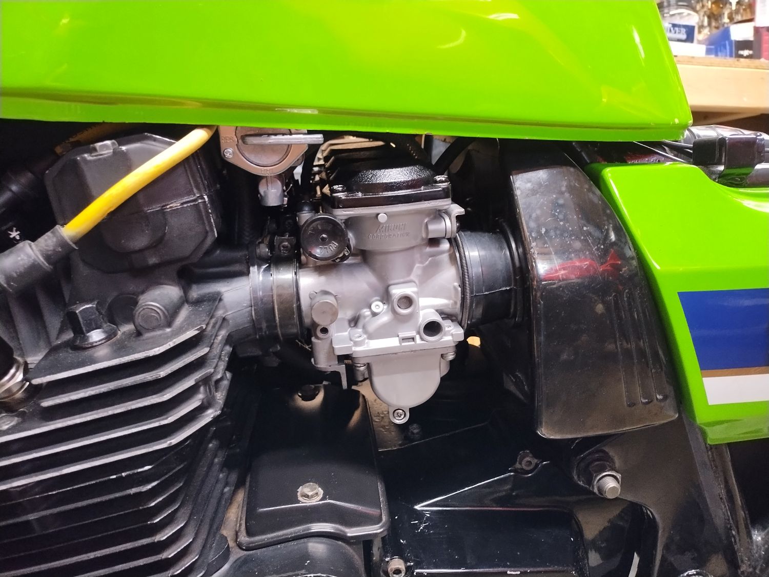

Still had some running issues, so off come the carbs again.
Going to have a look at the carb holders to cylinder head seal...
Seems they were not in the best of shape.
I had bought two new sets of carb holders, but the inside diameter was only 30mm on them, instead of 34mm.
My local dealer said he could have the holders enlarged.
Picked them up, and reinstalled them with sealant:

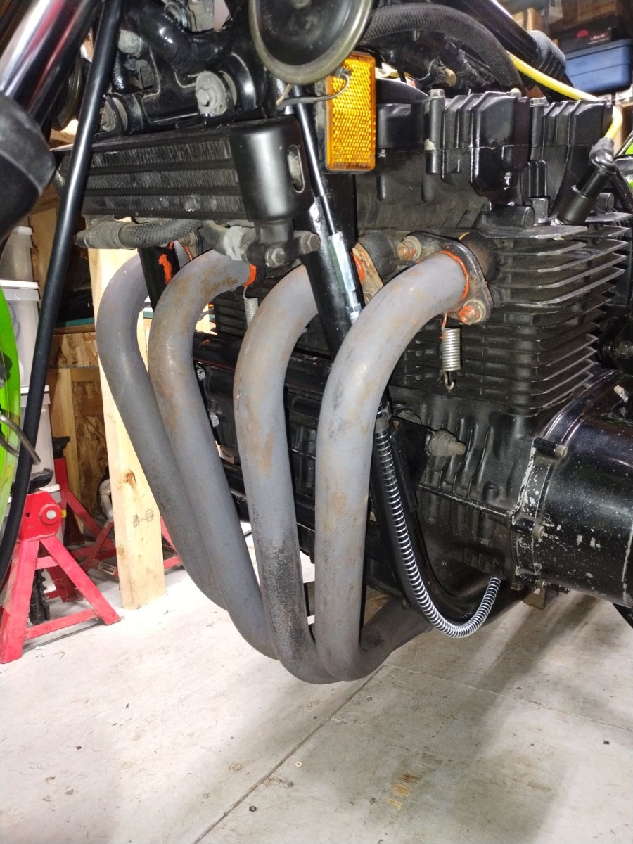

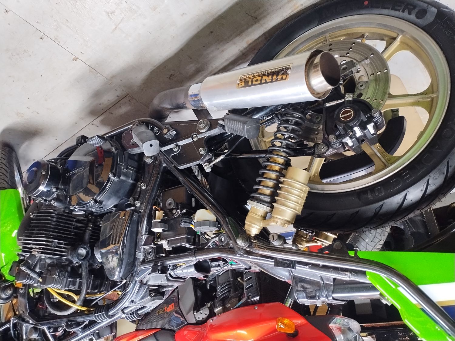

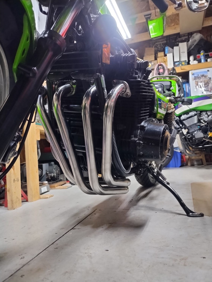

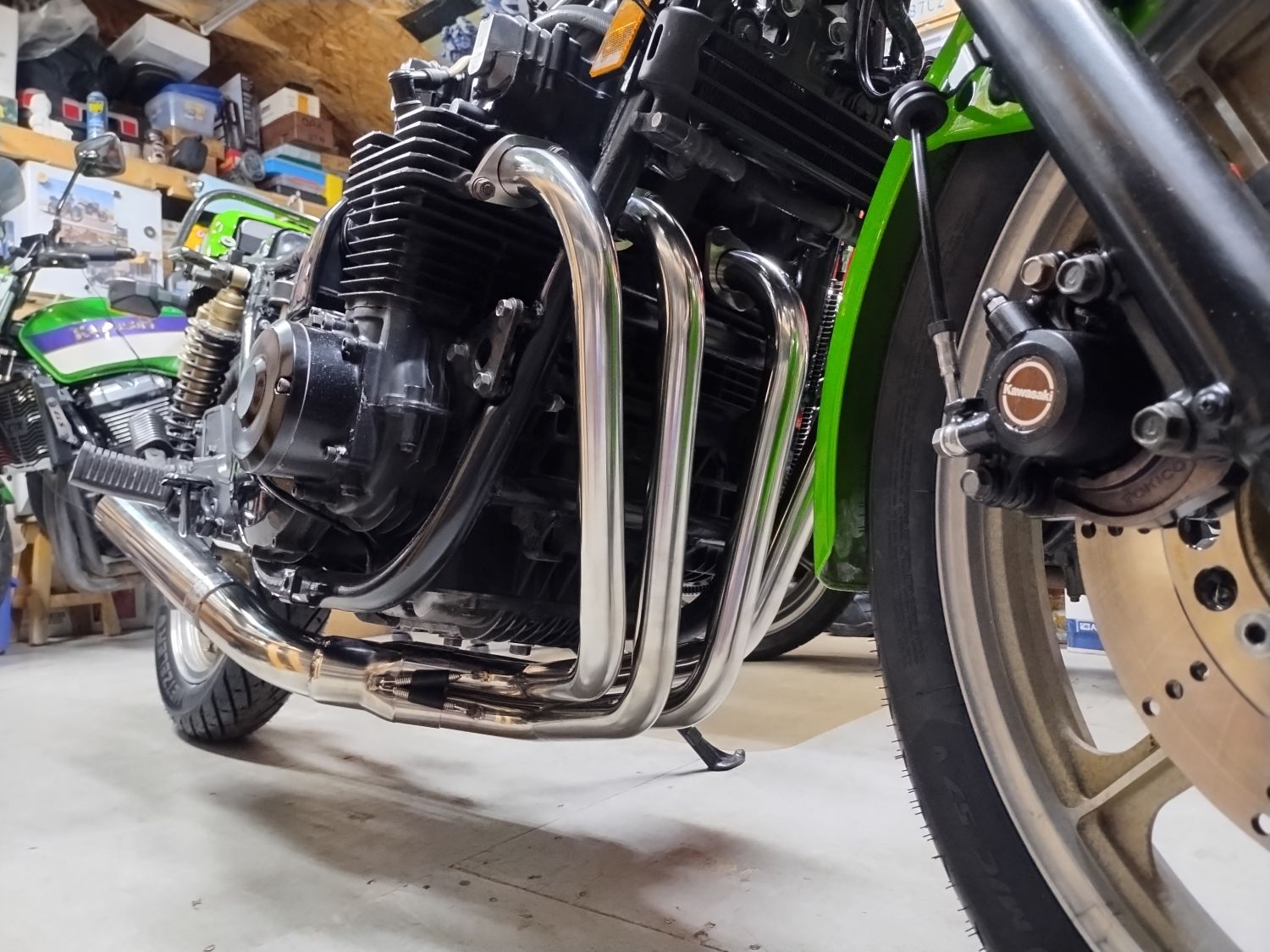

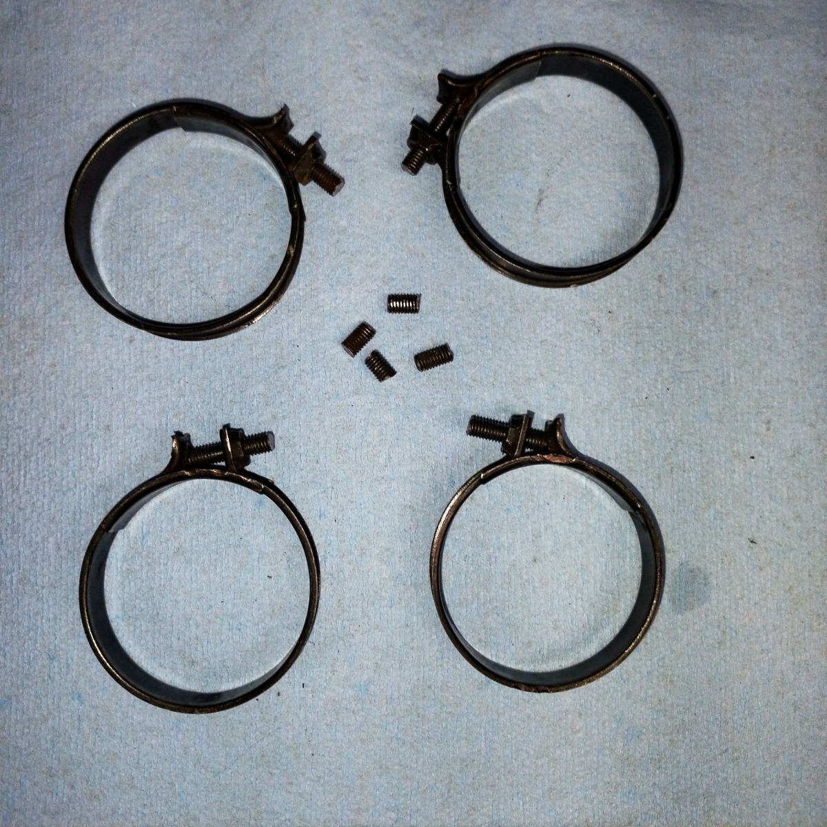

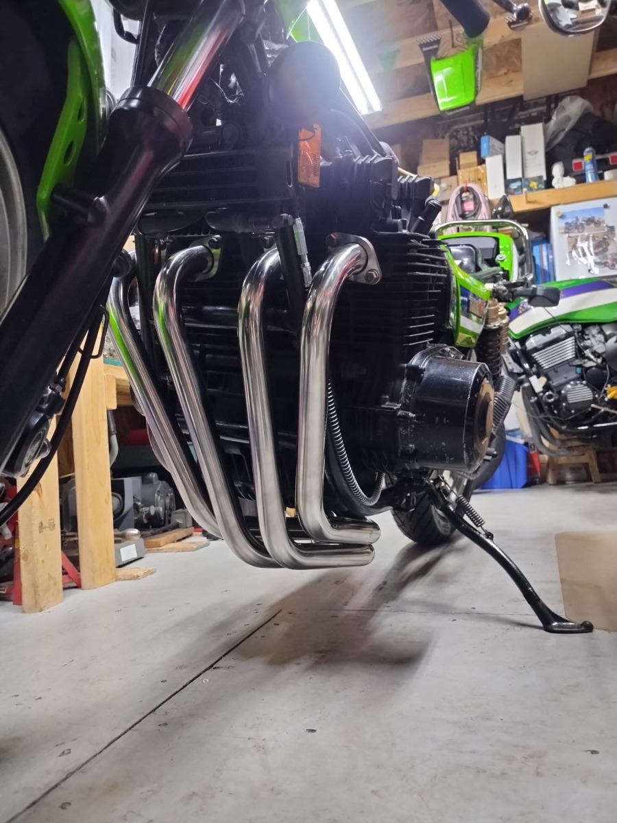

The Hindle exhaust that came with the bike did not look that great.
I spotted a new Delkevic Stainless steel one for sale on Ebay for $399 US$, that I couldn't resist.
I have had the same style Delkevic on my 1978 KZ650 for over 10 years,
Great exhaust.
Will not miss these:
Great exhaust.

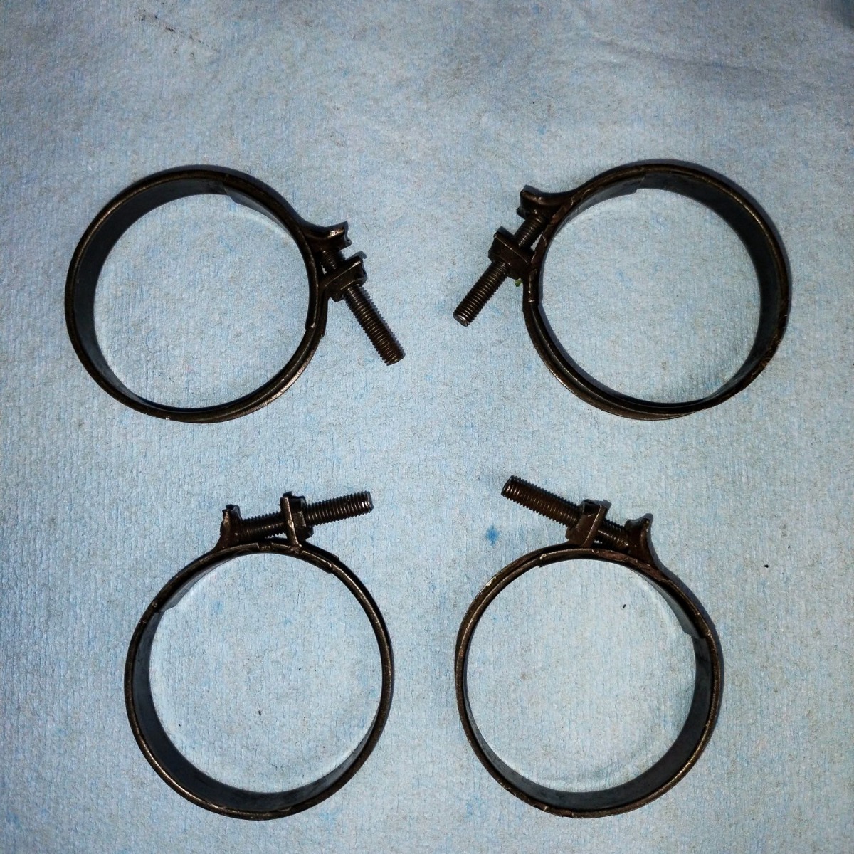

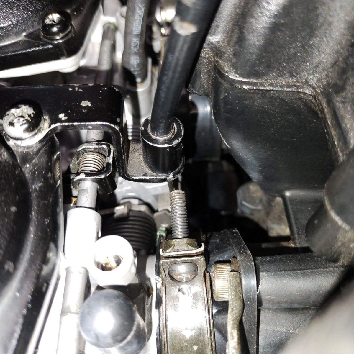

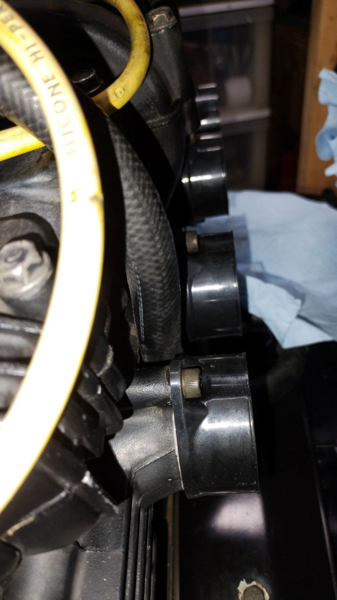

Each time I reinstall the carbs, the carb holder clamp bolts butt up to something.
Mainly the #3 carb clamp, comes awefully close to the throttle cable holder.
So I shortened each bolt a little.
Now some clearance to the throttle cable:
Carbs back in, tank on.
New Kawasaki petcock too.
All put back together, and test fire:
