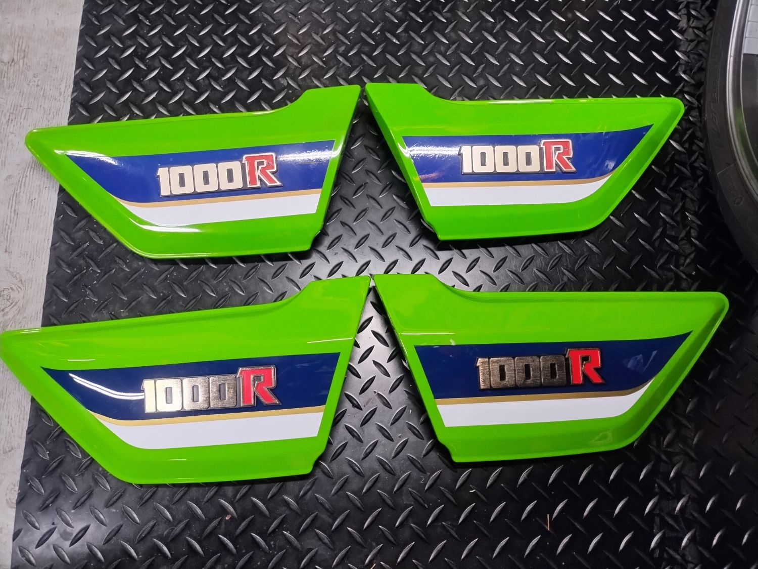

I had a look at the side cover badges today.
They are aftermarket, looking different than stock.
The covers are GPz, so it wasn't a surprise to me that the holes in the side covers, and posts on the badges, didn't line up.
I had to drill a new hole and file the other, on both side covers.
I'm waiting on speed nuts, they will be straightened, and attached, bottom.

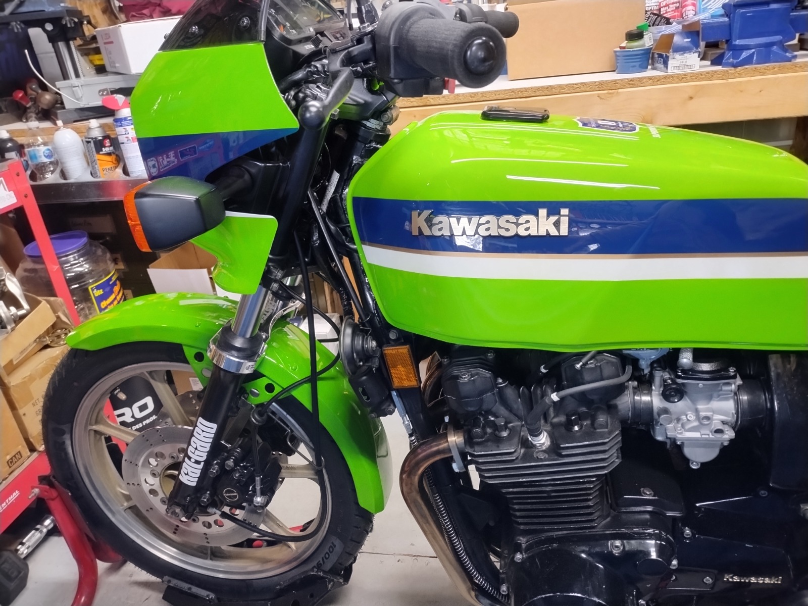

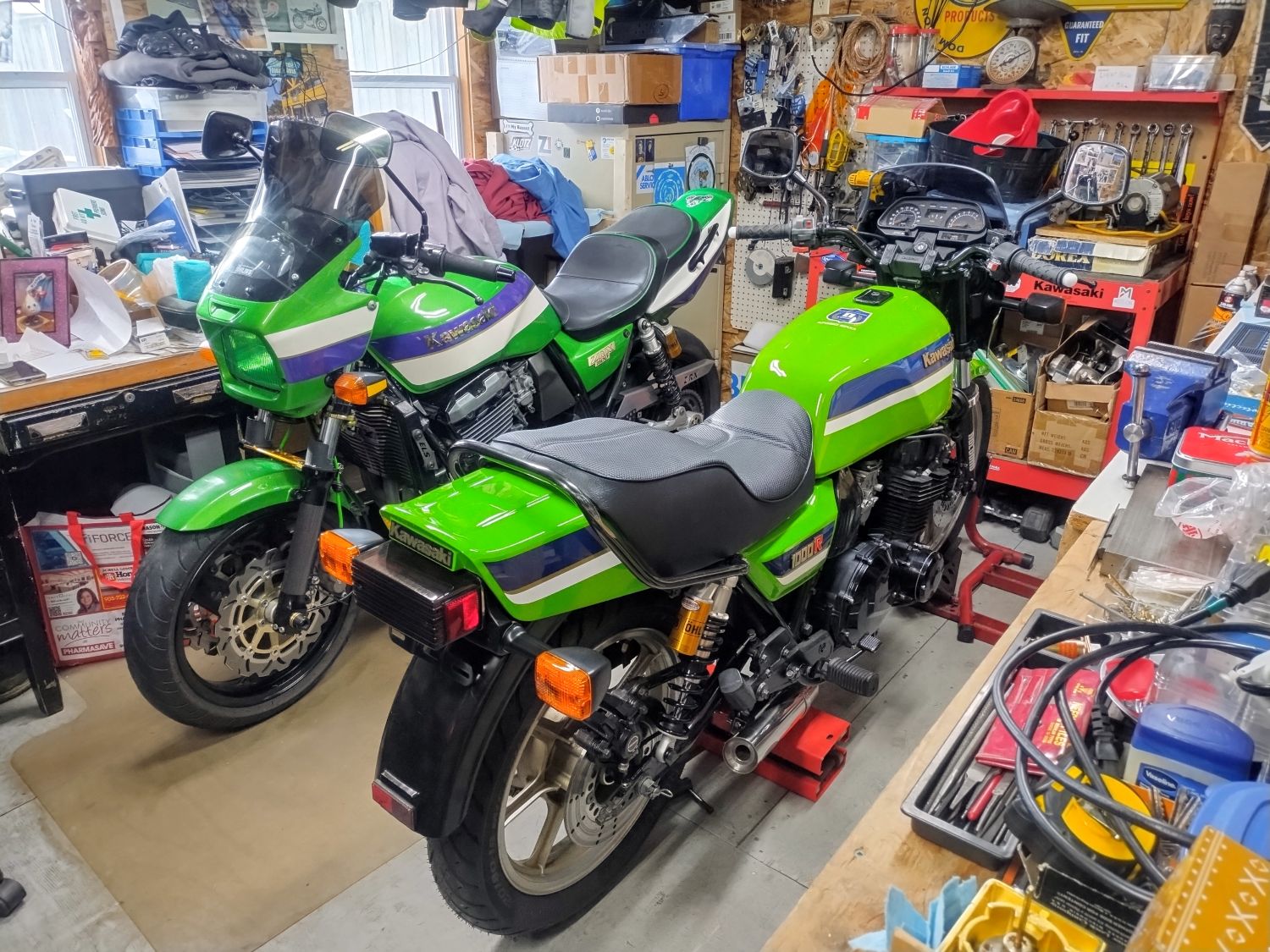

The GPz tank got a cleaning with Vinegar.
It's better, but not clean enough.
Since the original tank got a restore and looks great inside and out, I will be using it.
Tank badgfes back on, and pieces test fitted.

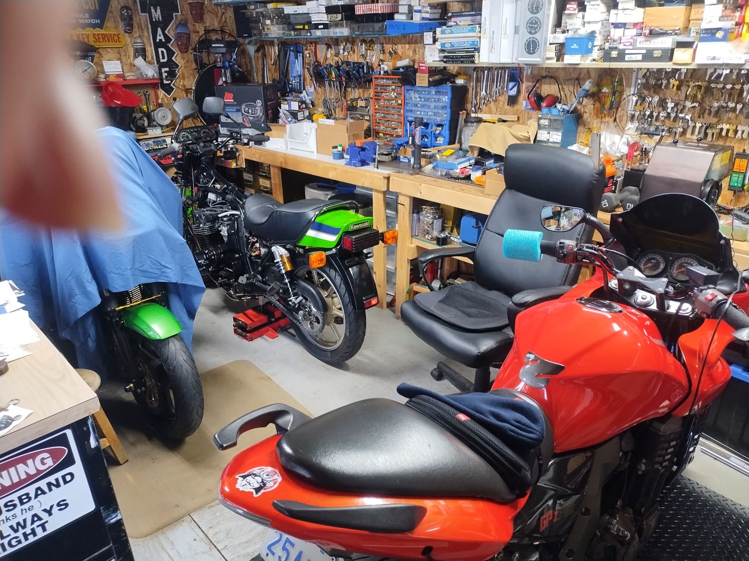

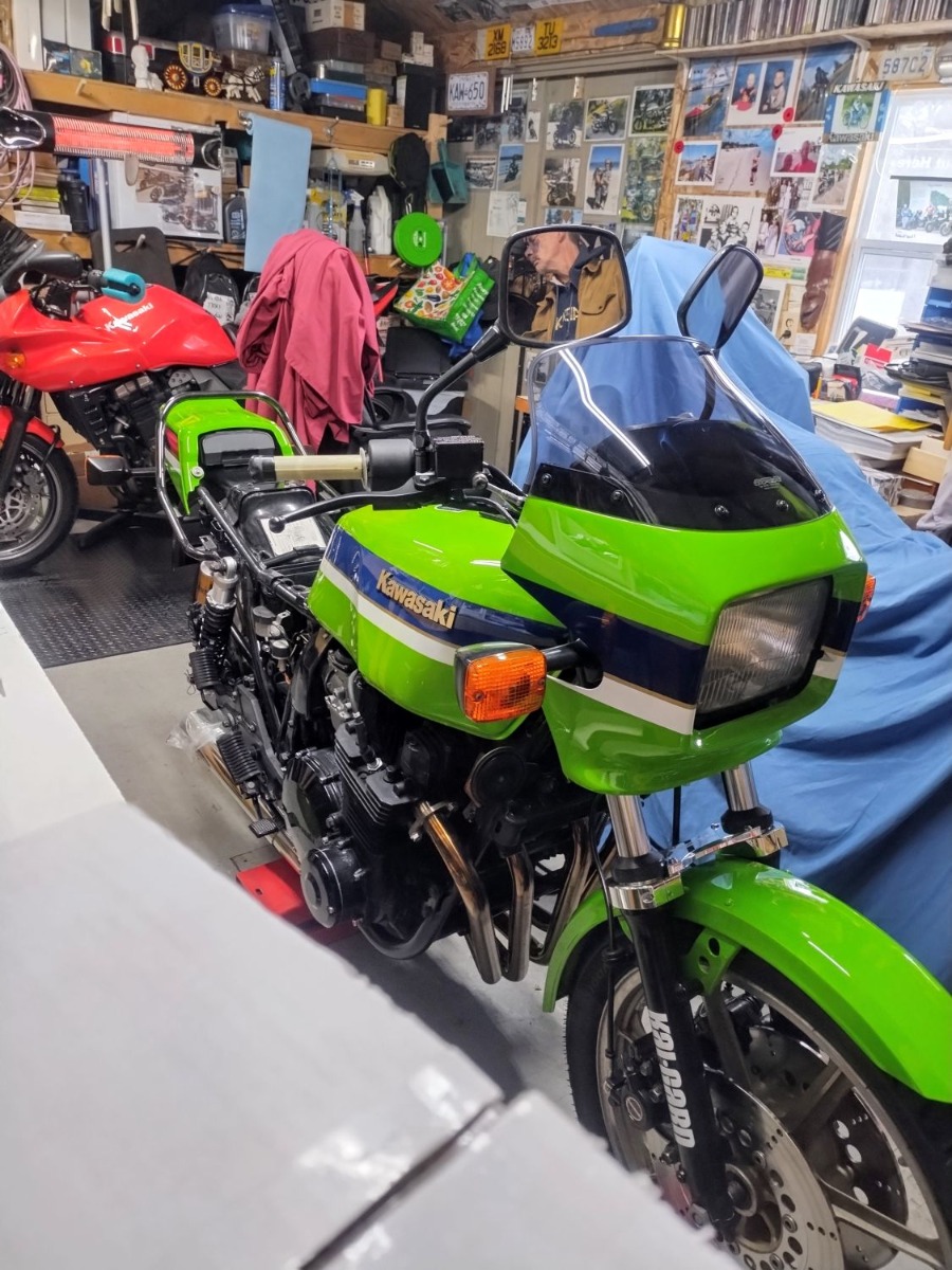

Your R2 looks great but your shop is as interesting. I also have to share my space, mine with wood working. The dust can be a real challenge.

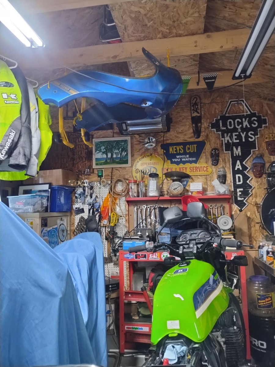

My Workshop is also my work office Bill.
I'm self employed.
A Locksmith.
Used to have two store locations and 5 of us (family) working.
Now it's mainly me, and my Son I am training.
Some keys are hanging on the wall, and lots of others in boxes, including 100s of Skeleton keys.
I've got a number of key machines and equipment, from two stores and service vehicles.
The house has three women and three Grandkids, so I spend a lot of time in the Workshop.
I can listen to music, and either do my work or tinker on the bikes.
It is a little crowded.
I built another storage shed, 8x20, but it is getting full too.

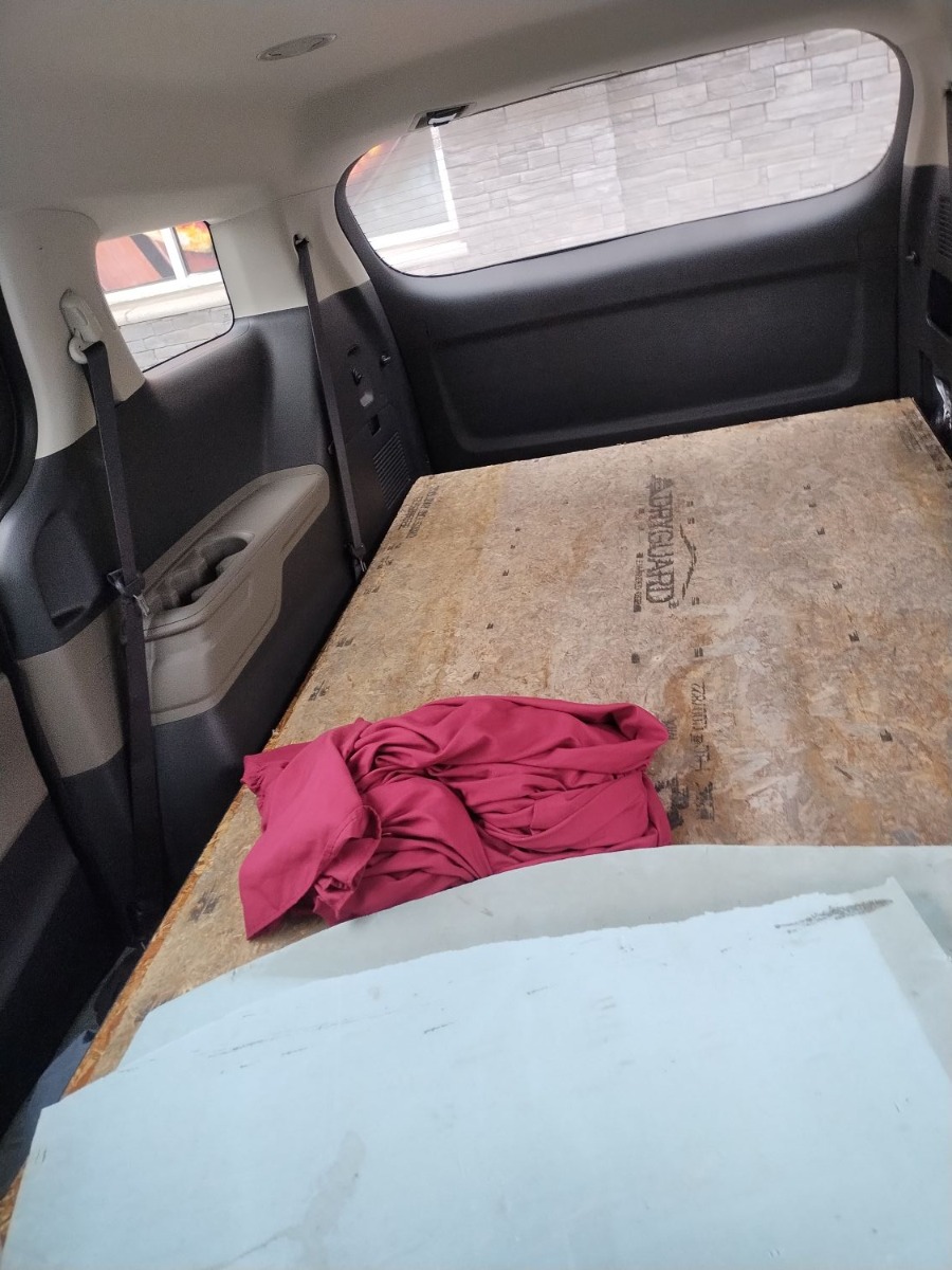

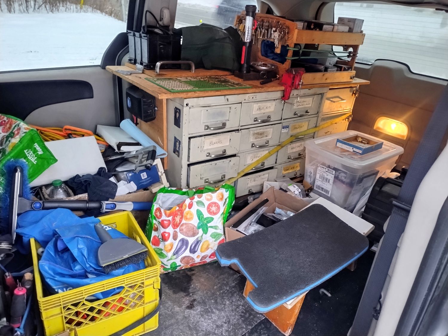

You being a wood worker Bill, maybe you could give me some tips on a project.
I need to build a work station for my new service van.
Basically a work bench, with some storage underneith.
And premade desk or benches seem to be too tall.
I need something a little lower, working in a mini van.
My current Dodge set up, a little messy and disorganized, but you can see how I've got a work bench.
The metal cabinet has had the bottom cut on an angle, as the floor is sloped. Then a piece of wood attached on top.

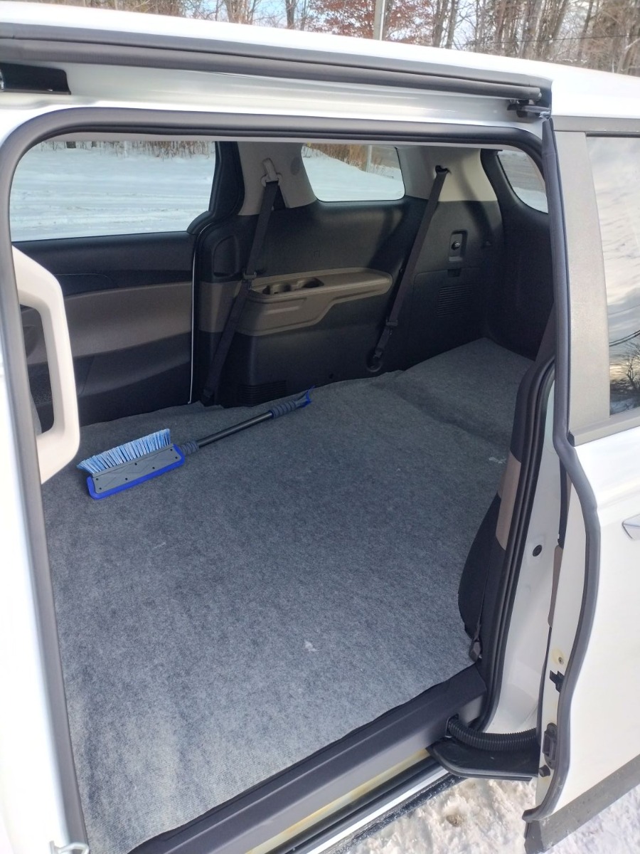

I bought a new KIa Carnival.
So it's a clean slate.
A 4x8 piece of plywood fits in the back:

Rob you may want to think about framing with alloy box section or angle. People often forget about the weight they are adding when fitting out vans and campers. If you aren’t careful you will exceed the axle weight before you put any kit in there.

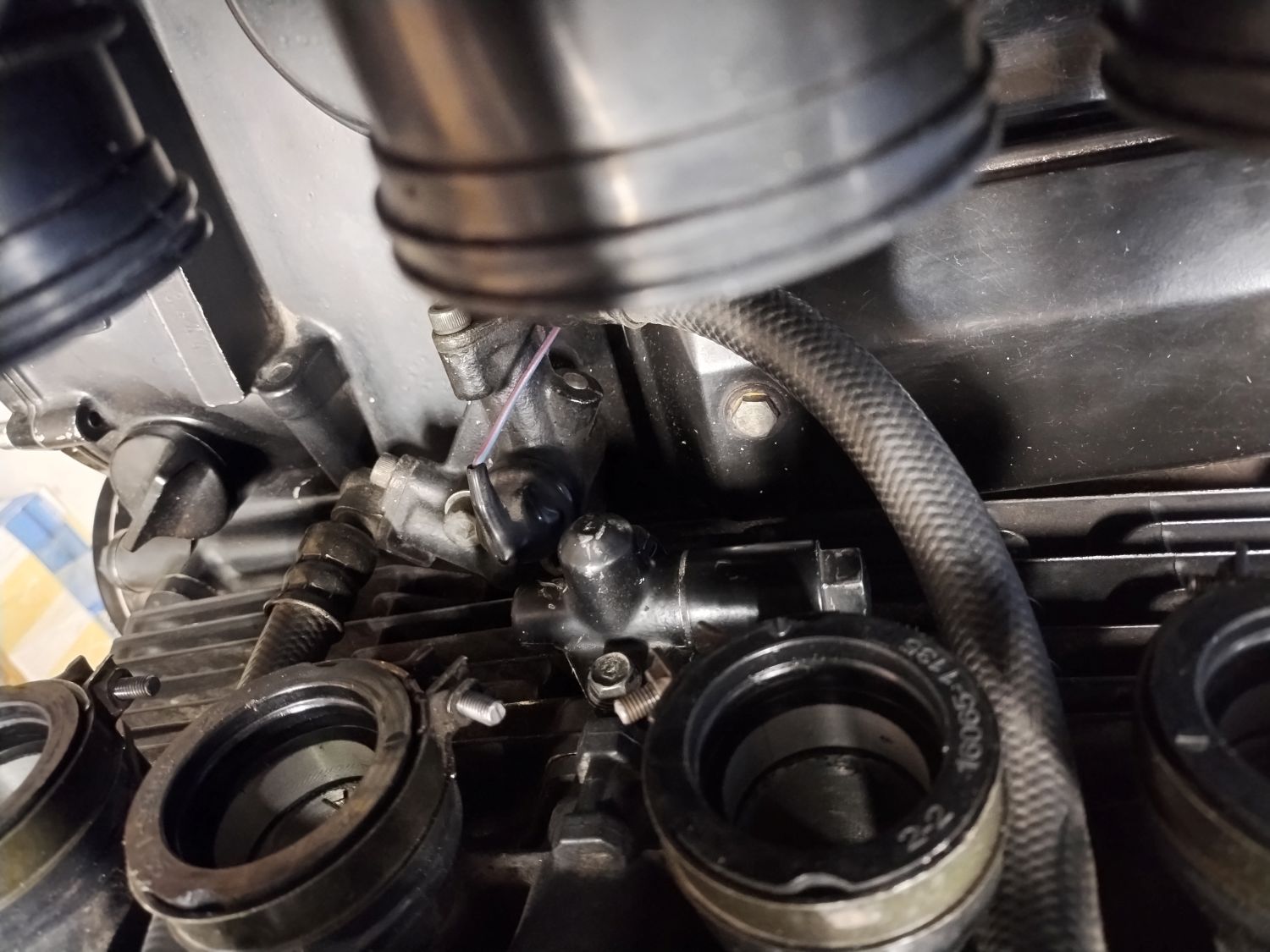

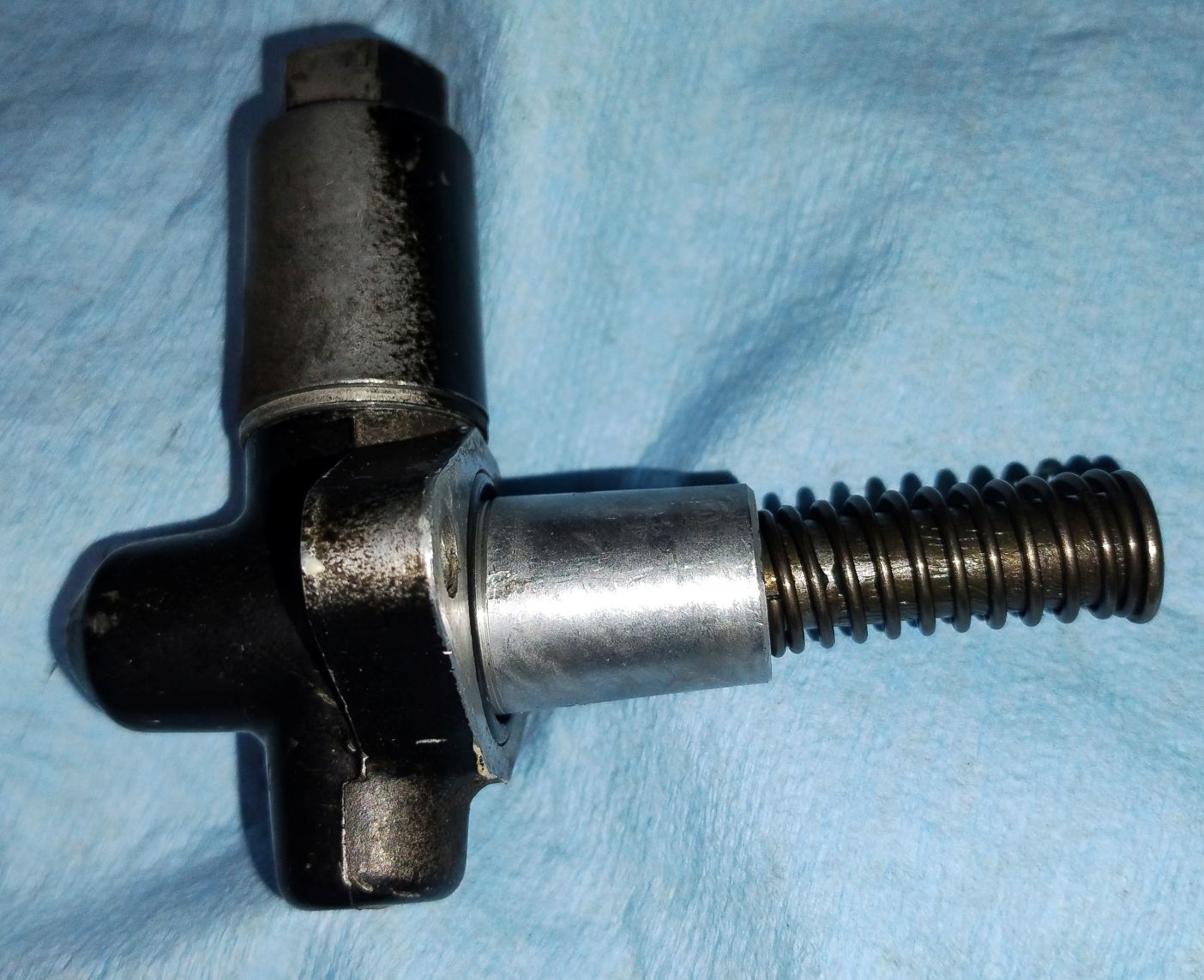

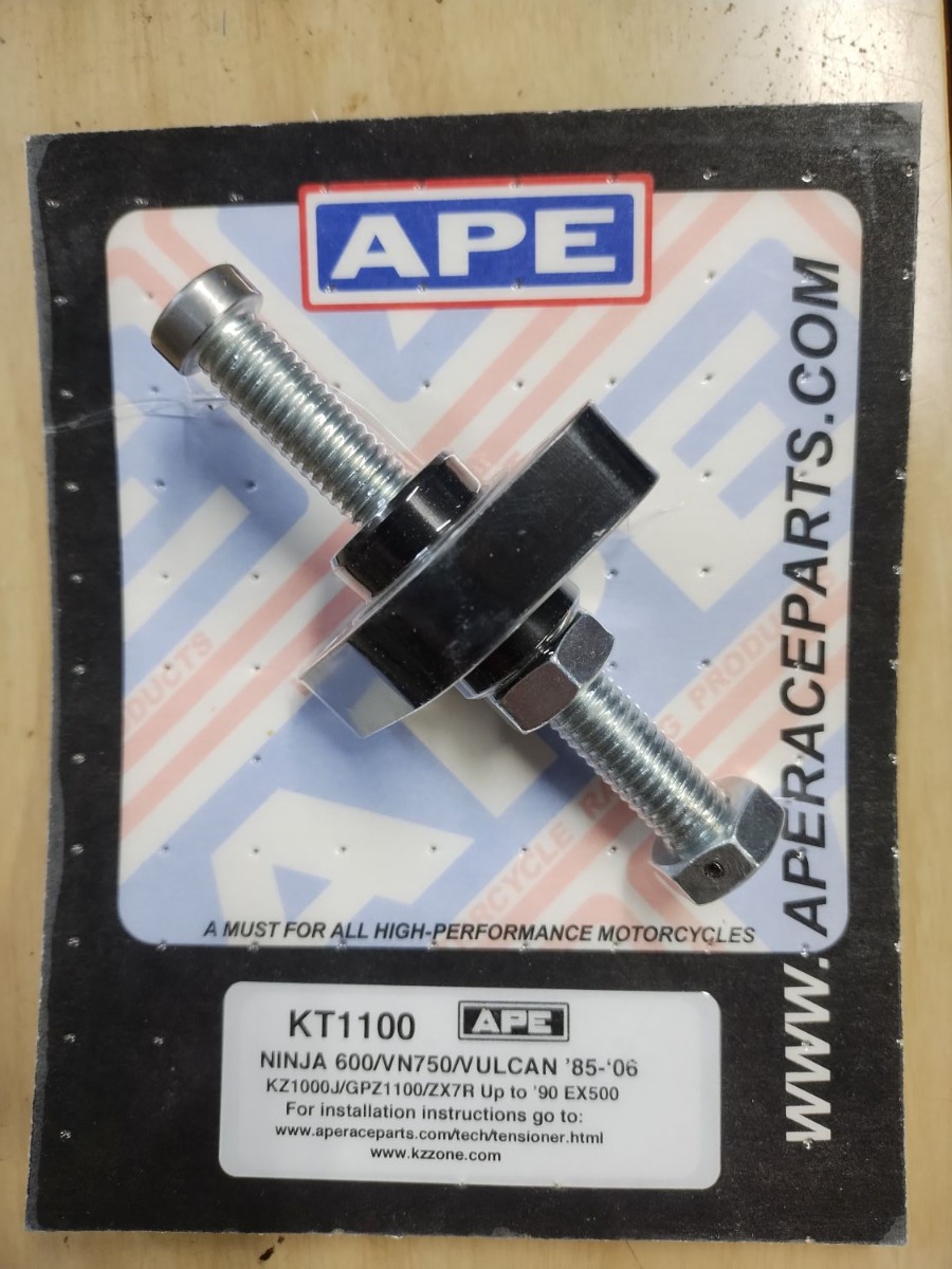

I pulled the carbs off today so I can replace the stock cam chain tensioner.
I did not like how it intsalled, so bought an APE manual tensioner.
I need to read the installation instructions again...

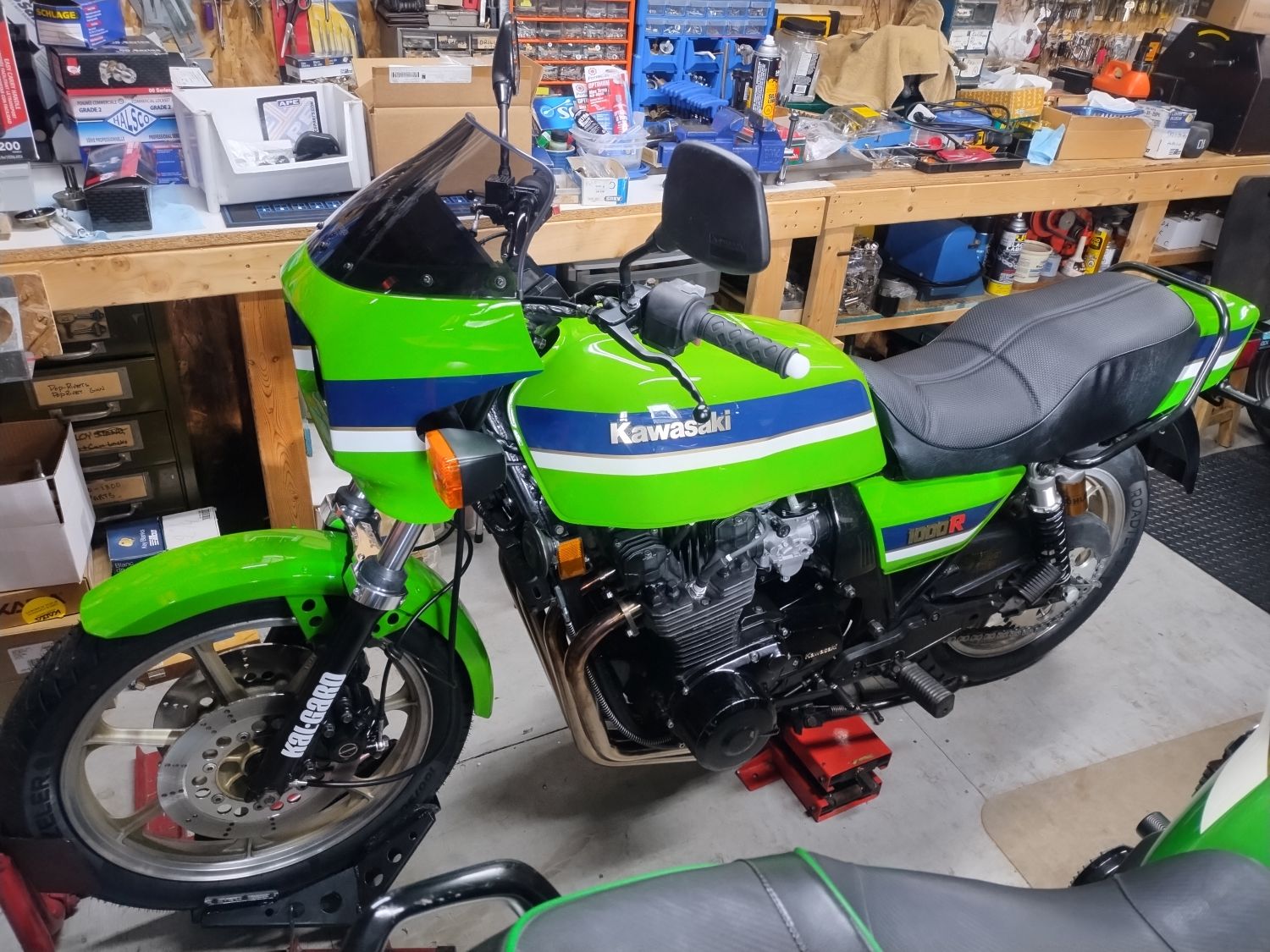

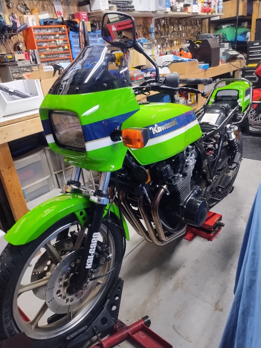

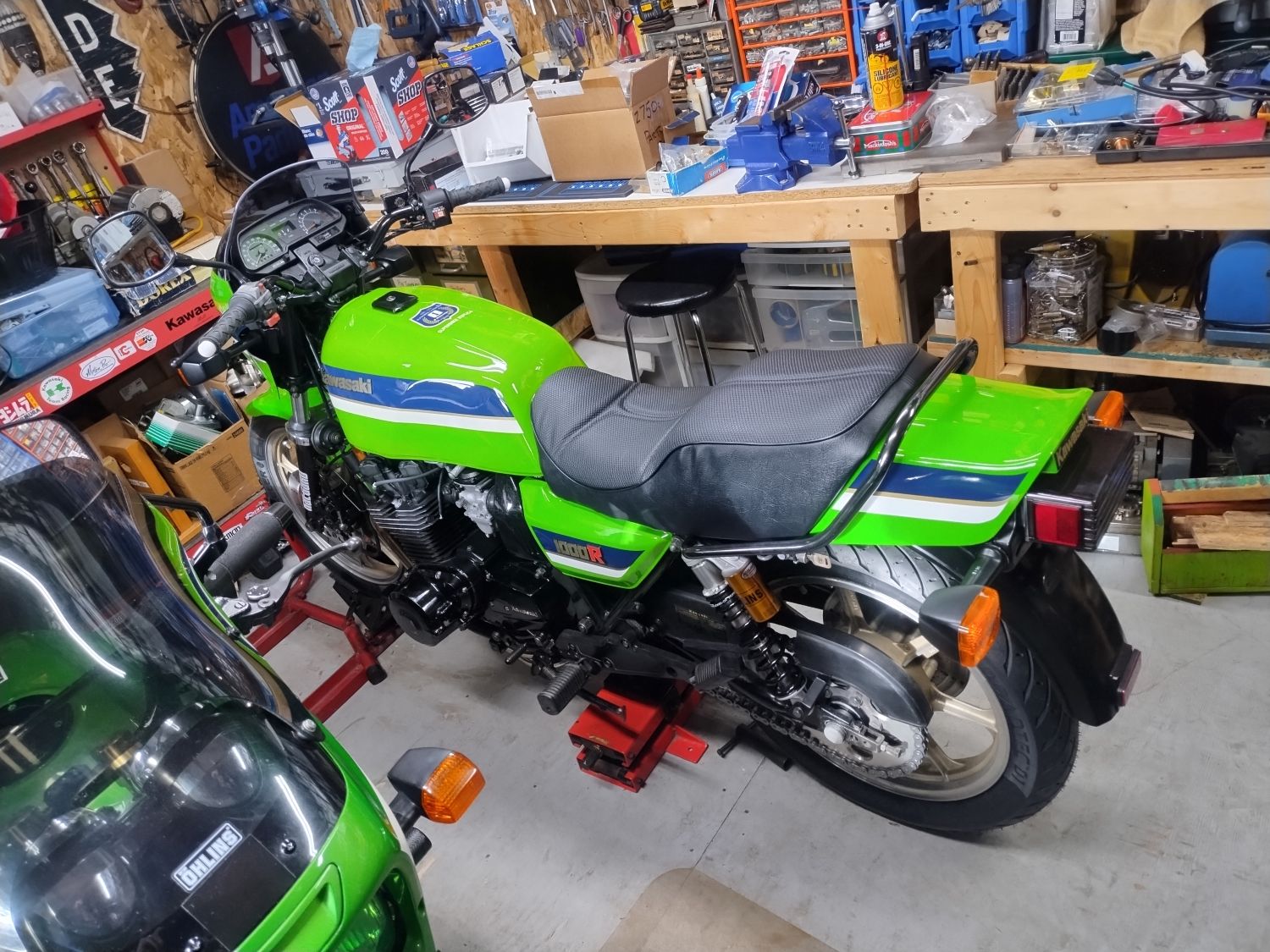

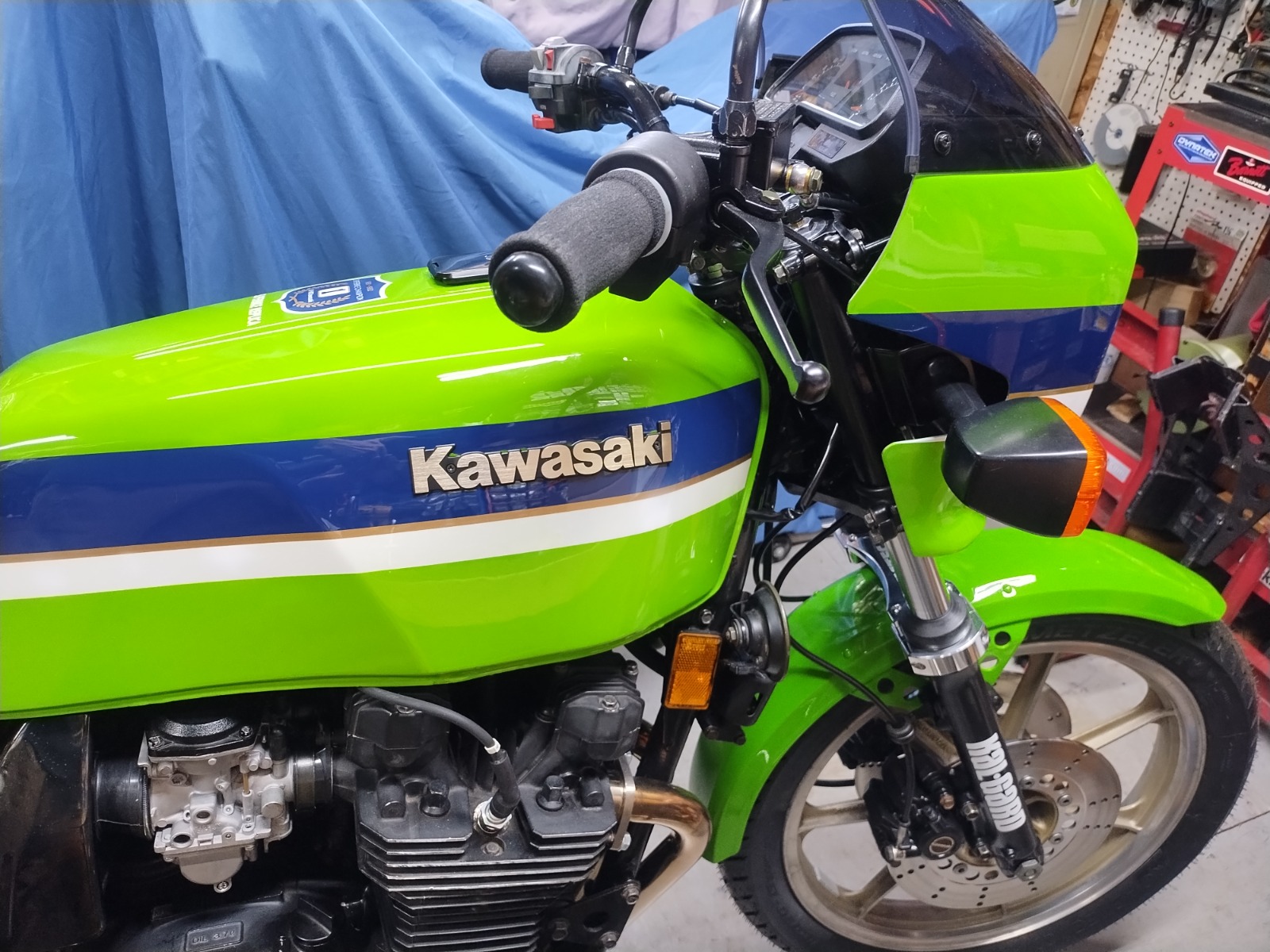

Attached the side cover badges using some RTV a few days ago.
Today a test fit of the side covers, seat and tank.
