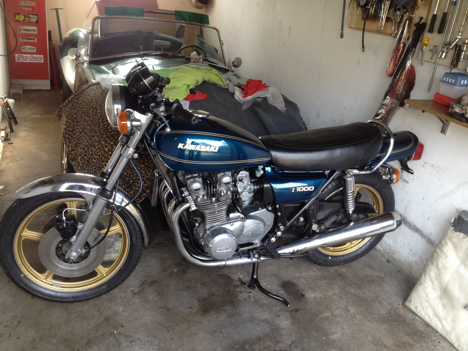

Adjusted the fuel-level in the carbs yesterday, and put them back in the bike, let the old oil flow out, change the oilfilter,... petcock to the tank, and now it´s nearly ready for the first start + run after 17 years sleeping...

Joe, I like your Cobra work table behind the KZ...

Me to, Scotty, me to
...(yes, it´s an really small and tiny garage, but as i´ve mentioned before, i am happy to have this place to storrage and wrench on bike and car...Garages are very rare to rent here in my area..!)

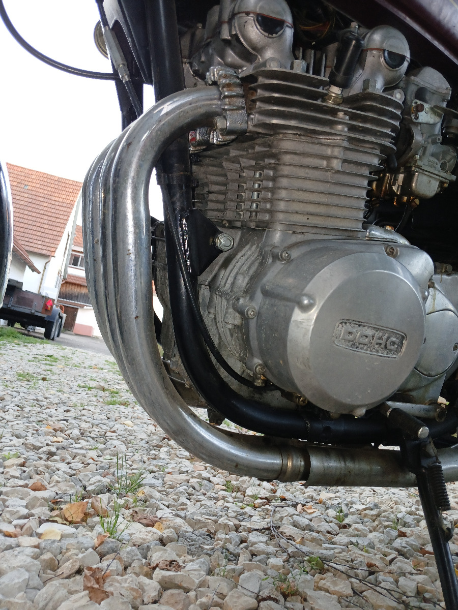

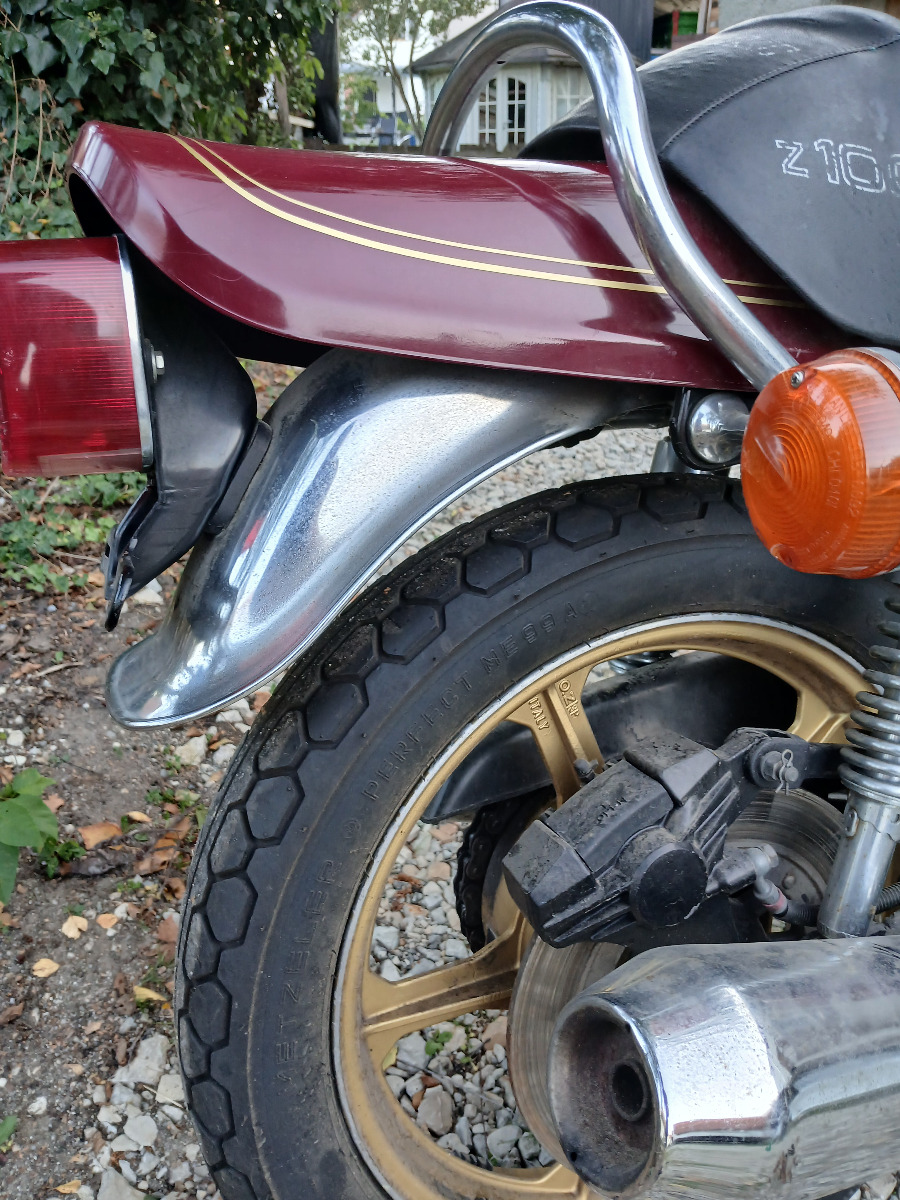

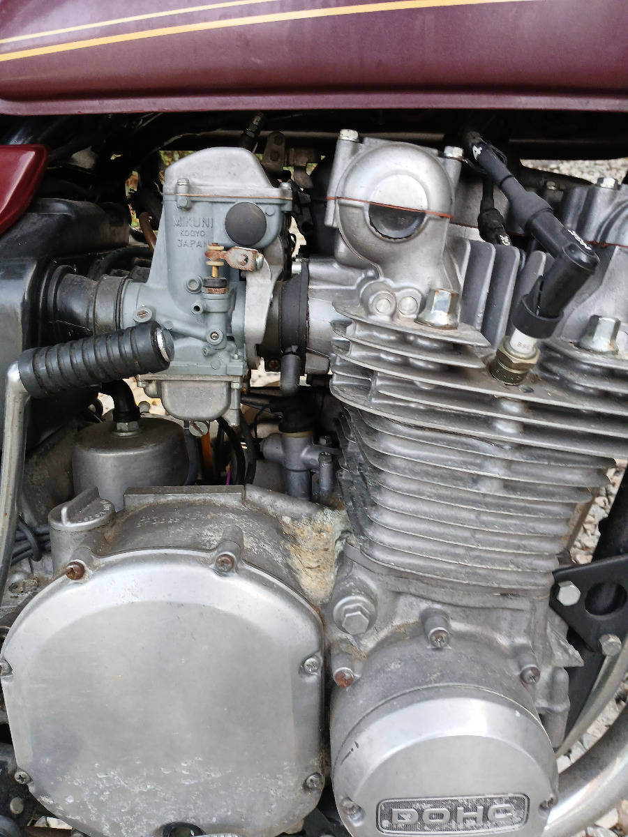

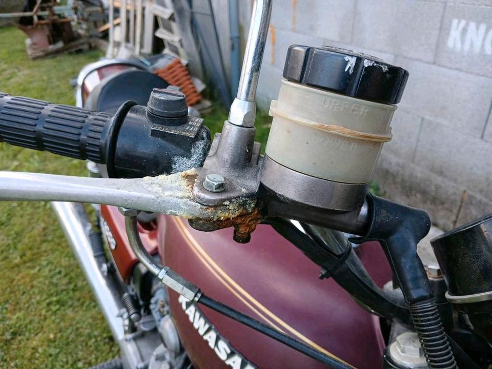

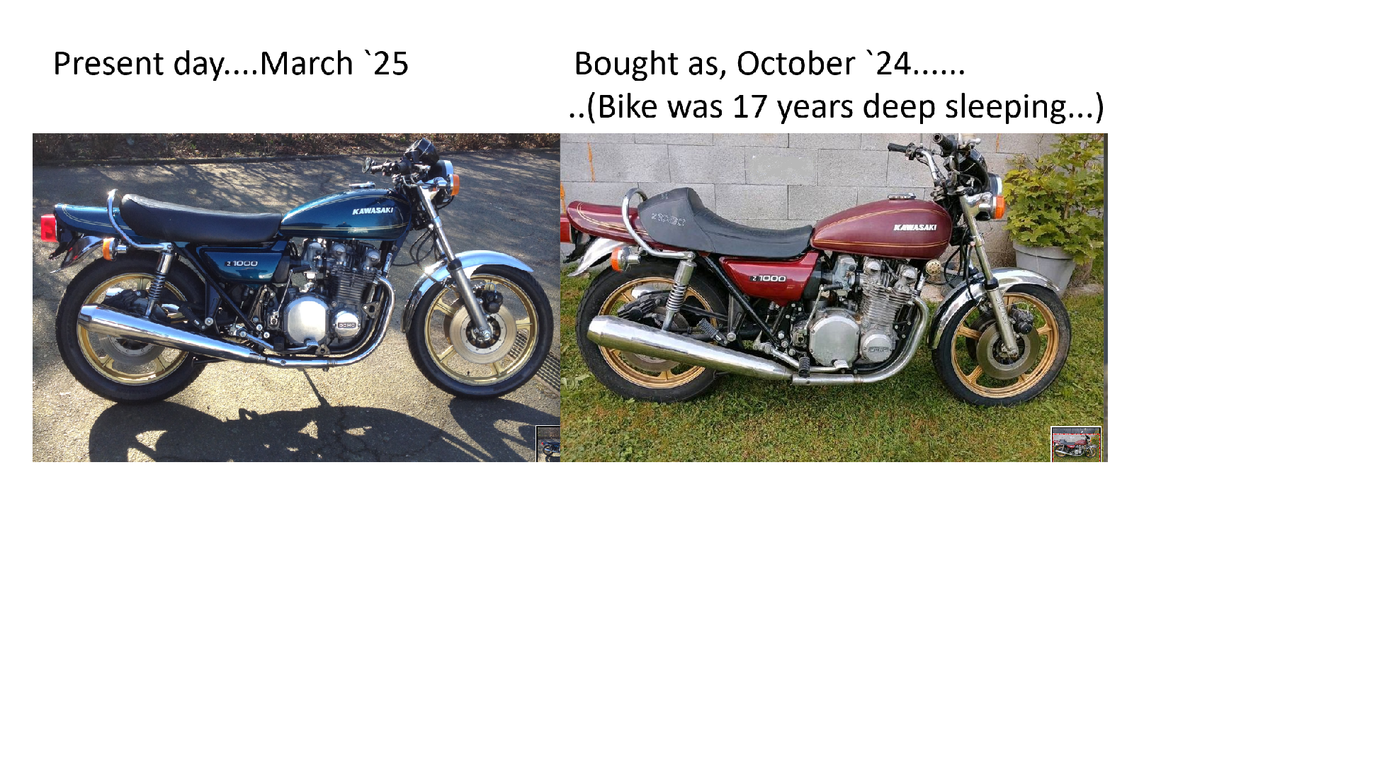

An overall summary:

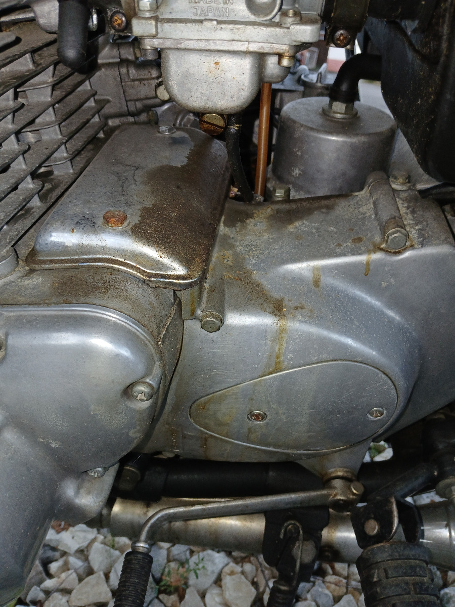

Most of it was actually a kind of cosmetic work, what was really badly corroded was the front master brake cylinder, or rather the entire brake system, which I overhauled or completely replaced. The engine was also moderately oxidized on the outside. Unfortunately, the paint could not be saved, there were too deep scratches and damage.
Rear fender was "dead", spotted with zillion rust points, carbs been with tight rotted sliders,rusted chake levers more than dirty bowls, ( masses of dissolved and disintegrated shit),

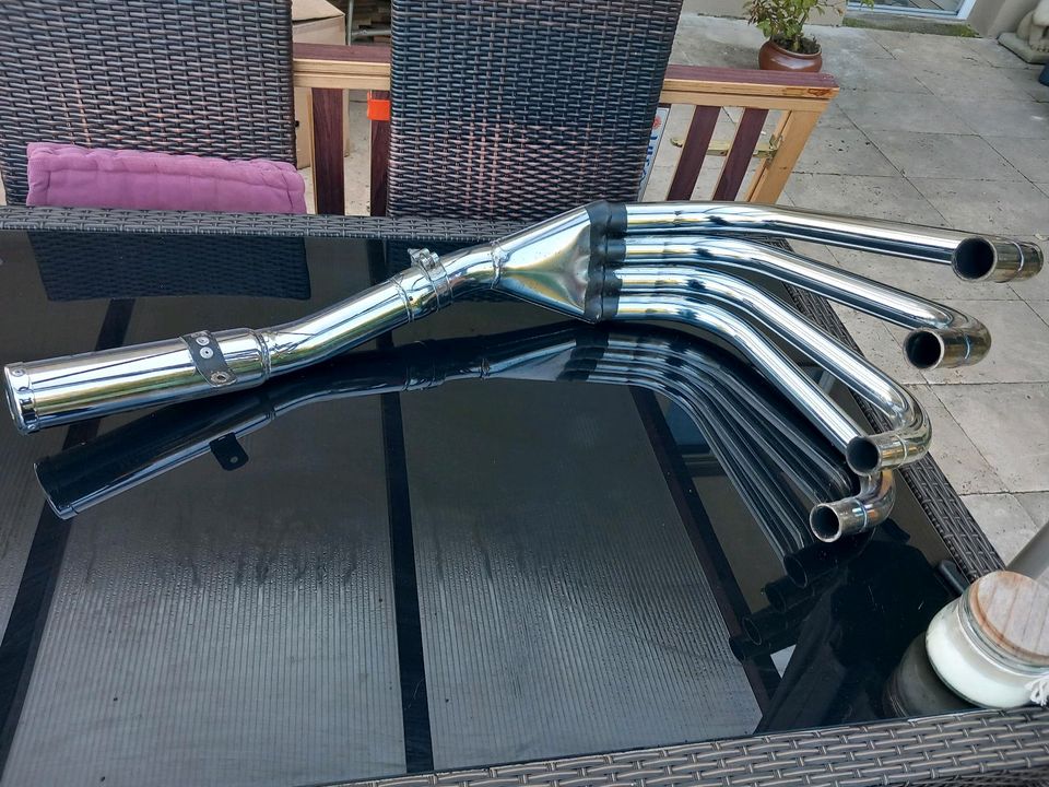

But all in all it was within limits, the engine was really clean inside, timing chain + rollers were tight, cylinder inside rust-free, (even the visible engine studs of the cylinder were still "brightly galvanized"! - All the electrics worked perfectly, the motorcycle was obviously not too damp...!Sure, the 4-2 exhaust-system is not so pretty: Some scratches, (bad on r.h. rear), chrome is in relative medium-condition, but no rust holes, or flaking chrome, for first, i can live withit,..and for second, i still have a brand new Marving 4-1 in reserve here
