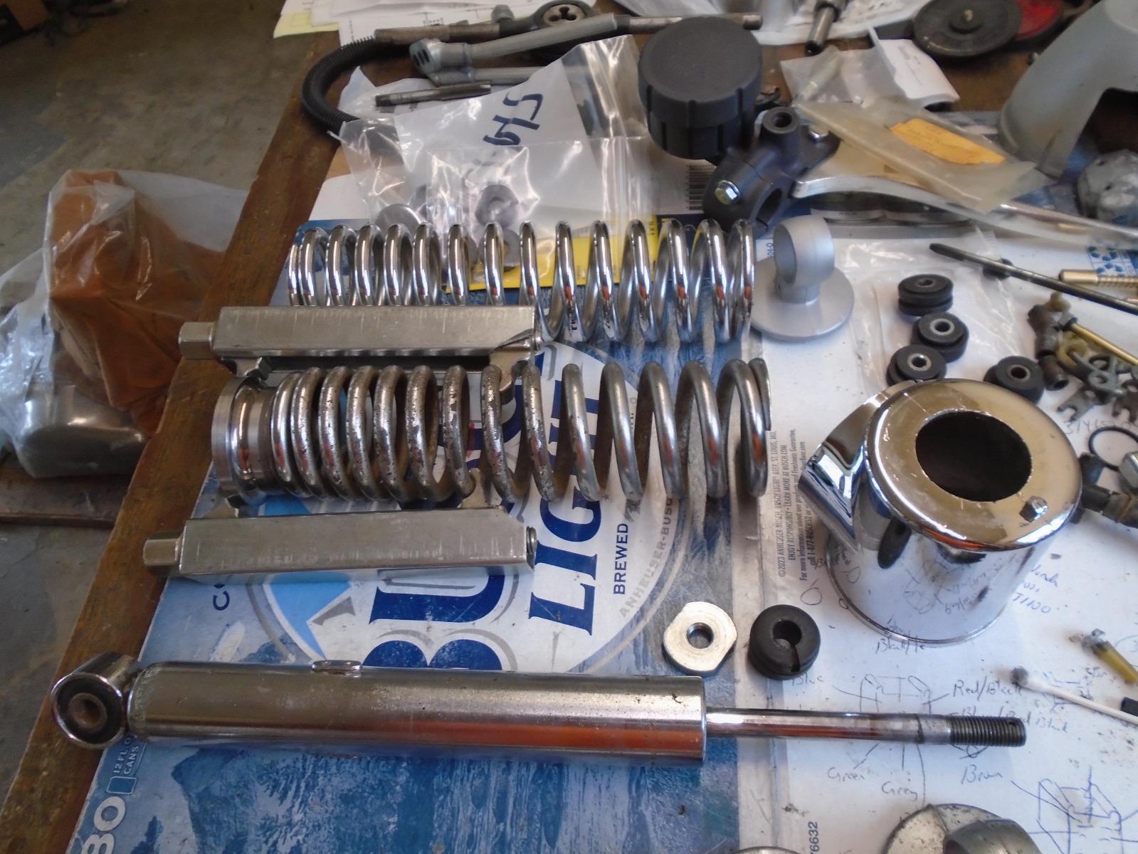

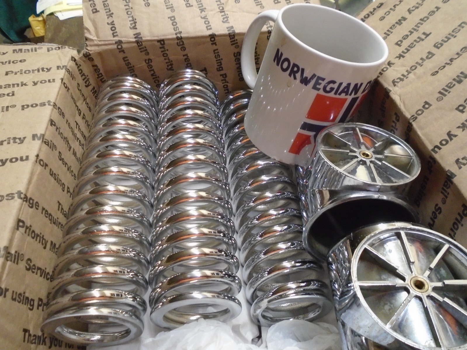

Those original KZ900-1000 rear shocks can be "glammed" up, they do come apart. I do it all the time and have the springs re-chromed, have a box of them already finished. Hey..how did that cup get in there Rolf?

19 Mar 2025 12:23 - 19 Mar 2025 12:33Asphalt900 You do very nice work! i did not know that the shocks cold be refurbished.I dont think i will try doing that could ending up with 4 front theeth knocked out or a eyeball on the floor ha ha. So you use a spring compressor for motorcycle chocks?
I did first not understand what you meant about the cup and was looking at the first picture and thinking you meant the reflector cup haha then i saw next picture with the Norwegian cup .Then i walked fast as i could in to my kitchen an had a look in the kabin and just as i suspected one of my Norwegian cups was missing .!!! you bast....

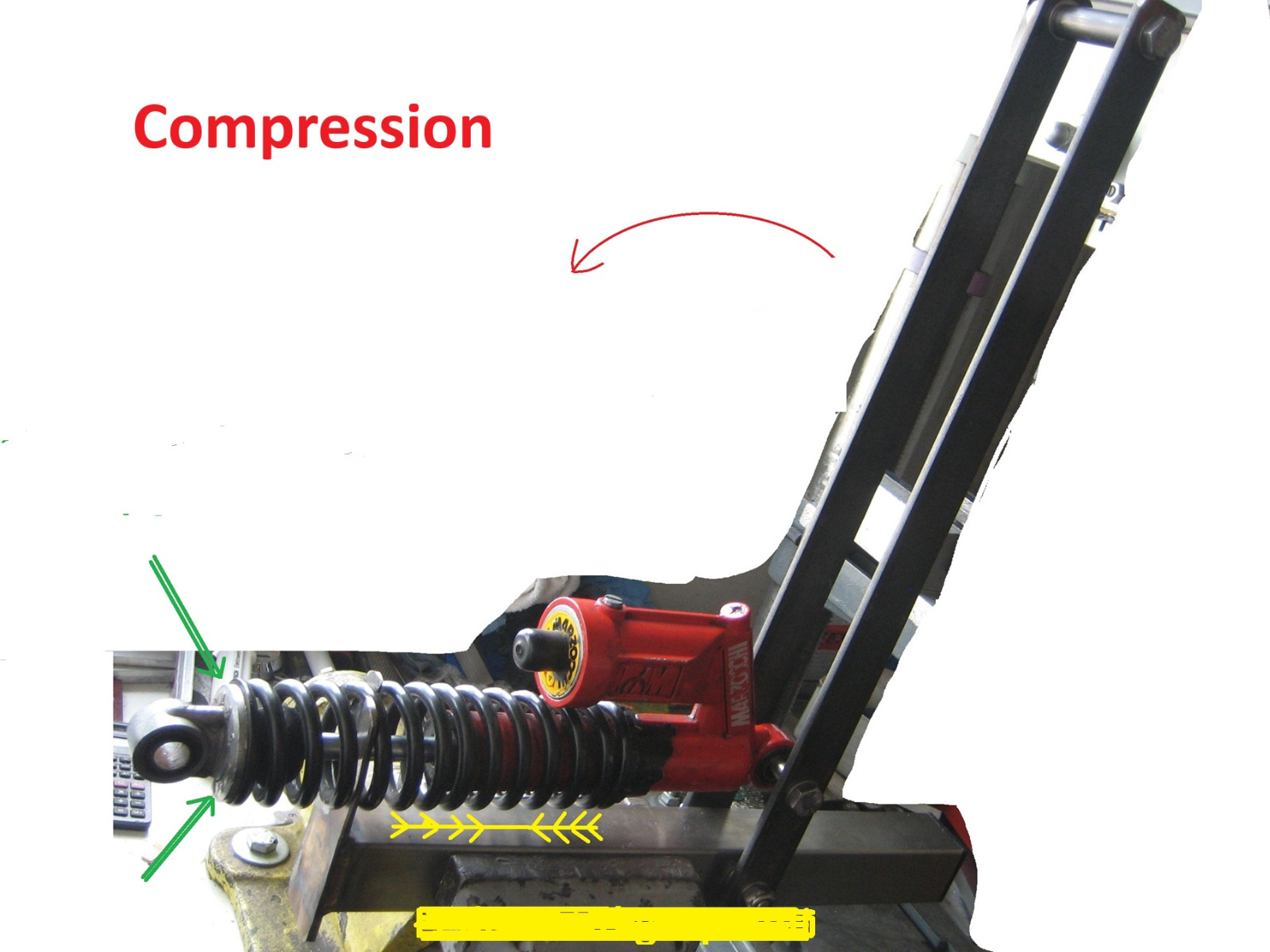

To avoid the risk of losing my front teeth, I built myself a spring tensioner several years ago. This allows me to safely tension and release the spring.If desired, I can provide better detailed pictures or a parts list with dimensions...It´s easy to build this, and it helps immense!

Didn't think You would notice the missing cup Rolf, had Kris Kringle snag it from you last Christmas. He was going that way anyway. Thought i would re-gift it to this coming Christmas as to complete your set, haha. Clever tool Joe!! I just modified cheap-o spring compressor kit and found a front outer carrier race bearing from a Ford Escort fits the adjuster perfectly. It's nutty how a sorted mine works, ha.
