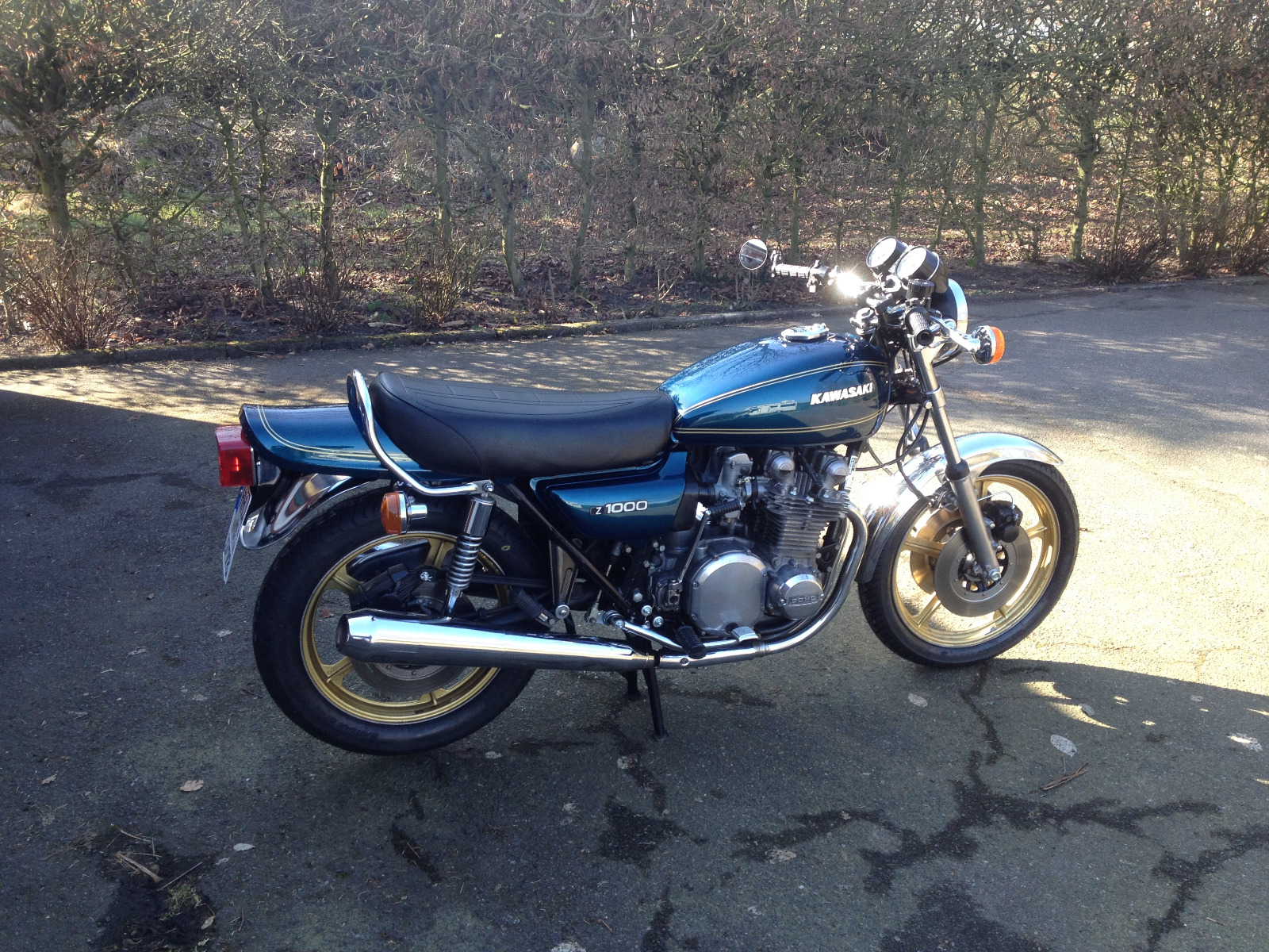

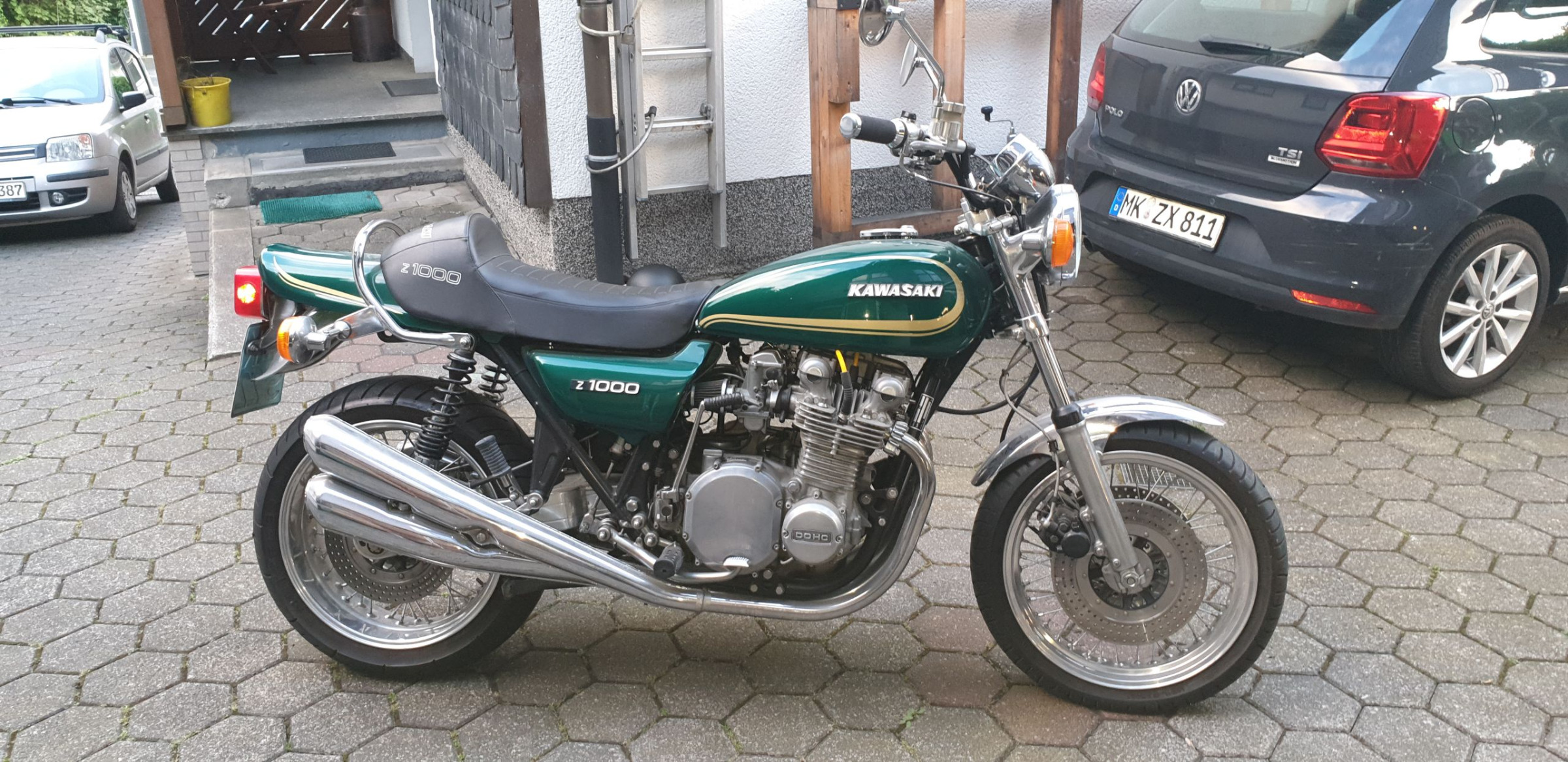

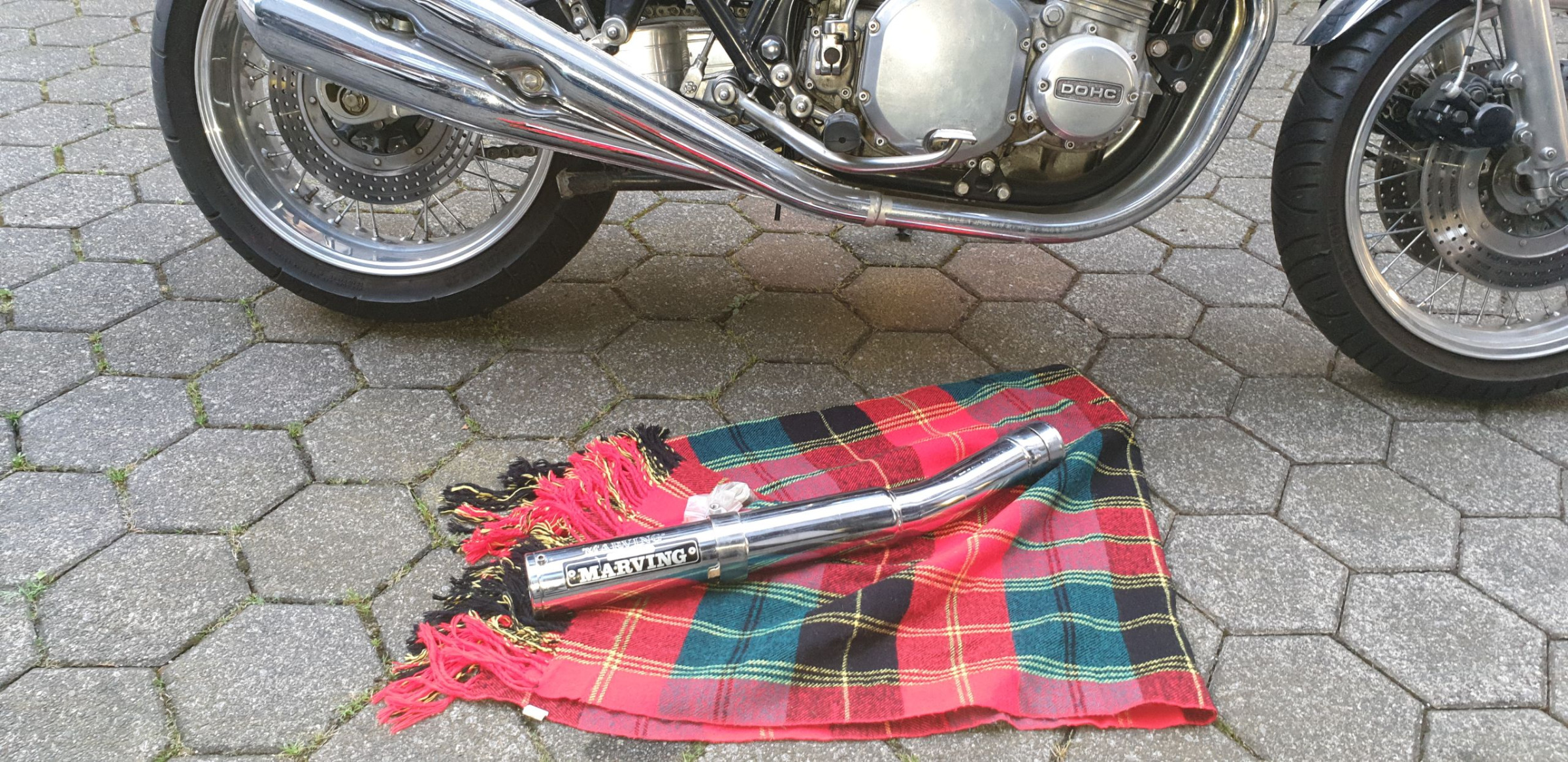

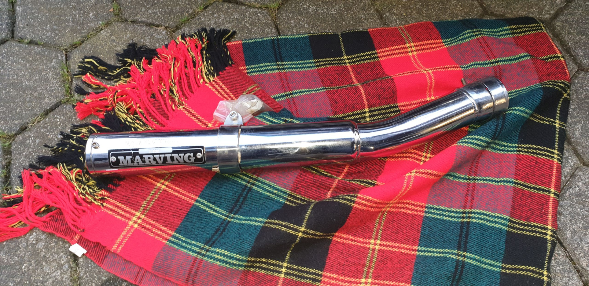

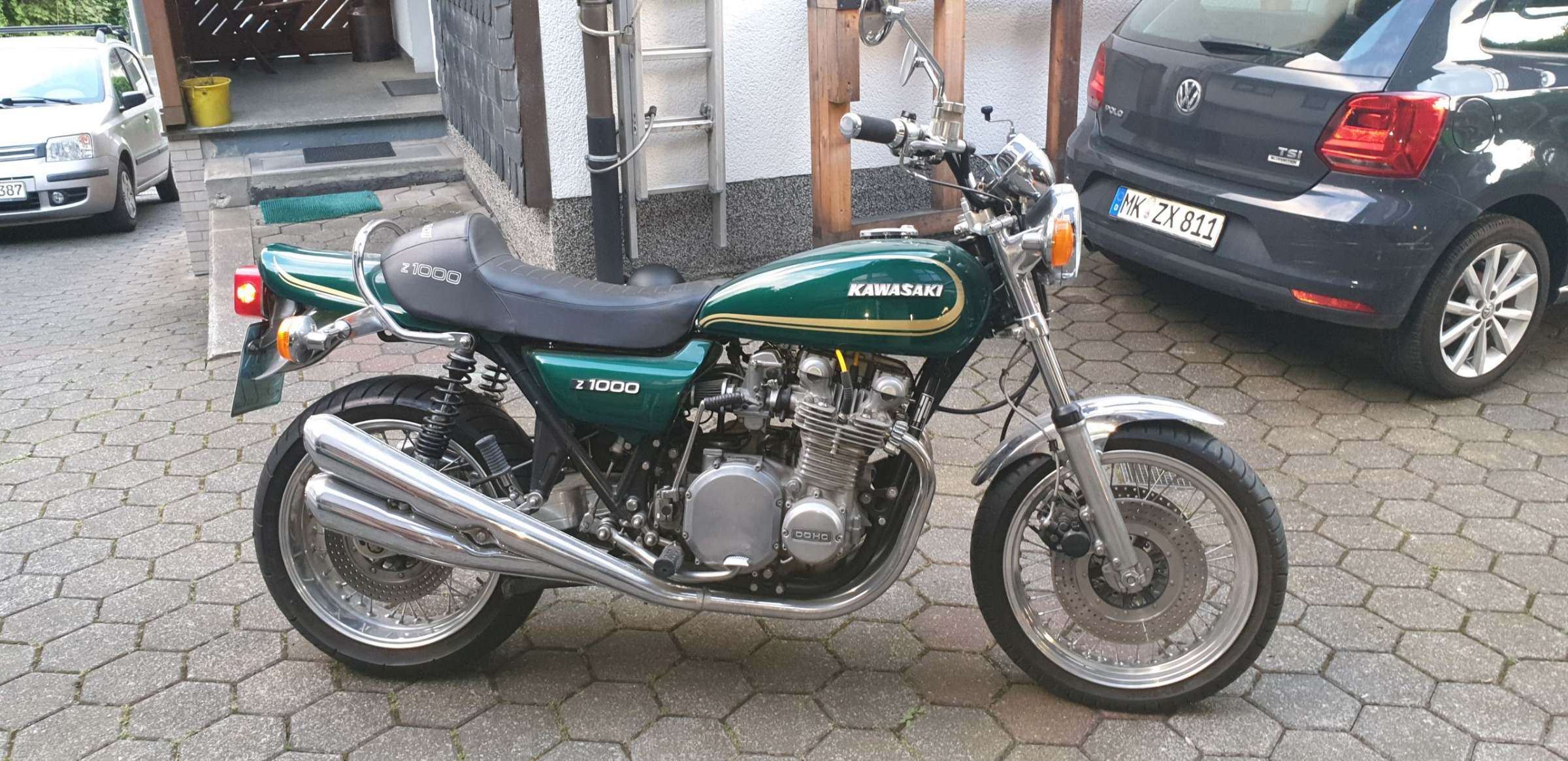

Nice rebuild!!!
The European (German only?) rear grab bar looks different.They have rear turn signal mounts.

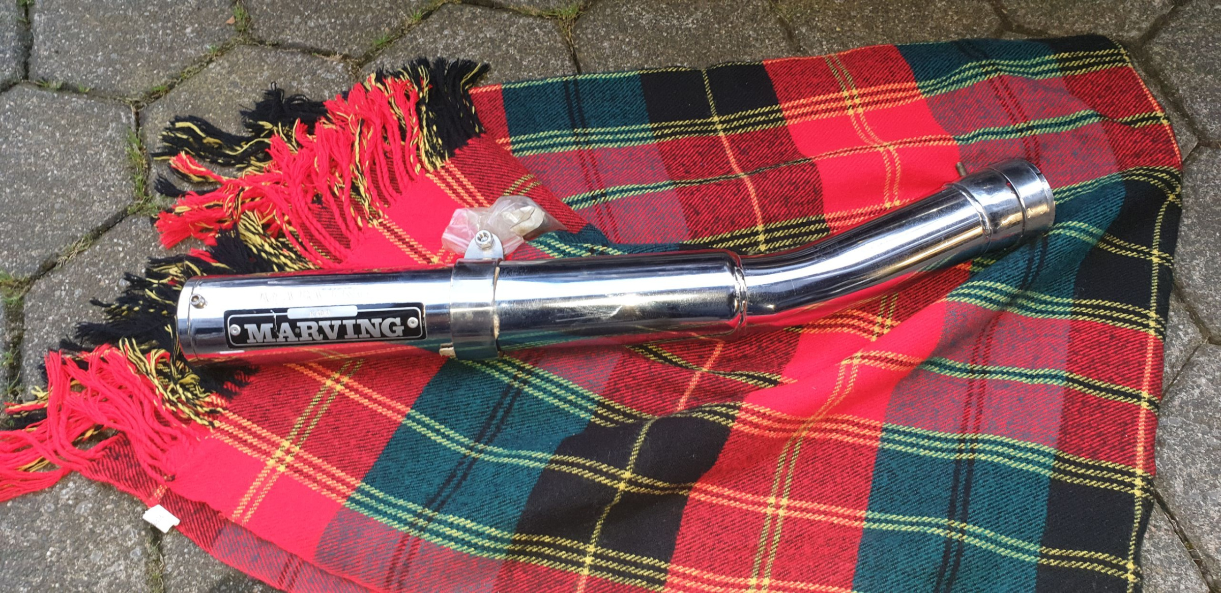

Your Marving Race silencer looks like shorten by 15 cm.

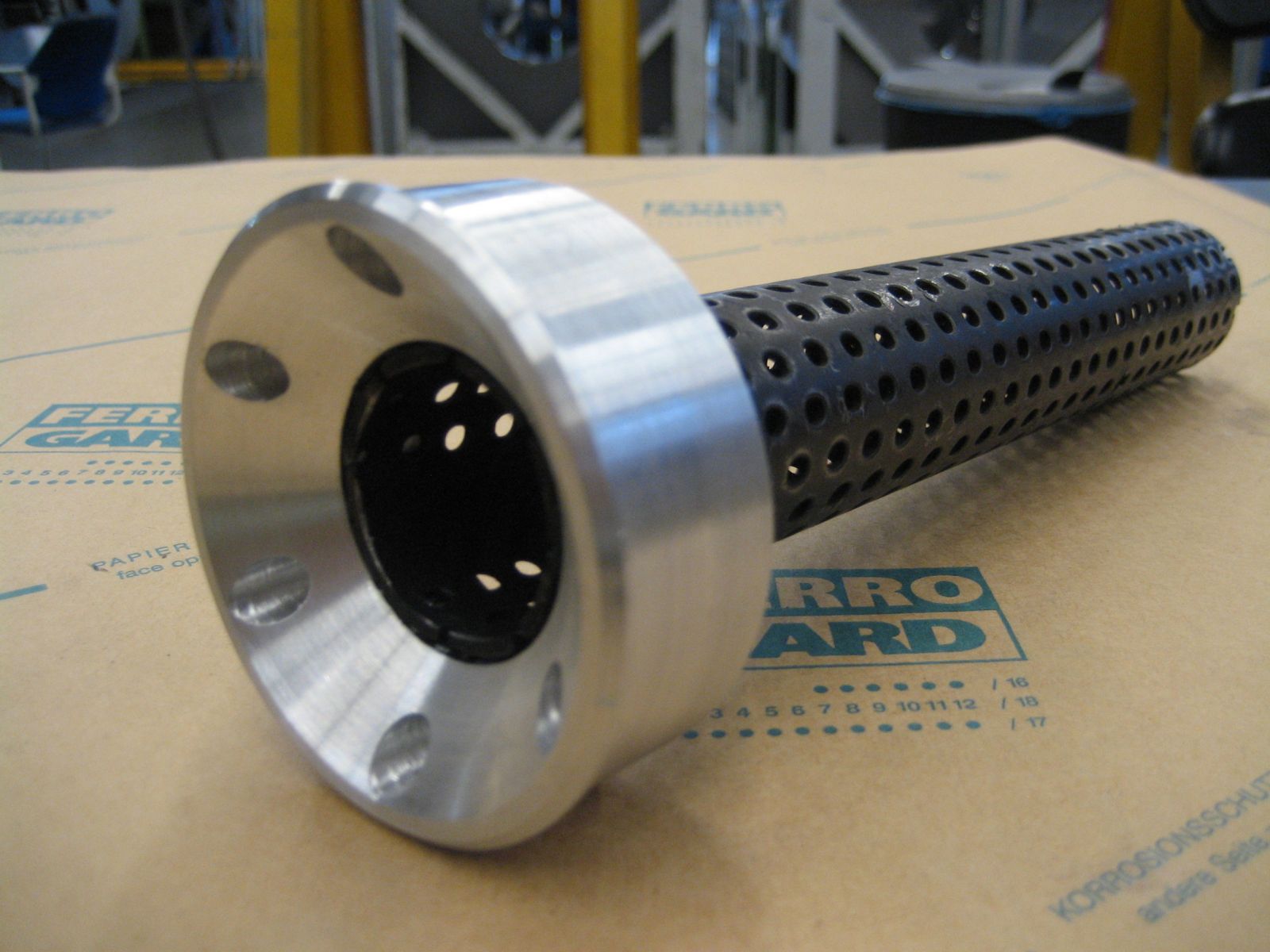

My Marving Race end cap mod.

The grab bar is from Z1-900,.( like Z1a, Z1B),.they came ever without the flanges for signal lights! ( I prefer this older version, the signal-lights are closer to the frame, and the bar is more filigran..!)
And you´re right: The "germany"-bikes have had it, also the sidestand mounted forward under the generator,..and with this very nasty, bended, shift lever....(for the circuit breaker to prevent for starting with the side stand out..)..I´ve ever prefered the international version of the Z1000 / KZ1000! - Our german government with thoose rules had made some bikes more nasty in details.....
My Marving is a "404", ...i don´t think,this is shortened,..but who knows..?
Anyway, i have the documents for this, and a good chance, to get it in the papers somedays...( and in case, i can fill it with some kettlecleaning stuff, to reduce the noise for the MOT check,..but that´s in an unknown future,..for now, i`ll like the 4-2 silencer style of the Z1000, and led the original 4-2 on it..! ( In more than 45 years of drivin`old Z1000, and Z1,..i`ve never had a Z1000 for me, with that original exhaust...haha..Must have this experience before i quitt...

The Marving "404" enblem is "borrowed" form the TÜV legal "Master" silencer to get it licenced !
www.marving.com/de/940-kawasaki-z-900-1973
www.marving.com/de/942-kawasaki-z-1000-1977

yes, sometimes strange things happen,...life is full of mystery and surprizes......
(But to be completely frank and honest: who am I to judge whether someone has shortened an exhaust pipe or, for example, the extremely high bent streetfighter frame at the rear.. As long as nobody steps on my toes, I don't give a damn!)

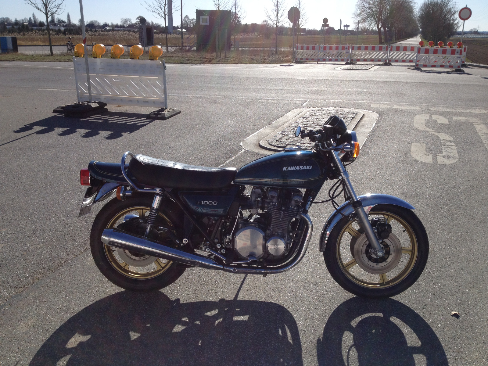

WHAT a perfect day today:
Petrol on the bike, kicked it in 6 times, and the lady runs like a good Swiss watch!! / (Thank to zed1015, the choke plungers are working perfect!!)
-Then quickly to the MOT, everything was fine, and then quickly to the DMV,completed the registration..! Perfect timing, and we were lucky!
Pictures will follow here,..came just back from a little 40 km ride, everything works fine, exept the speedo: Cable is broken...ha, littel thing...engine runs soo well, iam really happy!!
(( Wookie: Seems like Your very large "crossed fingers-smiley" had worked very well !!!)
Edit: Just back from a second ride, bike runs great at any speed and RPM´s,..totally satisfying!

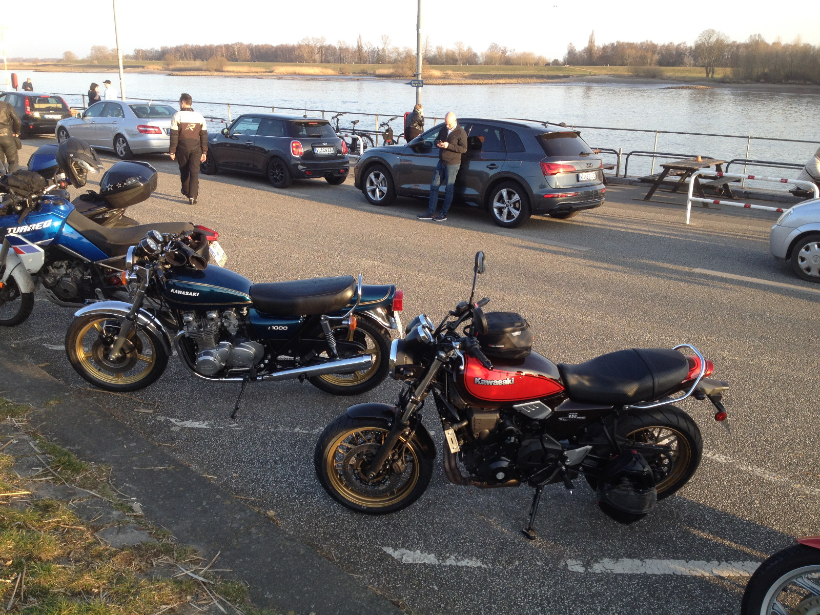

Here a pic from first run this morning...

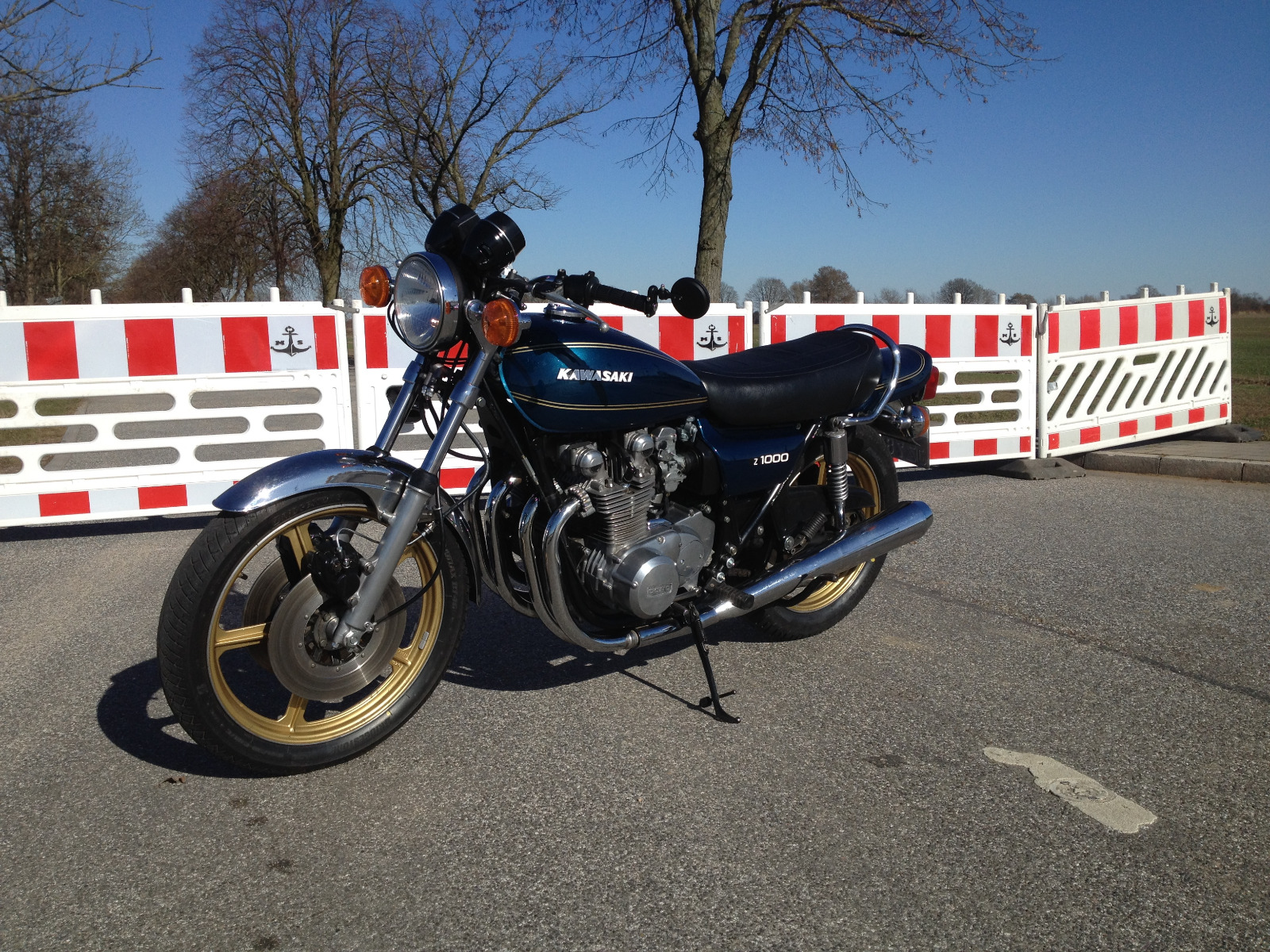

Here from a bike meeting point by a ferry over the river,...classic meets new age...

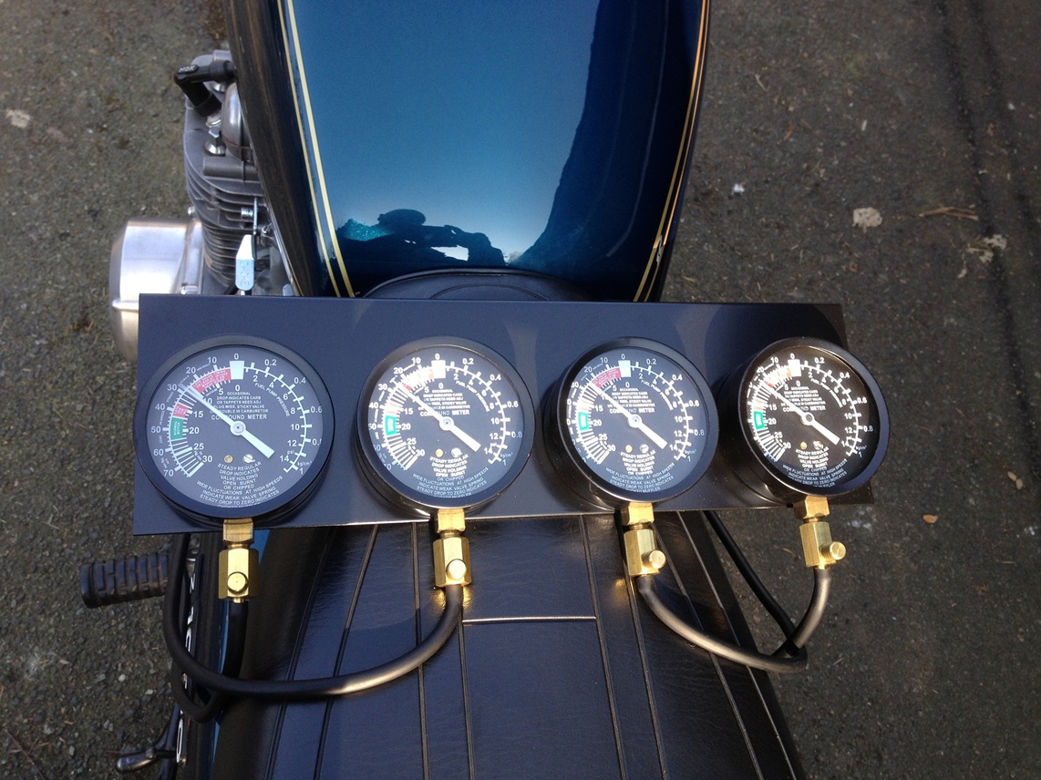

So, I've ridden the bike 500 km over the last few days, at different speeds, so to speak, i have" broke in" the engine again after theese long time sleeping..., and it's running very well. I measured the compression today, and I'm very happy with around 10 bar on all cylinders.
Finally, I connected a few vacuum gauges again to check, and to my surprise, this result also looked satisfactory to me! (I had previously adjusted the sliders manually with a 1mm wire, but I hadn't expected it to be that good...) All in all, a very fine surprise to me!!!
(The big joke is: I had a set of 4 high-quality Boehm-Synchron tester clocks for more than 30 years, and last spring, after 7 years without a Kawasaki, I decided that I no longer needed them....sometimes You can be soo wrong! Never say never!
-In any case, theese new cheaper gauges work acceptably enough for me, to control the carbs sychro from time to time....

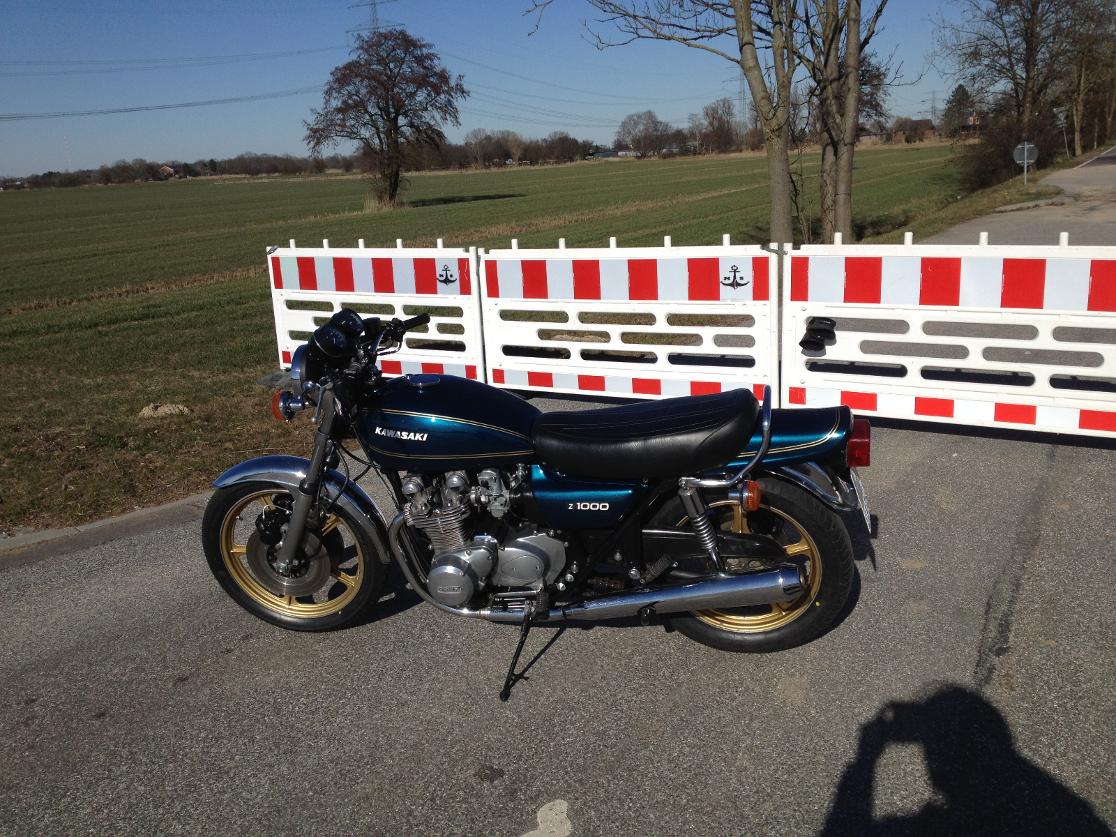

Today another little ride with the A1,...very sunny here and about 7-9 °C,..i really enjoy spring every year....! Bike runs great!

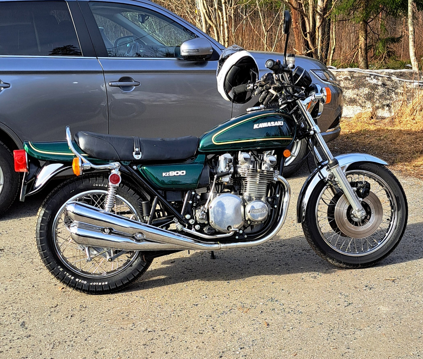

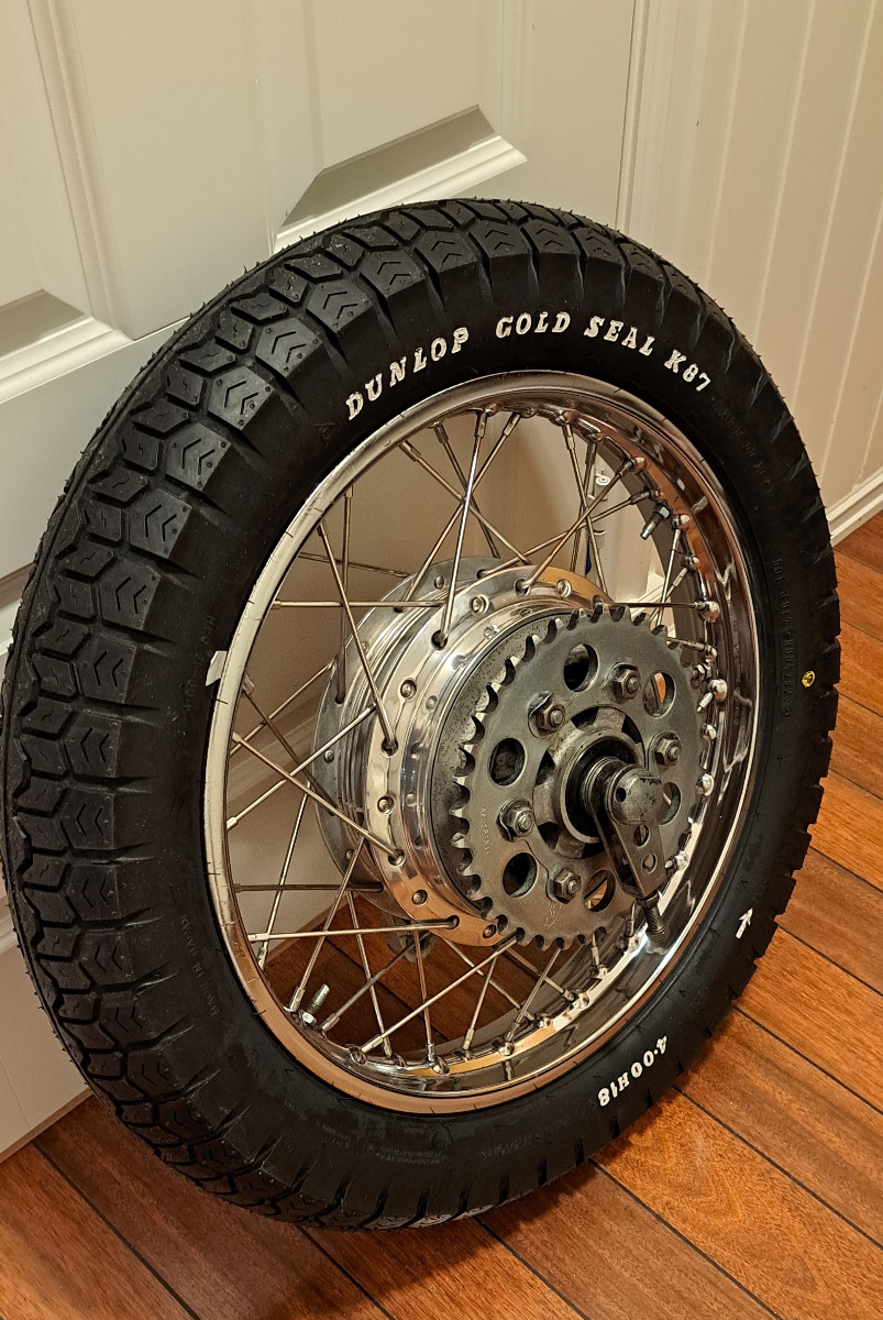

Nice! it has been a little snow again here since last ride so i used the time to put on one of the vintage tires i bought for christmas. These tire was a bitch to put on
with the rimlocks and tight beads.I have changed many tires before ,but this one.... almost gave me heart attack i had some of them before
.Yesterday it was nice and sunny so put the rear wheel on the bike and did a short testride.Not sure i like the look of the tire yet

Wow!- Looks great !!! - ( And you´ve put on your new shocks with the relector also..!)
Your scooter looks like new,..very high condition standard....i am jealous!
