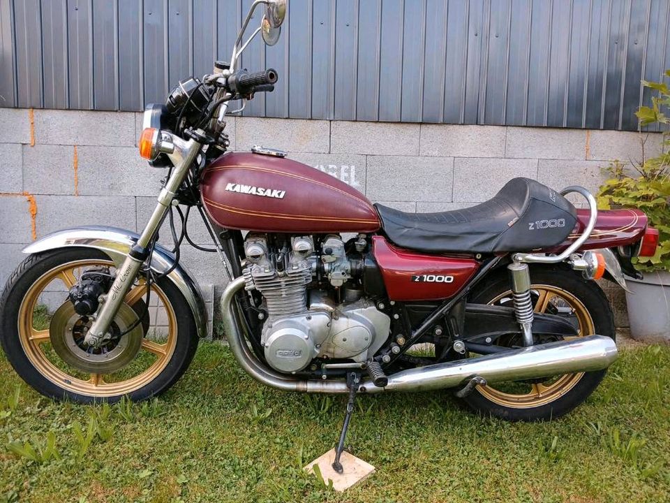

Bought an nearly original Z1000 A1 last august, was an really sleeper. storaged dry and dusty for more than 17 years, shure, some little rustmarks and scratches here an there bye, but all in all was looking than a fine objekt to be reanimated.
The original Italian OZ-wheels i will left there on the bike, like that 5-spoke cast wheels like the Campagnolos or PVM`s
After cleaning all the dirt, dust and little corrosions, i was surprized how little serious rust-damage i`ve found: Only the rear fender was marked with few little serious rustmarks, and of course, the original 4-2 exhast is not in showroom cond. but i can live withit, it´s like some grey, ( or lost) hairs and scars of life. The front master cylinder was total oxydated, and no chance for restoring, too much internal corrosions in the bore, and of course, all the brake lnes,..but calippers and their pistons has been survived and after cleaning and renew all brake lines, the system now works fine.
After cleaning outsides of the engine, depart the carbs, i had files up some mixture of a kind of WD40 and motoroil, take the valvecover away, and prime the engine via sparkplug-holes, and with a oilcan direkt lubricating to camshaft, lifters, timingchain, and turn the engine first by kisckstarter, and after a while per elektrik-starter, all was fine. I´ßve checked the valvelash also, and to my happy surprize, they were all with 0,1 - 0,15 mm lash, no one was without any lash,..,good sign that no valve was "hammered" into the seats. I was really happy to see that. After all, i´ve taken an simple compressions-test, and for an old cold engine, it was okay for me, to see that they all 4 have no lower than 6 bar. So i am really shure, to bring this engine without too much trouble back to life!
Carbs still departed, but ready for fuel-level check and adjust, standing on my selfmade carbstand, will that do in the next few weeks.
The original red paint was to faded by sunlight, and also too heavy scratches and little dents, so i´ve decided, to let paint new, and in my favorite colour for an A1 in diamond sky blue met.
Just right for X-mas, i had become the painted body parts back, and i am really happy with the result.
So,will do some other little things, but nowadays, its to cold and moisty here, to wrench in my little garage... iwill show you more here in the future...

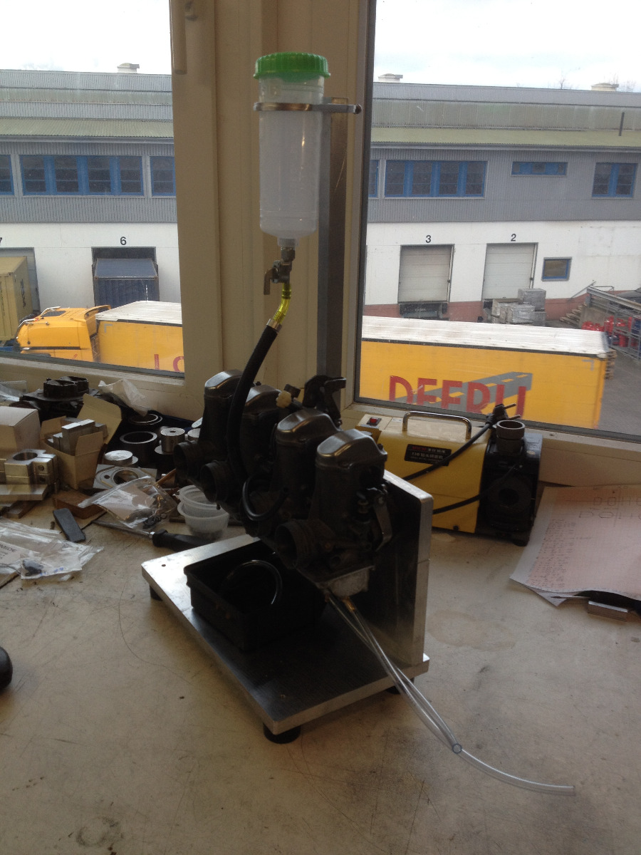

Cab-stand, for fuel gauging.. ( sorry for darkness in the pic)

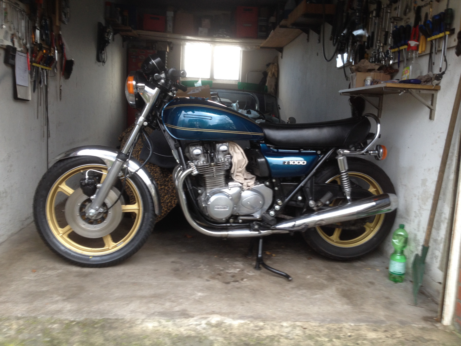

That's gotta be the smallest garage i've seen in quite a while! That KZ sitting in there sideways reminds me of the Austin Powers scene where he got that electric cart wedged in the hallway, also sideways, ha. Still have Your Goose bike?

Yep,..this Garage is as a fact tiny. 5 x 2,50 meters,..that´s why i´ve sold ALL my Kawasaki stuff in 2016 before moving to another living place,...sometimes, destiny is f**`n amazing...
But anyway, i am glad to have an Garage at all! Without any, i couldnt have any motorcycle, or screw on it! So i am a happy man!!!

- Posts: 220
- Thanks: 60
Re: 1976/77 Z1000 A1 bring back to life
08 Jan 2025 17:15
That stand is cool! Did you make that or repurpose something?

This Carb-stand i made myself from 2 aluminum plates, screwed 90° together, 4 rubber feet, measuring out the screw-pattern and distance for 2 carb-holds, , ad a rod for the fuel reservoir,..and now it´s easier to depart the flowbowls and leveling the swimmers for correct fuel level....did this job it last summer directly on the bike, and thats always a mess to fumbling in grotesk laydown by the bike, to get swimmers and needles in + out....It´s ok, when you won´t depart and remount the carbs from the bike with those hardened intake rubbers, but its alway a skill with those inner floatbowls...
