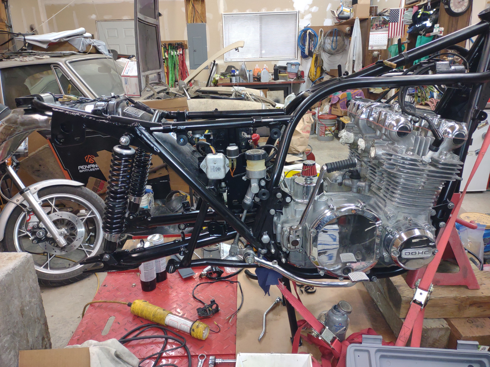

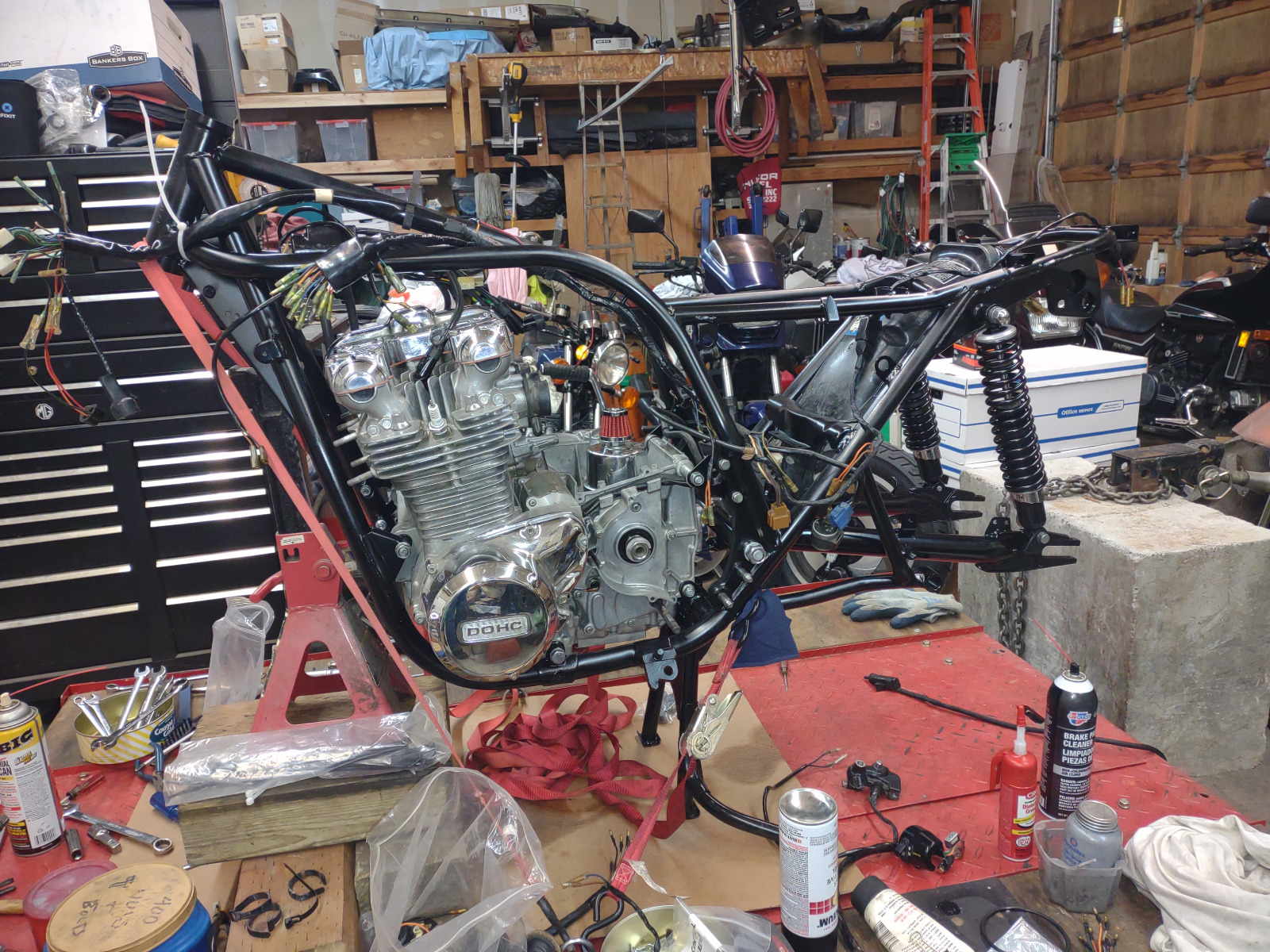

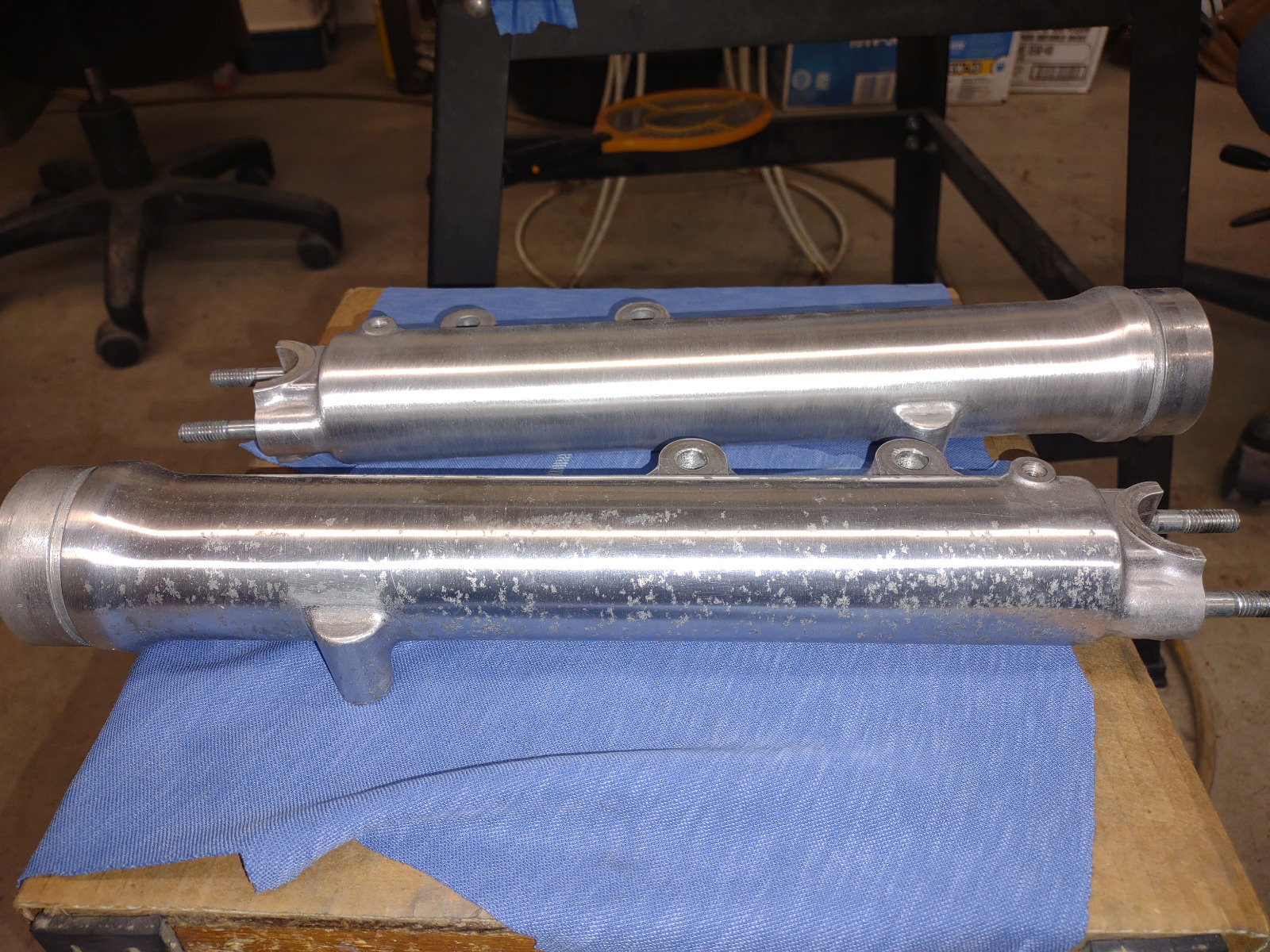

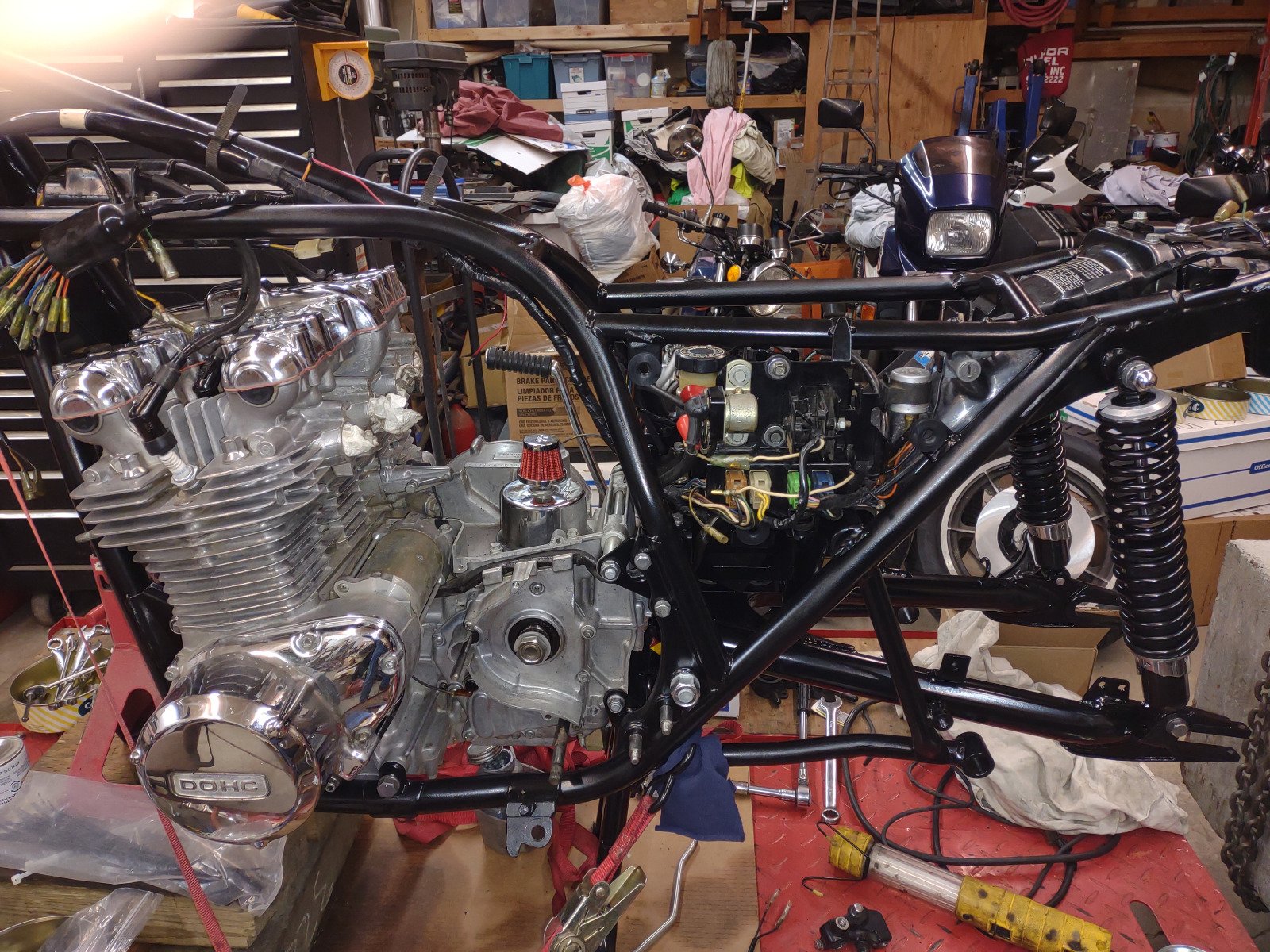

We started installing the wiring harness after some repairs. We also installed the swingarm and shocks today.I have been cleaning up the fork lowers after stripping off the clear coating with a brake fluid bath. I'll be giving them a satin finish with 400g and using only sanding strokes around them, not lengthwise. I also smooth out any casting ribs and rough sandcast texture before sanding.

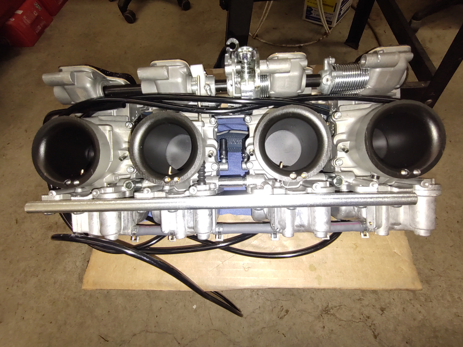

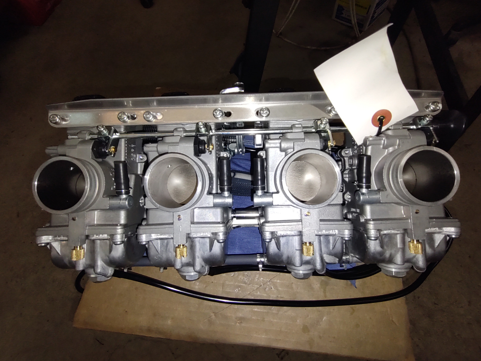

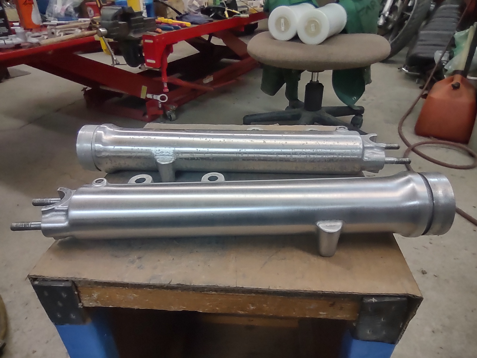

I finally finished the first fork lower. Then I figured out we got the wrong gauge mount and we needed different intake boots for the RS34 carbs. We sorted that out and got the K&N pods on the way. We also ordered a new gauge wiring harness because all of the bulb sockets self destructed pulling them out of the broken gauge mounting bracket while pulling out of gauges from the broken gauge mount.

That fork looks excellent!

Yes forks look great! What was you technique ? Brake fluid is a fantastic paint stripper and 400 grit sandpaper? Wet?
please share Thanks!

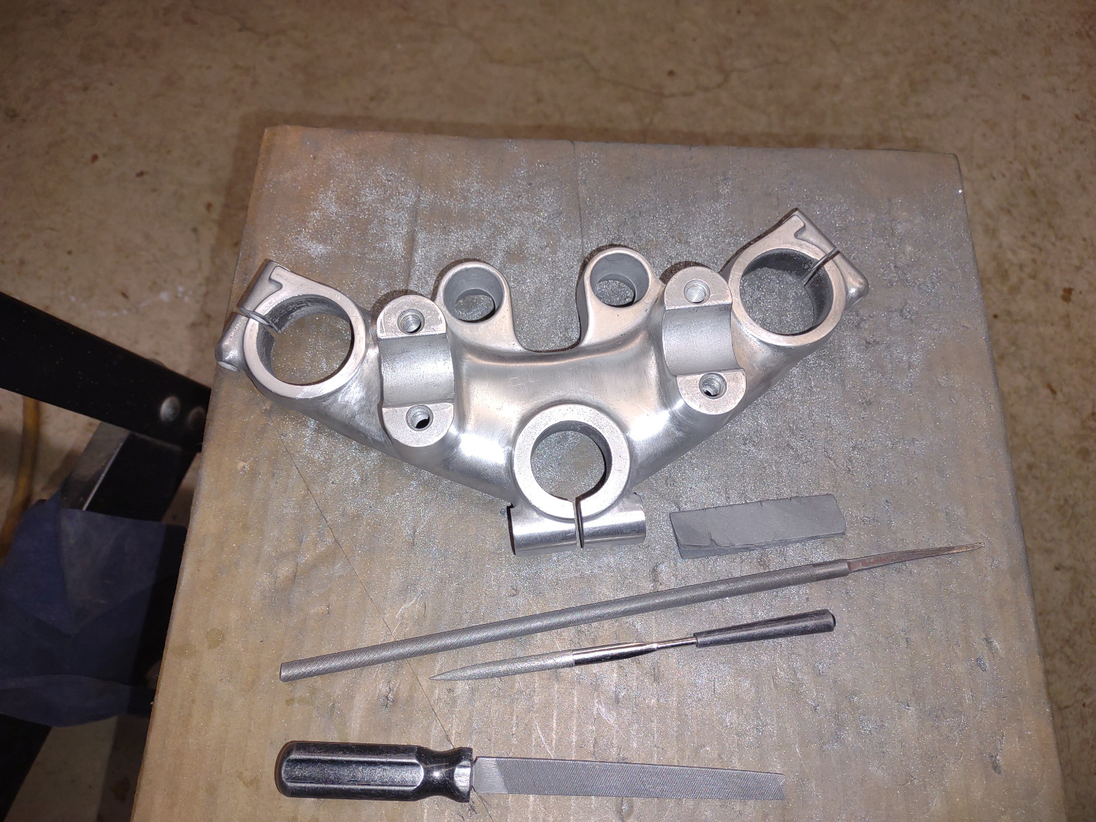

After the brake fluid bath I use a 6" coarse flat file and a fine round file to remove any casting and grinding flaws. Then if I need to because of corrosion pits I start dry sanding with 220g. Then I use 320g and finish with 400g.
All sanding strokes are around the part, never any lengthwise sanding strokes except for the fender and caliper mounting lugs. They are sanded with only lengthwise sanding strokes. Kinda like painting six panel doors, all of the brush strokes in the proper direction.
It turns out very close to the original finish but way better because of filing the casting flaws smooth before sanding. Hope this helps.

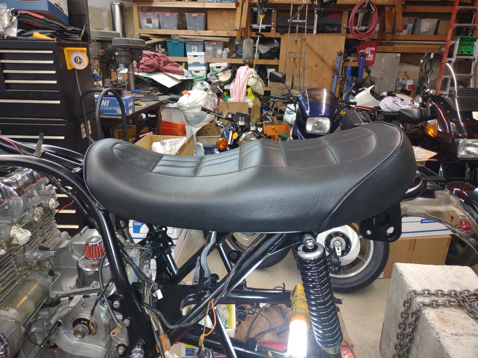

Yesterday we picked away at the wiring harness repairs and did the final fitting on the new seat. We also installed the battery box, electrical panel, rear brake master cylinder and pedal. I'm still working on smoothing the upper triple tree and refinishing the fork lowers.

Bike looks really good Kelly; you should be proud of what you have achieved and in a short timeframe
