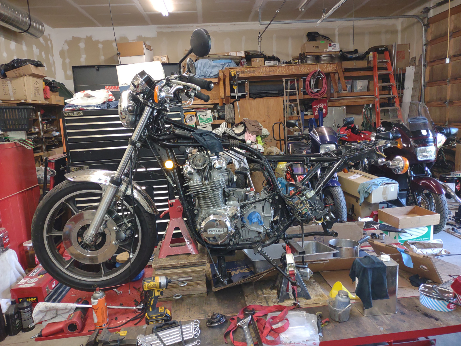

Today my buddy Paul started disassembly of the carbs. I pulled the rear wheel and brake system for disassembly and cleaning. I had to fill and use the parts washer because the bike is so dirty and greasy. The new seat came and I'll have to use the stock seat lock catch from the other seat.

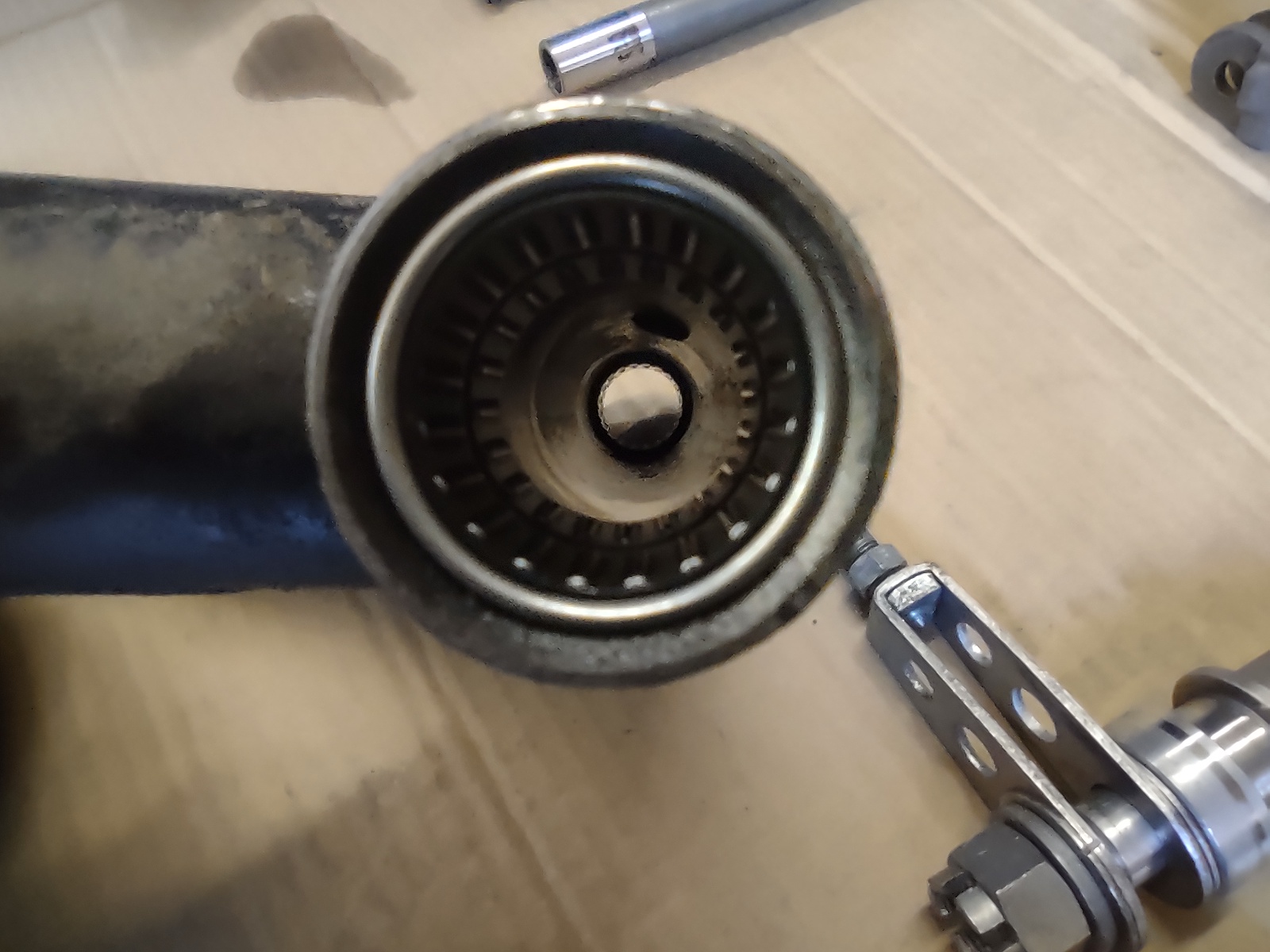

Today I pulled the swingarm out and found dual needle bearings on each side. I read in the Clymer manual that only ZR-1's got the dual needle bearings. Did the LTD's get them too?

Parts diagram at Partzilla says yes.

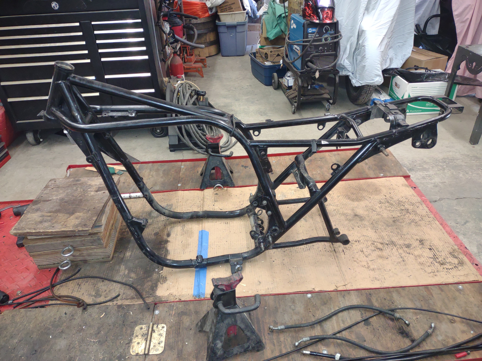

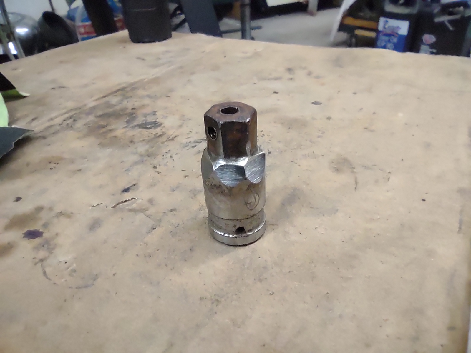

- Thanks: 477
Re: 77' KZ1000 LTD
08 Sep 2022 10:38 - 08 Sep 2022 10:41

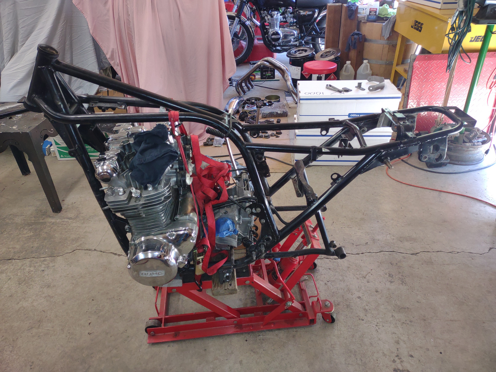

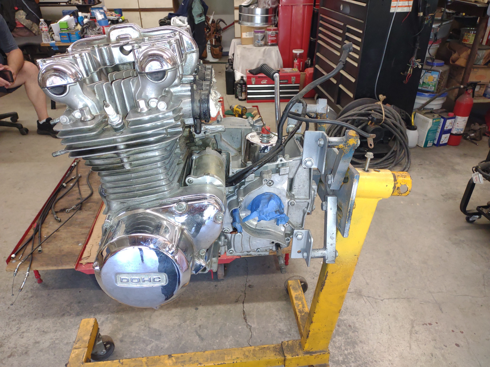

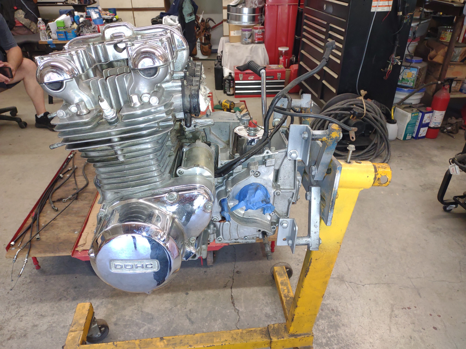

I decided to pull the motor to sandblast and paint the frame. Too much rust and scratches to look past. I finally got the front axle apart, the axle had rusty threads on both sides. I also had to make a tool from an old tool to take apart the forks. I'm learning that my uncle was a little bit lax on doing maintenance.

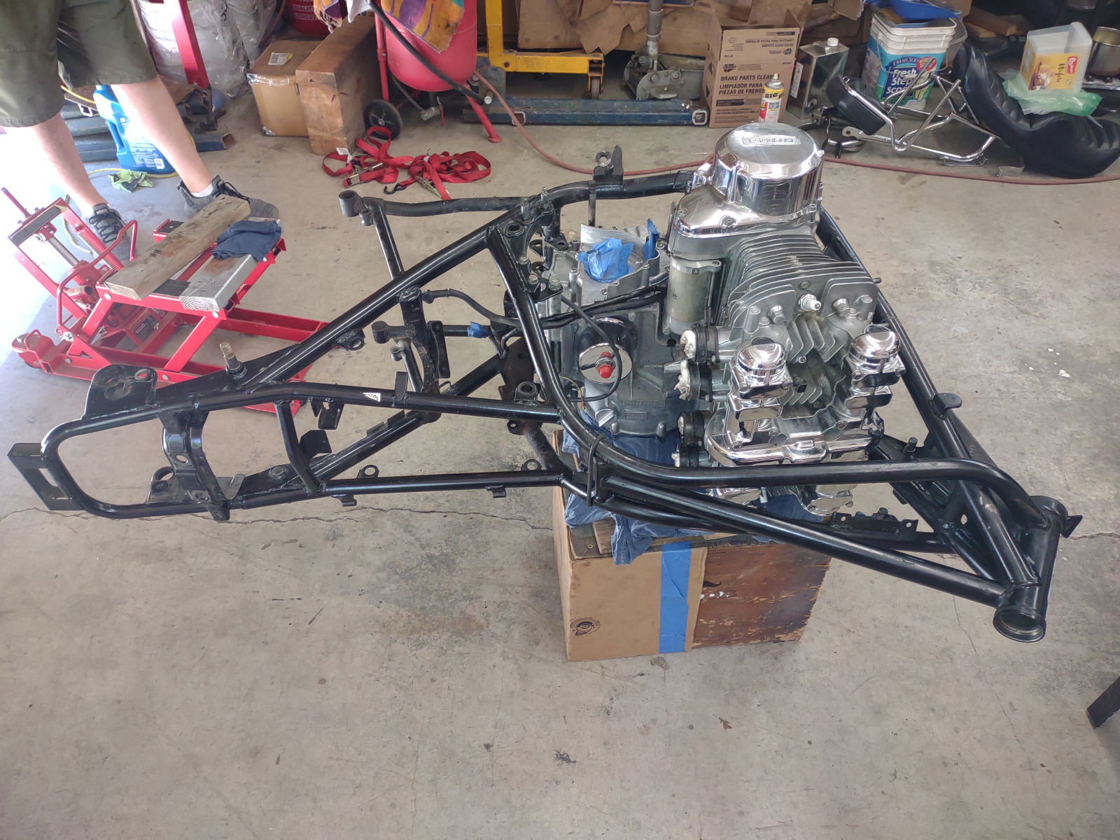

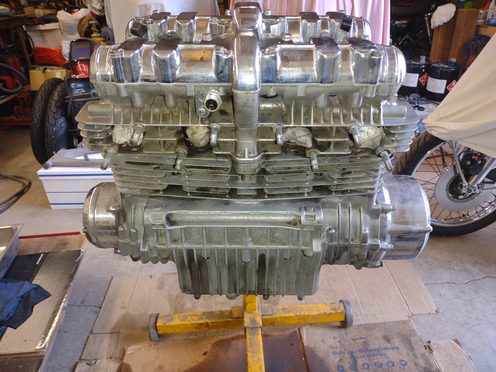

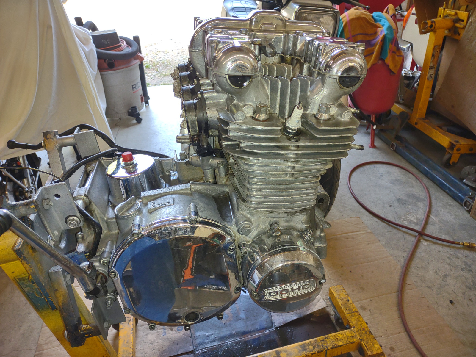

- Posts: 572
- Thanks: 477
Re: 77' KZ1000 LTD
13 Sep 2022 15:26 - 13 Sep 2022 15:35

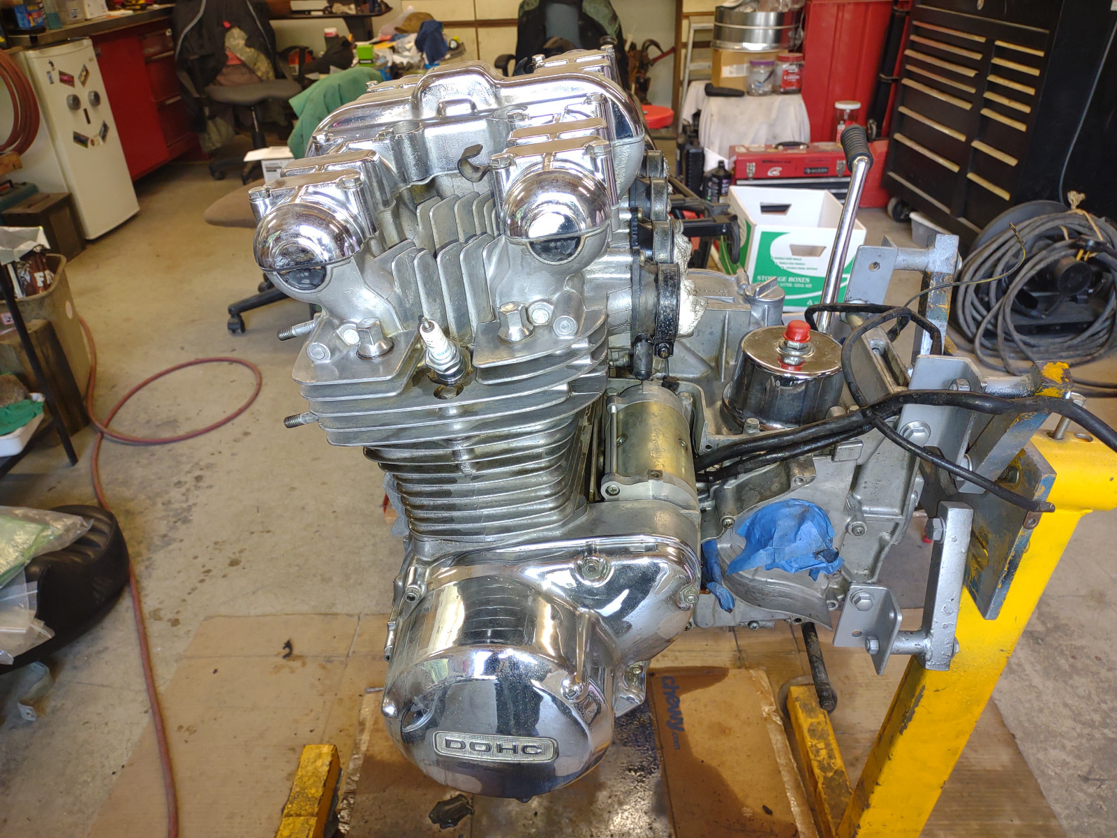

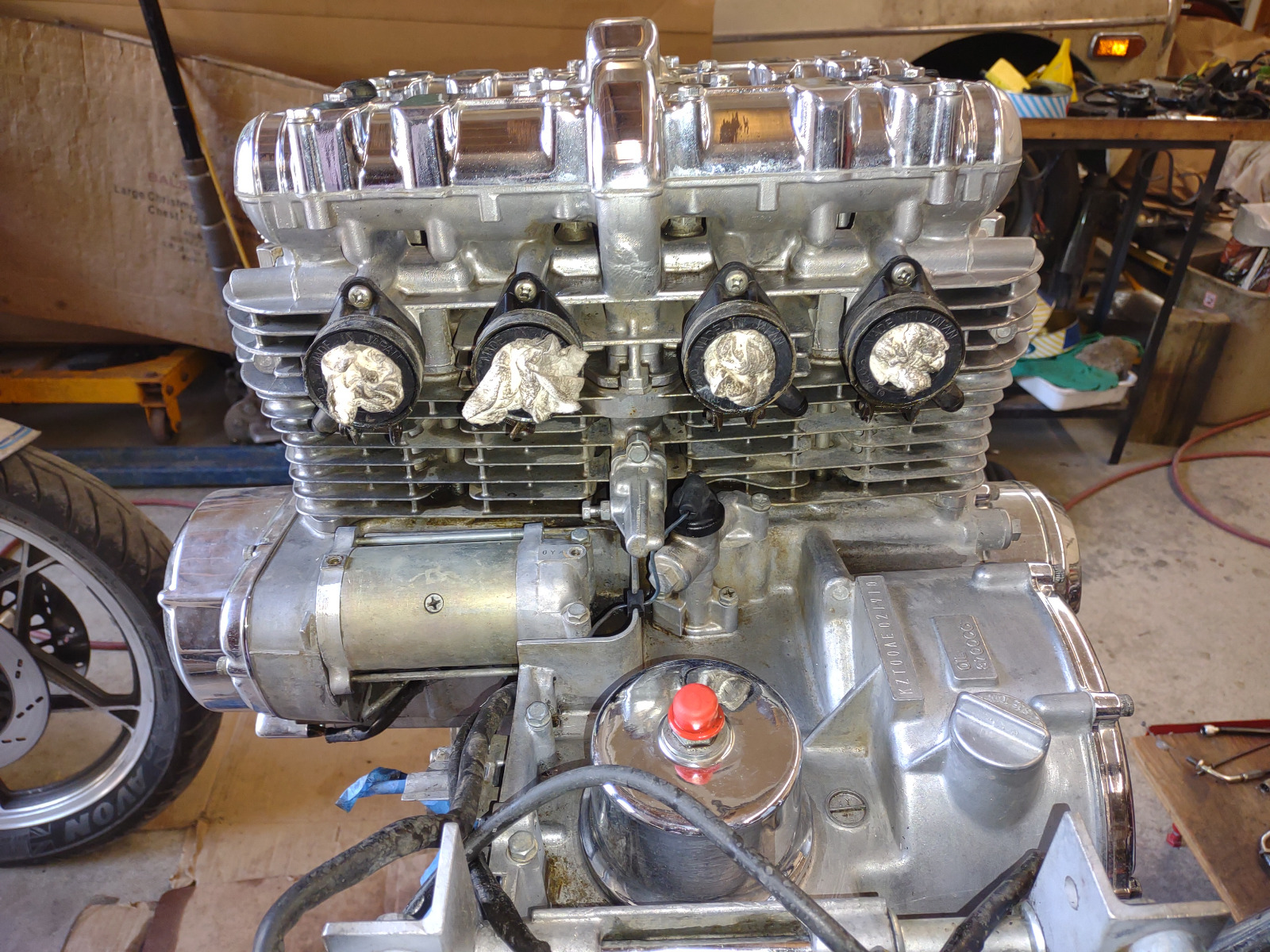

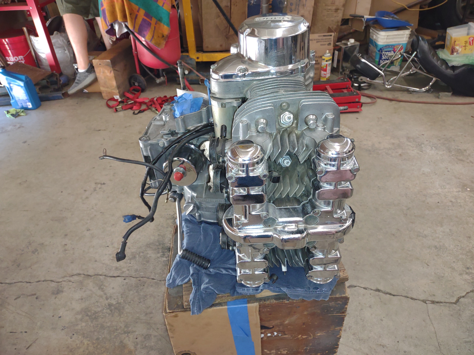

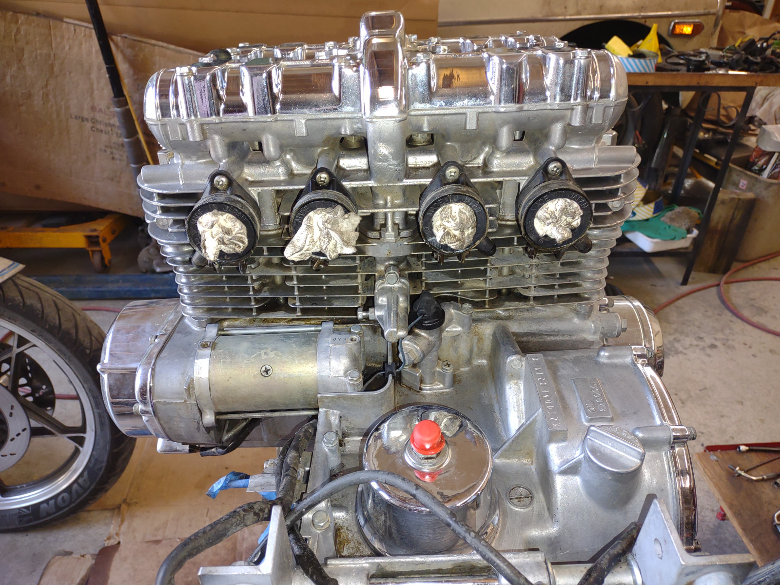

Well after 3 rounds of cleaning the motor is starting to look like it is made from aluminum and not 45yo baked on grease and oil. I figure it will take another 3 or 4 rounds of cleaning to get it looking even close to good enough.Still waiting for the blast media to blast the frame. Everything else fits in the blast cabinet including the swingarm.

- Posts: 572
- Thanks: 477
Re: 77' KZ1000 LTD
15 Sep 2022 19:47 - 15 Sep 2022 19:49
Today I started blasting the frame. I made it about 3/4ths of the way through it before I had to quit for the day. In the morning I'll go get another bag of blast media so I don't run out. If the weather cooperates it will be done tomorrow.
