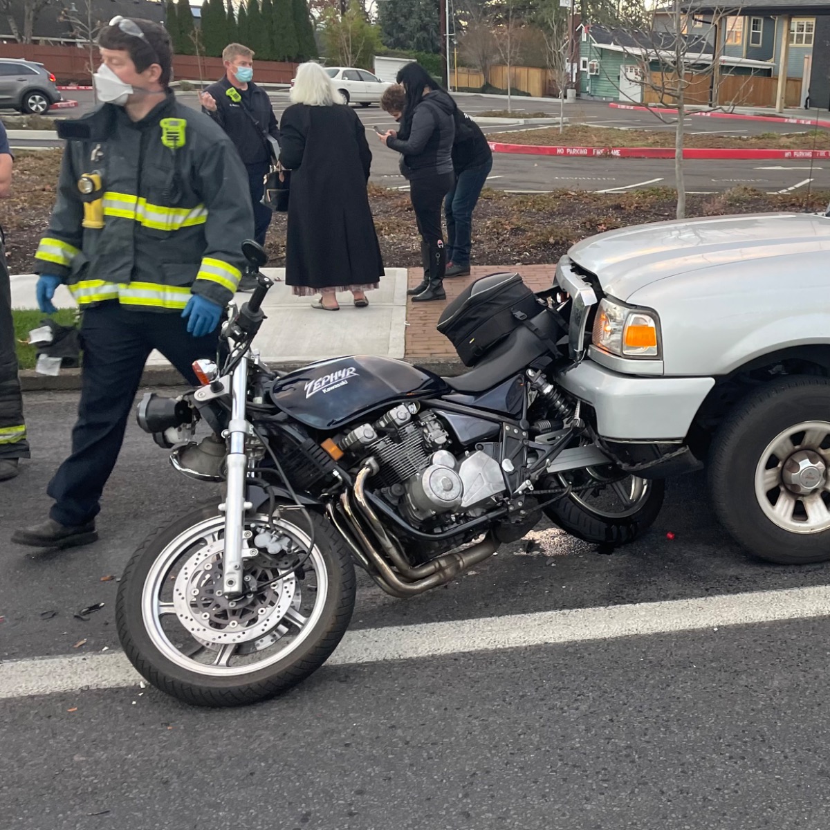

I’ve owned this bike for about a year and a half, and as documented in another thread , I was rear-ended, about a month and a half ago. Just to throw anyone unfamiliar in the deep end on it, here’s a photo from the accident.
So since then, I have largely been in insurance hell, but recently I settled, and I have a check coming in the mail, but I opted to keep the bike. The long and short of it, is that after careful inspection of the bike, I am confident that it is fully repairable, and that I can take care of it myself. I love this bike too much to give up on it.

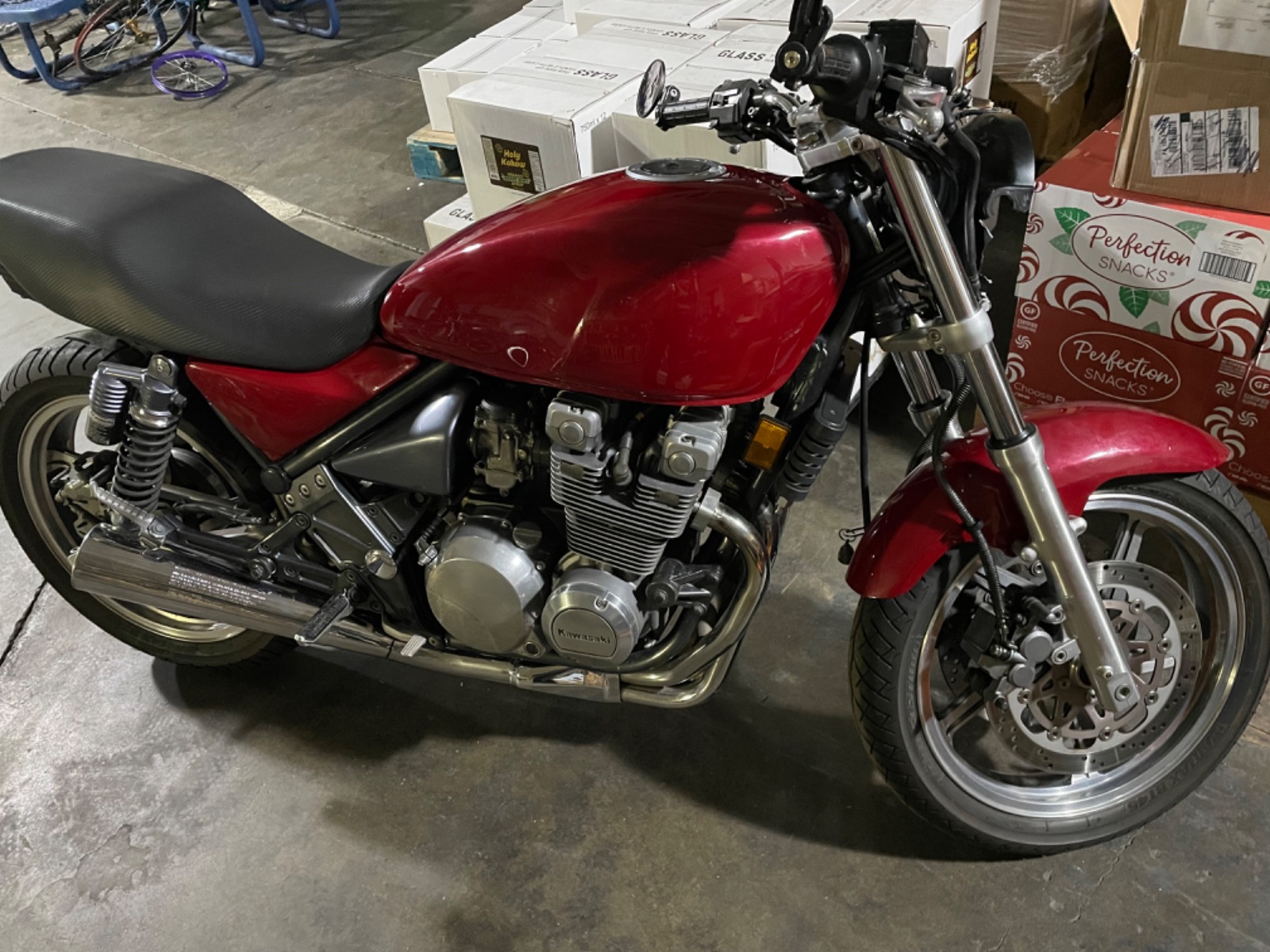

So far I have got replacement tank, front fender, side panels, and (not pictured) rear cowl, and headlamp. All sourced from eBay, and obviously in candy cardinal red, instead of the original candy Atlantic blue.
On the way, I have ordered a new gauge cluster, which I plan to use the good parts to transfer my old speedo/tach into, and a new right hand head lamp bracket. I’ve also ordered a new rear fender, but we’ll see if that shows up or not, since it seems like nobody actually has that part.
