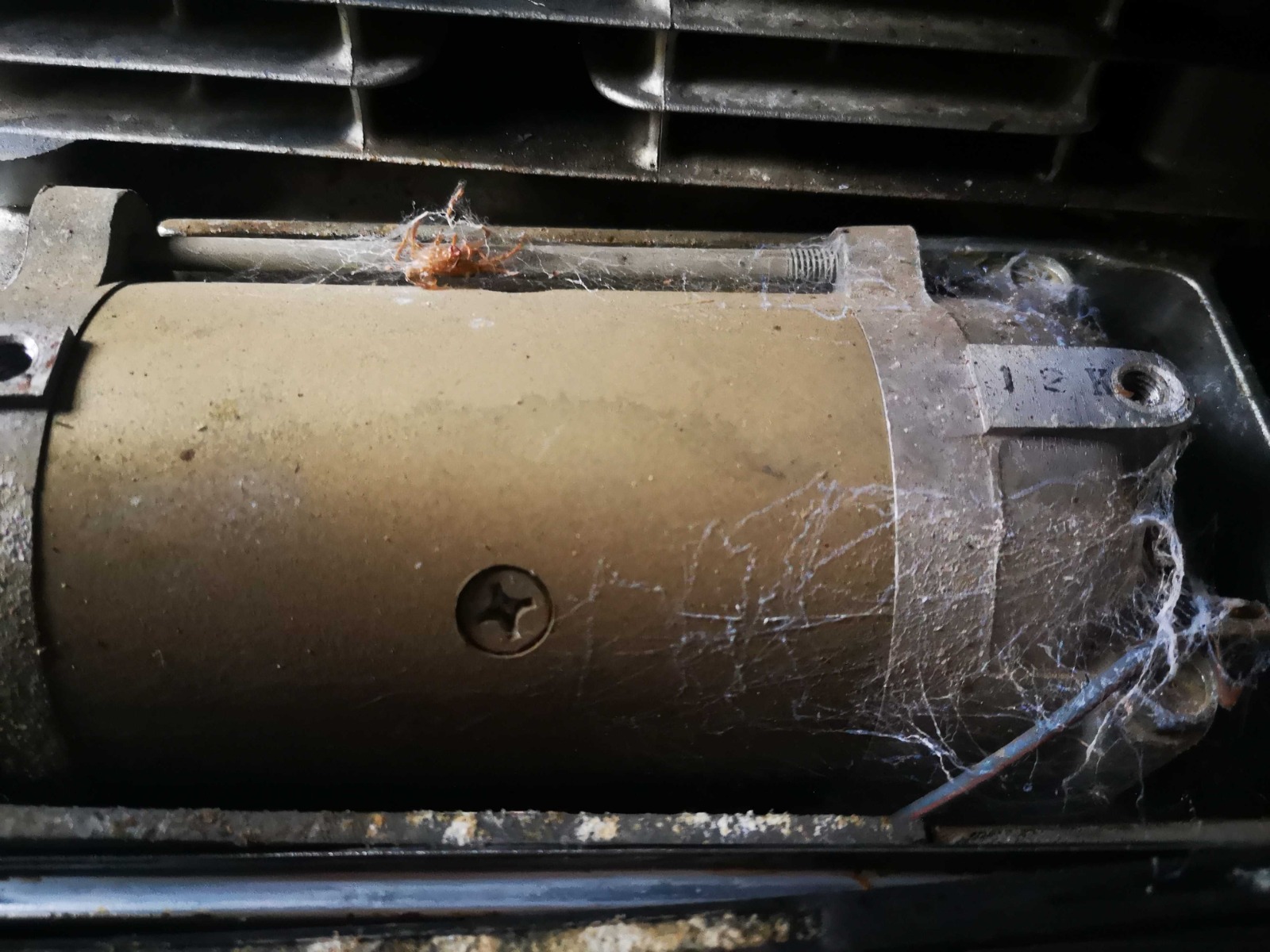

Behind the sprocket cover, there is a liberal amount of a spcial good-for-rust-prevention mix of dirt and grease and spider poop:
And here is the spider :

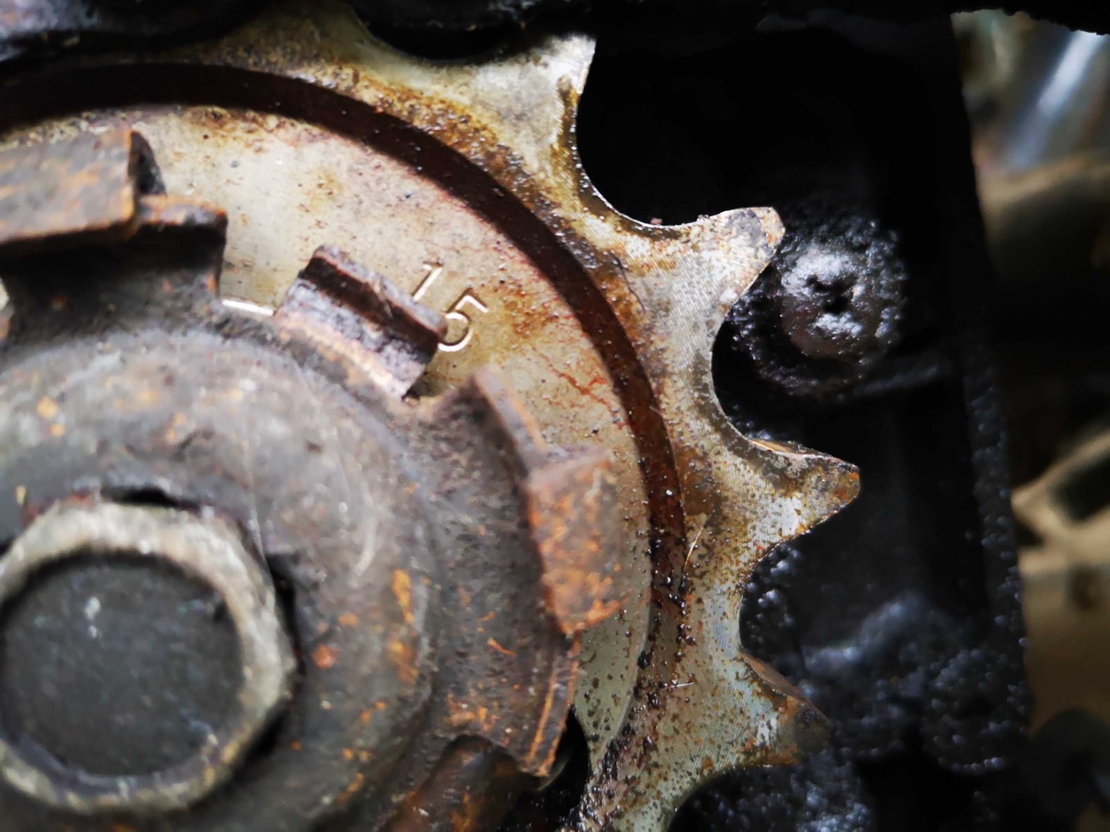

Another question for the experienced gearheads: Does this sprocket look healthy to you ?
(it does to me, I mean the teeth don't look all carved and bent like they did on my old XL600R which had seen copious amounts of wheelie practice)

Re: KZ1000 full spa
02 Feb 2022 11:45
The gear looks ok. But if your going to replace the chain get new gears. Everything wears together and lasts longs. Here’s the catch 22. If your replacing the chain go to a 530 if you don’t already have that side.
The following user(s) said Thank You: KZmarcel
