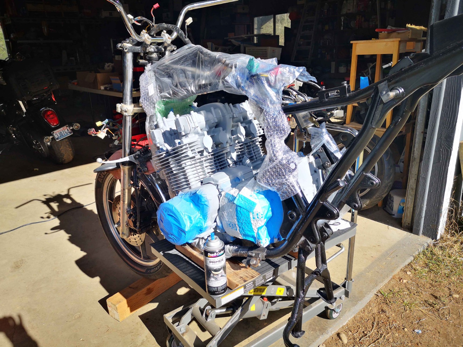

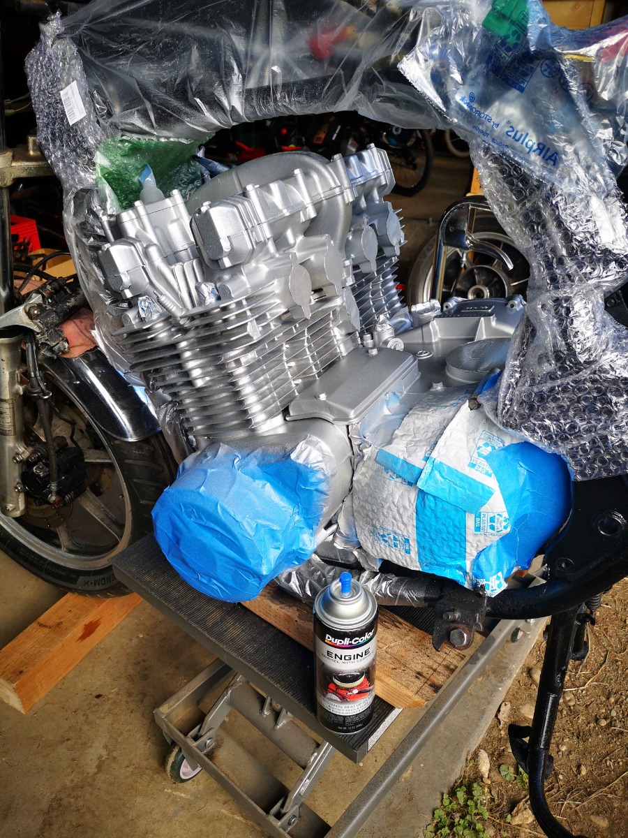

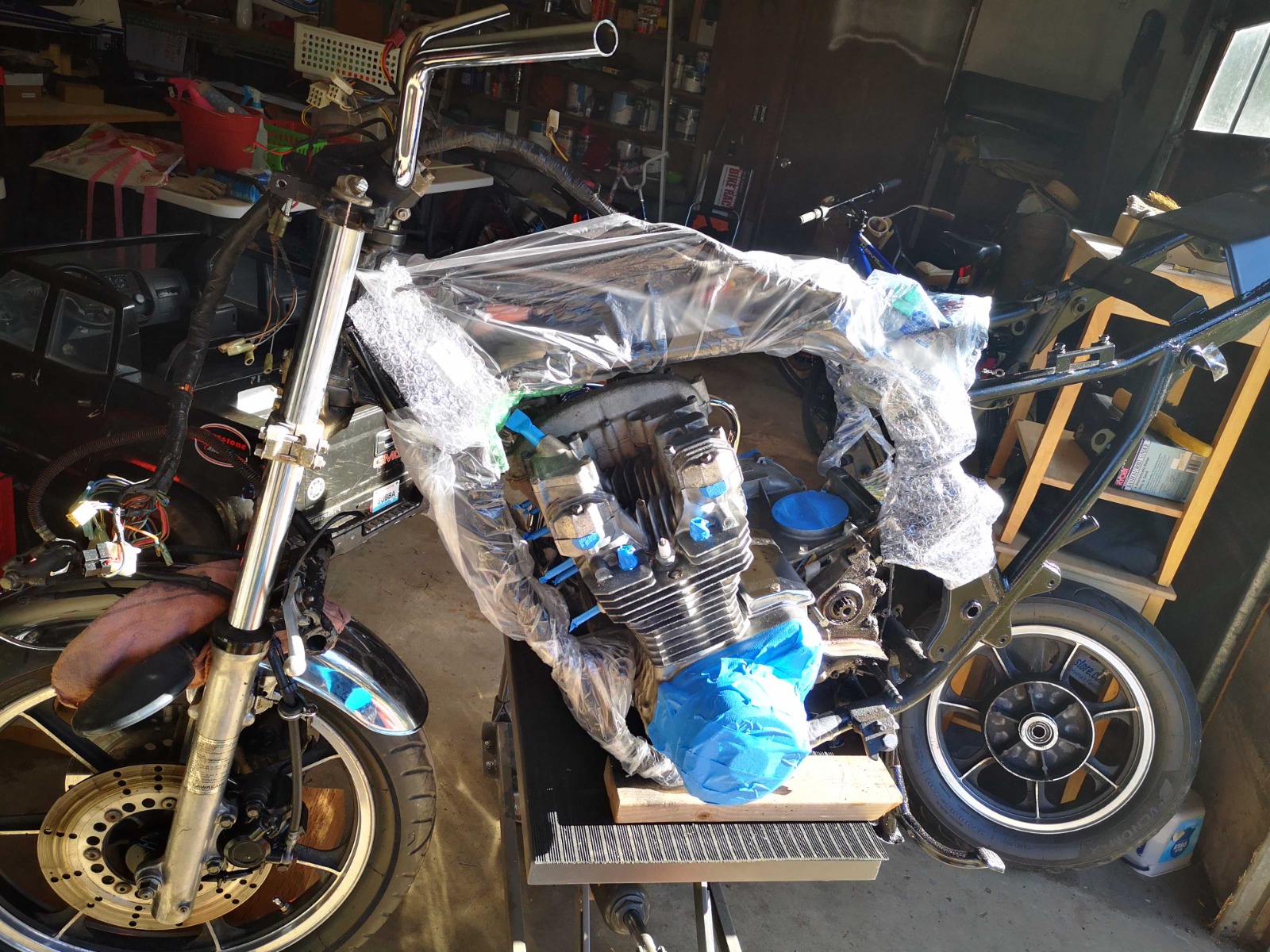

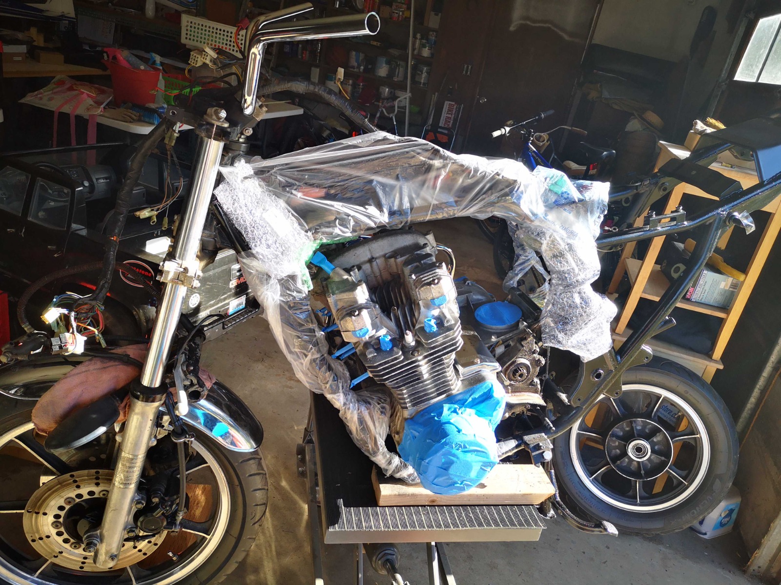

Awright, moving on, today was sunny in WA state so I launched into the painting of the engine block.
Had been working on masking stuff for the last few days, including wrapping the frame with plastic.
So, here it goes :
wrapped
primer
paint.
So, here it goes :
wrapped
primer
paint.

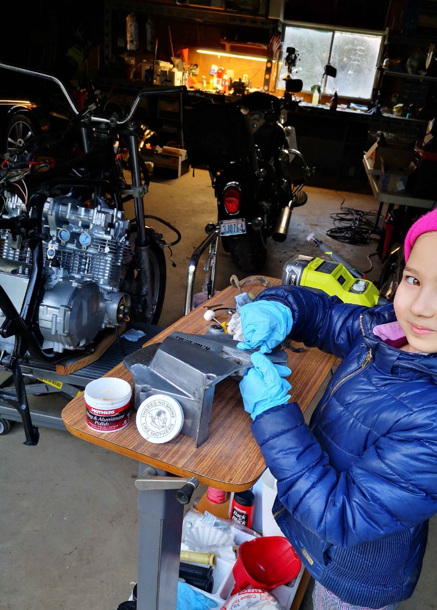

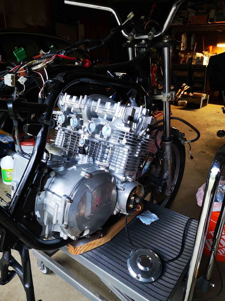

So, pretty happy with myself, this block gonna look real guuuuud.
Next is gonna be working on polishing these various covers to a mild shine. I'm not aiming for chrome mirror effect, rather for a simple clean shine with a slight vintage patina.
Luckily, I have an enthusiastic helper, my 9yr old girl.

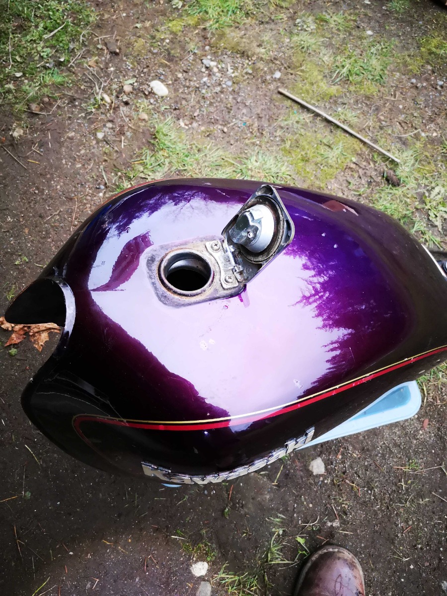

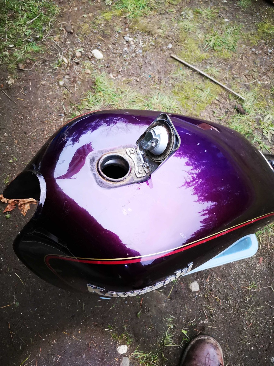

I intend to keep the exhaust if I can, will get to that later...

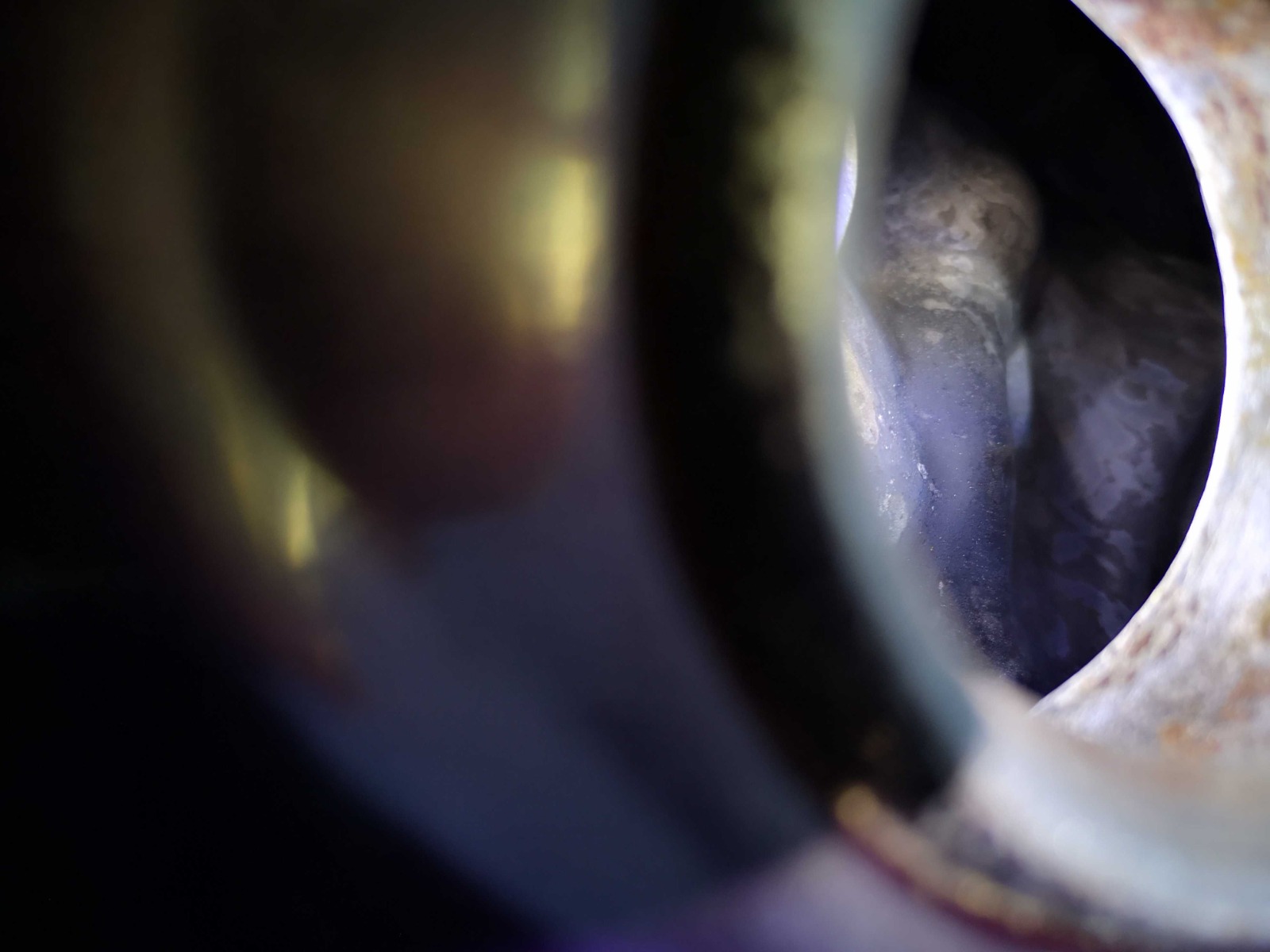

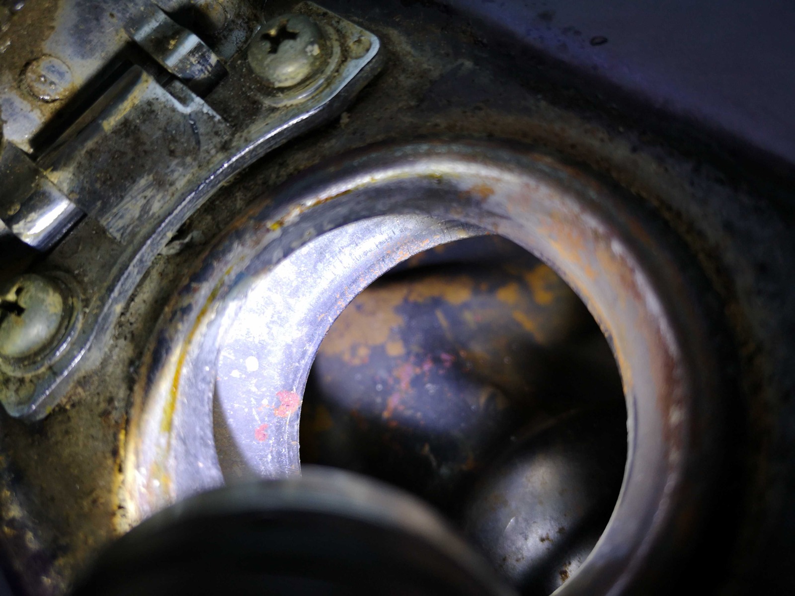

Regarding teh fuel tank, I've done vinegar followed by Evaporust, and a misting of WD40 while I wait for the restoration to progress. Tank / rusty before / clean after:
