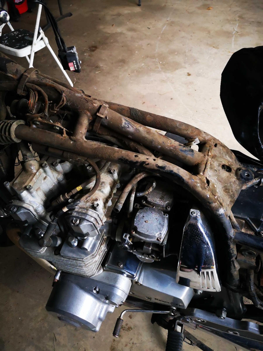

I will start here the "blog" of the "full spa" restoration, not a concours attempt, just a fairly thorough bubble bath and scrubbing of the old gal who looked very neglected.

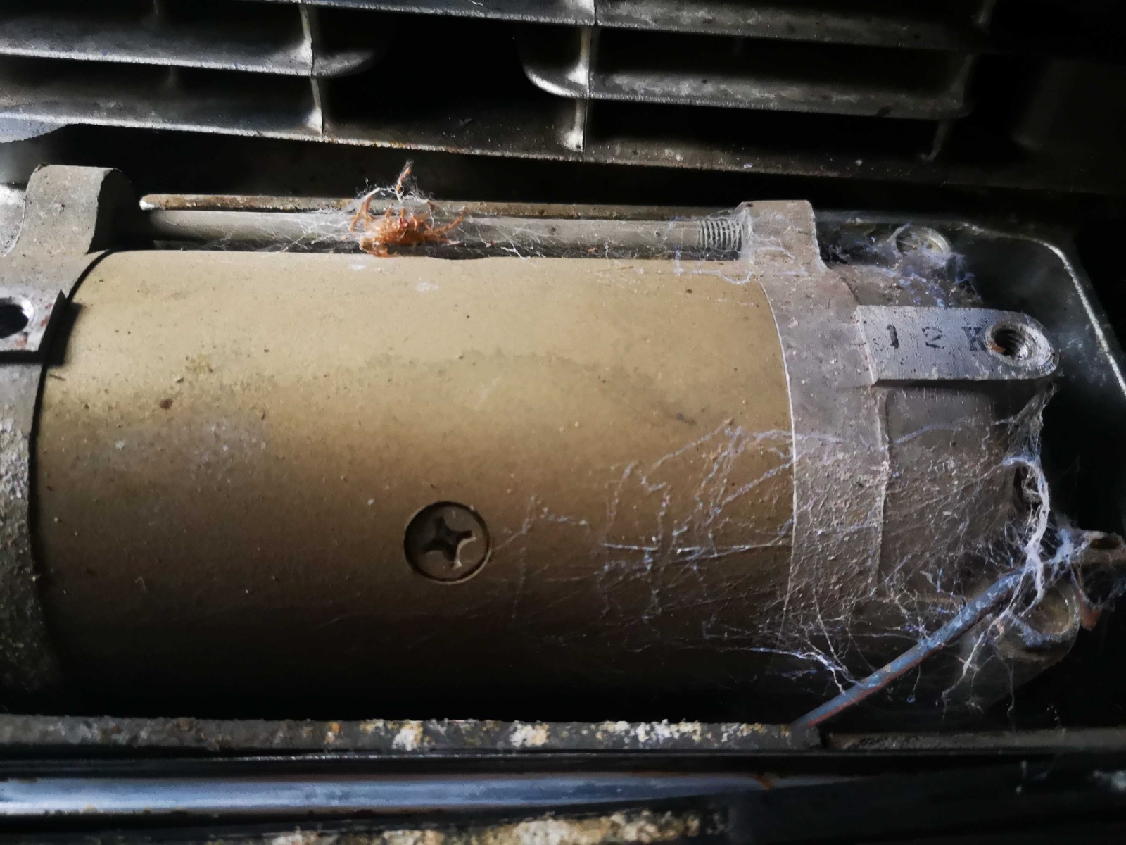

Behind the sprocket cover, there is a liberal amount of a spcial good-for-rust-prevention mix of dirt and grease and spider poop:
And here is the spider :

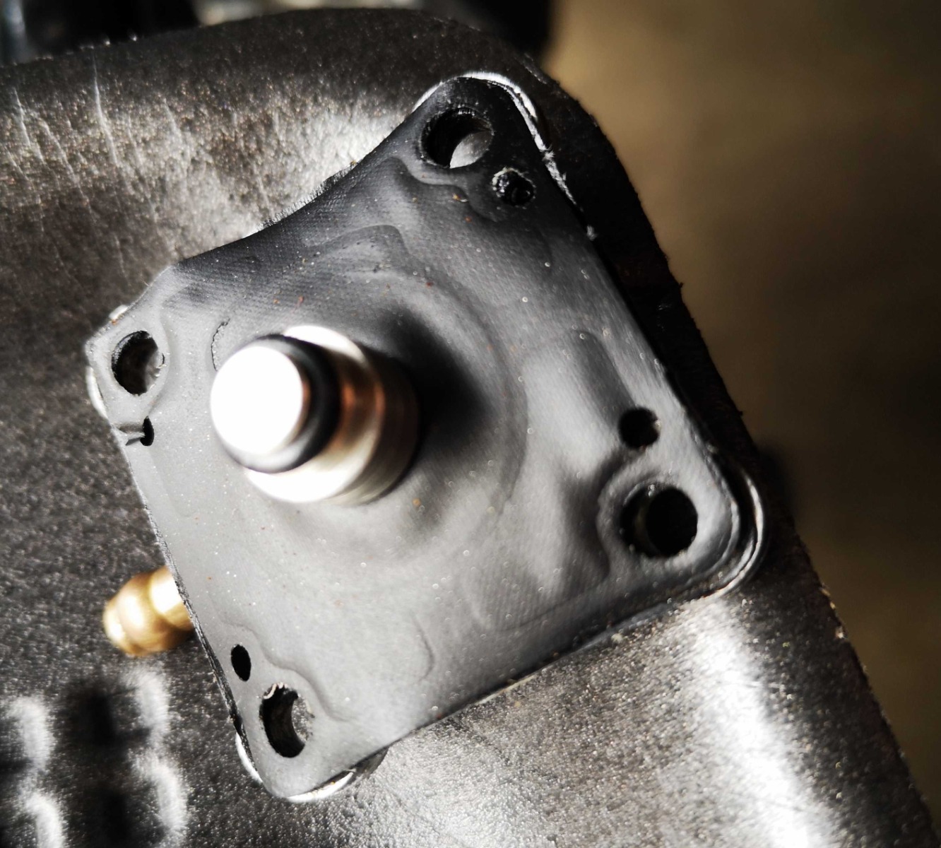

I have one question, regarding my petcock.
Would y'all say that this diaphragm is good enough, or needs replacing ?
It did not seem to leak before I removed it.

Looks like you will be little busy. I would look for a full petcock rebuild kit.

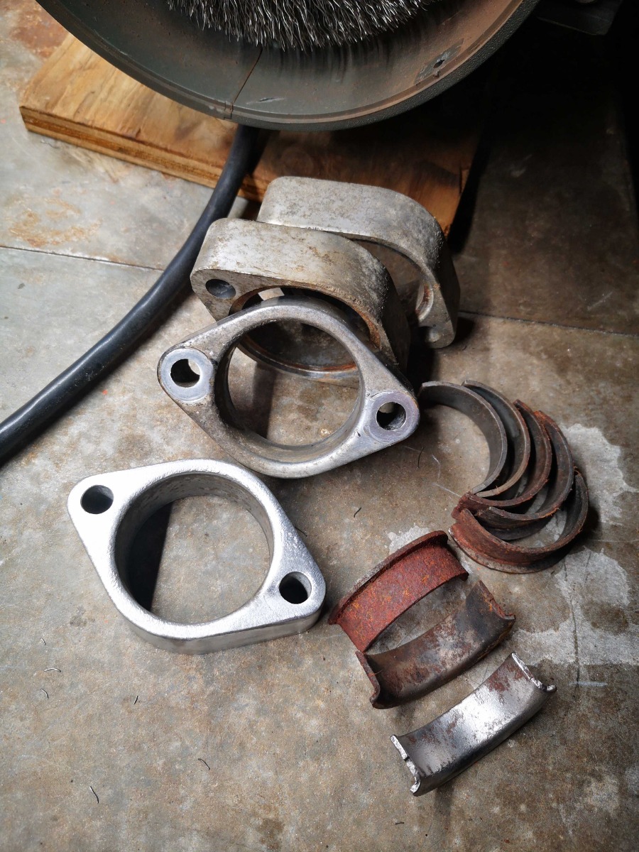

02 Feb 2022 01:12Thanks, I'm ordering a kit from z1enterprises.Looks like you will be little busy. I would look for a full petcock rebuild kit.
Next question: exhaust clamps and collars.
They have a susbtstantial patina of rust.
See below a photo where one collar and one clamp have been wire-brushed (the collars are trickier to scrub, I can finish with a rotary tool).
Would y'all think they can be re-used, or are they too pitted ? (especially the collars)

A steel wire brush on aluminum parts create a rough surface. A brass wire brush on soft and sensitive surfaces like alu gives you a smooth finish.

02 Feb 2022 06:16Yes. Well these exhaust clamp/collar items are seriously crusted so they need the big wire wheel. For the engine covers, I'll go more gently for sure....A steel wire brush on aluminum parts create a rough surface. A brass wire brush on soft and sensitive surfaces like alu gives you a smooth finish.
But are you meaning that the exhaust clamp/collar items need a smooth finish, in order to perform their function ?

The pitting on your exhaust collars and clamps is purely cosmetic, and will not affect the performance of their function.

02 Feb 2022 08:45 - 02 Feb 2022 08:46Thanks Skidmark,The pitting on your exhaust collars and clamps is purely cosmetic, and will not affect the performance of their function.
I'll scrub the clamps and the collars (even if they'll be hidden from view) and reinstall them... soon.
