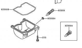

I think you could say the screw definitely has a specific purpose. It's not just a standard screw, it's tapered at the end, and has a ledge for holding an O-ring. Here's a picture.Wookie58 wrote: Ref the screws, unless they have a specific purpose "air screws etc" they are generally easily replaced.
It's 92009 that looks like mine, I'm not sure why it shows a slightly different screw there labeled 92009A.

If you figure out the thread pitch, you can spend some time with a file and make new drain plugs from plain bolts; I think the o-rings are just to keep out dirt, the variation shown in the parts diagram looks to have a head that would cover the opening entirely. EDIT: Checked the diagram. 92009A has a different thread pitch as well.
I would cut some slots in your existing screws and use a flathead, since that's a cheap and quick solution. They don't need to be more than a little snug.
If you're set on allens, you may be able to find some from a different model that fit - can't say which, just a thought. My ZX600J has allen drain screws but I think they're too fine.
