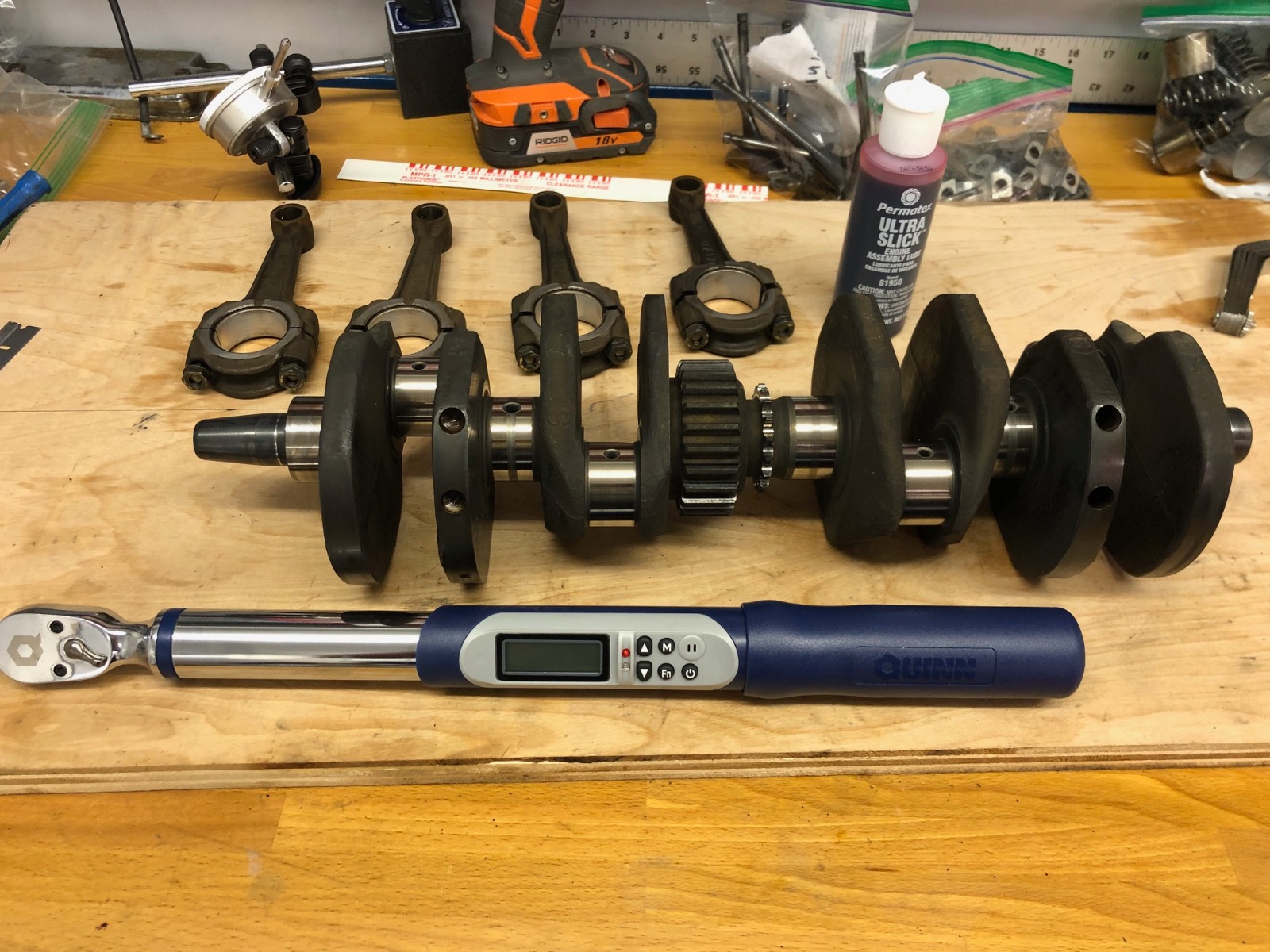

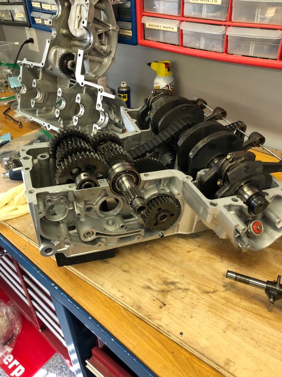

Getting more confidence. Measured rod clearance and side clearance. All well within specs. Getting very close to reassembly.

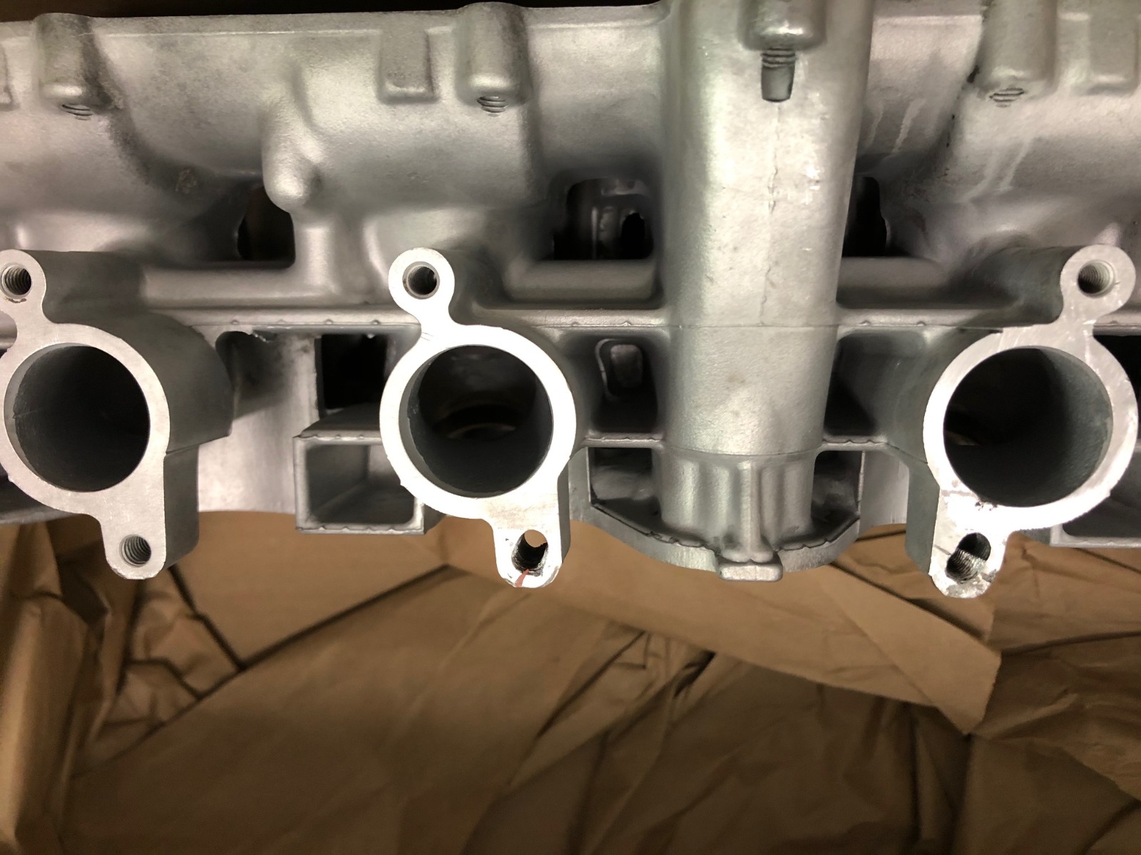

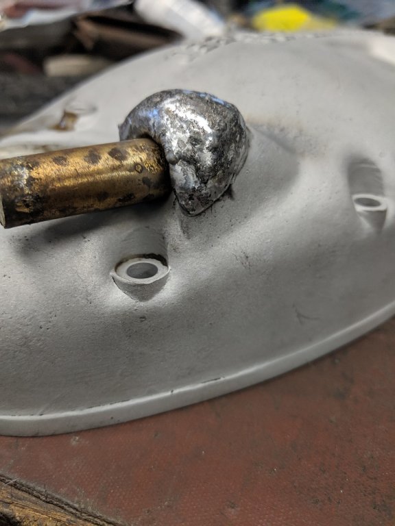

Head update. Got NOS valves (all
, new APE guides. Found local shop with great reviews. Took it there today, waiting on estimate
I asked them to fix intake threaded holes, plug emissions and replace guides with 3-angle valve job.
The biggest concern they have is intake holes

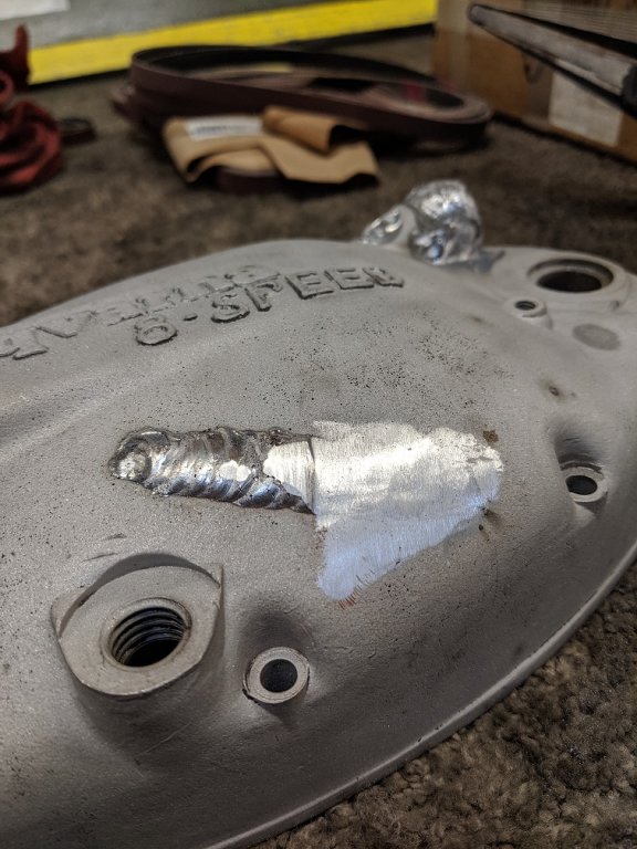

Yes, I kind of regret I didn't get TIG, but I don't have a way to machine flat afterwards. I think they either don't have TIG in a shop or they don't feel like I want to pay for this. In any case - will wait what they say after they look at it in detail.

Yeah, I'm lucky to have a guy that is awesome with cast aluminum, says they hold a lot of oil but with the right cleaning are pretty easy to weld. As for the machining and stuff you have to get the surface flat, I use a large piece of sandpaper I get from a place with a sanding machine like a planer, It's the worn out sanding roll that they change out. It s pretty big, like 36"w x 60"l . I use it on all my surfaces and all cases that will use a gasket, has worked really well so far!! Knock on wood, Chris

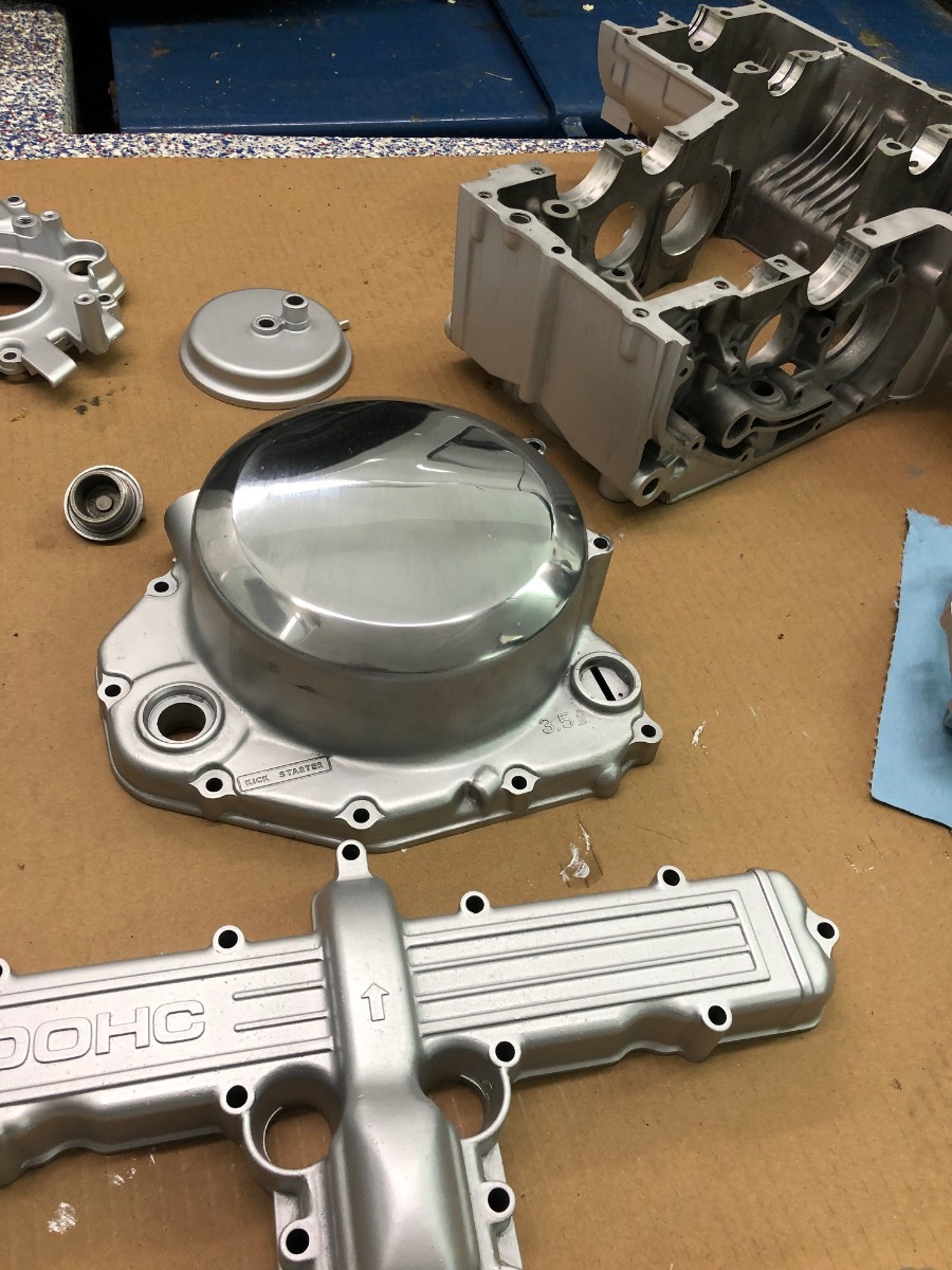

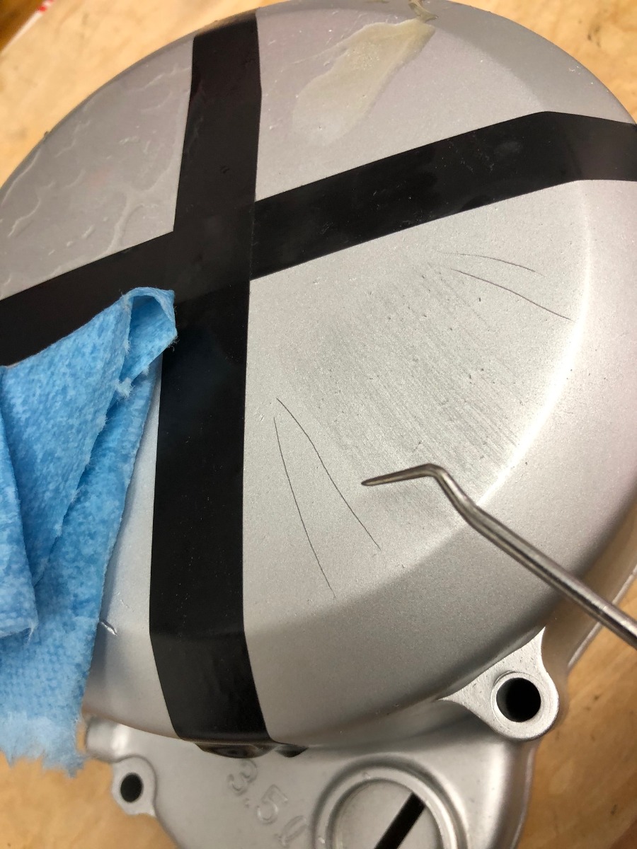

Spent some time cleaning/sorting engine parts. Test of cerakote as promised.
Oil, fuel and brake fluid does not bother it.
Scraping with pick obviously works
Scuffing - no. Scraping with blade - takes paint off. But no flaking or signs that it didn't adhere. So, in my book - it works.
I also tried polishing. Not like gazz but works for me. I didn't take too much time, took me maybe 40 minutes to do this round section. With what I want - I can handle it.

Thanks, nice job on the polish. The big test of the Cerakote will be how it stands up to bolts being tightened. That’s were I see my choice of coatings fail.
- katit
- Posts: 460
- Thanks: 47
Re: Katit's 1978 KZ650 project
22 Apr 2021 10:19Right. Coating does not feel extremely hard. And it's very thin. If anything I expect it to scratch without chip/peal. But will see. Will keep you updated.Thanks, nice job on the polish. The big test of the Cerakote will be how it stands up to bolts being tightened. That’s were I see my choice of coatings fail.

25 Apr 2021 14:09
Spent multiple hours cleaning every thread. This is after multiple cleaning and washing. Lot's of media left on threads (after bead blasting). Now all clean and preliminary assembly (not final) started to see what else I am missing. All parts cleaned, tedious work of checking all my records, parts fiches and book started..
