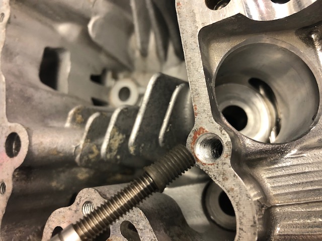

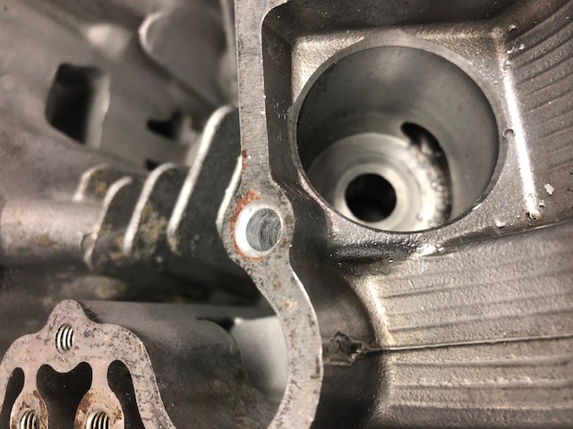

19 Mar 2021 10:56Other head with missing cap also has at least 5 cap holes with ruined threadI blocked the emission holes by tapping them (from the valve cover side) and then screwing in a set screw with some red threadlocker.
If you have a good head that is missing a cam cap try pulling the valve train and bolting in a cam. try several different cam caps from the other head you have. If it turns over easily by hand I wouldn't hesitate to run it.

Oh, and I'd use helicoils to repair the threads for the cam caps. It's quite easy and cheap, while being a quality repair for stripped threads like those. Just be sure to use a drill press to make the holes. I also think you should at least try to see if mixing and match will allow you to find a good cam cap to replace the missing ones. Can't hurt to try anyway. Plastigauge can be used to check the clearance.

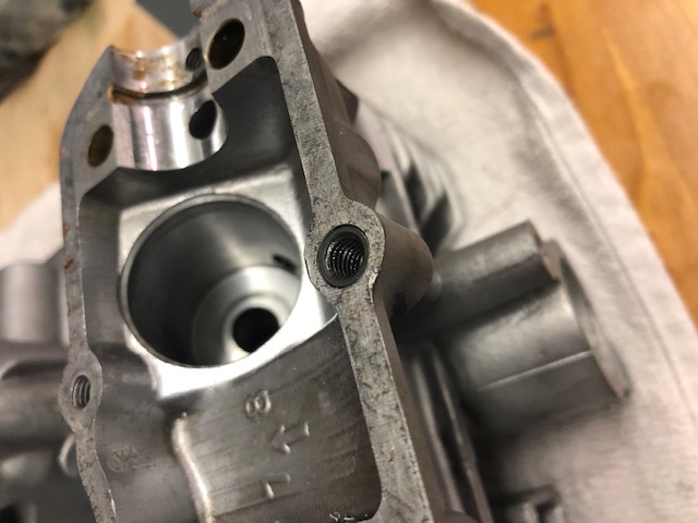

Ed, Why helicoils vs time-sert? Time-sert look like much more solid solution.
As far as "missing caps" - I don't have any in 2nd head I have. Thats why I am planning on using it. In this head I have 3 issues with threads. One on cover (not cap) which is easy. And 2 on carb mounts which I don't think going to be a big deal either. Other than that - all caps in place and threads is good. Of course measurments to be made.

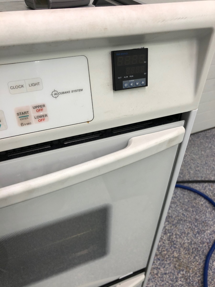

"Oven project". So, oven needed to heat parts to get them cerakoted. Ok, ebay had some parts that supposedly "fixes no display issue". Here we go $30. Replaced parts. Nope. Ok, then I figured that I just needed PID controller and wire elements directly. Finally got cheap inkbird controller and got over working. Now it hold temperature precisely.

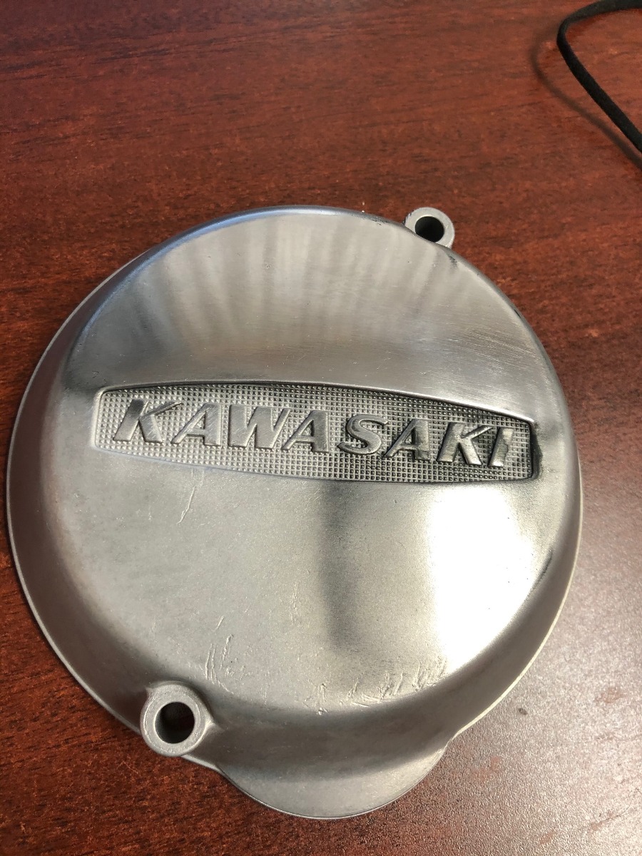

Question about engine covers. I started polishing just to see how much PITA it is. Not bad, actually. So, I am going to polish covers, decided. On cover on a pictures, what should I do with lettering and those "dots" on background? How do they come from factory?

Polish it, tape that area off, spray it black with engine paint. Once it's dry, remove the tape and sand the cover with something like 2000 grit sandpaper on a block to remove the spray paint from the lettering and such. Then polish again if needed.

06 Apr 2021 08:08Should it be gloss? Any recommendation on paint?Kaylinator post=846244Polish it, tape that area off, spray it black with engine paint. Once it's dry, remove the tape and sand the cover with something like 2000 grit sandpaper on a block to remove the spray paint from the lettering and such. Then polish again if needed.
Is ring around need to be black as well?
I am thinking painting first (after blasting) and than sanding and polishing. This way I won't have to sand twice. Any reason to do it differently?

Mine was a semi gloss and yes, the ring was also painted. Ed

I found it was better to sand and polish once first so you spend less time polishing after paint. Helps to ensure you don't end up taking some of the paint you want to keep off.
As for paint, I just used Rust-oleum semi-gloss engine paint.

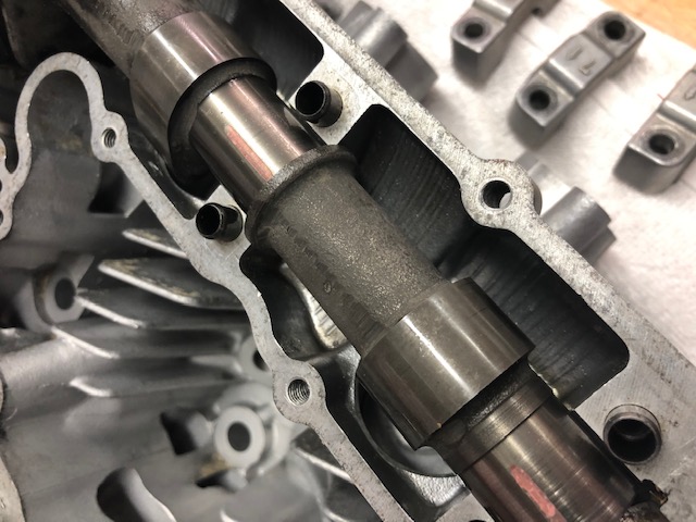

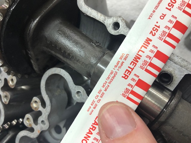

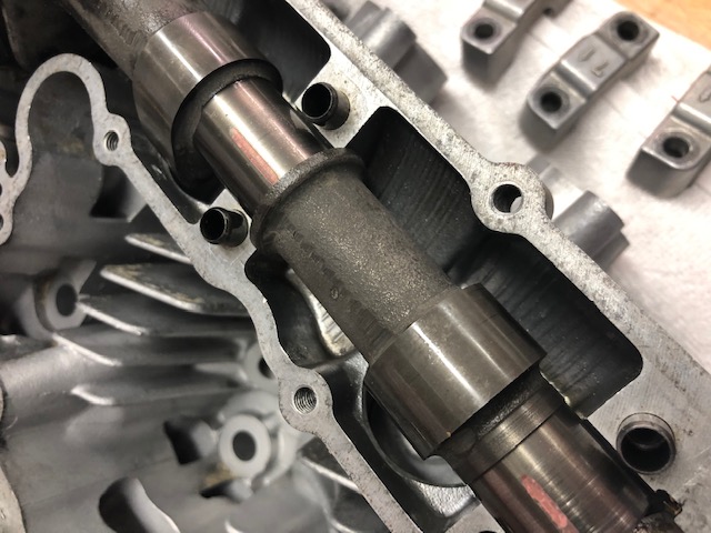

11 Apr 2021 17:57
Worked with head. Measured camshafts - all in specs, very little wear. Fixed 2 threads for cover - love timeserts. First one little too deep, but now I know. Dab of silicone will hold it not problem. Will take to shop, let them fix 2 intake threads..
