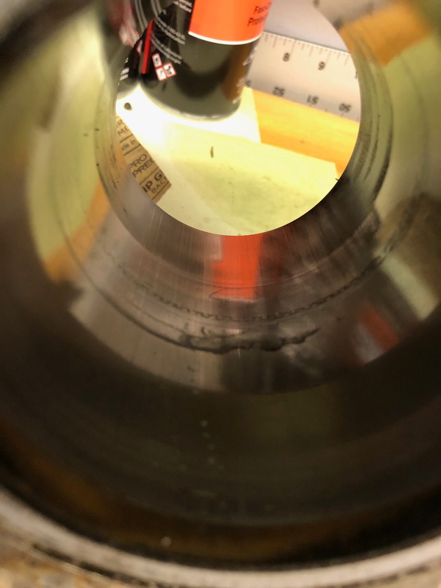

Finally got time to do some more work. Well, first of all head has to come off anyway. If head comes off- cyliners have to come off as well, gasket need to be changed anyway. With so much dirt I feel like engine need to come apart as well. Or maybe not. But if I don't do everything (check whole engine) - I might be wasting gaskets and time.
So, with head it's clear - need to be replaced (will see what other spare engine head look like). The one from a bike has most of the cam lobe bolts stripped and one lobe (#
incorrect.
Question about cylinders. See pic. Seems like bike was parked for awhile and pistons stuck and corroded to cylinder walls. No scratches. But no hone marks either. Cylinders wear like a mirror. I can't feel anything with a nail when checking those spots.
Course of action?
A. Measure pistons and cylinders. If all in spec - clean up, replace rings, hone cylinders and go.
B. Buy +0.25-0.5 piston kit. However, not sure how good those $200 "reproduction" piston kits are.
Course of action?

If its got a rust ring from sitting you really need to re-bore. You might get away with a hone and new rings for a while but i would bet you will be revisiting this issue in a short amount of time.

02 Mar 2021 15:28 - 02 Mar 2021 16:10DoctoRot wrote: If its got a rust ring from sitting you really need to re-bore. You might get away with a hone and new rings for a while but i would bet you will be revisiting this issue in a short amount of time.
What is my options to make it right then? Looks like NOS pistons sold by each, hard to get "kit" and then rings, etc - get's expensive and hard to collect.
2nd choice is reproduction pistons at ~$300 - set with rings IMDPistons from UK
3rd choice - Wiseco +2mm kit ~$600. This one looks interesting. Is there enough in stock sleves to go +2mm. Is it good idea? Adjustments to carbs/other needed? I am not really interested in more power, but I want reliable quality parts
4th choice - cruzinimage - most affordable, $150 for kit?

The Wiseco pistons are probably the most popular option on this forum. I don't have experience with IMD, and limited experience with Cruzinimage, just used their rings with mixed results. Maybe some other member can chime in here on IMD becuse they look like a good inexpensive option. Don't forget to budget $60-80 per cylinder for bore and hone.
Another option would be to get a good used block and fit some new rings

If your pistons are in good condition you could have your block resleeved and bored for them - that may be the least expensive.

03 Mar 2021 08:16ghostdive wrote: If your pistons are in good condition you could have your block resleeved and bored for them - that may be the least expensive.
Hm. Thats an option too. But still need rings. Pistons look good. I have another locked up spare engine which might be even better.
The only problem - work quality. Complexity of work (resleeving) goes up, cost goes up. Potential for error goes up.
I searched for cruzinimage here on site and people give them good reviews. I also searched online and found good reviews. For $150/set I can't see how it will be any cheaper to resleeve.
Wiseco at $550 for +2mm looks like a quality option. But question stands. Will +2 mm throw tuning out? Will it require rejetting?
Any suggestions for good shop to do cylinder work?
I want it to be done right. But at the end let's be realistic. I won't put 10k miles on a bike in my life. No need to build it to last forever.

Shipping a block is expensive so that will factor in to the price. APE does boring and honing at a discount if you buy the piston kit through them - they sell the wiseco kit. The bigger bore and higher compression of the Wiseco pistons will require rejetting. I think they are drop in other than that, but i would double check. I use LA sleeve for my machine work as they are down the street from me and do great work at a reasonable price.

The cruzin image pistons are excellent value for money, I'm fussy as hell and are buying them for my GPZ750/810, i'll be running higher compression and bigger cams and am not worried about them one little bit. My friend is a mechanical engineer/mechanic and he's used them on everything form Kawasaki's to CBX1000, to CB750 honda's with absolutely no problems, and this guy gets 130 RWHP from a methanol slurping cb750 engine, so I'm quite happy to accept his opinion. I was told that the IMD pistons are the same piston, just with a top heat coating, I was also told the pistons {both IMD and Cruzin image} come out of Korea not China but I don't know this for sure...
