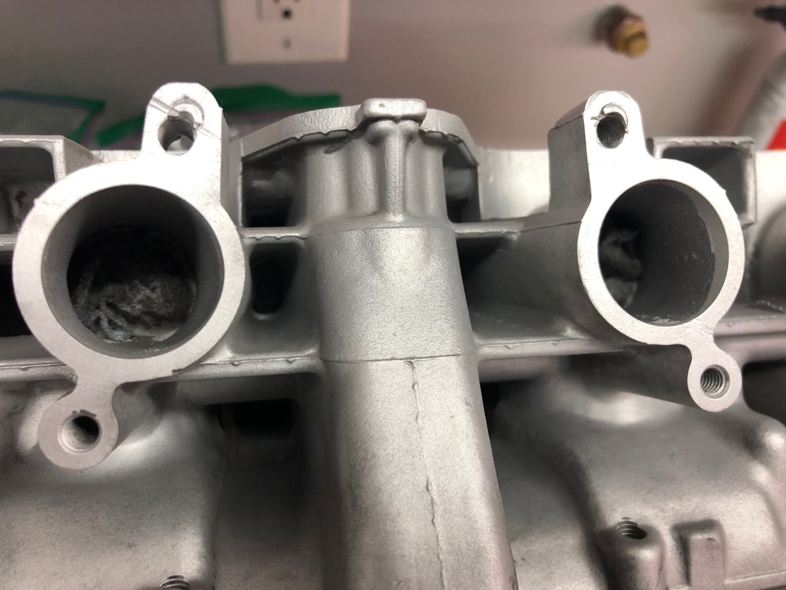

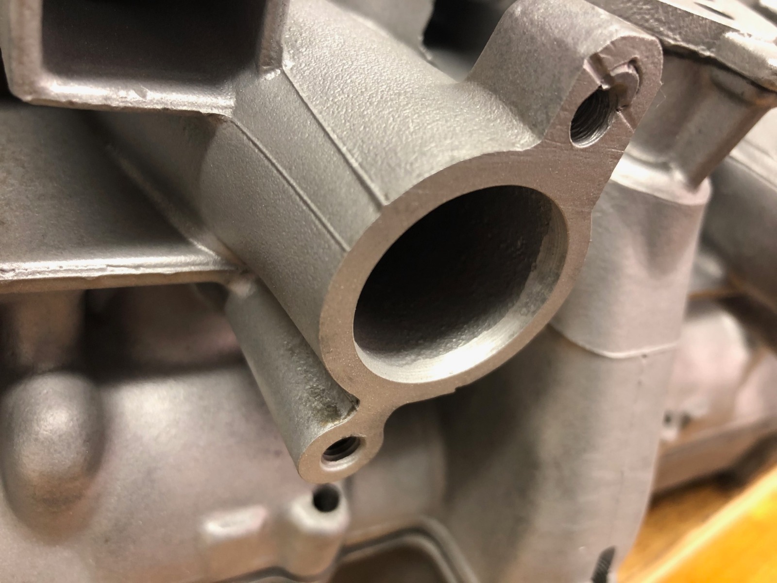

Started cleaning up this head. And dang.. Whats wrong with those people?
2 of the intake threads messed up in a bad way. No easy timesert here. Any suggestions on repair?

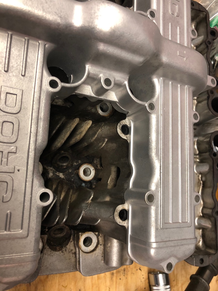

And.. What do I do with those emissions holes? I want to use my cover

Have you tried chasing the threads with a tap? Just a guess but I think it would be M6 by 1.25.

18 Mar 2021 12:13Look at pictures. Threads IS there. They just not in correct spot, about 3/16 off center, putting intake manifolds in a bind. Someone broke bolts but wasn't able to correctly extract broken bolts making it even worse.Have you tried chasing the threads with a tap? Just a guess but I think it would be M6 by 1.25.
I get it, it was PITA with head/engine on a bike, but...

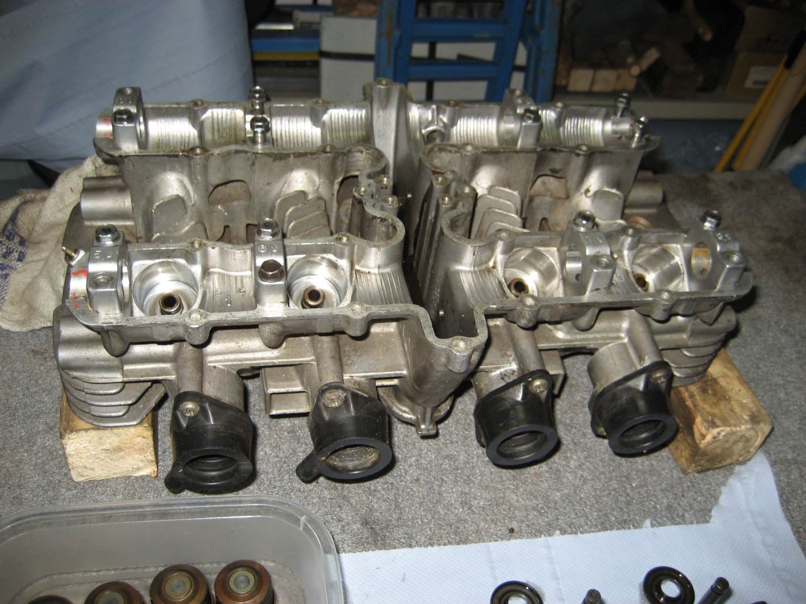

If you pay the shipping you can get a 650 head for free. All threats in good condition, no broken fins. Only cam bearing cap #2 and 4 are missing.
It was a cheap 50 Euro ebay offer i bought only for the shim under buckets i need. Both cams also available.

18 Mar 2021 12:56That "only" is a problem. They machine caps with head at a factory, you can't just replace cap as they go mated with a head. This is main reason I am not using my original head (see page 1) as someone replaced cap #8Only cam bearing cap #2 and 4 are missing.
And how do you know everything else is good? Valves, guides etc? If it was just for threads I could probably figure out something myself or fix it quickly locally. I am guessing surfacing might be needed and valve lapping and potentially guides.

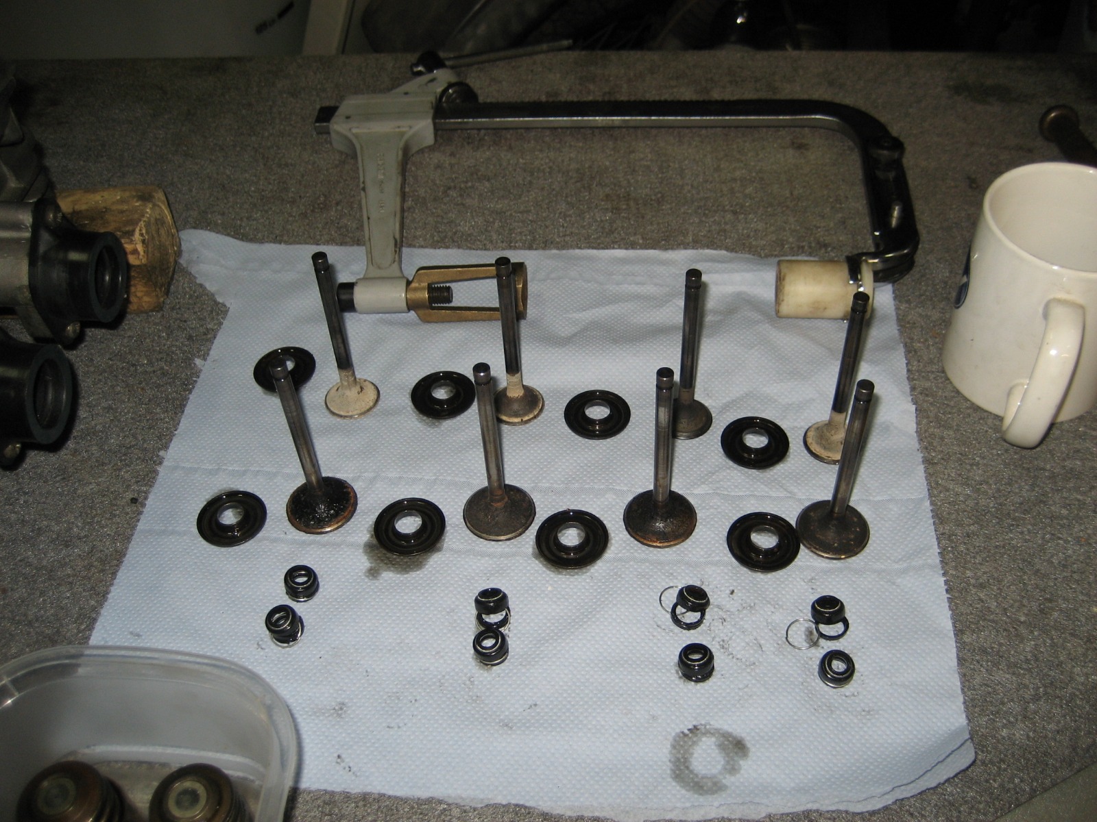

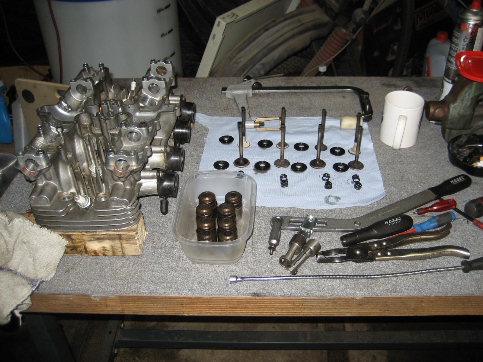

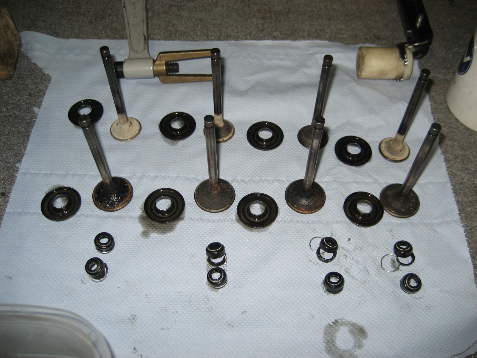

Yesterday I put some more time working on head. Took valves out, inspected a little. There is corrosion on guides and valves. Not working surfaces but still.
Checked manual, removing/replacing guides if needed is not a problem , I got all the tools.
If I get Neway cutters - I can do valve seats no problem.
So, the only thing remaining - check for warpage and fix threads. Got helicoils on order, will try to repair.
Sounds like with my own tooling I should be able to get most of it figured out.
Any pointers on exact Neway kit/set? I know I need 45/30/60 cutters.
Any pointers / info on how to block smog ports? I see it's just a hole going to exhaust valve. How should it be plugged?

I blocked the emission holes by tapping them (from the valve cover side) and then screwing in a set screw with some red threadlocker.
If you have a good head that is missing a cam cap try pulling the valve train and bolting in a cam. try several different cam caps from the other head you have. If it turns over easily by hand I wouldn't hesitate to run it.
