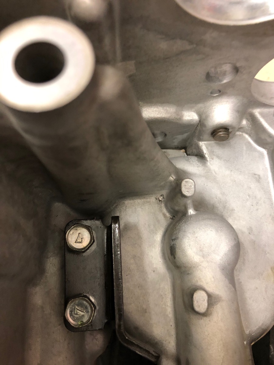

Yesterday evening spent assembling bottom end. Checked transmission, all sizes well within specs, close to new. Main chain has about 20-23mm play, service is 27. Great because I didn't want to buy it
Anyhow, another $300 spent ordering little bits and pieces.
Don't know why, maybe my engine was built on Friday night but I am seeing more missing stuff. Lock washer under bolts on kickstart stop missing. It wasn't there from beginning..

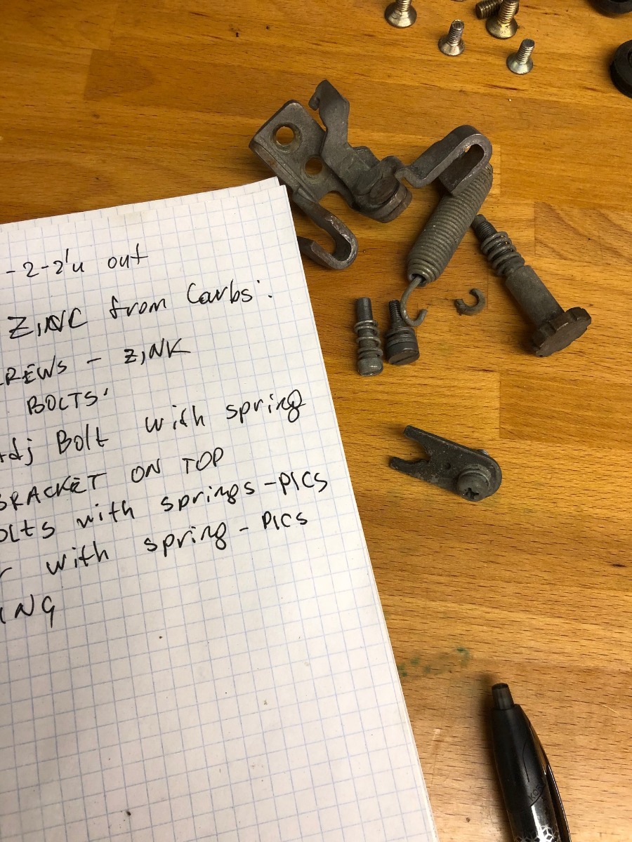

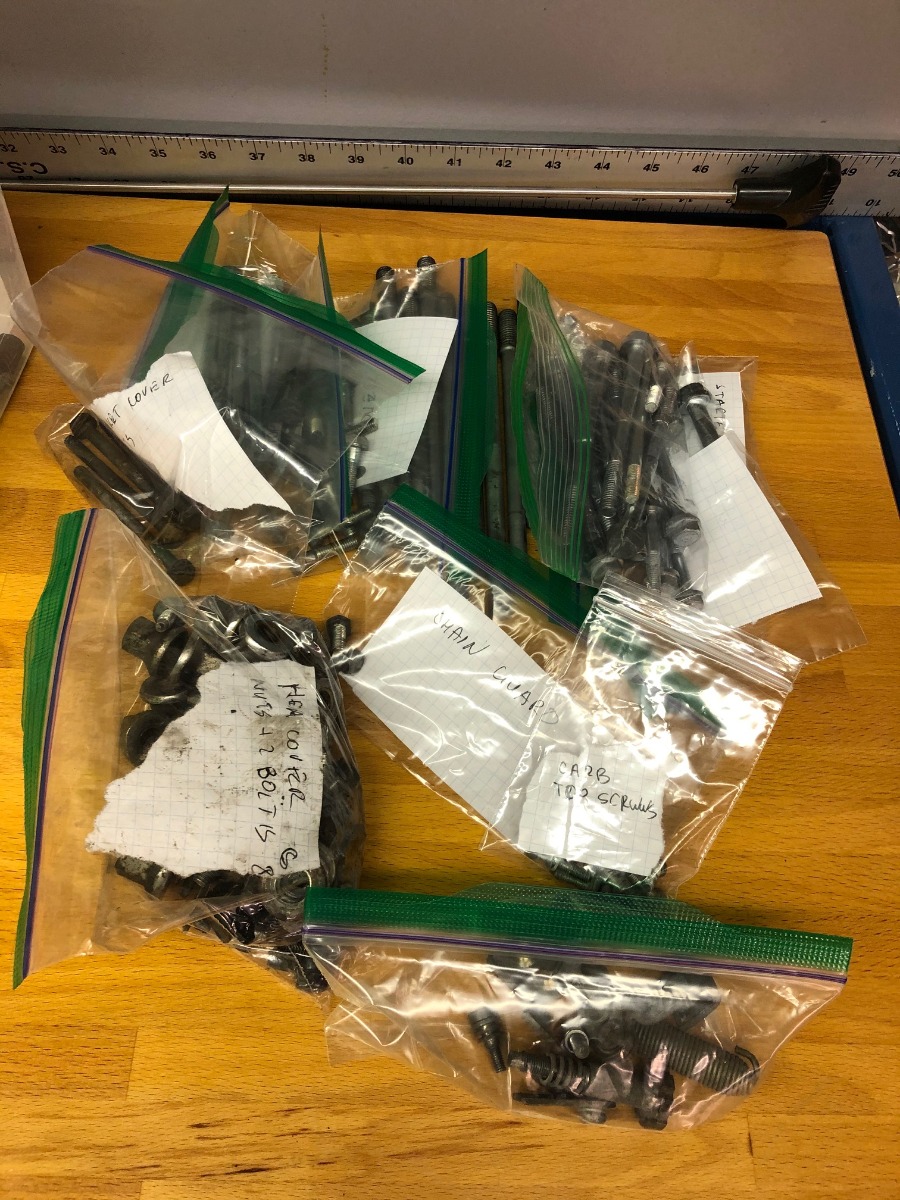

Next step is to get carbs sorted and once I have carbs apart and checked - do plating on all hardware. By the time parts come in I should be ready for reassembly with everything.

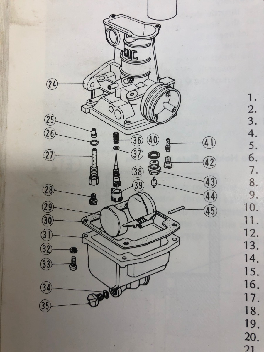

Making some progress. All hardware to plate sorted and ready. Carbs being evaluated. In very poor dirty shape. Lot's of dirt in bowls.
I got new plastic barrels (for enrichment), new o-rings (viton kit). Some new hardware. Reusing jets and other stuff.
Going to soda blast bodies and then ultrasonic clean everything.

For carb kits I would go with Keyster. Except I would not use their choke plungers because they don't have the point on the end.
Those rubbers and the plastic risers above them are available on ebay from several suppliers. I've bought them from retro-motorcycles. The entire assembly is also used on most of the big Mikuni carbs.

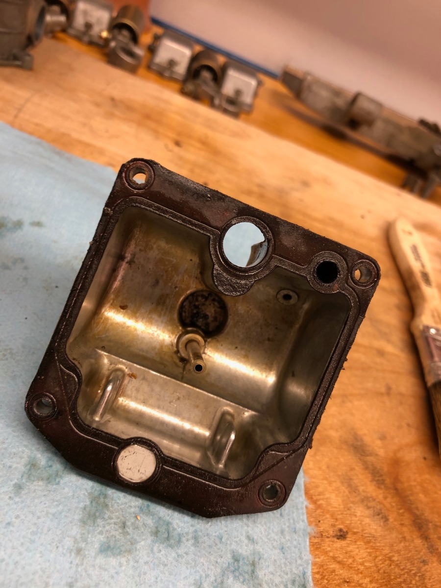

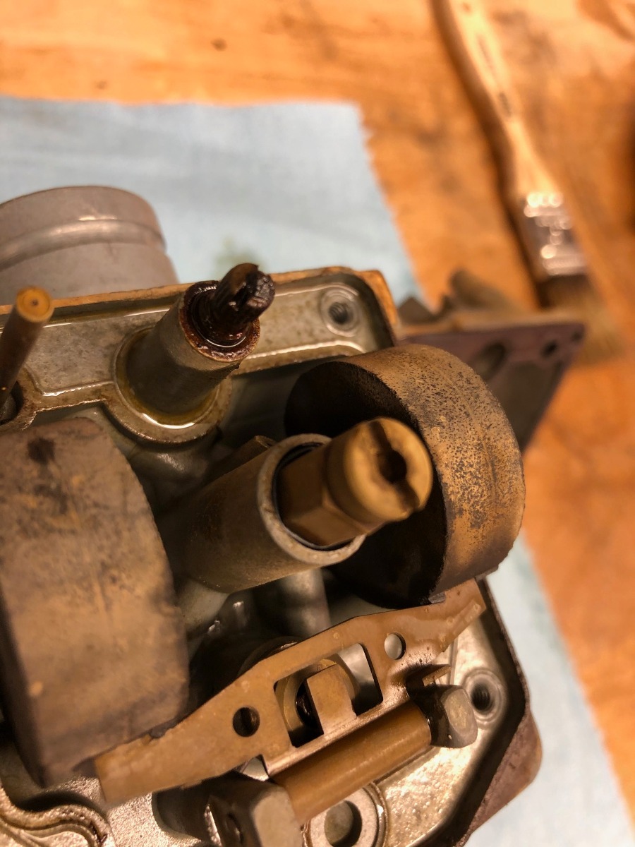

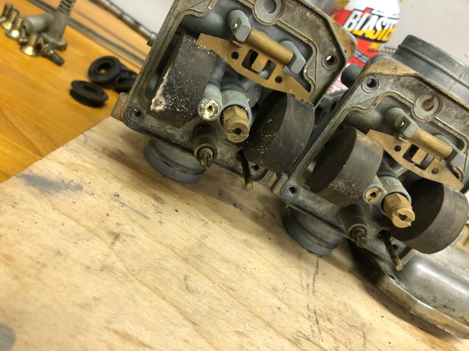

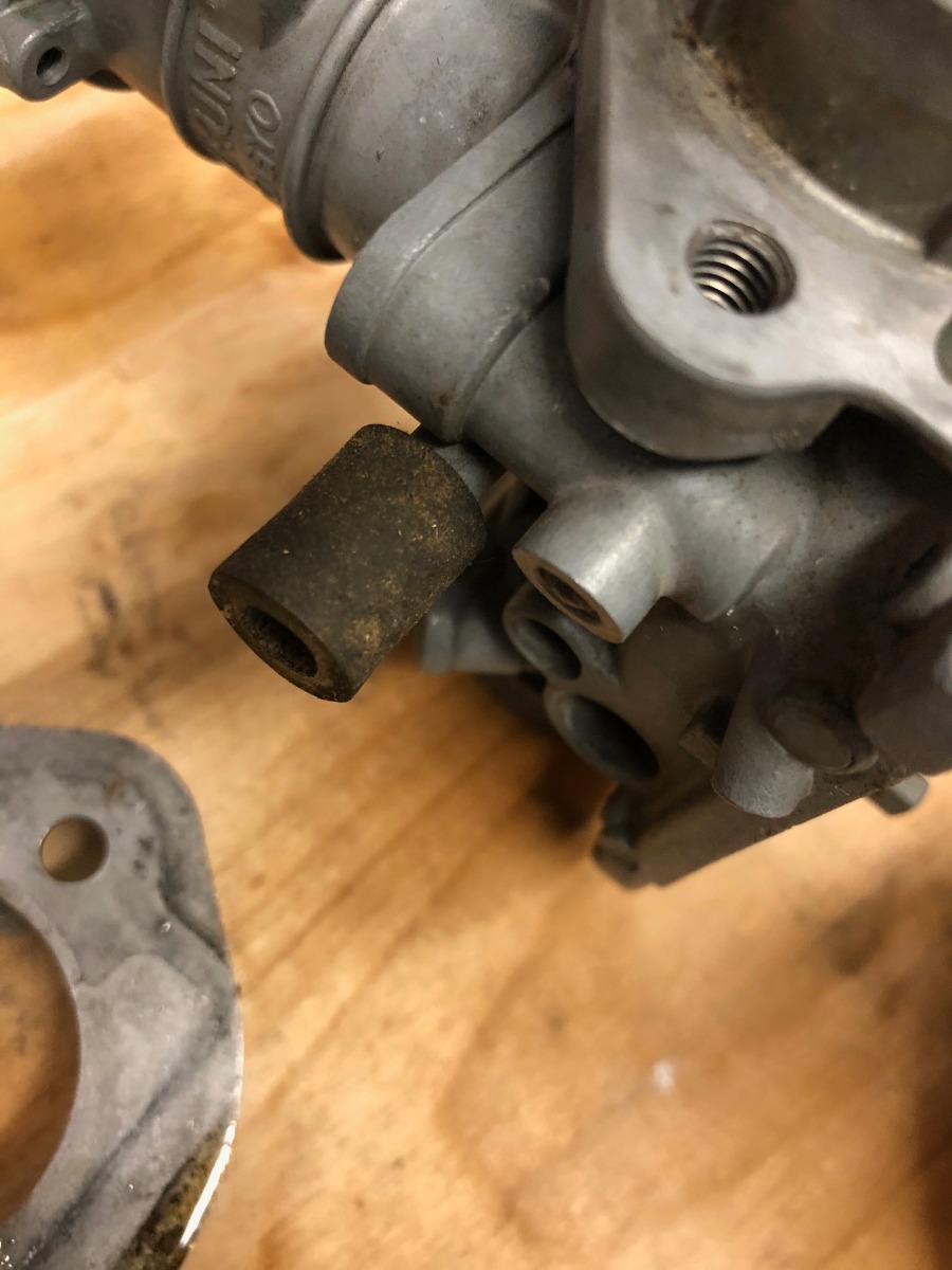

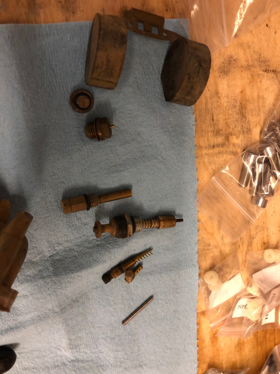

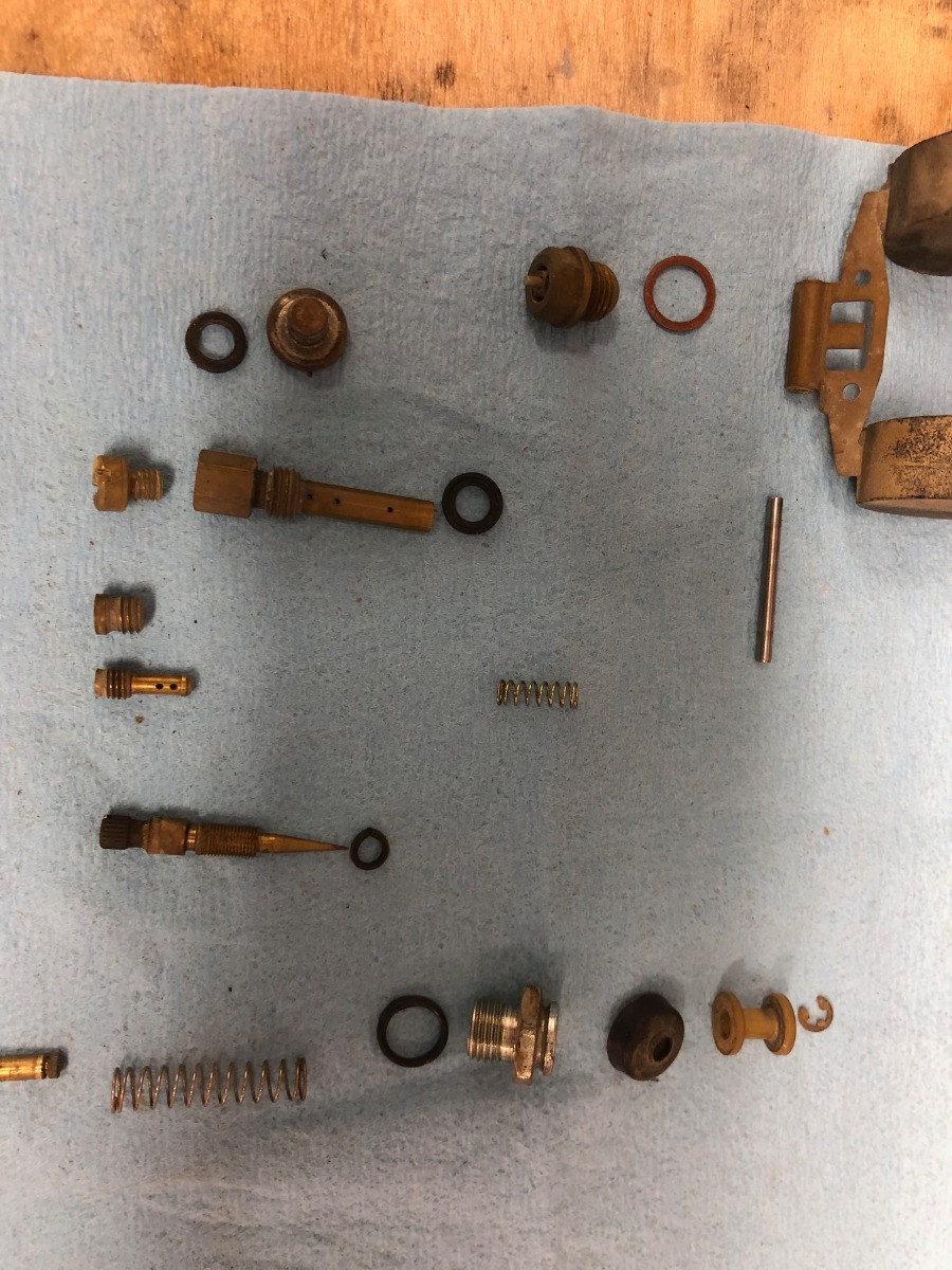

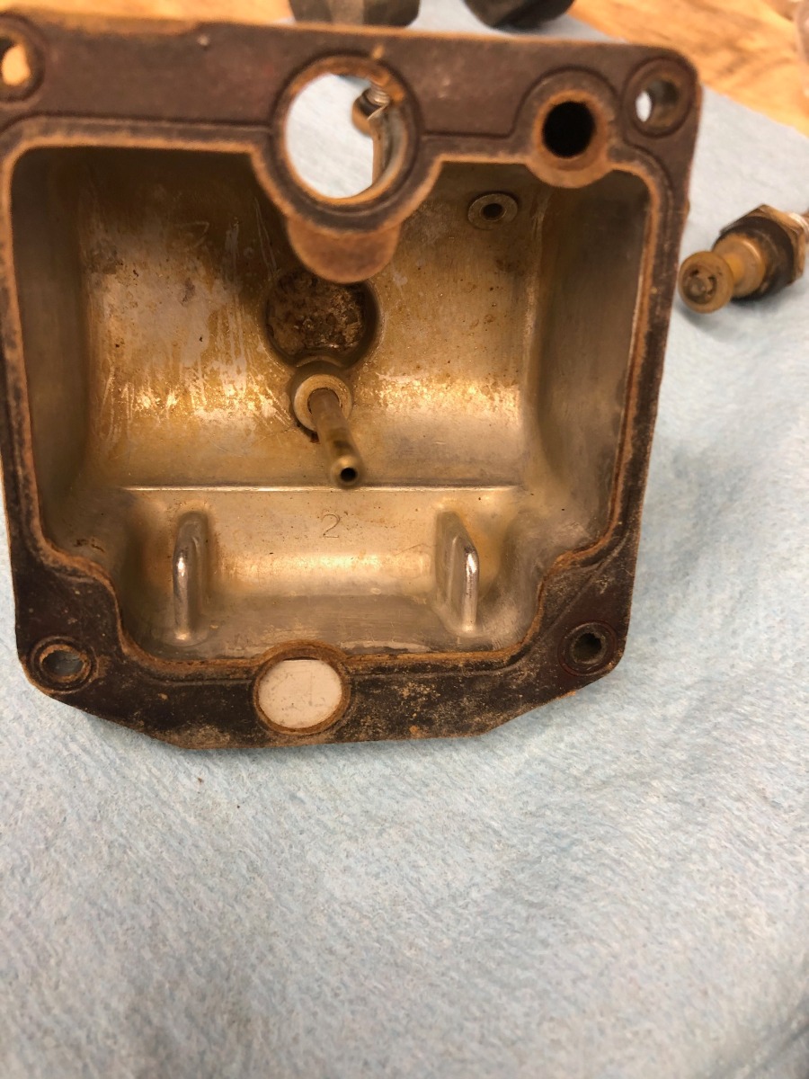

Took carbs apart. They all missing #39 "limiters". I understand those are not required.
Because previous "mechanics" got in there, I had to check needles. They all seem to be set stock (second slot from bottom) but thin washer over one needle was installed ipside down. Tiny "dimple" need to point down from what I understand.
For rebuilding - I am going to go with Ed's advice. No metal parts will be replaced. All jets etc seem to be perfectly fine. Hard to read numbers though.
Any advice on assembly lube for linkages and moving shafts? Silicone grease?
Any advice on where to get replacement drain tube in bulk?
Supply tube?
Those little sections (vent pipes) between carbs?
After seeing inside - a lot of crud, one carb had idle passage completely blocked with some white chalk (on picture)
My plan for cleaning/rebuild:
1. Soda blast cases and covers.
2. Ultrasonic clean all metal parts in Simple green solution
3. Blow and check all passages
4. Zinc plate some parts, some top screws replaced with original.
5. All rubber replaced except for shaft seals (go through all carbs) - those look good and it's just dust seals. Also, starter plunger has sealing rubber in them, I will leave those be.
6. Bench sync
7. Check and set fuel level
Supply tube?
6. Bench sync

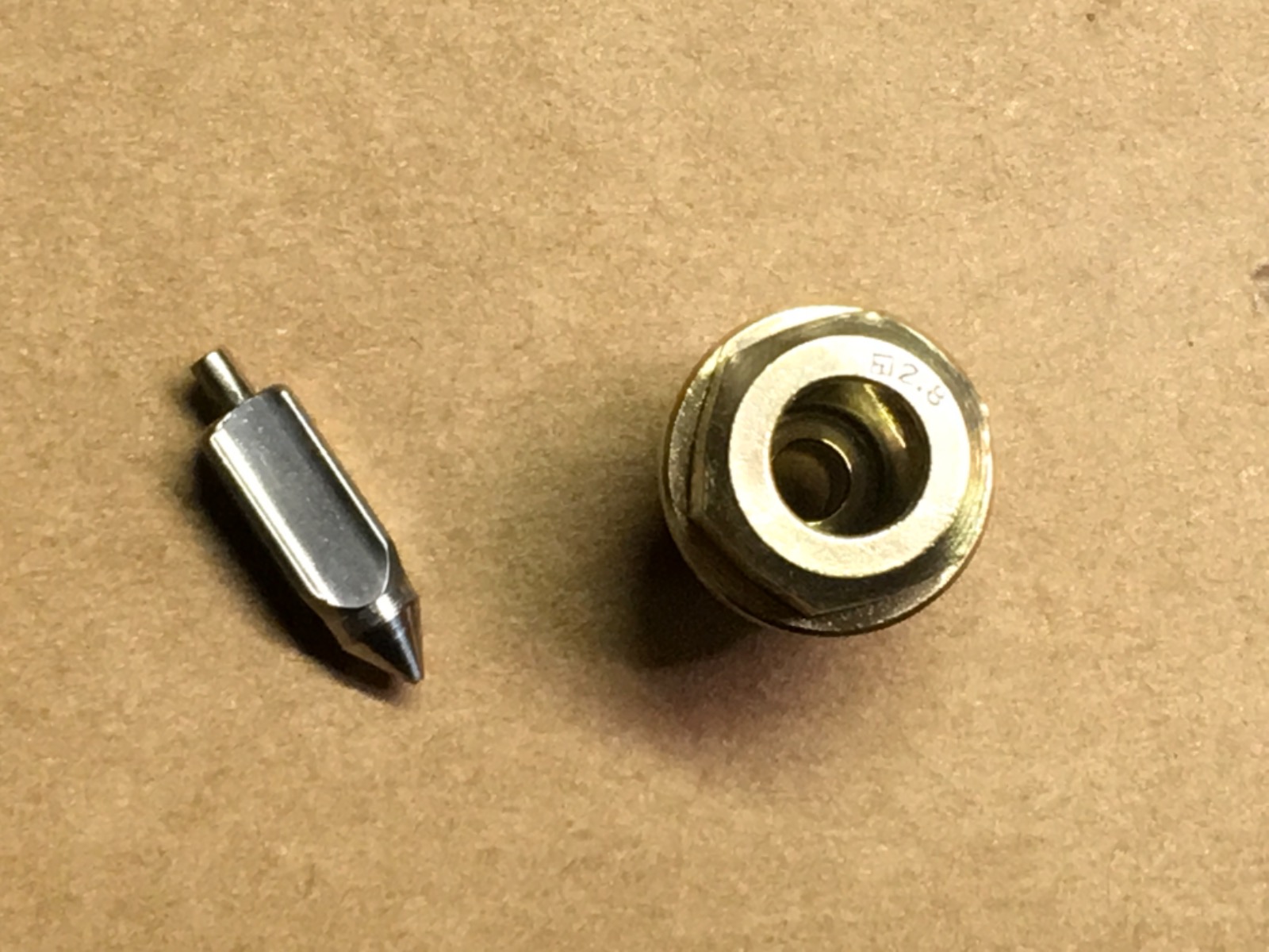

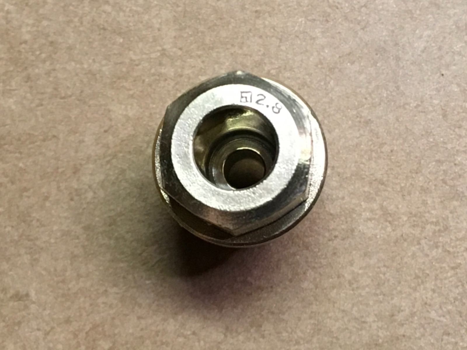

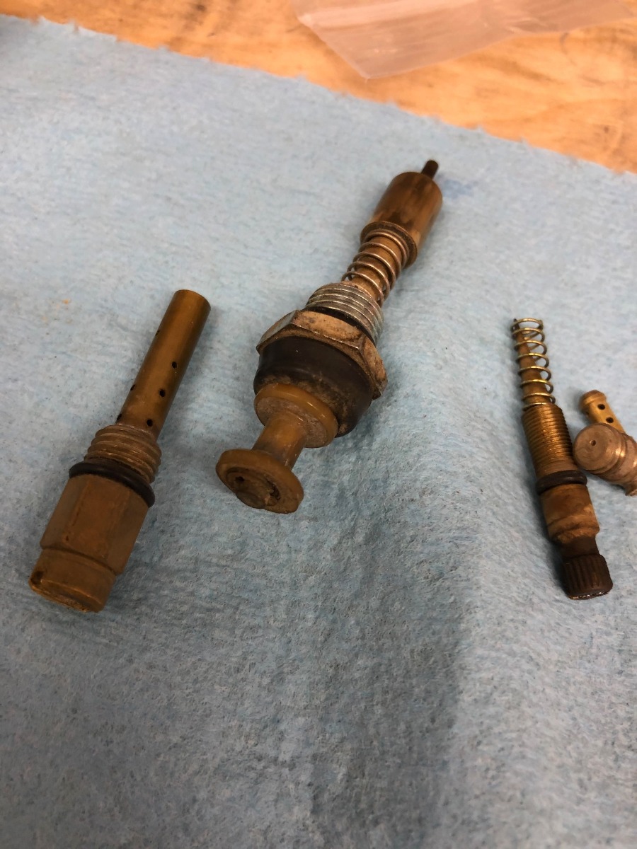

I’d strongly suggest two things with the carbs. 1) keep the Float needle and seat paired up as a set, polish them with good brand Q-tips chucked in a drill at low speed. I’ve have good success with Mothers Aluminum polish. I carefully chuck the needle in the drill and polish up the needle tip with soapy water and 2000 grit wet sand. 2) save yourself some tuning issues later and have zed1015 replace the seals in the choke plungers.
also make sure to free up the spring loaded tip in the float needle.
