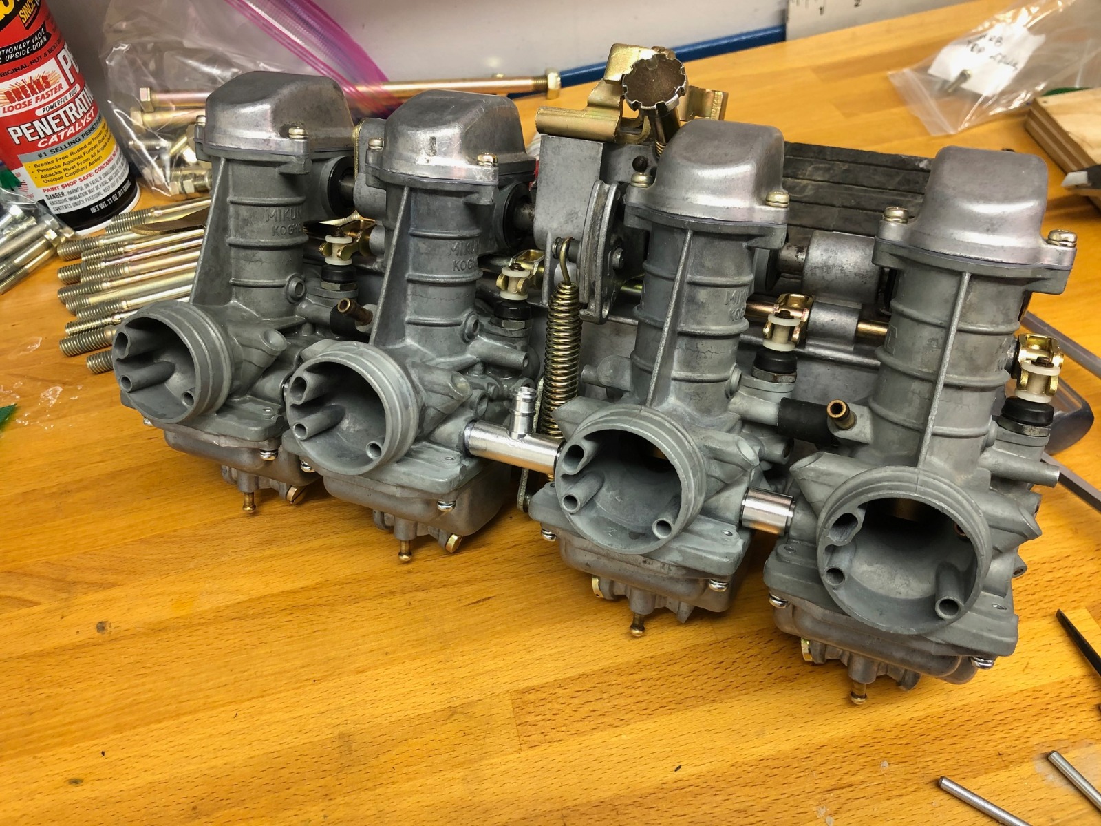

Carbs ready, bench synced. Still need to adjust/check float levels.

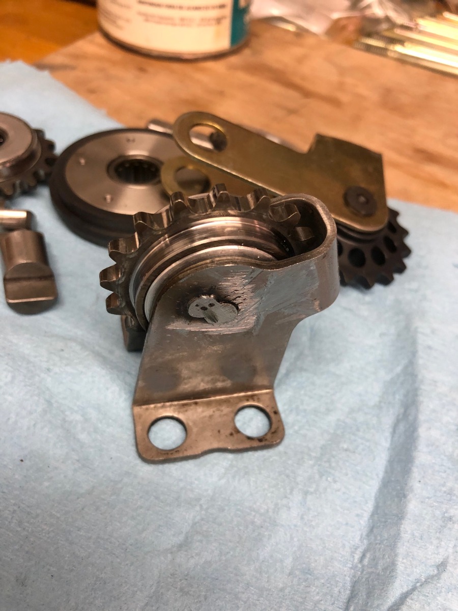

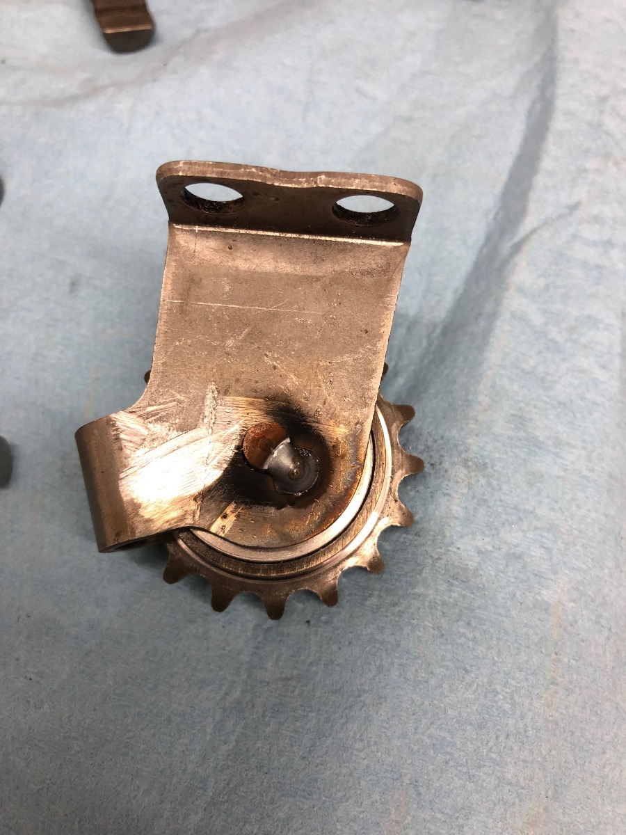

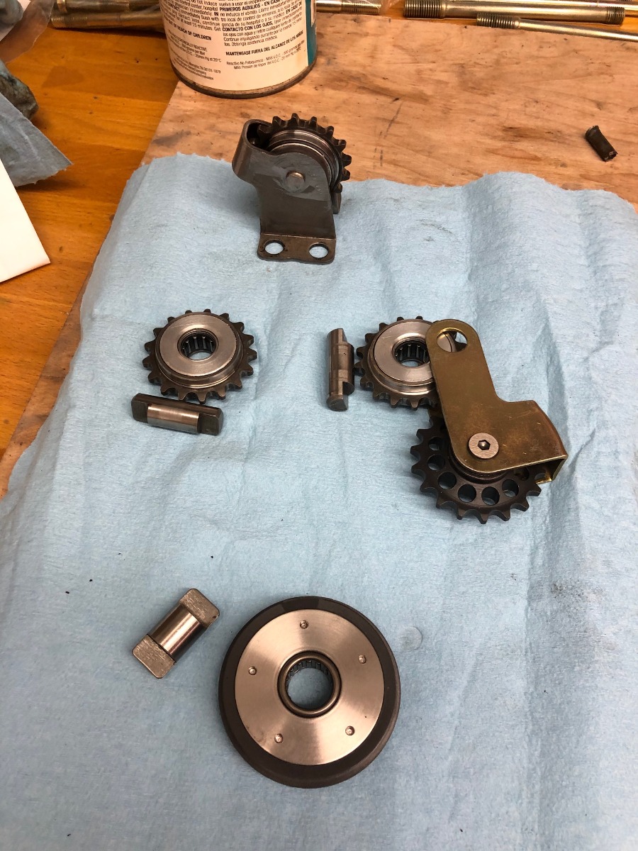

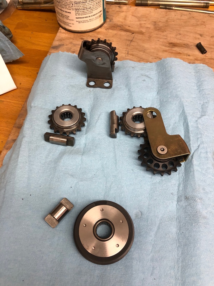

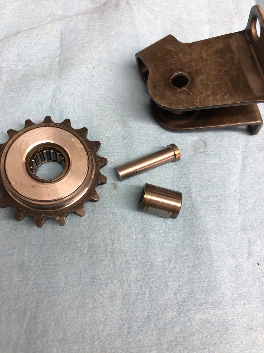

Making some progress with camchain parts. Machined alum inserts for gears, got 2 parts from APE, pretty much all is there.

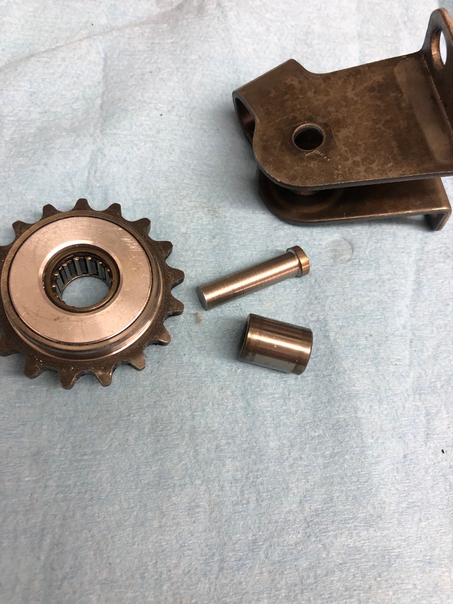

All parts for camchain there. Top idler - machined axle and then pressed in and welded at the end.
Next thing going to be head cleaning and checking. 6 more gears going for sale on ebay

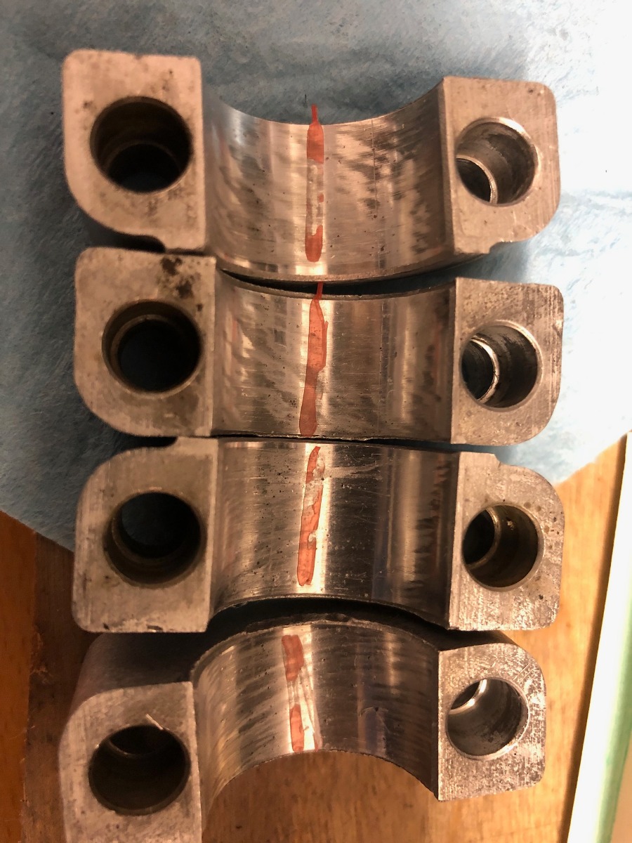

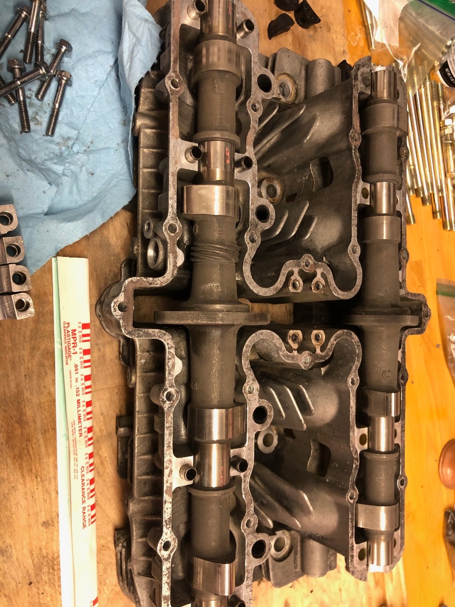

Head I got from ebay looks promising. No corrosion. Deposits under valves but it's just a valve job. All threads look to be good.
Camshafts seem to be well within factory specs..

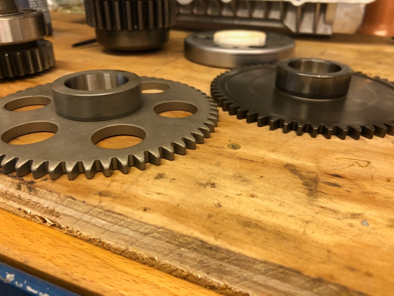

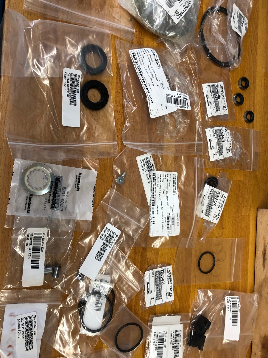

Even though head is "good" in general with camshafts, threads, etc... Intake valves have very noticeable groove. Also, "side rock" test reveals a lot of wear. Since I bought guides and valves anyways - it's got to be done.

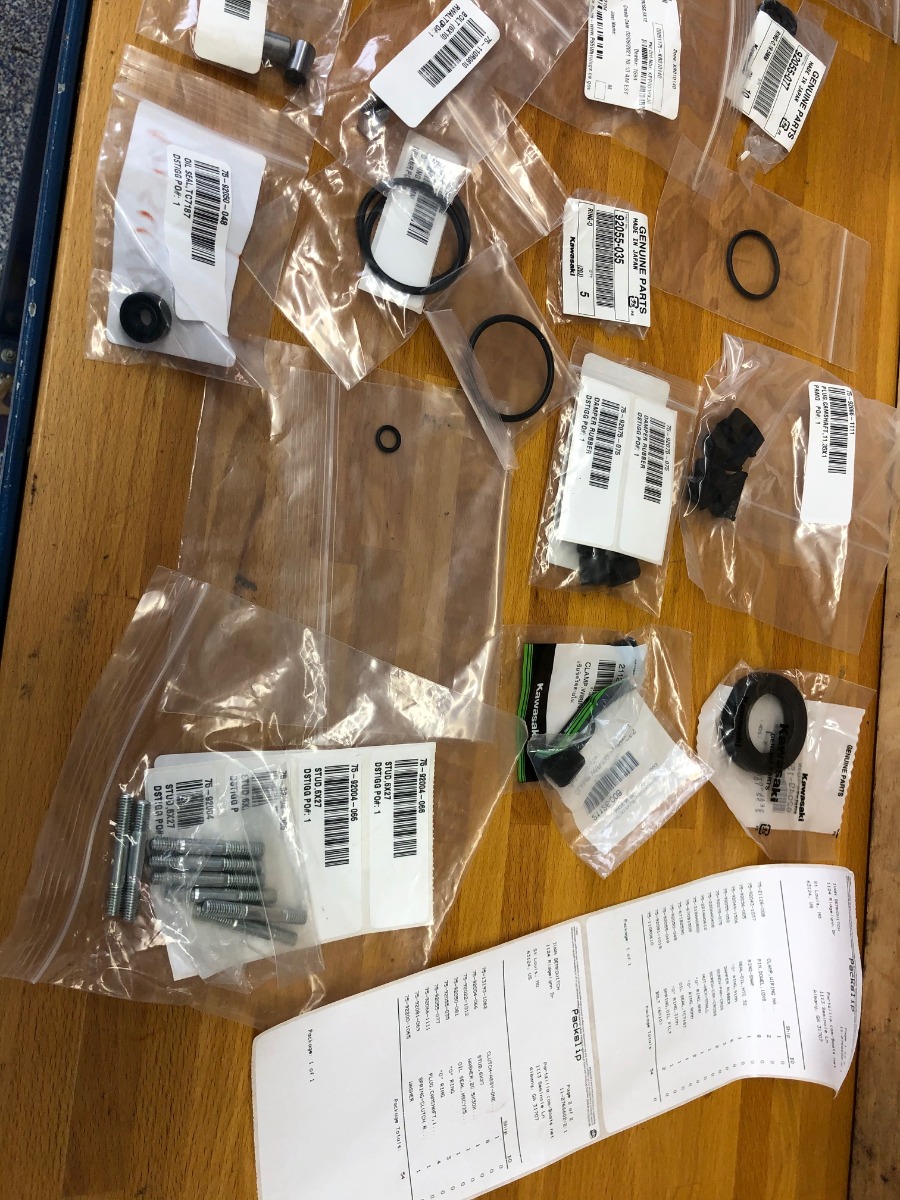

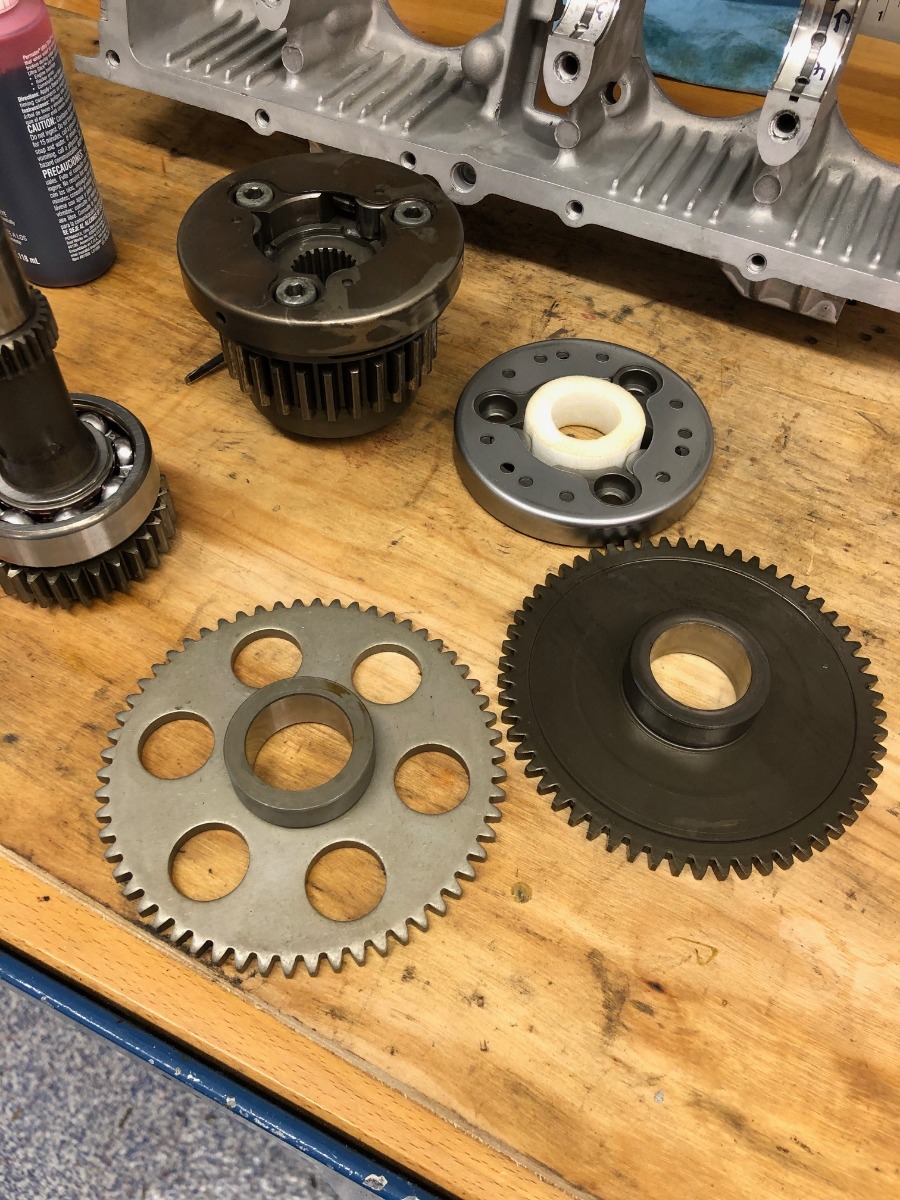

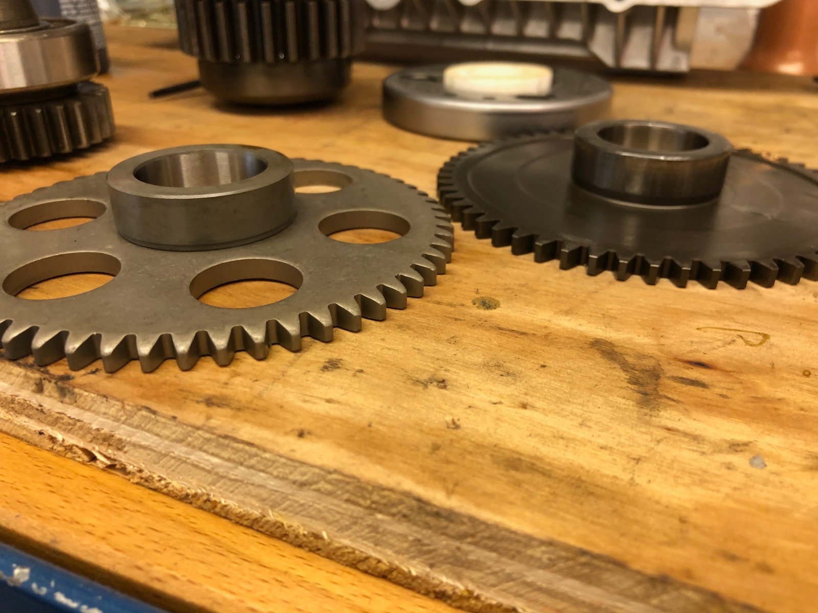

All engine parts came in, 99% ready to assemble, but found issue with gap in gearbox so waiting on some washers. New starter gear is different from original (see pic)
In short - all rubber parts replaced
Starter clutch and gear - replaced
All hardware replaced or plated
Some bearings replaced

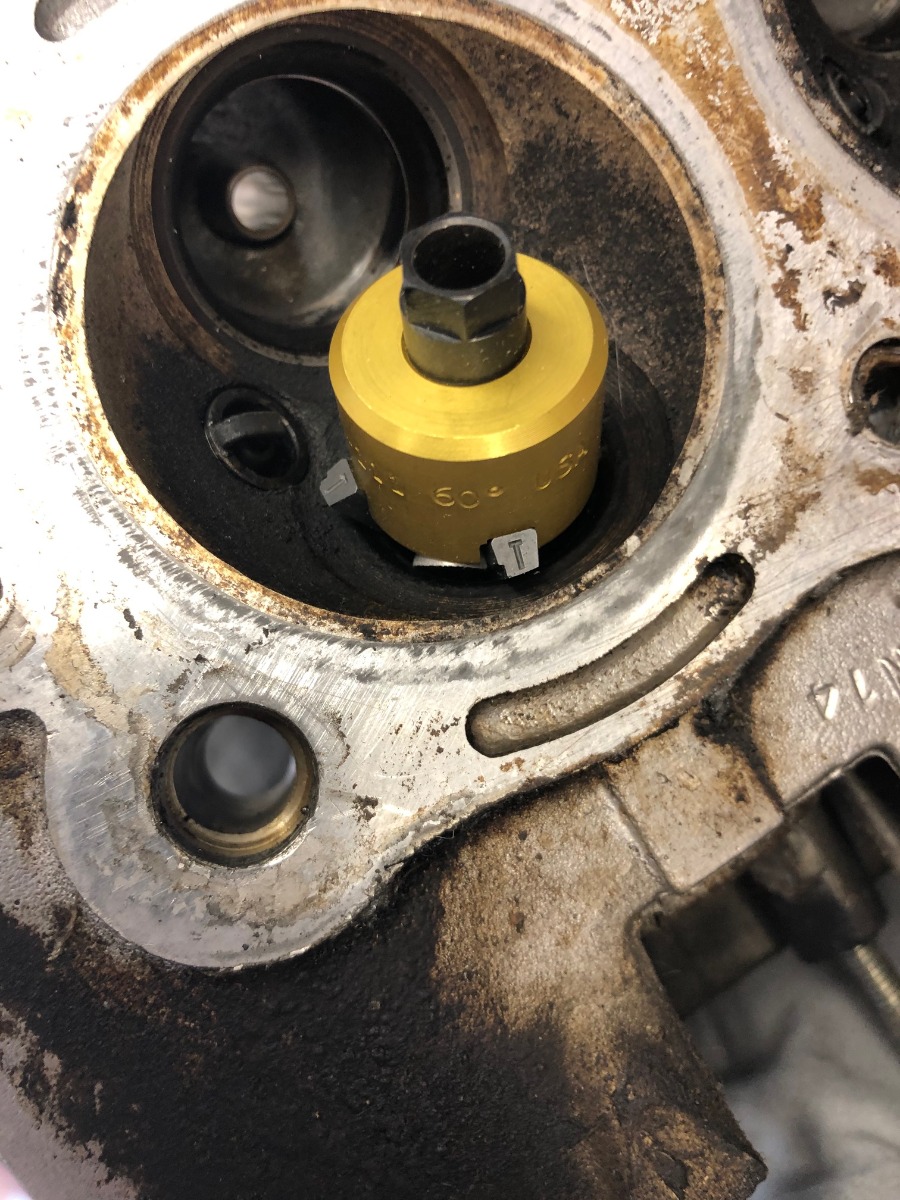

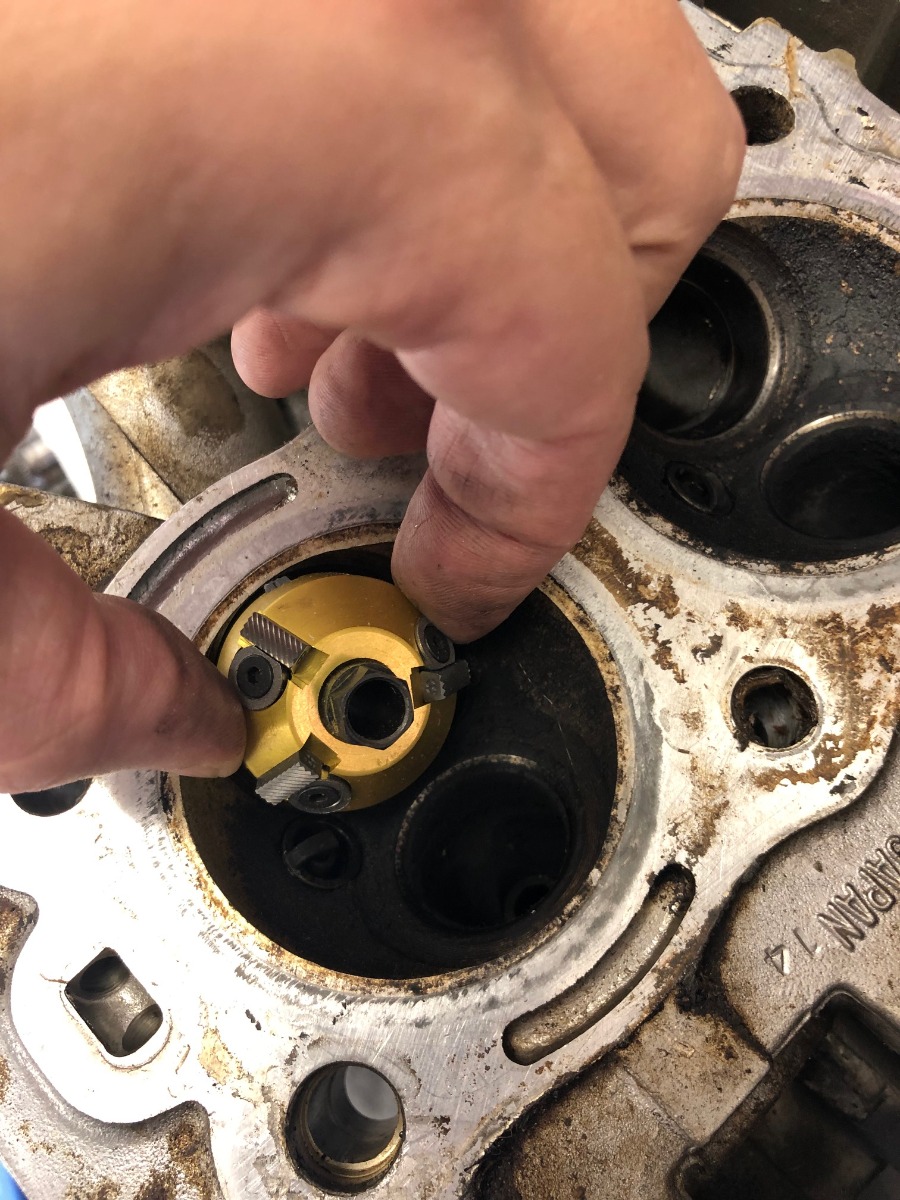

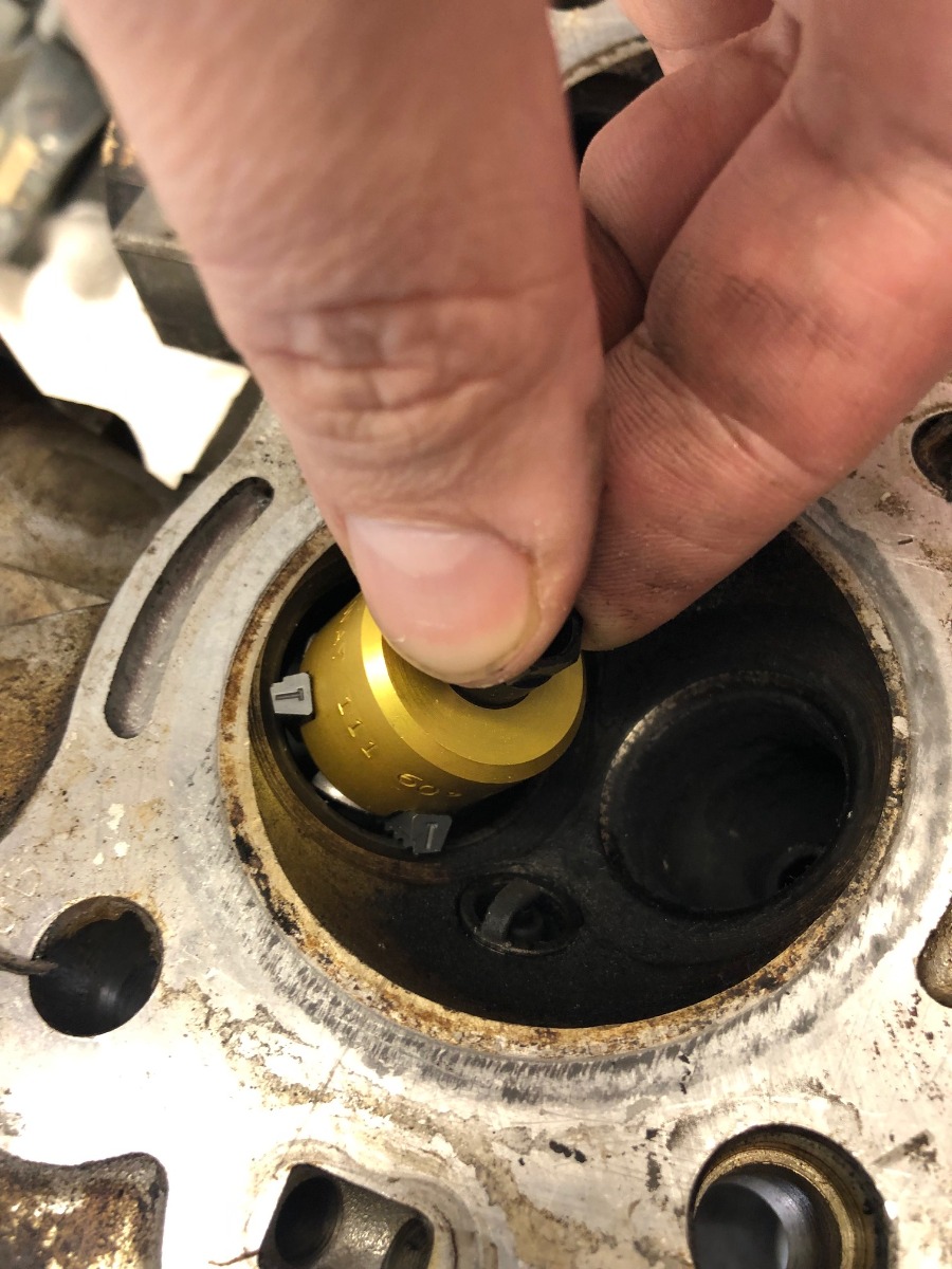

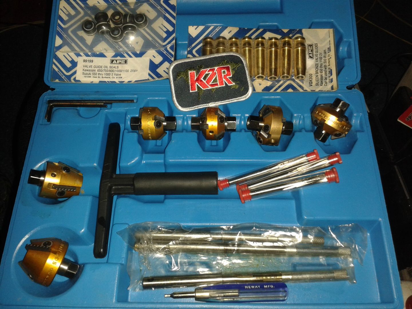

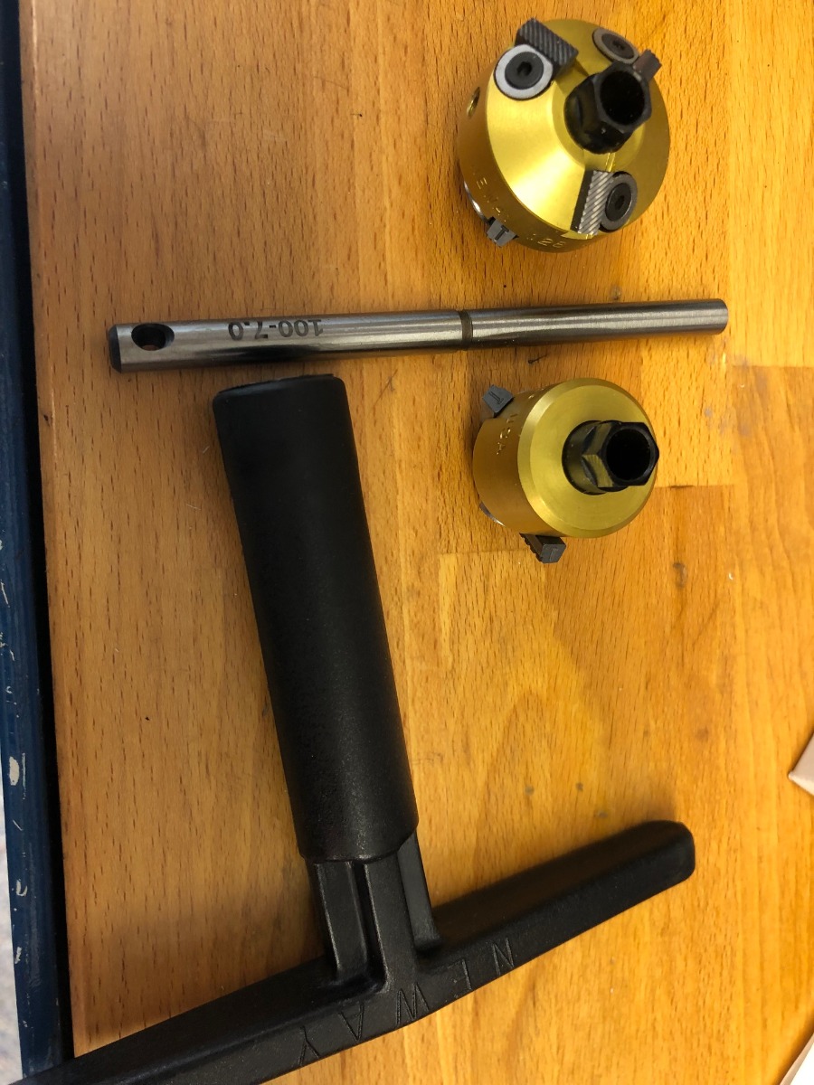

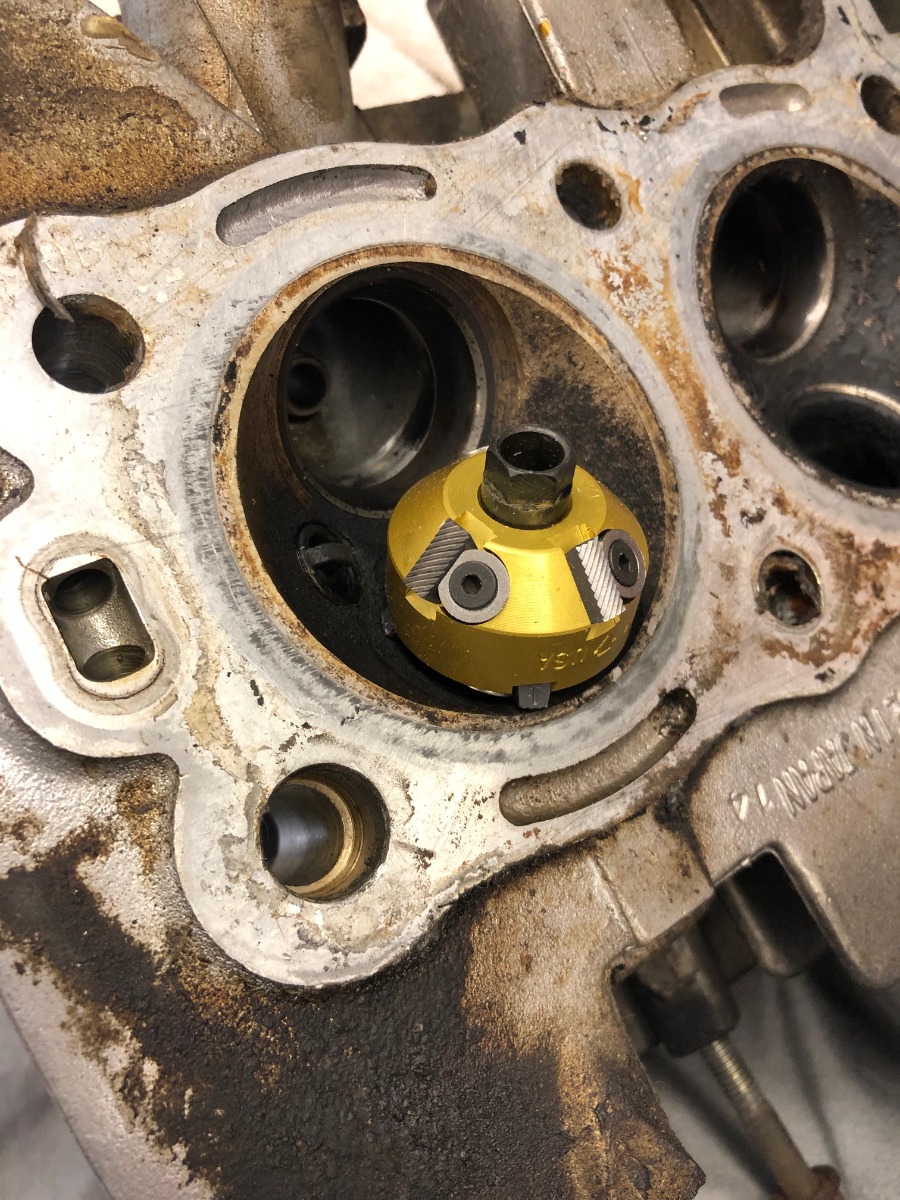

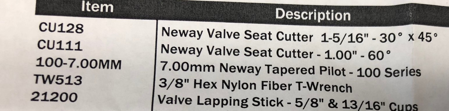

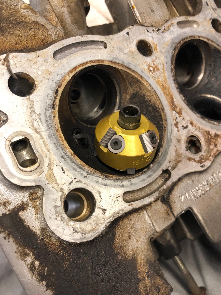

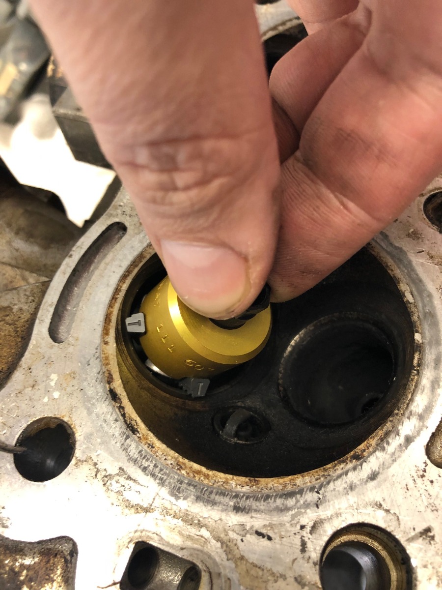

Good news. Looks like 2 Neway cutters will do whole job on 650. Maybe for 1000 or 750 have different/bigger valves but in my case 30/45 is taken care of by one cutter. And 60% I was able to make fit by moving cutting blades out (see pics). Didn't do job yet, but whole thing cost about $220, much better deal vs giving it to shop. The only job that I may need shop to do is to shorten valves if it's going to be necessary
- Thanks: 2260
Re: Katit's 1978 KZ650 project
12 Jun 2021 15:08 - 12 Jun 2021 15:14
Nice to hear you can cover your valve job with less cost. Be careful, this Tungsten Carbid blades bite like hell.
Do only max three turns with less pressure.
First do the 45° angle job and then only if needed the 30° and 60° angle to set the valve to seat touch surface width and position.
Less is more in this case.....
I bite the bullet 25 years ago with my set of NEWAY cutters to cover the BMW, Volkswagen and Japanese classic engines, it´s worth the money i had paid for in the mid 90th...

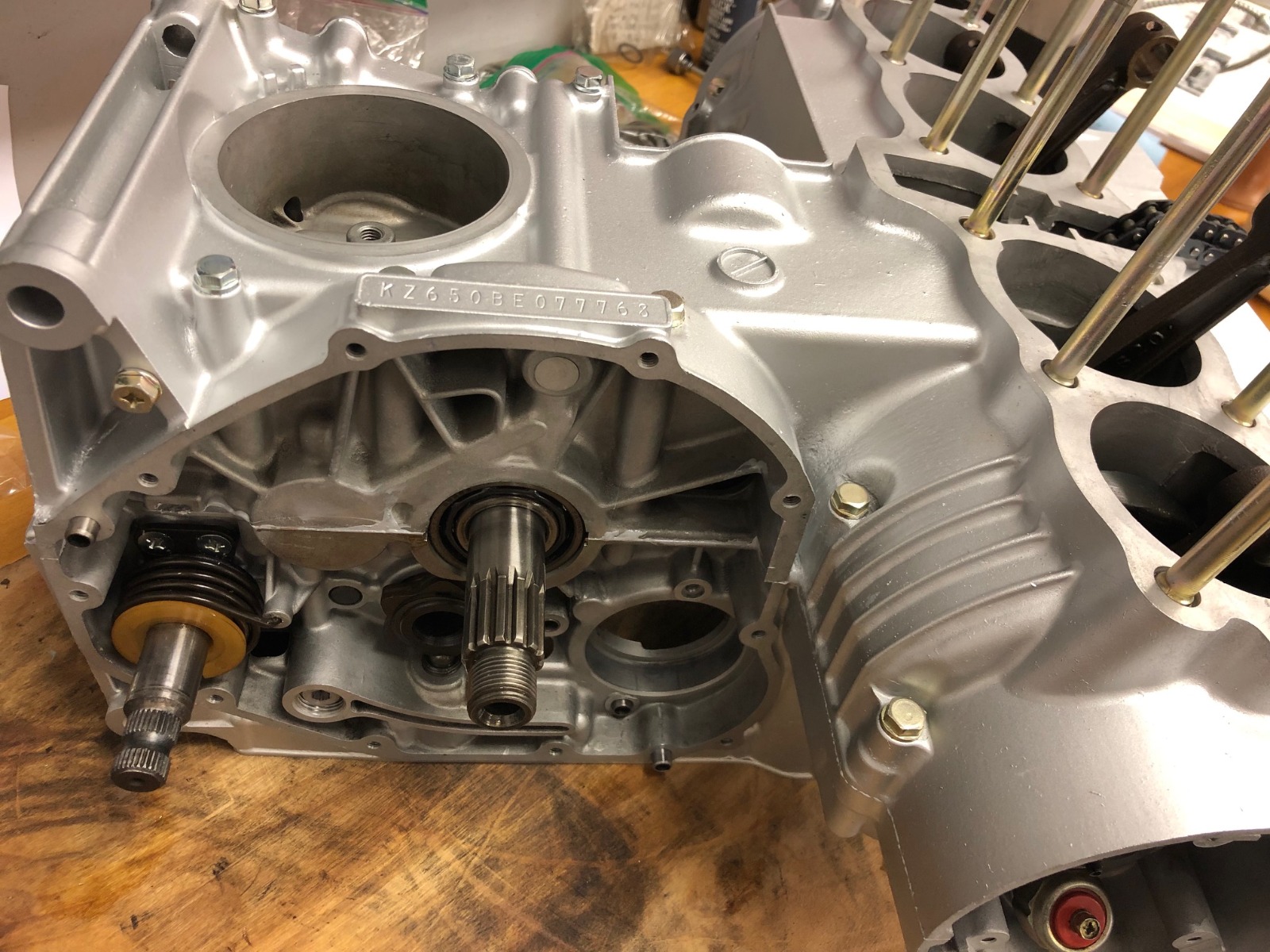

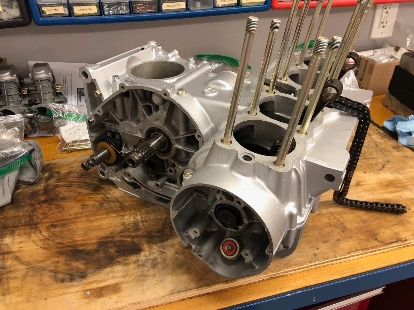

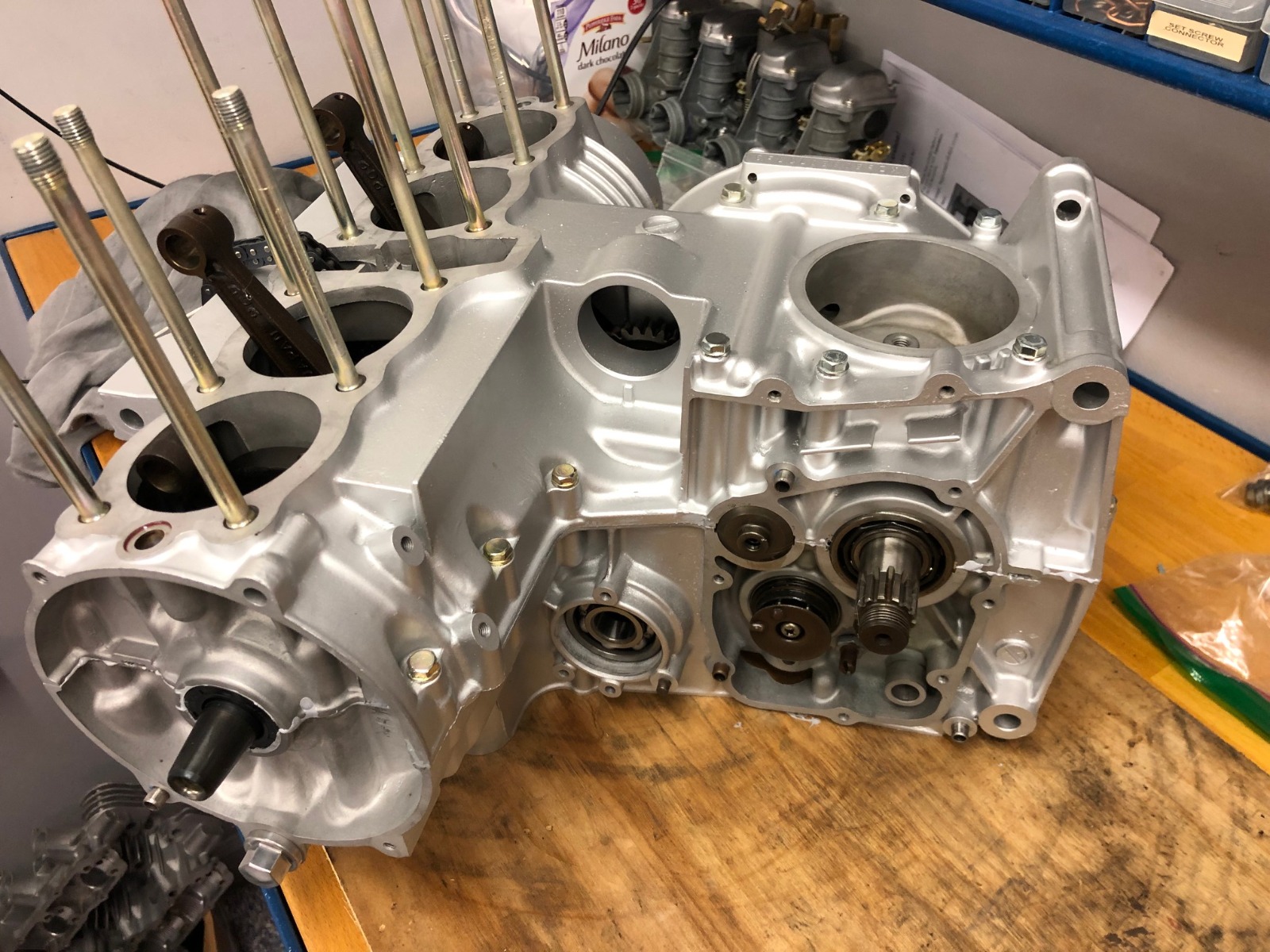

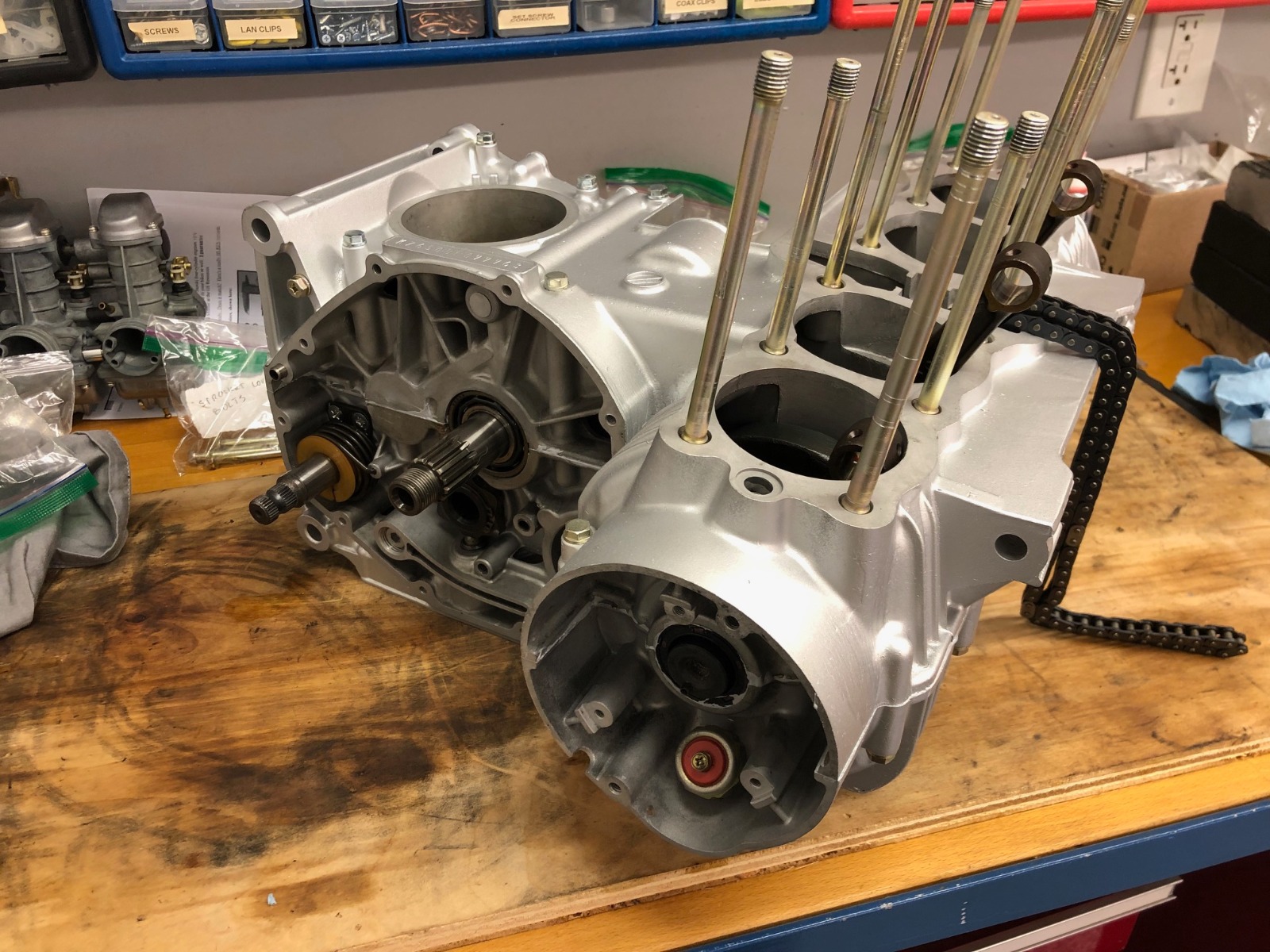

Life is busy. Finally completed my "other" project (LX470 suspension overhaul) and back to this. Engine glued together. Next is to finish all other stuff and work on head.
Anything I should leave off for easier re-install into the frame?

I am only Dreaming that my work looks so amazing!! Is the finish paint or what? Thanks for the pics!! Chris
