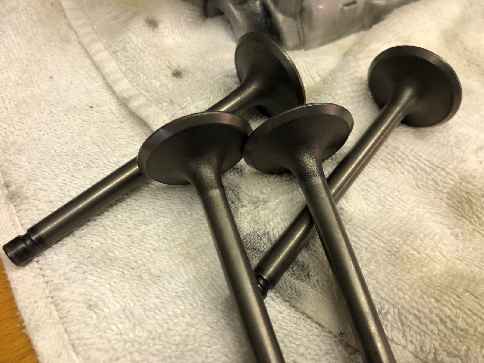

Are you using new valves or used? If used, find a shop with a centerless grinder and get the valves faced. The same machine can skim the stems too. It's SOOOO nice starting with a fresh and perfect surface on the valves. My local shop did the set for a very fair price since it only took about 15 mins to do the full set.
- katit
- Posts: 460
- Thanks: 47
Re: Katit's 1978 KZ650 project

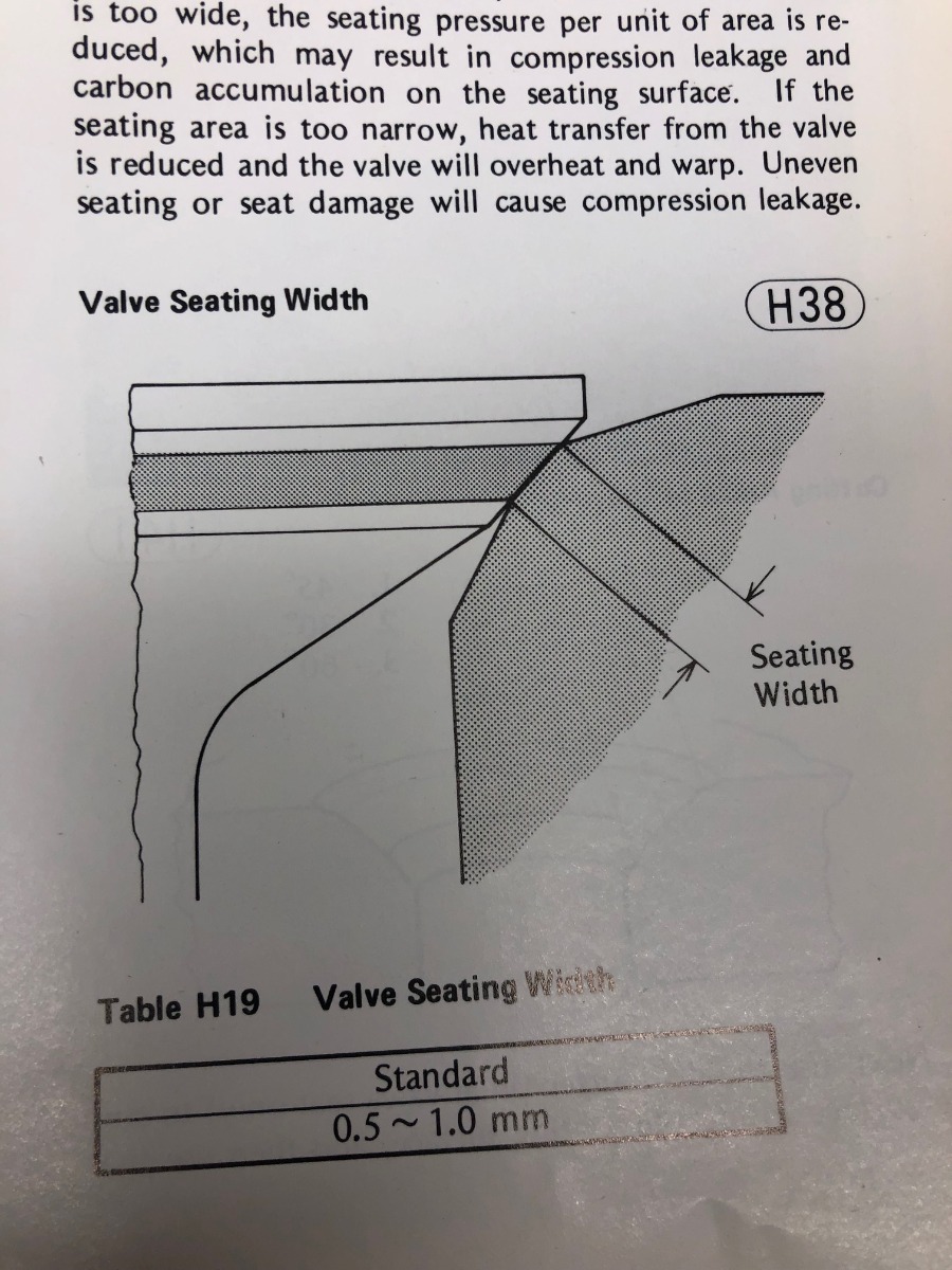

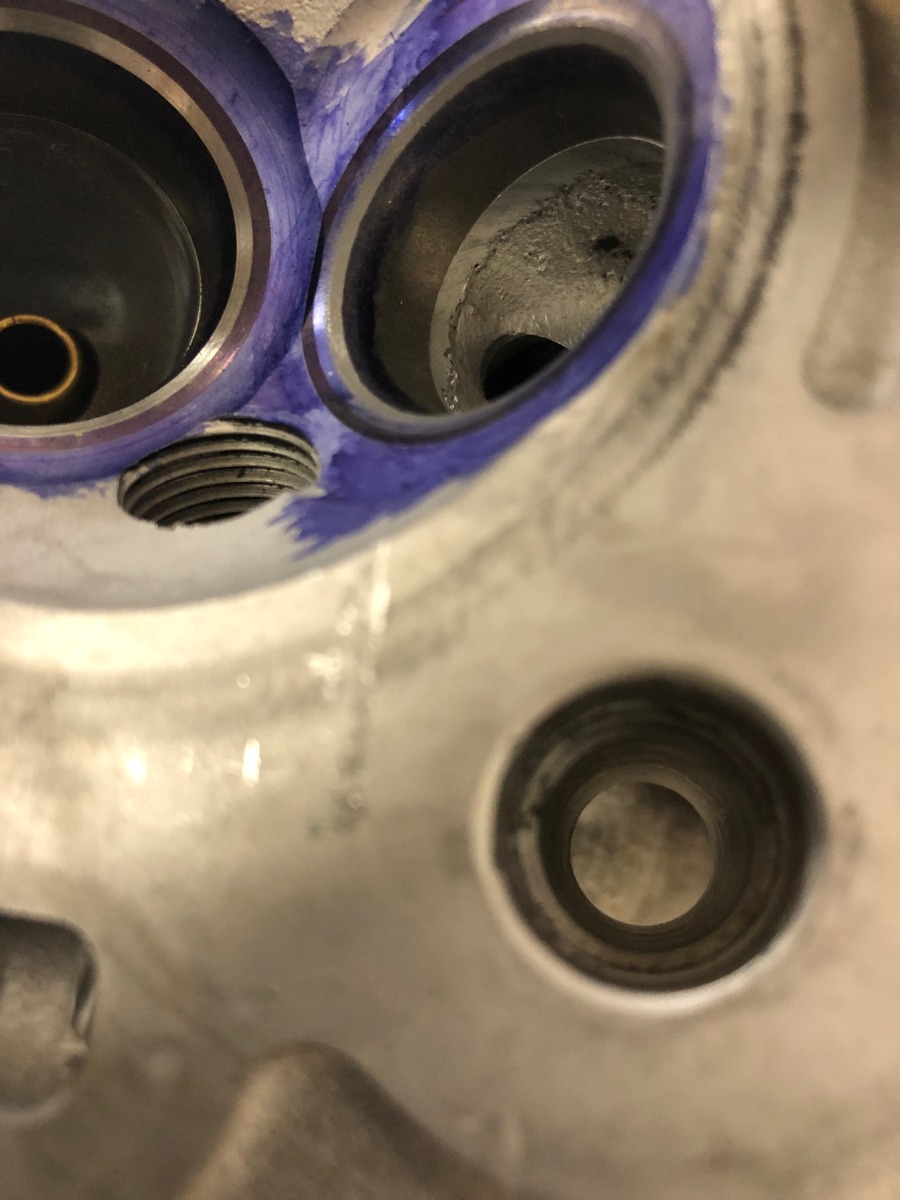

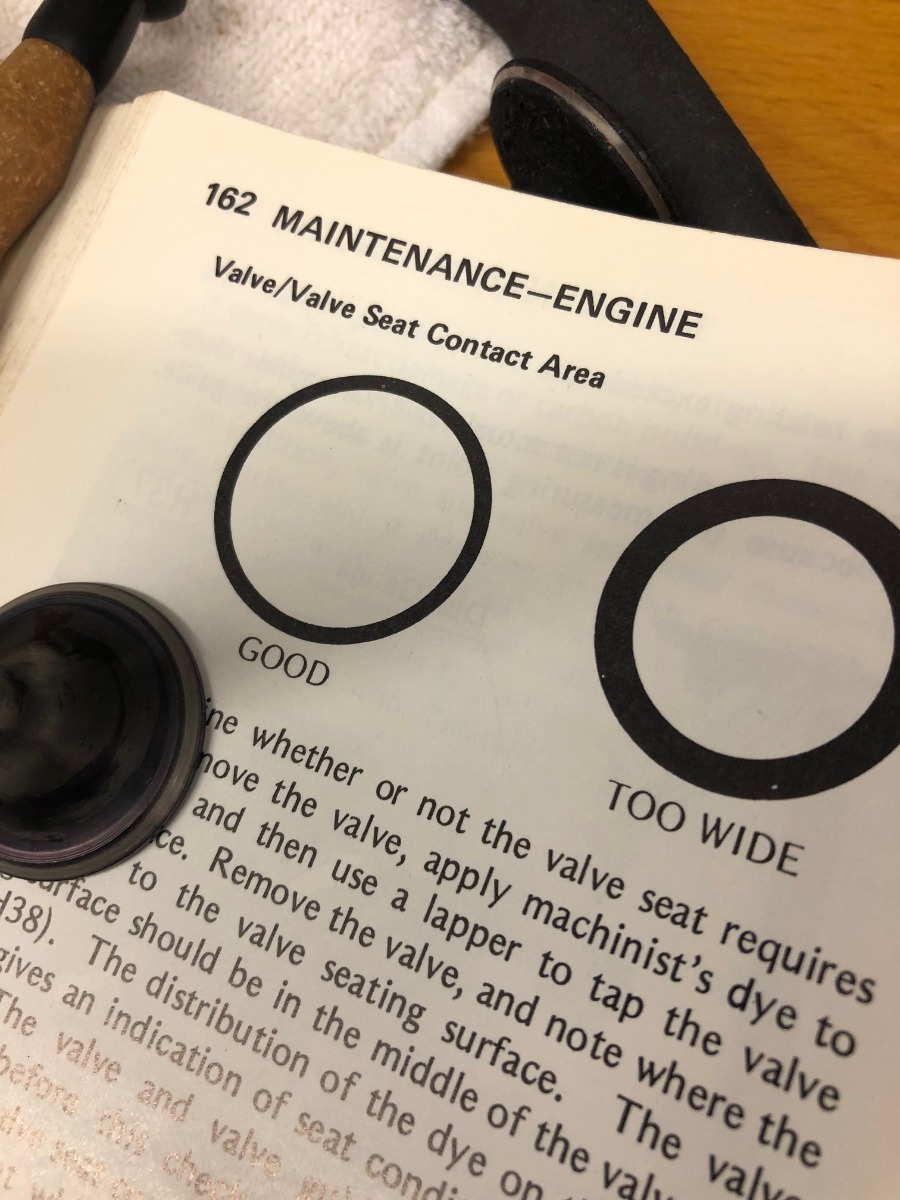

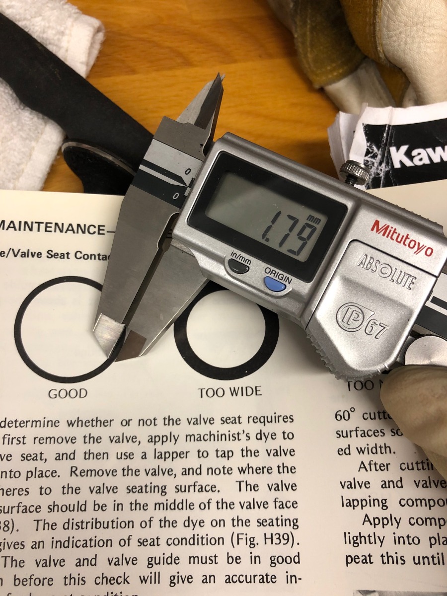

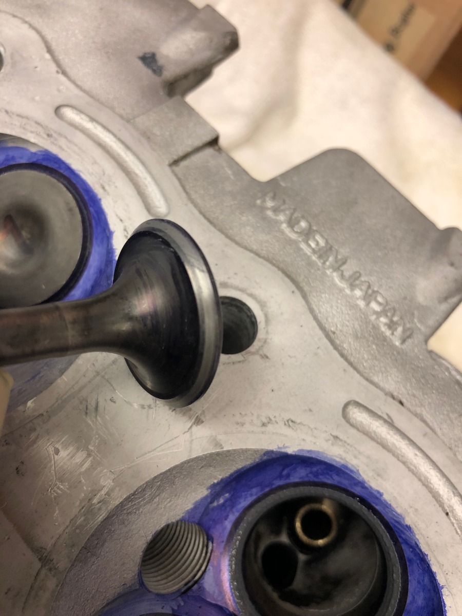

25 Sep 2021 15:31New valves. Now I am confused. Head I am actually doing is in much better shape (less pitting on valve seats). Exhaust valves actually do fit into guides so I proceeded withs second angle to get contact spot width correct.Are you using new valves or used? If used, find a shop with a centerless grinder and get the valves faced. The same machine can skim the stems too. It's SOOOO nice starting with a fresh and perfect surface on the valves. My local shop did the set for a very fair price since it only took about 15 mins to do the full set.
If I look at manual drawing - their "good" spot is about 1.5mm. Specs is 0.5-1mm which to me looks very small. Should it really be less than 1mm? I got contact right in a middle of valve surface and it's about 1.3mm wide.
Intake valves don't go into guides. They either bigger or guides under more tension. Will check once I get hones what actual sizes are. But for now - I am done with exhaust side unless you tell me I need to go after smaller contact patch
- Skidmark
- Posts: 1087
- Thanks: 312
25 Sep 2021 15:34
I wouldn't recommend measuring the image on the page and thinking it is accurate. Go by the measurement numbers listed. Just my $0.02...

25 Sep 2021 15:44 - 25 Sep 2021 15:46I wouldn't recommend measuring the image on the page and thinking it is accurate. Go by the measurement numbers listed. Just my $0.02...
I agree. But 0.5-1mm also look very narrow. Comparing to everything. images or actual valve edge surface(which is slightly over 3mm). No problem doing it, just need to hear someone experienced. And when doing 0.5-1mm - should I stay closer to 0.5 or 1.
25 Sep 2021 17:20
1mm on the inlet and a wider 1.5mm on the exhaust to help shed the heat as they run hotter.

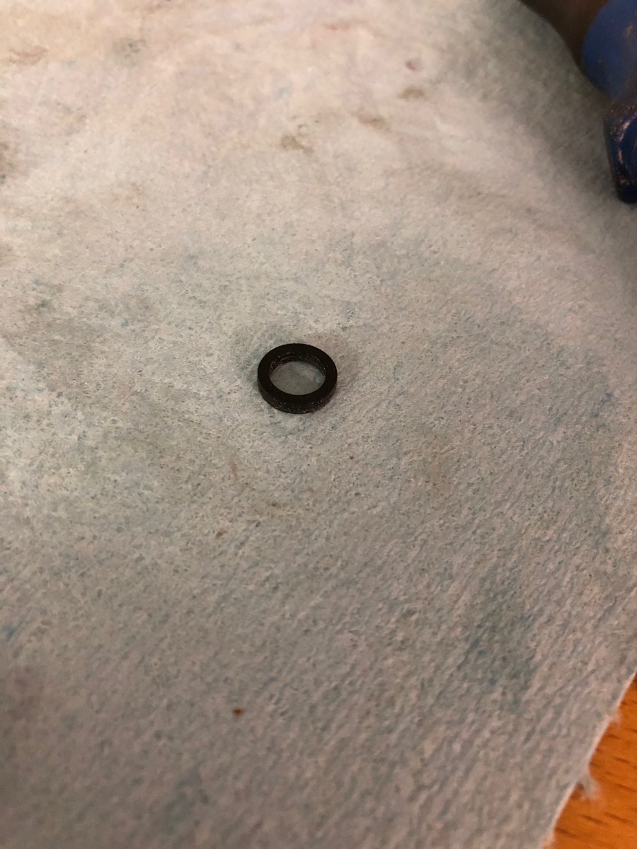

Painted head, almost there. Hope to start engine on a floor this week.. Is this square o-ring somewhere on engine? I found it in a box but can't remember if it should be there or it's some random part?

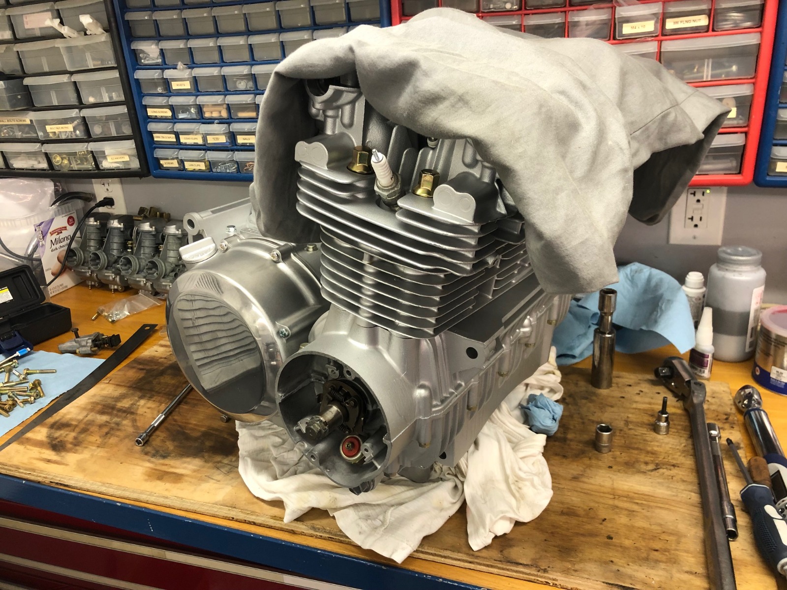

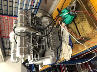

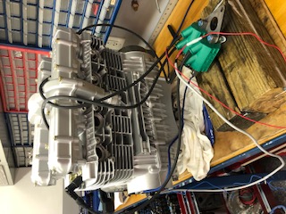

Yesterday finished with valve adjustments. One valve was way out of spec (0.3mm), another was slightly tight around 0.08. And this is after 2nd round of adjustments. Installed different shims. Had to cheat a little. Needed 2.4 shim, but had 2.45 only. So I put it on sharpening stone and took 0.05 off. Put that side facing cup, should be OK.
Today installed Dyna S ignition, was not sure about adjusting, instruction say to use mark which is 1/2 inch on right from T mark, but I couldn't get it there with range of adjustment on a plate. So I just left it in a middle, will do with timing light later.

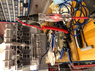

Filled with oil, took plugs off, connected test light to oil pressure sensor and ran started in shorter 4-5 second sessions until light went out. Now it builds pressure with 1-2 cranks. Great!
Next I rigged ignition setup with a battery. Sprayed 1 squirt of start fluid into each intake and it started right away!!!
All happening on a bench, it's LOUD. I was going to start it on carbs next time, but knowing it will run longer and loud I am freaking out now

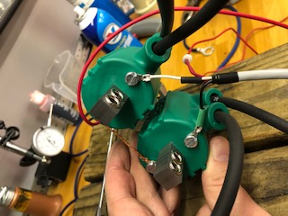

Question is.. After running for a second or two, dyna coils got pretty hot. One more than others. I am not sure if I did something wrong? I connected 1 terminal to + on battery and another terminal to 1-4 and 2-3 leads from ignition. Why would they get hot?
EDIT: Funny searching google brought me back to KZRider: kzrider.com/forum/4-electrical/309828-ne...na-coils-getting-hot
One coil got hotter than another. Oh well, looks like normal? Will need to keep it in mind when working on wiring.
