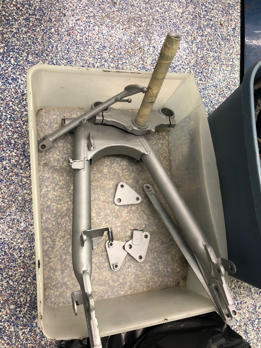

Weather not cooperating, can't do things as quick as I wanted. In addition, AC in garage broke, this is truly suck.

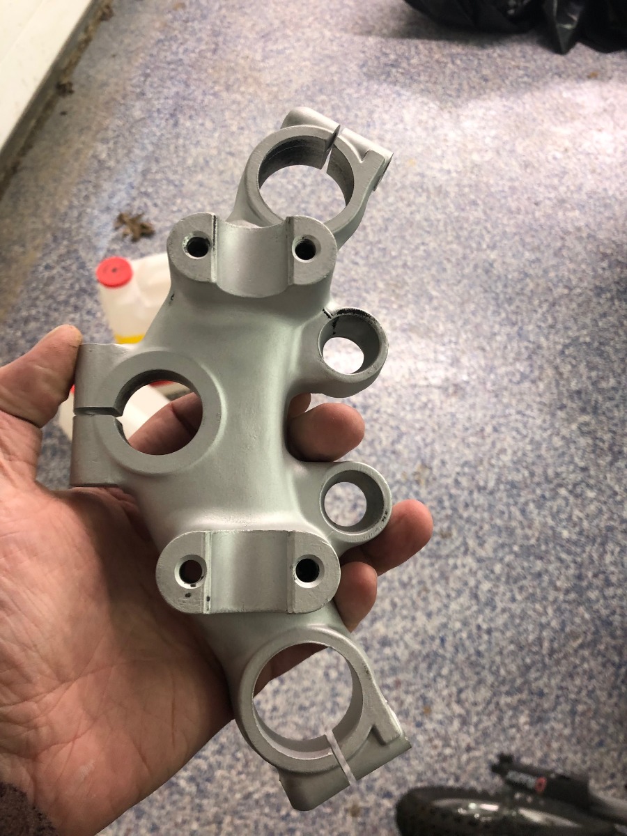

Quick question. Are those triple clamp painted black from factory? Sand blaster took paint off like it wasn't there, very thin weak layer
- Posts: 3161
- Thanks: 1252
Re: Katit's 1978 KZ650 project
27 Apr 2022 09:13
Yes, I used a semi gloss to paint mine.

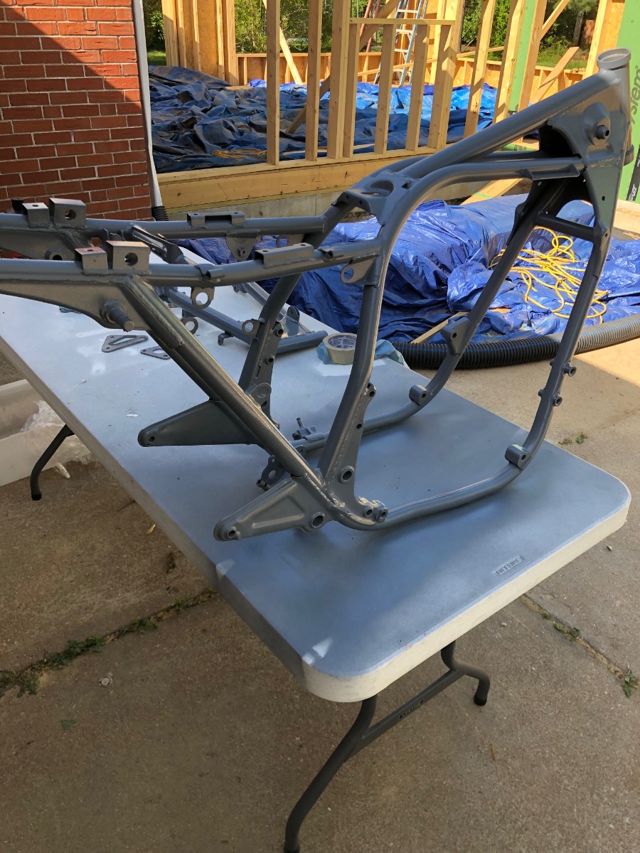

27 Apr 2022 14:53

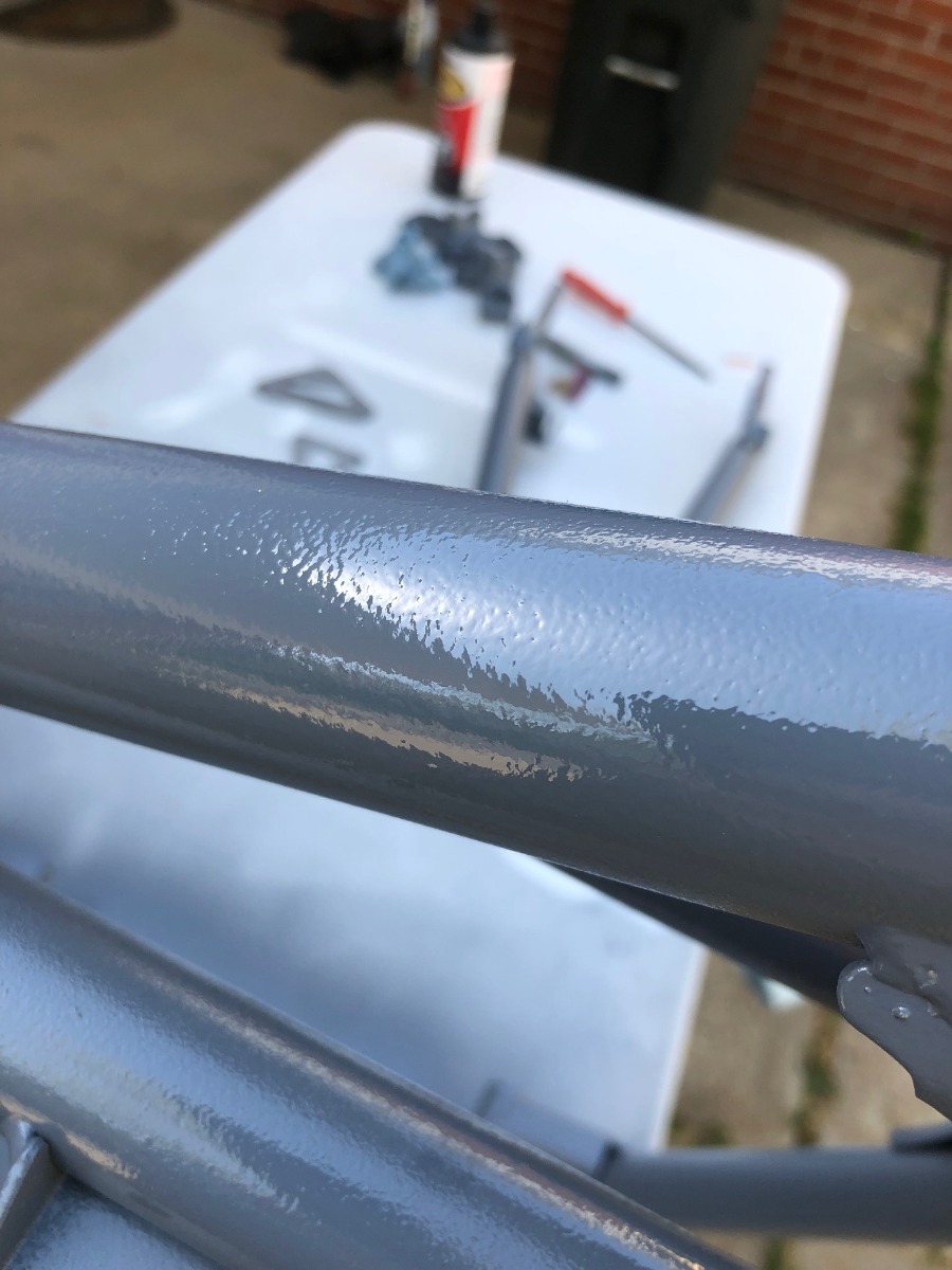

Primer applied. This Raptor may not be designed to lay very flat. Also, I didn't have gun with 1.7+ nozzle, used 1.4. Got some texture. Oh well. I kind of expected this, it needs to be sanded anyways. But big part is done. I covered parts with primer, now I can take my time prepping for paint. No weather for a week, enough time.

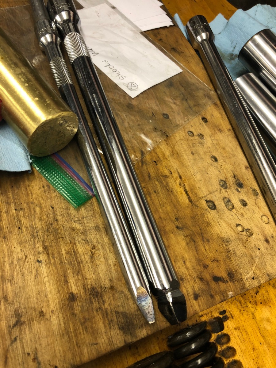

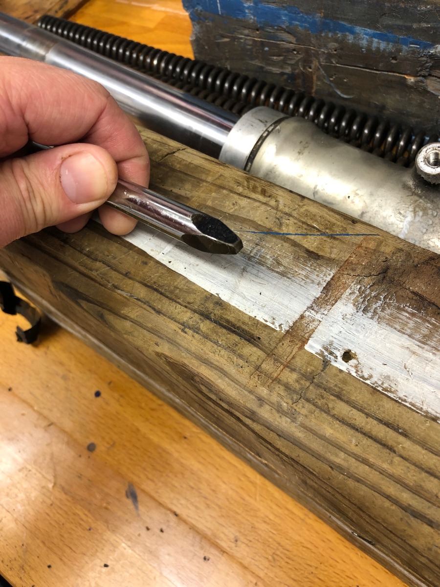

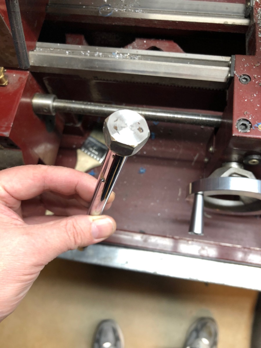

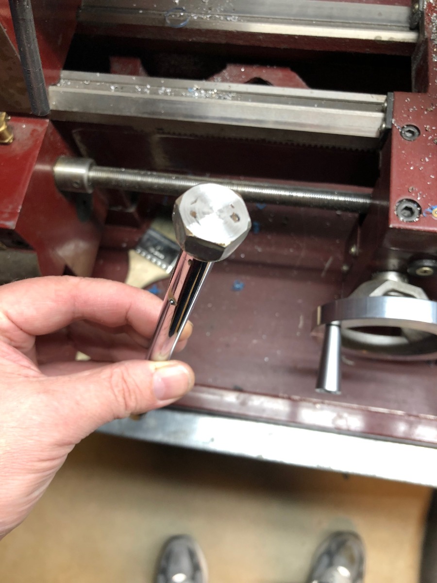

The story of ONE TOOL. Need to disassemble forks. I read people using brum sticks, etc. But I also read that people use 19mm bolt head. Ok, I sacrificed HF extension, welded 19mm nut on it and got nice tool. But it didn't work.
Ok. I guess I needed to read a BOOK first. Book mentions special tool. Googled special tool - looks like 4 edged spike. I thought it's a 3/8 extension on picture, cut welded nut off and got new tool. But it didn't work (too small)
Ok. Let's destroy 1/2 HF wobble extension. Another tool.
