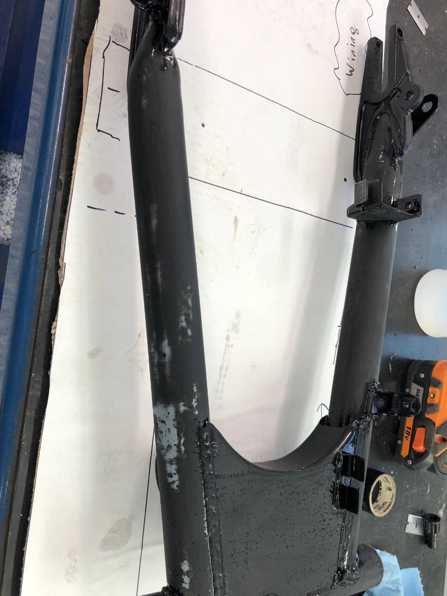

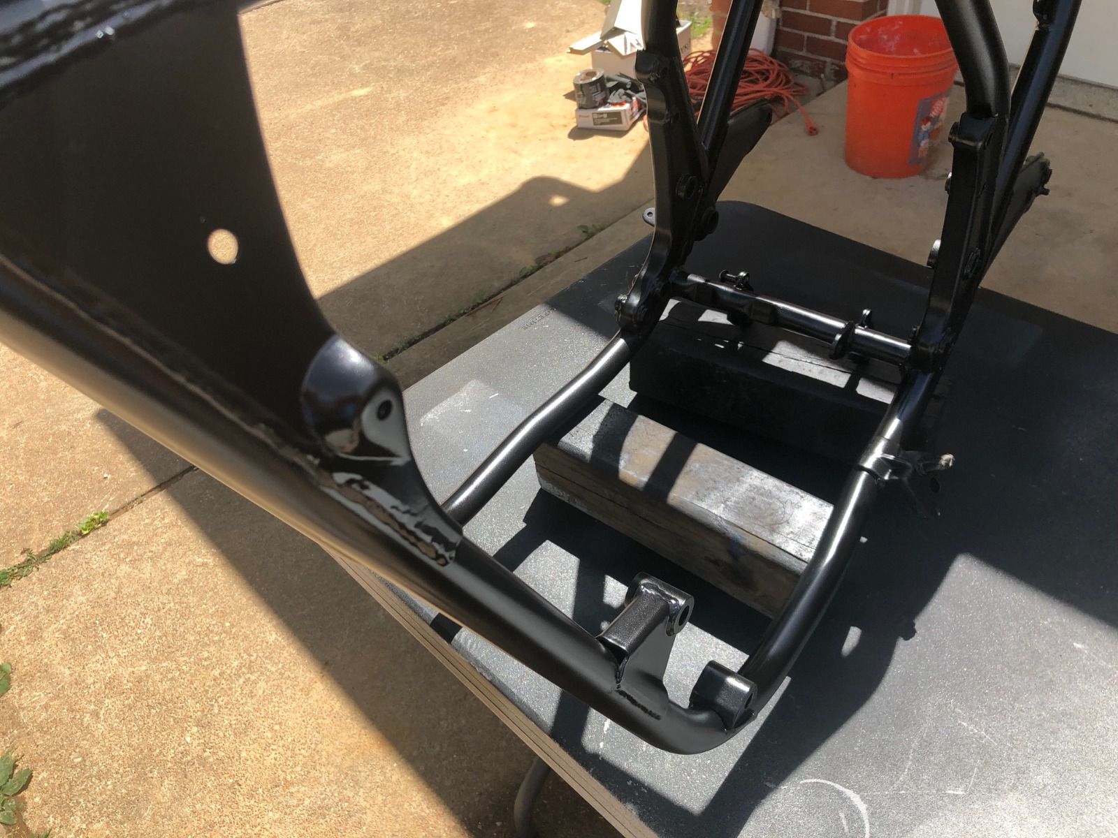

My OCD just won't let me rest. No, I am not going to leave painted parts as is. I did downgrade to spray bombs for frame (VHT frame/roll cage). I tried to use it per instructions but still got runs when did swingarm (it's on picture prepped).
Prepping - I have to sand every bit now. Orange peel from previous prime/paint is too much for my taste so I sand it all down. Good thing everything is dry and not too bad to sand.

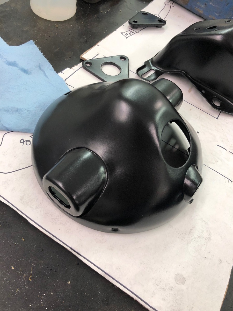

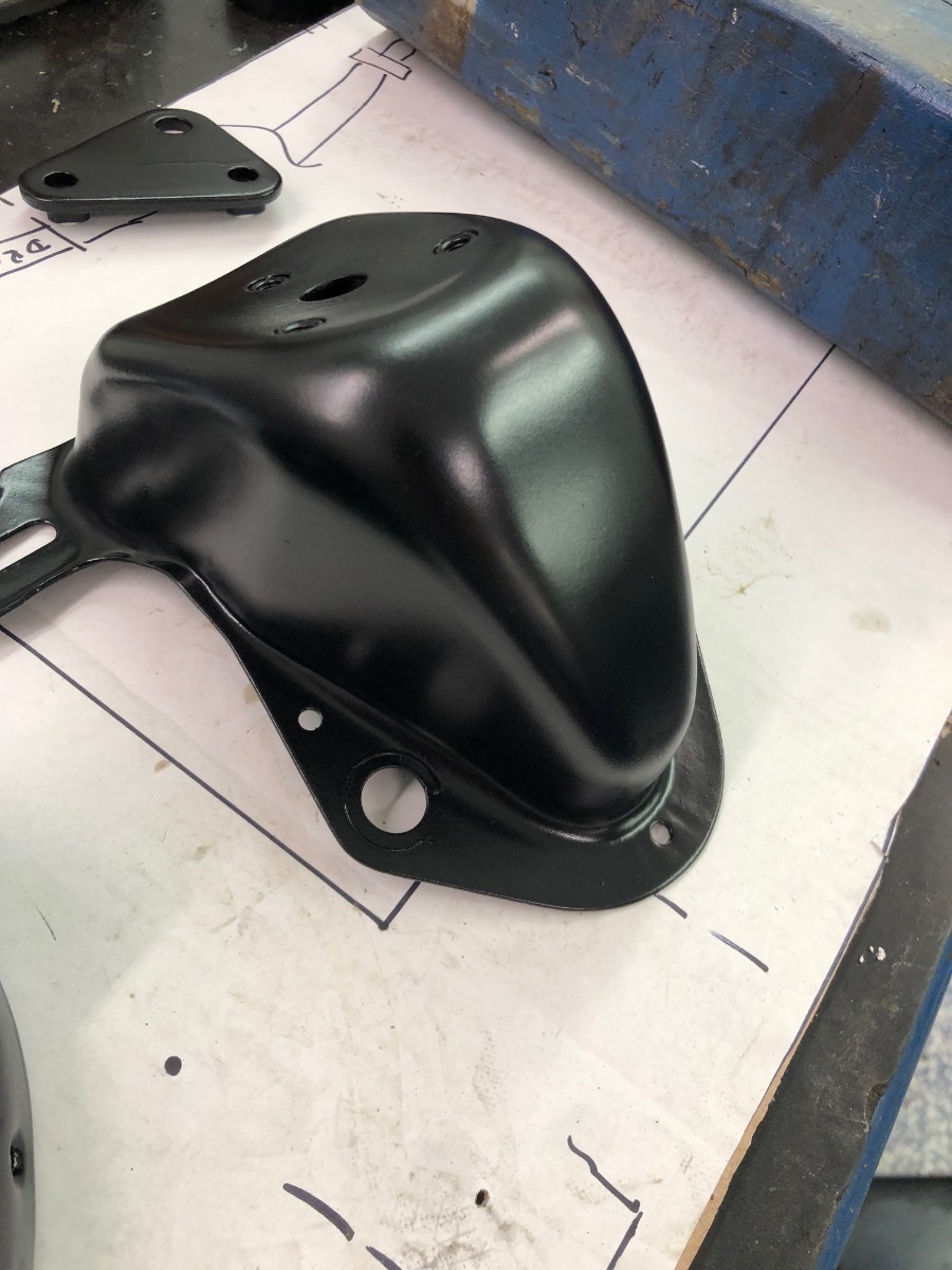

First tried failed with swingarm. Yesterday painted light casings and few small bits - worked much better. Really need to be careful not to create runs. Layer will be thin, but I have 2 layers under, so it should be just fine. I like finish I am getting though. Will do few more practice batches with smaller parts before tackling actual frame.

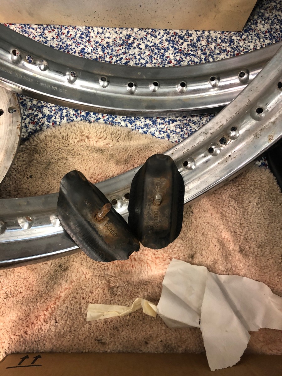

Question, do I need those bead locks? New rims don't have holes for them and I was just wondering if they really needed..
- slayer61
- KZR FLAG RELAY CARRIER #62
- Posts: 908
- Thanks: 276
Re: Katit's 1978 KZ650 project
14 Jun 2022 07:48I raced flat track in my past and had tire pressure as low as 12 PSI and never used bead locks. I would ditch 'em.

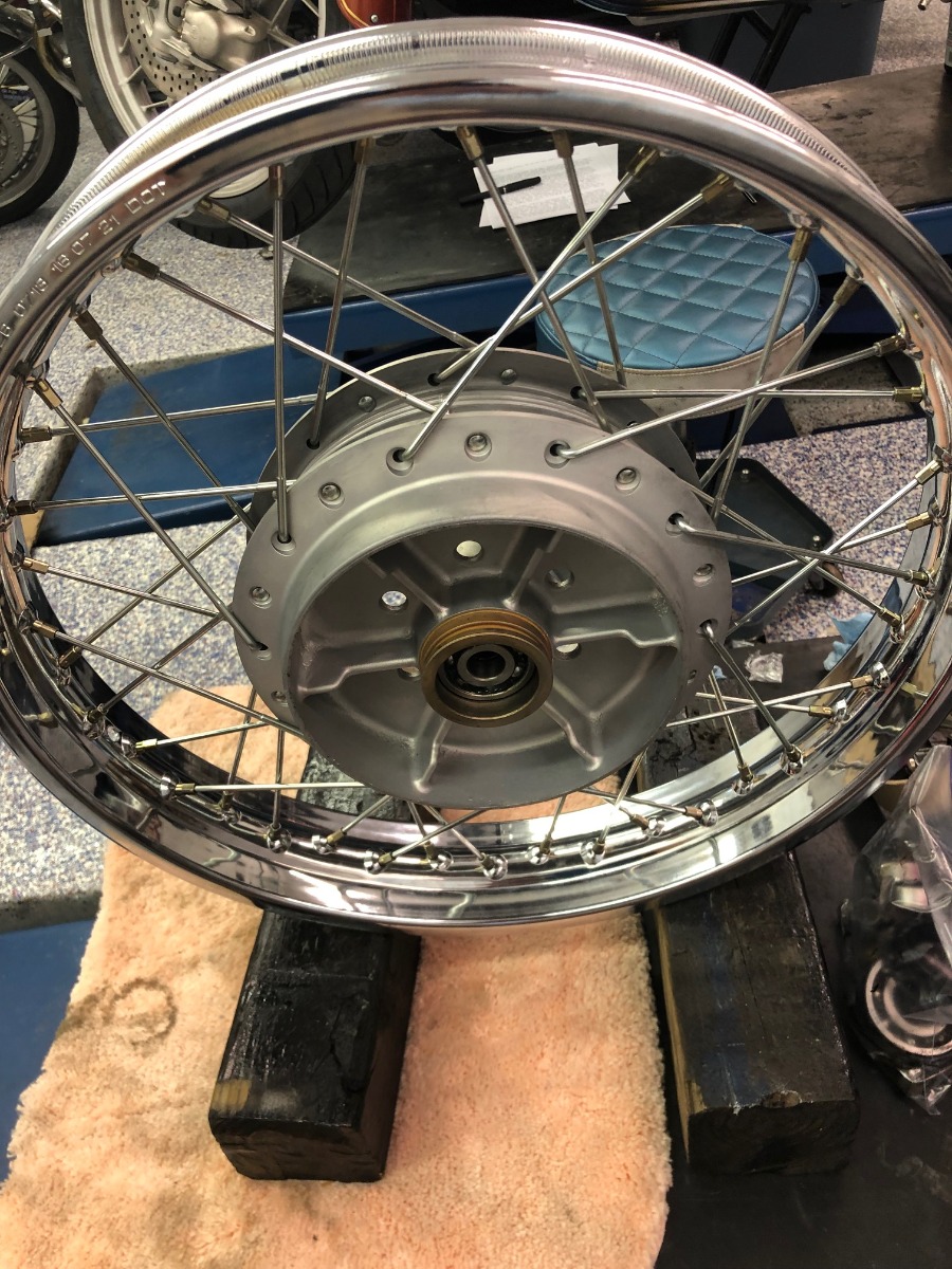

Did some work(no pictures, sorry). Rear wheel is done. New rim, spoked, new bearings installed.

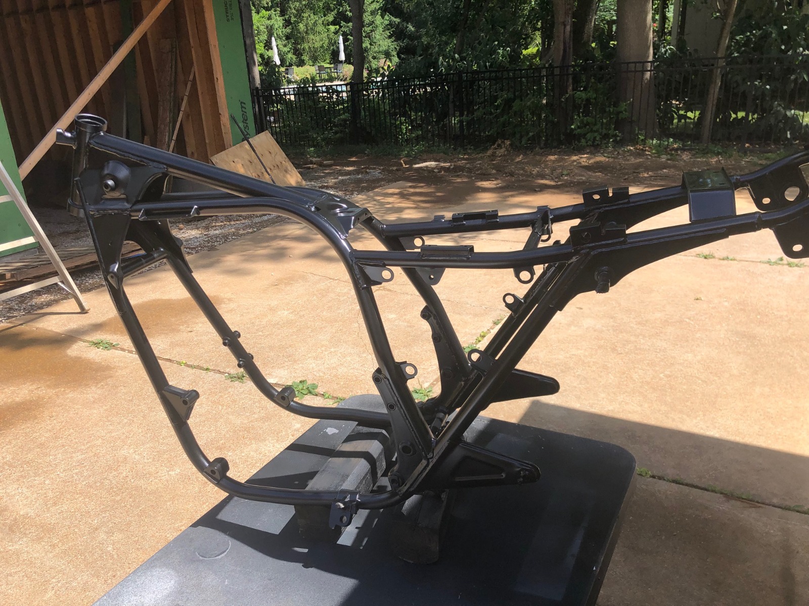

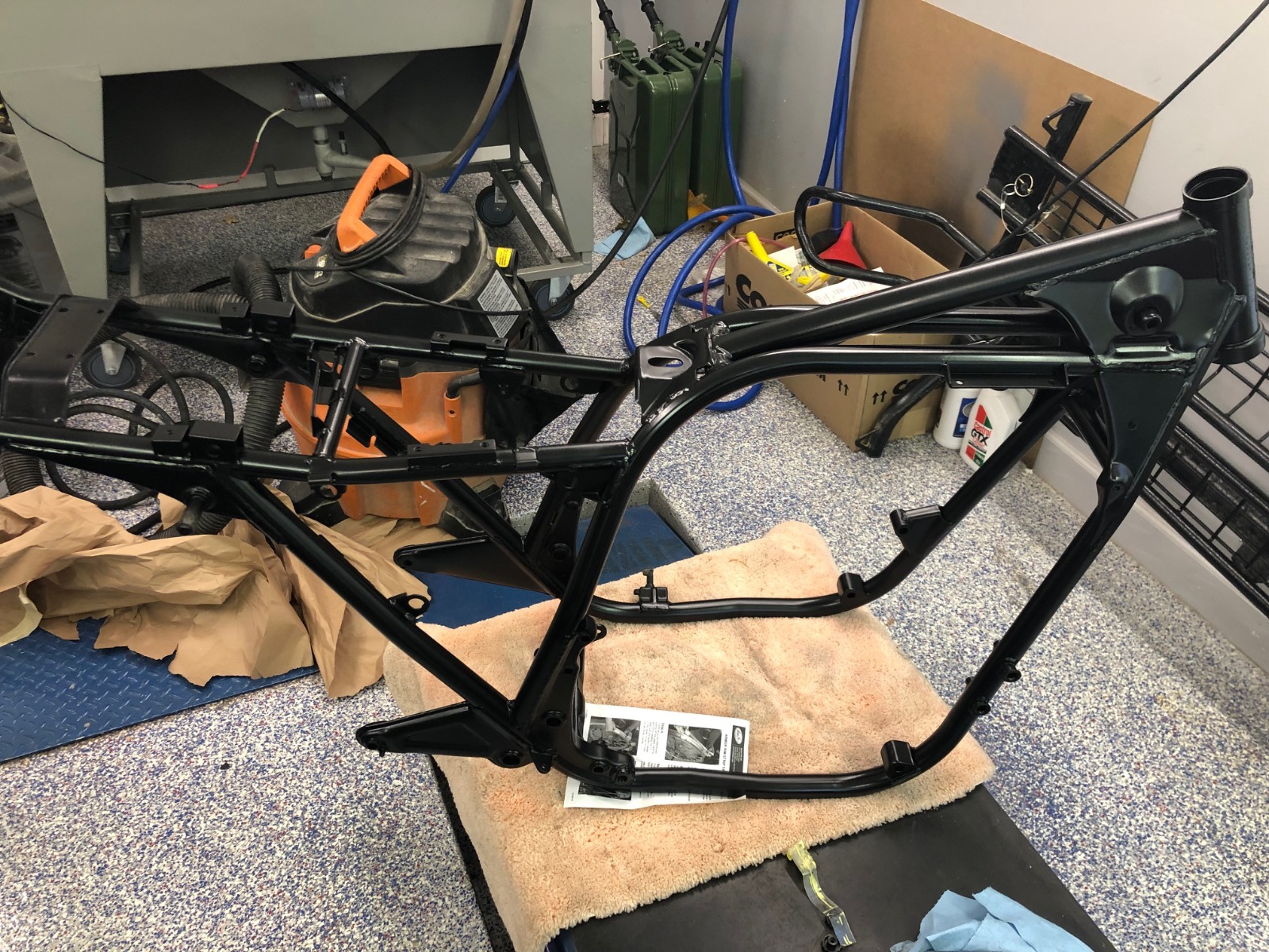

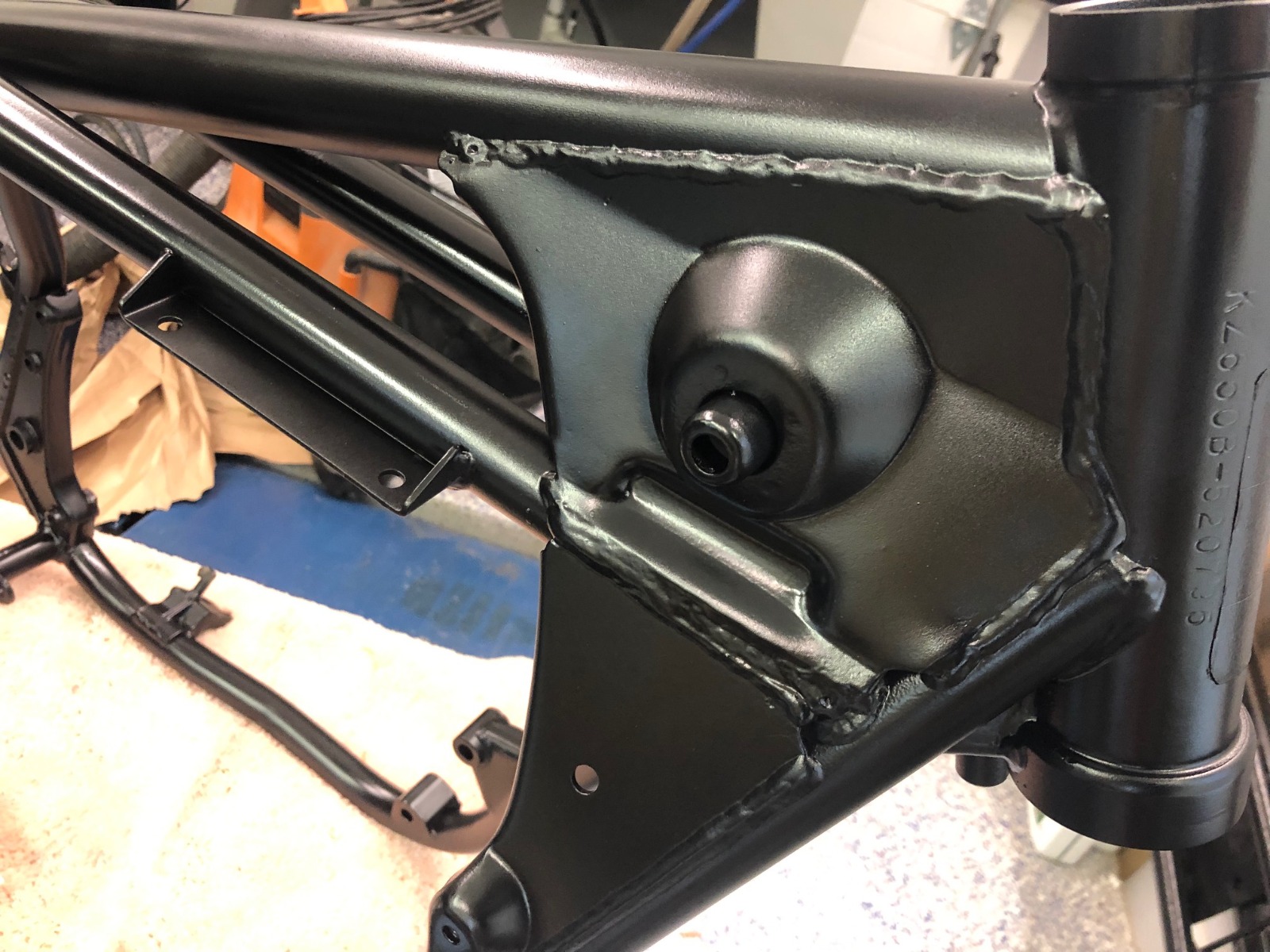

Progress. Finally frame painted and to my liking. Maybe. Maybe not 100% perfect but 8/10 on my scale and once assembled will be just perfect.

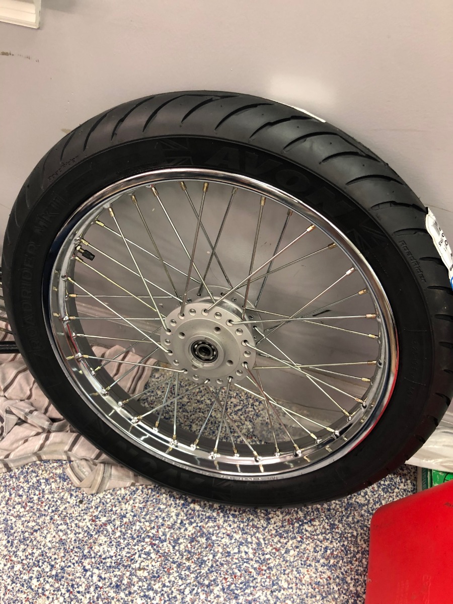

Front wheel is ready to put on a bike (even though to make it a roller for now). Rear wheel spoked and trued. Need to mount a tire and will be ready.
I am moving forward getting roller going so I can install engine and refocus on what else is next.
