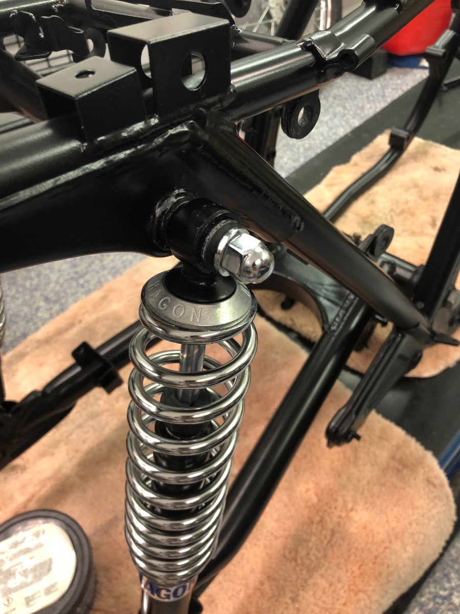

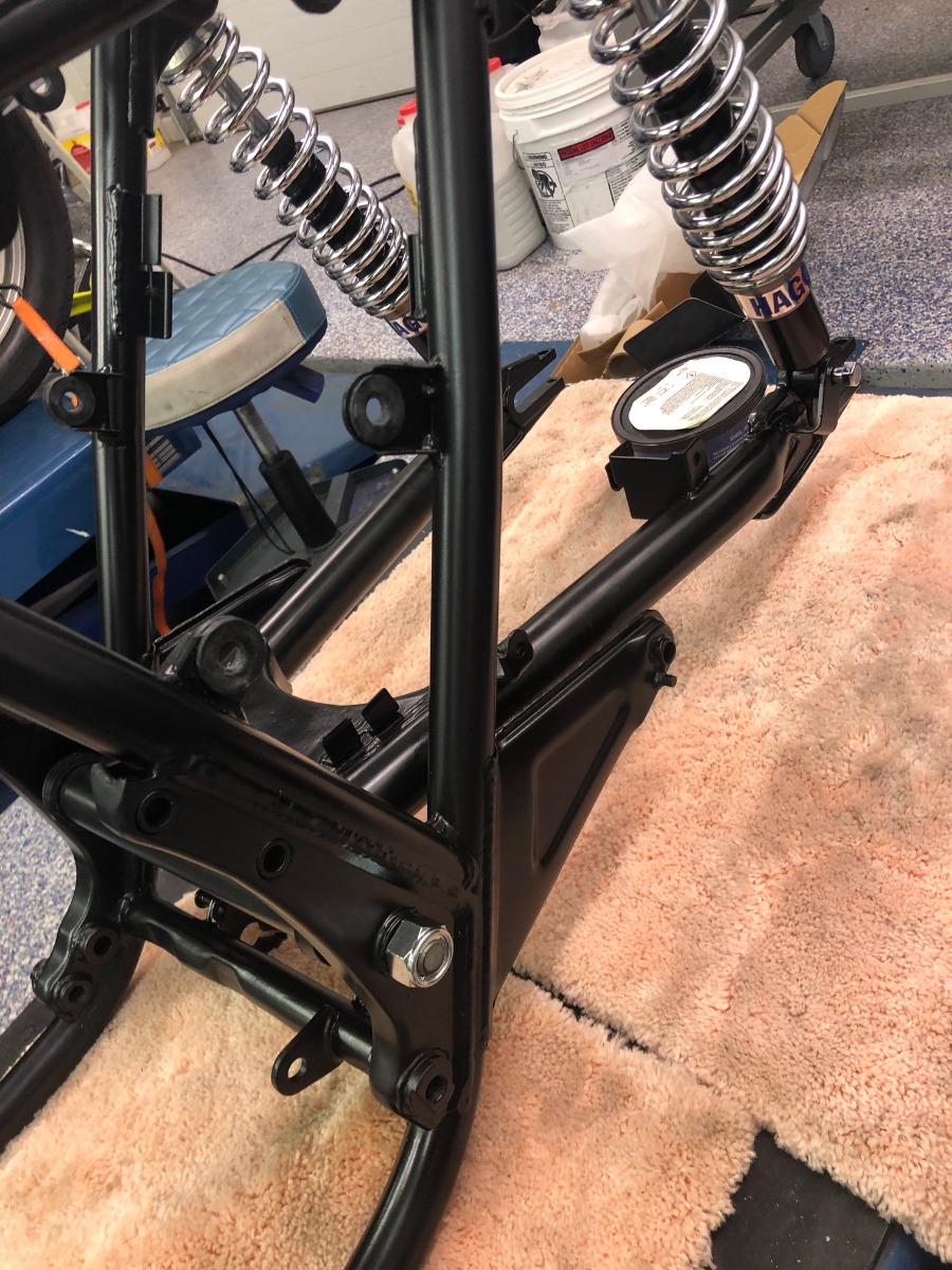

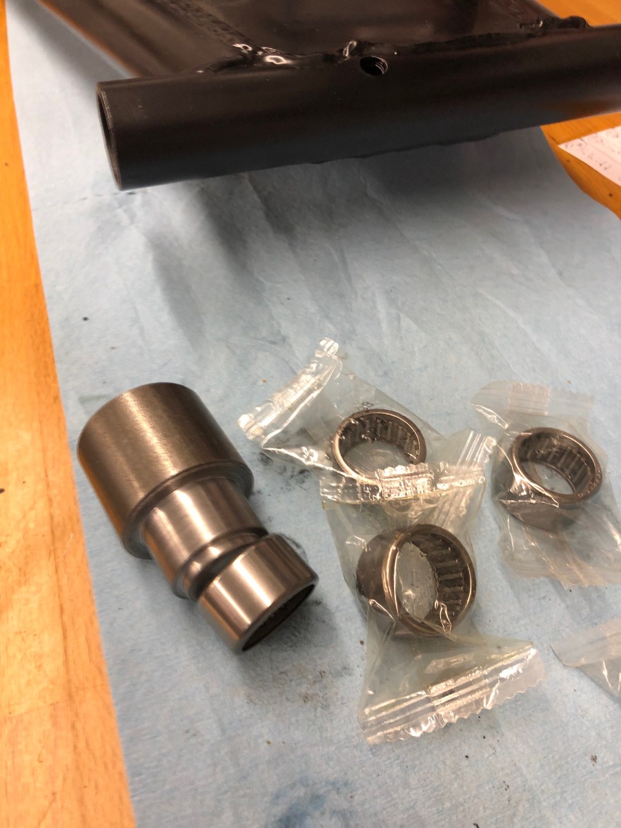

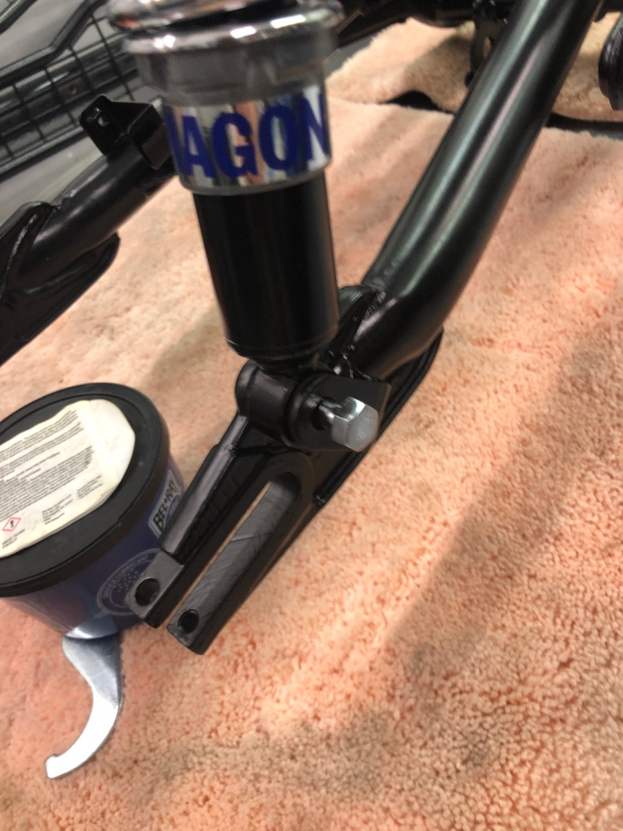

Small steps. Of course I somehow threw away bottom bolts for forks so now waiting for package. Started to blast/clean hardware and small bits prepping for plating.

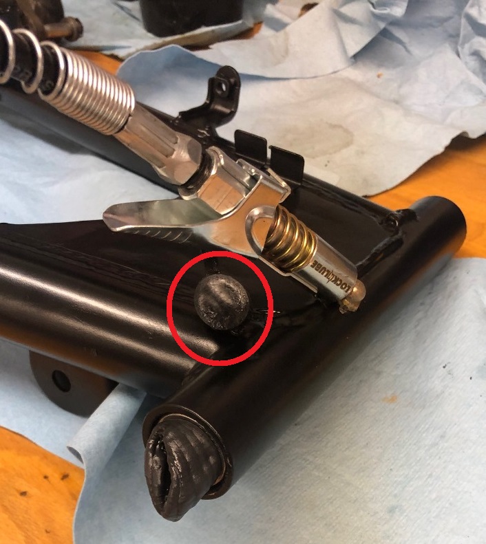

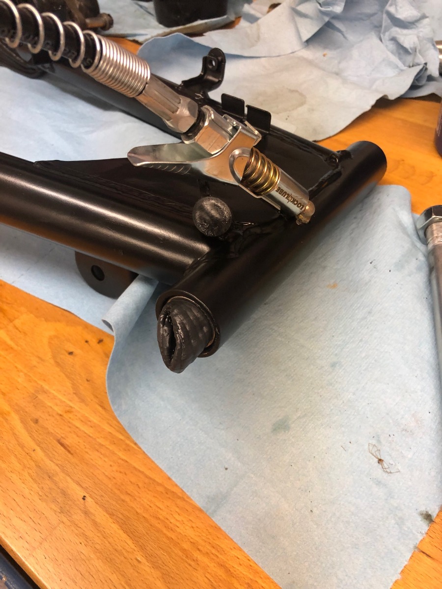

Swingarm - had to make bearing install tool. Packed with grease and installed. Also installed Hagon shocks (btw, not really excited with quality but oh well..). Nothing permanent yet, just sorting through plated and other bits and put it in places.

Does that photo of the swing arm pivot with grease gun show grease coming out of the swingarm bracing plate behind the pivot tube? Grease is not supposed to come out of the there! Maybe that's just a blob the fell off the gun before it went onto the zerk fitting?

Nah. It’s neither. I was looking at this photo myself wtf
It is plastic cup that covers grease gun nose.

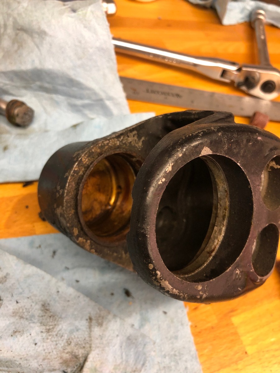

Calipers look sad. But definitely rebuildable. I did bad thing, took off one nipple and looks like thread got damaged. On second caliper I heated with torch and it came out clean.
Don't know, will try to chase threads and it may work. Or maybe I should try and do 8mm threads right away

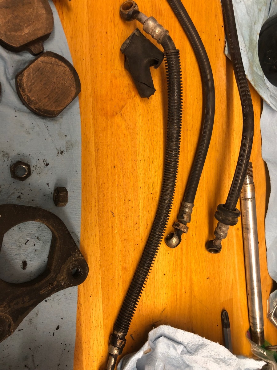

Found two lower hoses at z1-parts. But I can't seem to find top one. This is one with rubber dust cover and spring over it. Any suggestions where I can buy it? (I know I can buy aftermarket..)

Nipple? Do you mean Bleeder screw? If then that’s a pure random thing never had that happen. The dust boot is a separate item,
www.partzilla.com/product/kawasaki/49006...c598d659766d264f4f19
not part of the upper hose. These are about the closest thing I have found to OEM. You’d have to email them to see if they have hoses for your bike.
item number 234024998157

I had a heck of a time finding hoses for my 650 project. I finally went after market, but I'm still having issues bleeding the lines.

Calipers were pretty crusty. Bleeder screw was corroded in caliper. I should have stopped right away and torched it like I did with second one. But oh well. Will see, will first chase those threads and see how it goes from there. There is enough meat to go M8 if needed and I can machine new screw worse case scenario. Buying spare used caliper would be easier but quick search on ebay proved to be confusing.

01 Jul 2022 08:37I had a heck of a time finding hoses for my 650 project. I finally went after market, but I'm still having issues bleeding the lines.
I do see two bottom ones available no problem. Just a top one I need to find. Bleeding should be easy I would think. But I always use pressure bleeder. Will see how it goes with this one.
