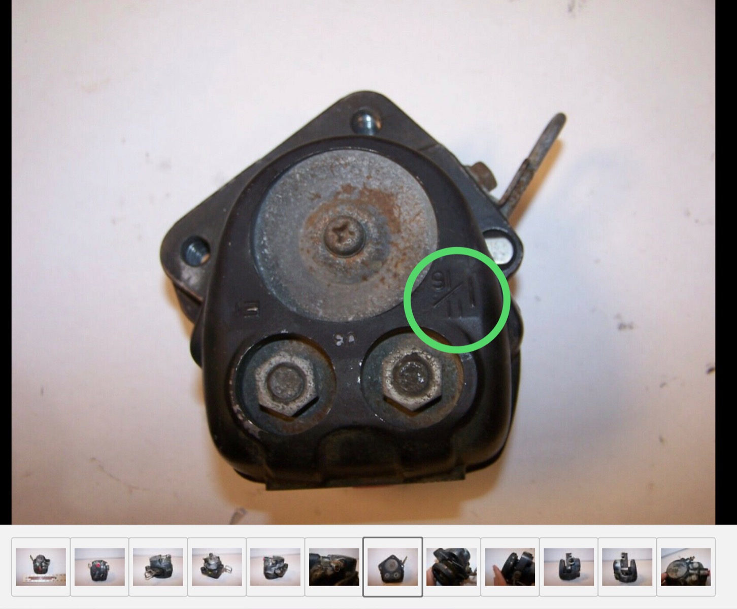

If your looking to match a 43mm piston size, you need to find calipers that are marked with 1 11/16. It will be on the hub side (inside) of the caliper.

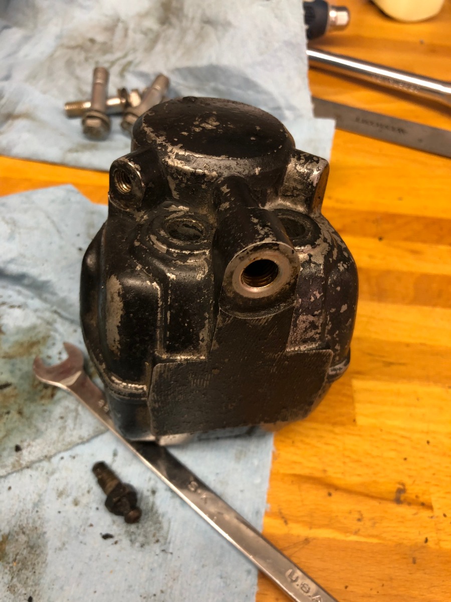

01 Jul 2022 09:31This ones not bad.
item 123675943899
keep in mind these are handed based on the “nipple” location. It needs to face up…
lol he said nipple!!!
This is bad one. Not sure which one is it (R or L). But on those ebay items, how do you know it's 43mm?

That looks like the "R" one to me, if you put it on the left the "nipple" would be at the bottom making it almost impossible to bleed (we have "grease" nipples as well

Agree with Wookie. It looks like a RH. If yours mount trailing fork.

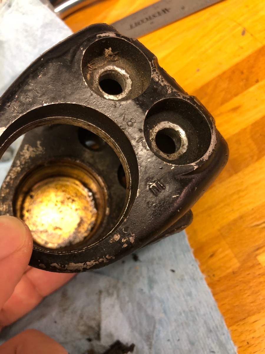

Go here.
www.partzilla.com/product/kawasaki/43020...c3a6020f0cd4f6a63f2f
It gives you all the other bikes that use the same piston.
It’s also saying it’s a 42mm piston. I converted 1 11/16 to mm and it came out to 42.86. So I called it a 43. I’m guessing 42mm is correct
