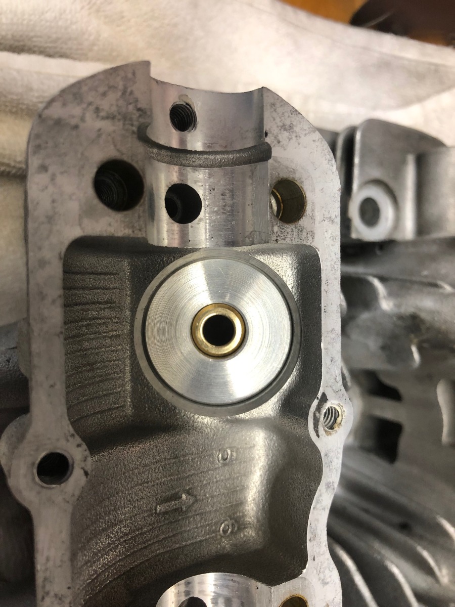

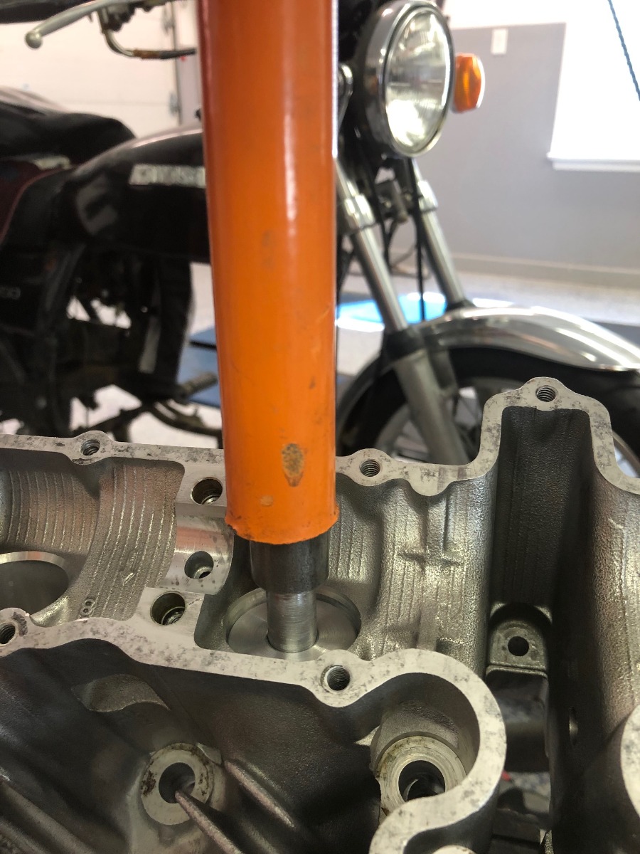

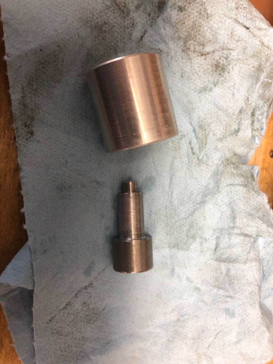

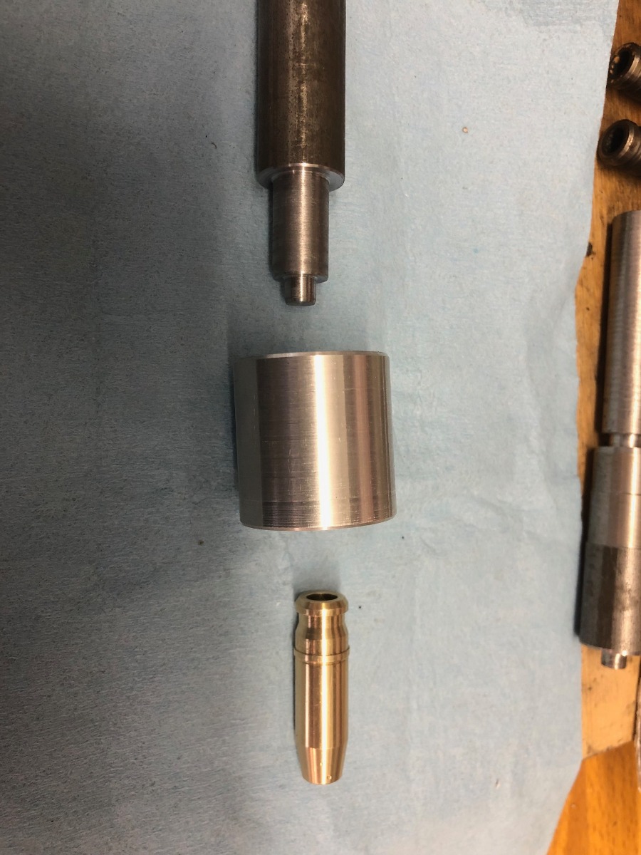

More progress. Liked idea of using cap hole as a guide. Machined aluminum bushing and press adapter to fit tight and stop when correct press depth achieved. ID of bushing is just right to fit new valve guide.
All guides went in easy and quick. Proper tool makes a difference! Pressed back some old guides into other head (original) which going to be my test bed for cutting valve seats!
Now, zed1015 were absolutely right. Right now I can't insert valves into guides. Micrometer gauges and hone is on a way but meanwhile I can work on valve seats...

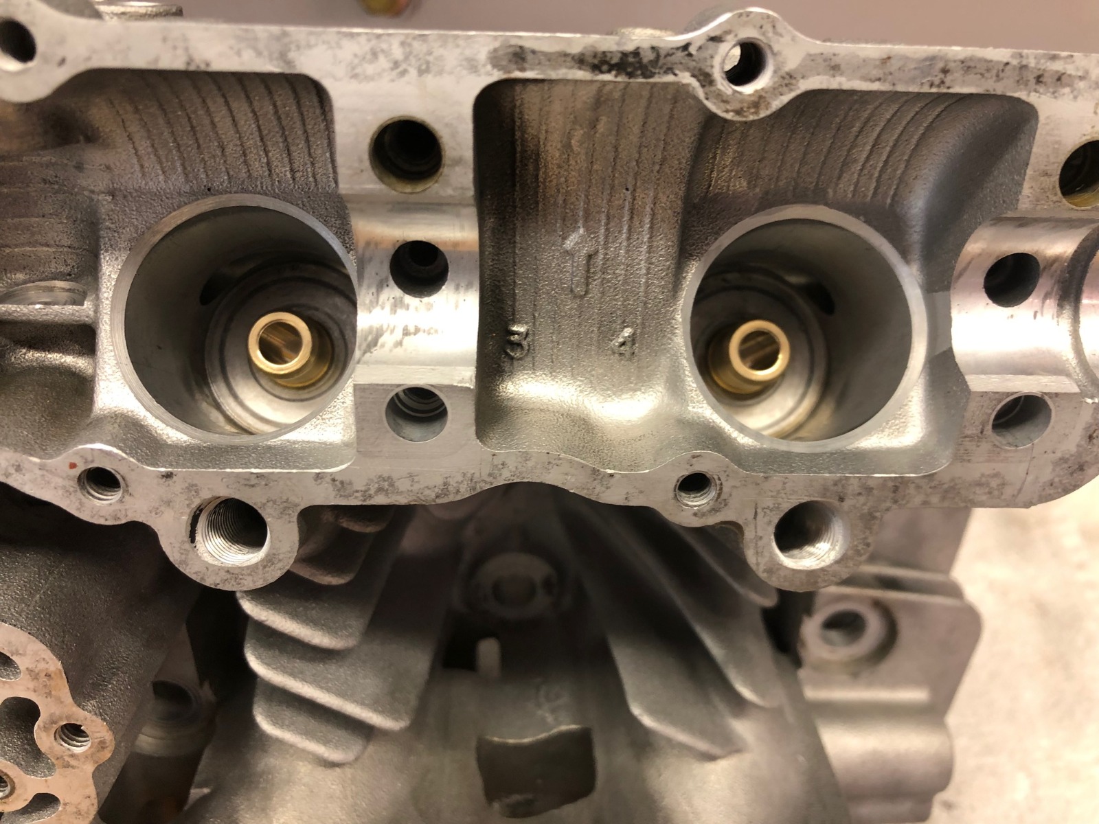

Re: Katit's 1978 KZ650 project
25 Sep 2021 13:38

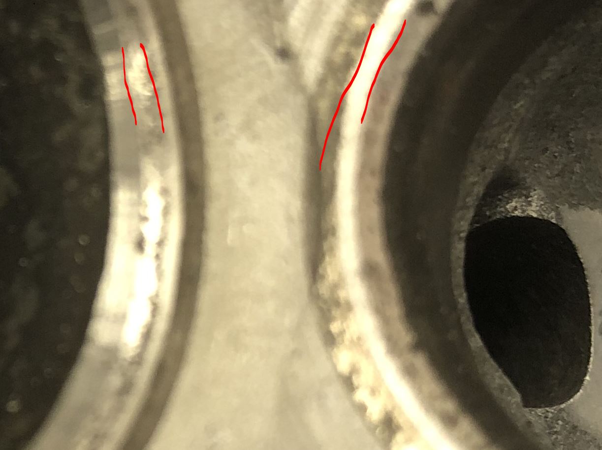

Question about valve seat cutting. I tried on scrap head and this is result. There is some deep pitting, hopefully you can see it on a picture, so main surface (45 degree) need to be cut pretty deep to get to clean metal. At least on this head. Is this expected? Or leaving some of this pitting is OK?
BTW, per manual only intake needs 3 angles. Exhaust needs just 45 and external angle
- Posts: 8057
- Thanks: 3444
25 Sep 2021 13:58
The seat should be a uniform 1mm wide. Use the top and bottom cuts to center the contact patch on the valve face. When cutting the valves on my 750 the seat widths were pretty uneven but I was able to clean them up nicely using Suzuki type cutters with a 75 degree throat cut and 30 degree top cut. Kawasaki references the top and throat angles opposite of normal convention; the throat cut they call a 30 but most people refer to it as a 60.
- katit
- Posts: 460
- Thanks: 47
25 Sep 2021 14:19Ok. I am all inThe seat should be a uniform 1mm wide. Use the top and bottom cuts to center the contact patch on the valve face. When cutting the valves on my 750 the seat widths were pretty uneven but I was able to clean them up nicely using Suzuki type cutters with a 75 degree throat cut and 30 degree top cut. Kawasaki references the top and throat angles opposite of normal convention; the throat cut they call a 30 but most people refer to it as a 60.
