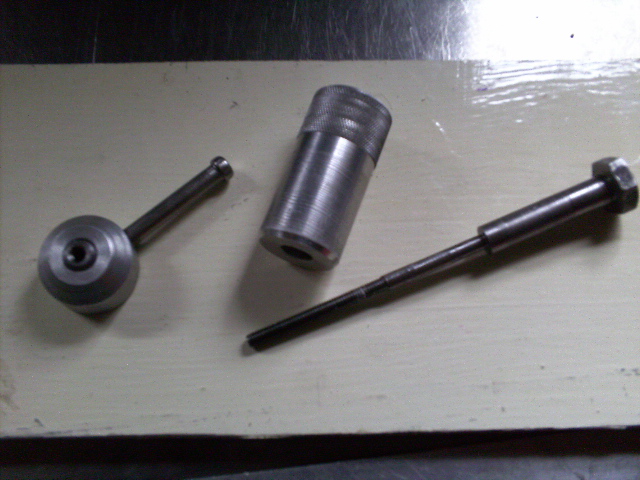

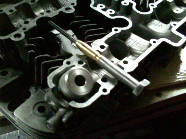

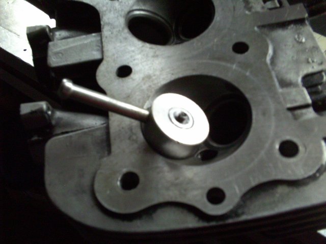

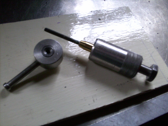

I made this tool to draw the guides into the head.
The guides follow the bore in the head when being drawn in rather than drifted and leads to closer concentricity with the valve seat and less cutting if any to true the seats to the new guide..
Far right is the draw bar. Middle is the insertion guide for the bucket bore and left is the glorified nut which has a 45 degree taper to centralise it on the valve seat .
Insertion guide slips in the bucket bore and the valve guide on the draw bar.
Threaded 'nut' sits on the valve seat. Main body is aluminium to prevent seat damage.
Threaded center portion is steel and you hold the handle to prevent it from turning when tightening the drawbar.
Use a bit of lube on the threads and the valve guide.

23 Sep 2021 08:10Quick question. I am thinking on maybe replicating your tool. Is that m6 thread on it? Is it strong enough to draw insert in?Far right is the draw bar. Middle is the insertion guide for the bucket bore and left is the glorified nut which has a 45 degree taper to centralise it on the valve seat .
I really like idea of using aluminum bush to center guide in place. I may just do that and use my press instead of dealing with threads, nuts, etc

23 Sep 2021 08:26Yes! it's a 6mm thread. Couldn't go any bigger, well maybe 1/4" imperial.Quick question. I am thinking on maybe replicating your tool. Is that m6 thread on it? Is it strong enough to draw insert in?Far right is the draw bar. Middle is the insertion guide for the bucket bore and left is the glorified nut which has a 45 degree taper to centralise it on the valve seat .
Was wary it may not be up to the job when i made it but it works fine and has done many, many guides.
The draw bar is made from a spare swingarm spindle so good tensile steel.
