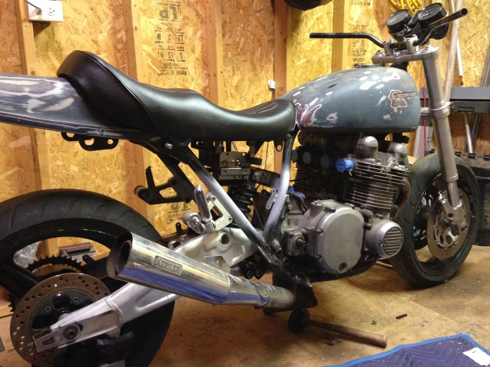

I won't really know what I need until the seat pan is done, but the seat will definitely be a lot shorter than the 1100 - will be a single seater. , don't want anybody on the back of this one.
Will almost certainly have to get the seat cover made, but thanks anyway.

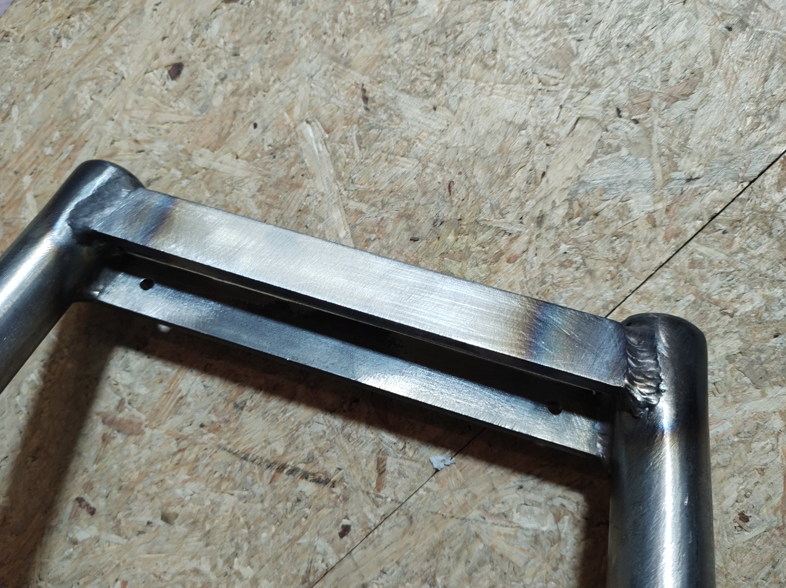

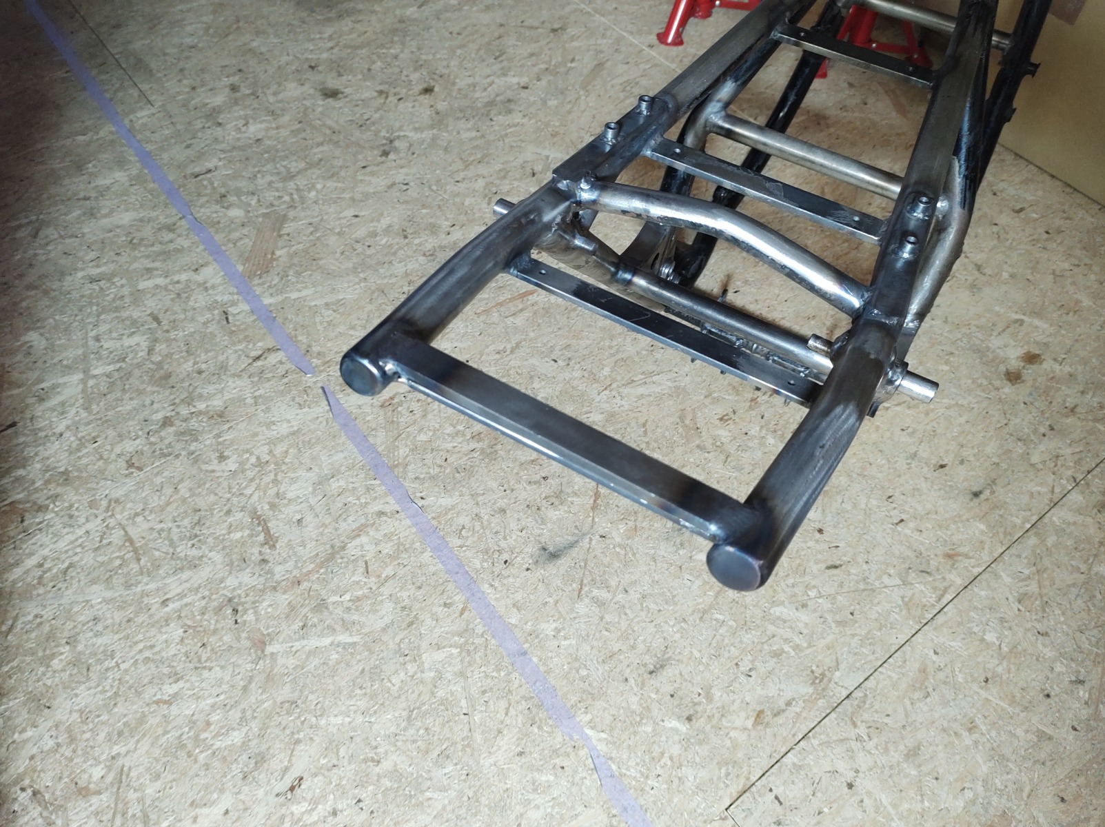

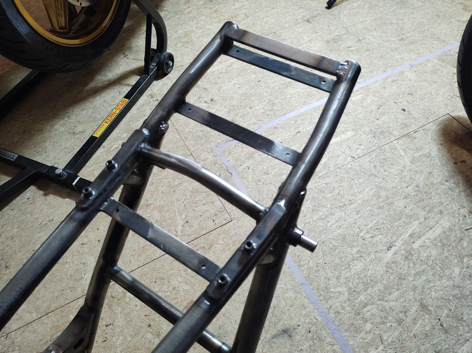

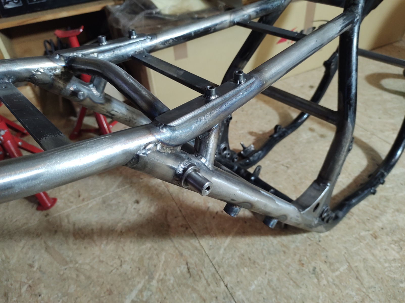

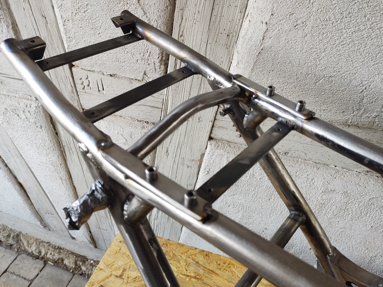

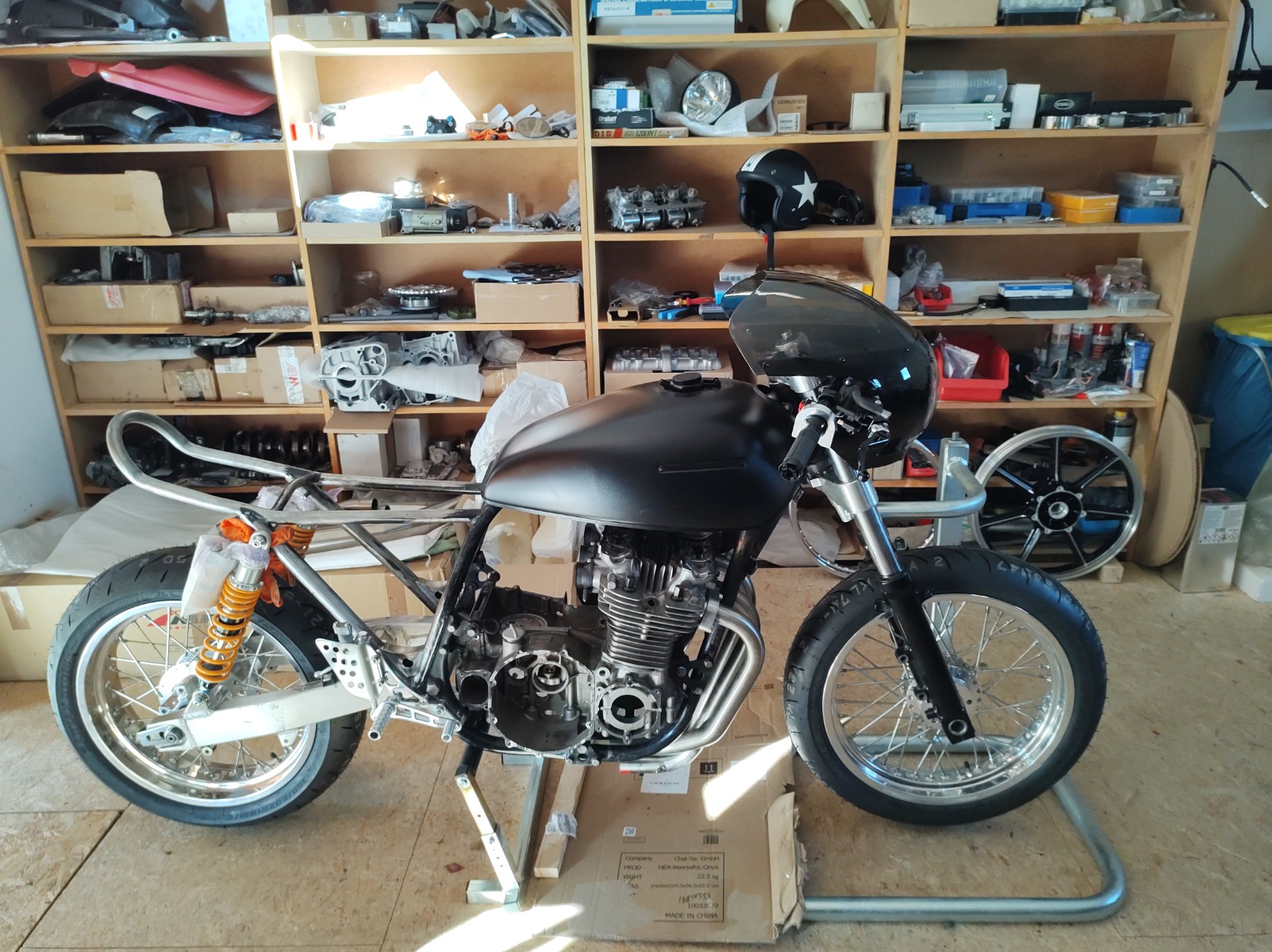

Got the frame back.
Did the back end myself - changed the brackets to a straight bar and just plugged the end of the tubes. Welds are a little bit better with the reading glasses.

Being able to clearly see the weld puddle, and the seam, makes a remarkable difference in weld quality.

20 Jan 2022 14:11Just curious, have you installed the swing arm, the rim and tire you are going to use along with the shocks without their springs and check to make sure nothing will come in contact with your tire throughout the whole range of suspension travel??

The rear end upswept frame looks like to have a lot of space left for the suspention travel and tire/fender clearance.
- calum
- Posts: 1144
- Thanks: 415
Re: 1977 KZ1000 Restomod
20 Jan 2022 22:35 - 20 Jan 2022 22:49Just curious, have you installed the swing arm, the rim and tire you are going to use along with the shocks without their springs and check to make sure nothing will come in contact with your tire throughout the whole range of suspension travel??
I haven't taken the springs out but the clearance under the tail section would allow the springs to fully compress. I'll double check again later though, thanks.
