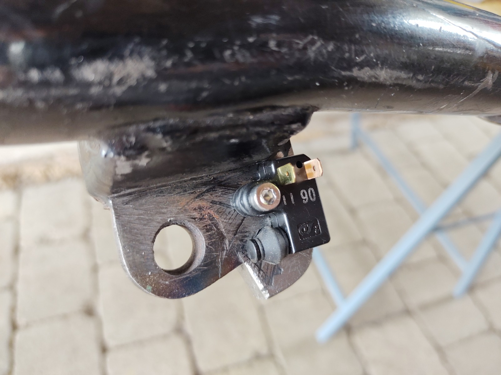

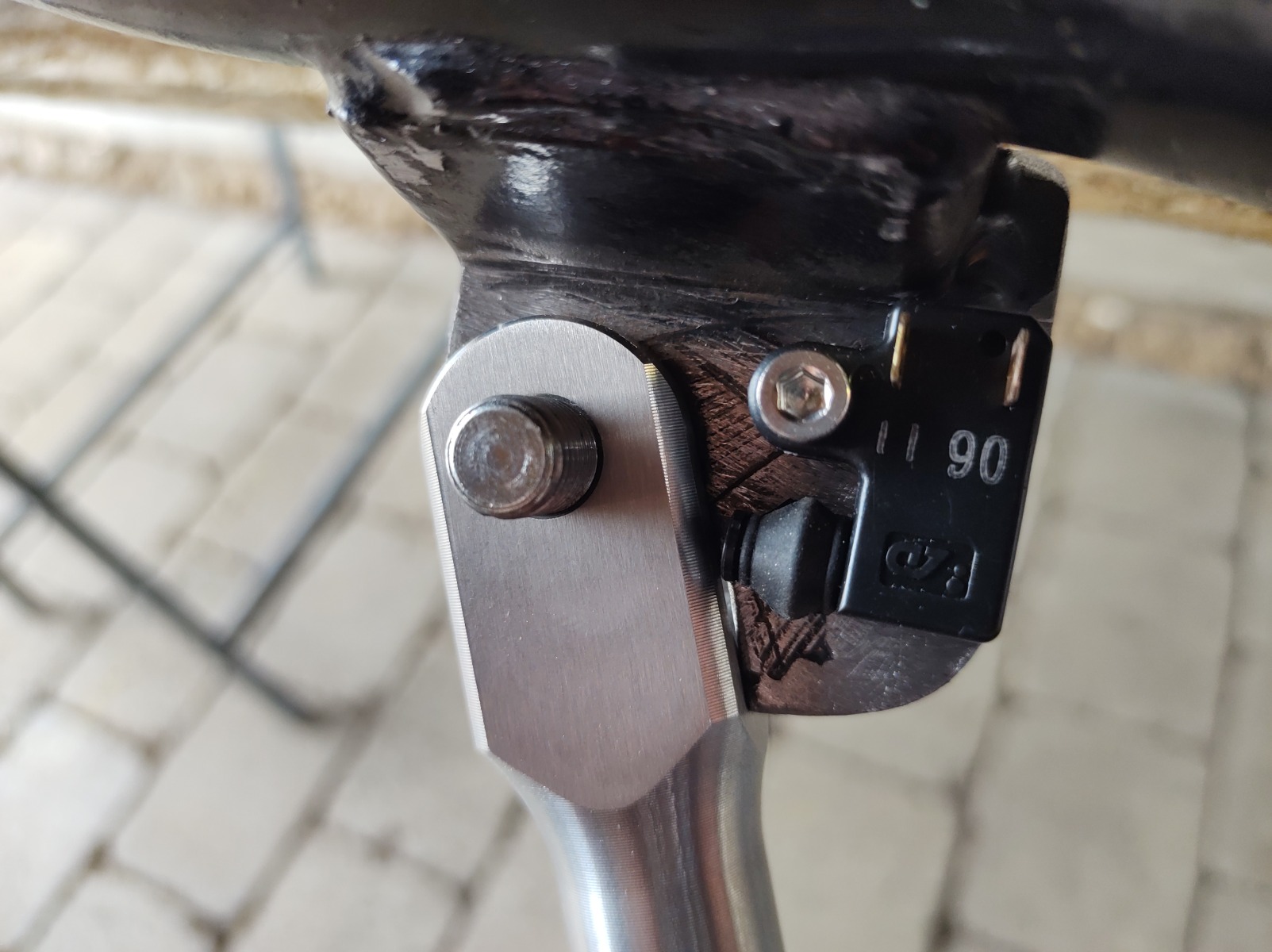

Drilled and tapped the holes for the 550 side stand switch today. Need to weld something to the stand so it hits the switch. Working on the Duke 125 tomorrow so I guess that'll have to wait until next weekend.

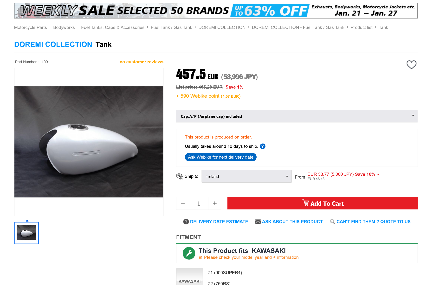

Thanks, I'll probably go with one of these - more money, less work
although I'm still looking for a cheaper option.
www.wwag.com/cgi-bin/WebObjects/WebSite....tion?page=%21WW24480
