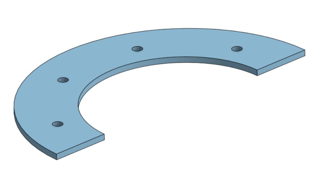

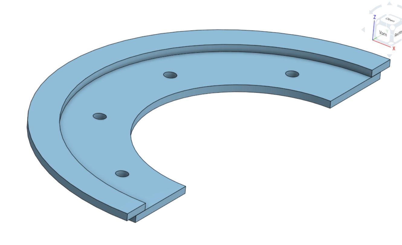

23 Jan 2022 13:20I'll cut out a slightly larger section than needed and make up a flange with a step down so the cap is flush with the tank (may need a bit of filler on the transition from the tank to the flange). I have a few ideas of how to do it but I need to wait until the tank is here to see where I need to cut it and how curved it is there.

This picture might make a bit more sense... I'll try and get the cutout in the tank flush with the step - hoping it's pretty flat at that diameter.

I'll either make up some short threaded bungs and weld them in place before it goes in or I'll just get the parts cut out of 2.5mm steel and cut the threads directly into the plate. 8 x M5 threads each 2.5mm deep should be plenty. Not really worried about weight.

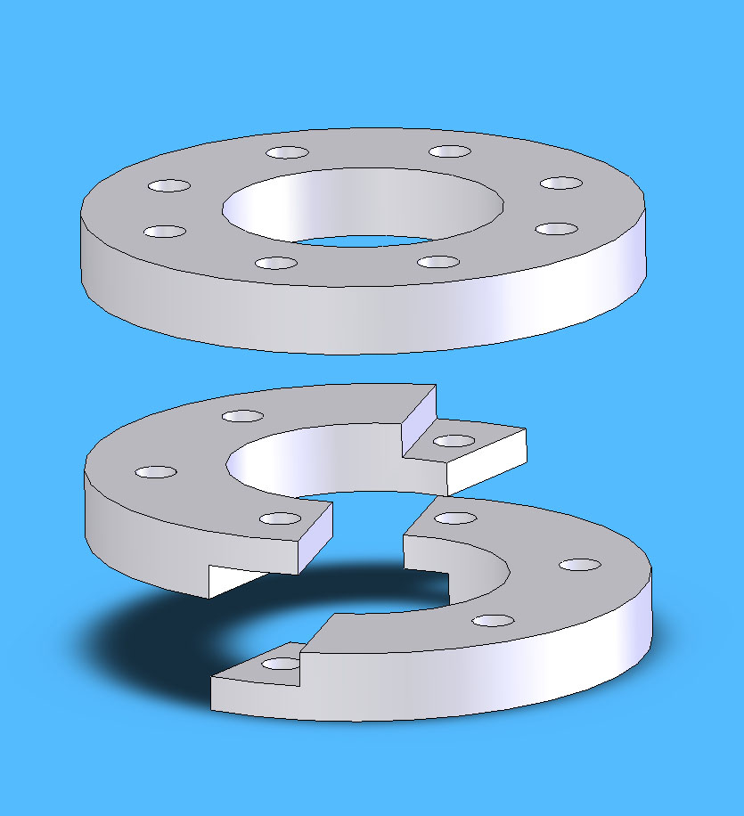

Continuing to think of overly complicated solutions, I was trying to think of a way to form the area around where you want to weld to make it into a flat ring. I was thinking you could make two piece insert and then clamp the rim to form it to be flat. No idea if that would actually work. The metal might winkle or just refuse to change shape.
The picture below shows what I'm thinking. The two piece split ring goes on the inside, the full ring goes on the outside, and you clamp it together with bolts.
