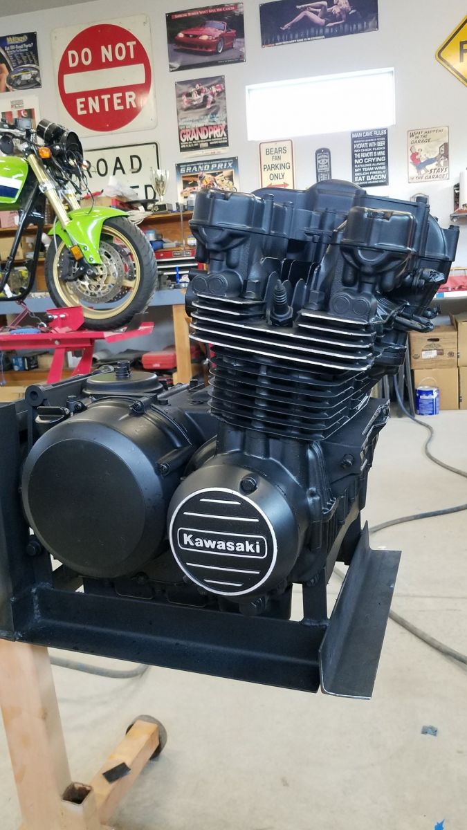

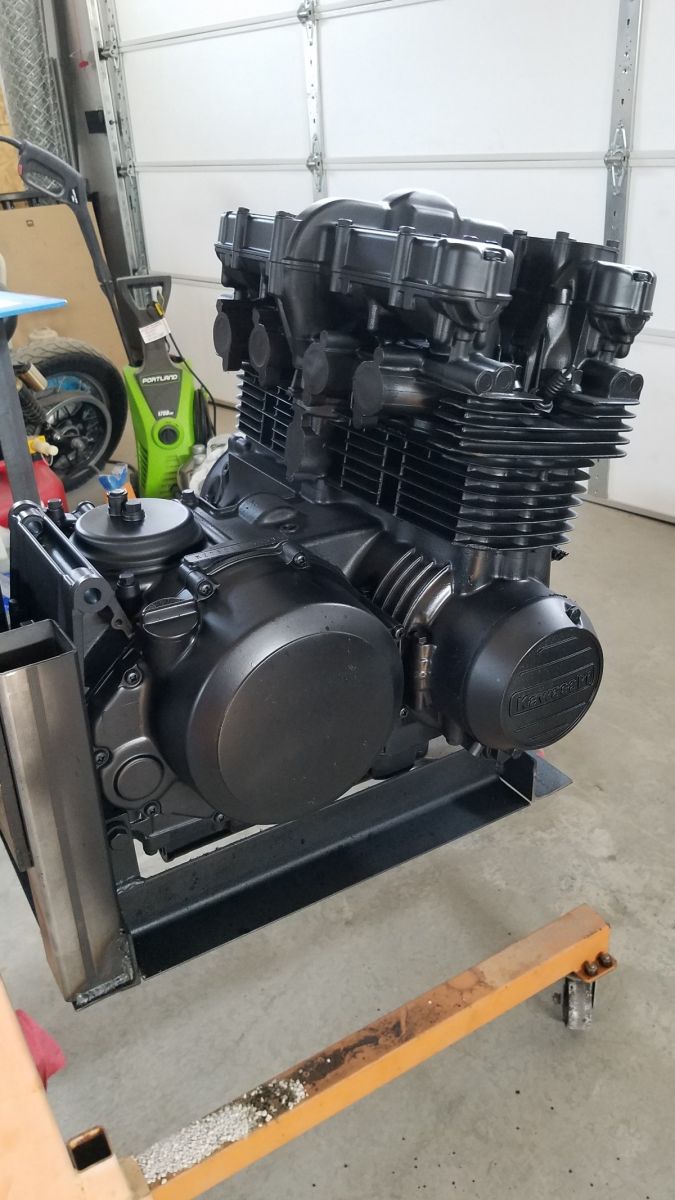

Three coats are on. The temp readings inside my shop are 87 F, 15% humidity. Each coat flashed off really well in these conditions. As far as appearance goes, I am very happy with this paint. Whether or not it does well in operational heat, or just assembly handling, we will see. It won't be touched for at least 48 hours. The holding points of the stand will need touch up, but the top end will come off first. Each part still requires a final cleaning on the inside prior to assembly.

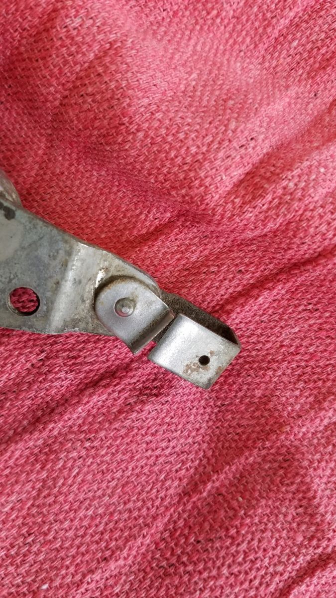

After a thorough cleaning, I found the clutch cable bracket on the actuator is cracked. Looks like a weld repair is in order.

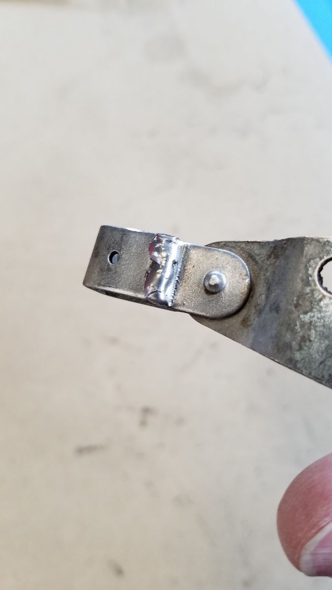

Here is the repaired bracket. I usually don't post close ups of my welding (:dry: :laugh: :laugh: :laugh: ), but this one didn't come out too ugly.

25 Aug 2020 18:55looks good. I think if you polish the cam cover ends its will really sing
