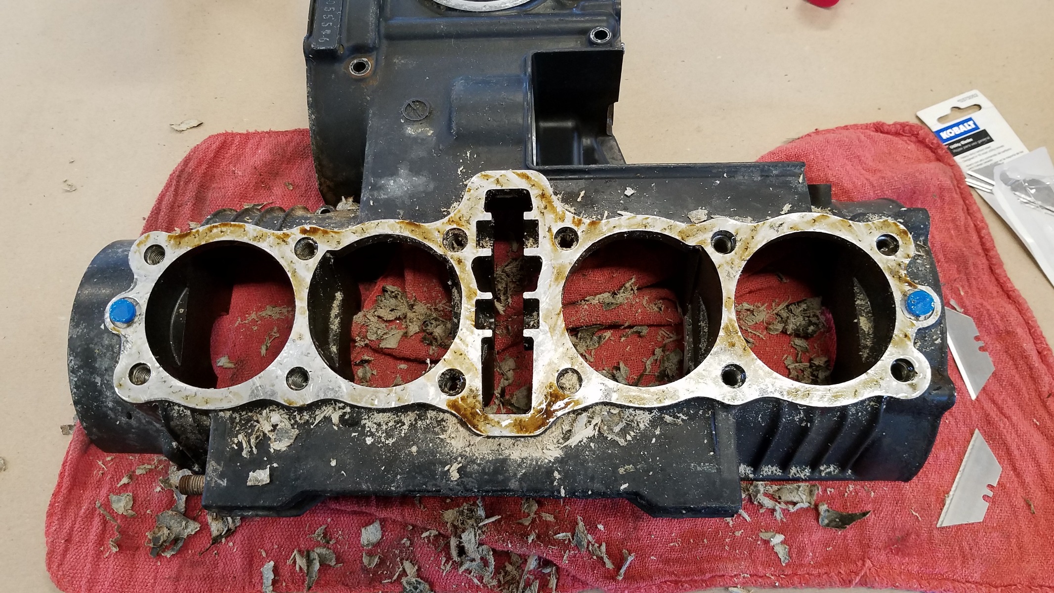

After 48 hours of paint stripper I am convinced there will not be any further changes to the gaskets with the product I am using. I have been testing the adhesion with a hard plastic scrapper, but that isn't going to be as useful as I hoped it would. Today I am cleaning up the chemical mess and going after the gaskets with a single edged razor blade. If that still proves to be too much effort, the paint stripper wheels will be the next step.

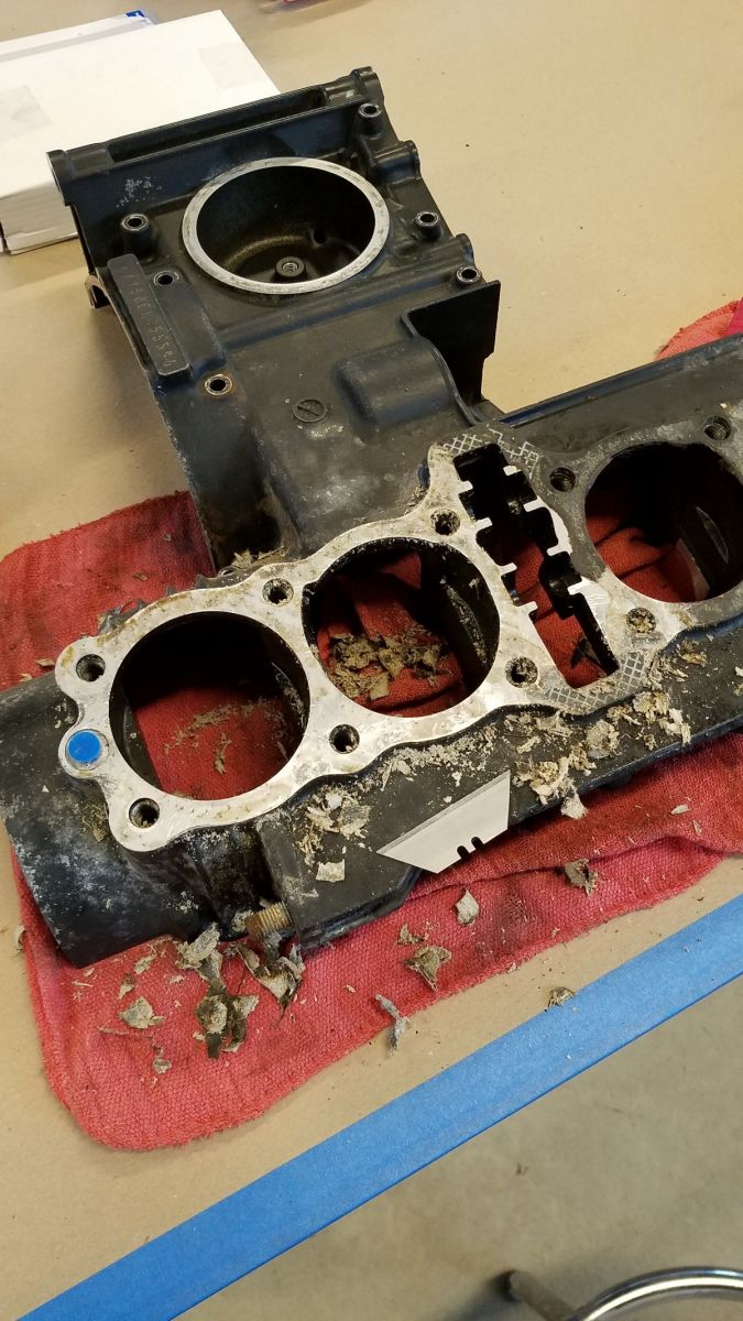

About half way in 30 minutes of razor blade work. I admit it is a little easier after the paint stripper, but not a whole lot. The factory must have used some kind of sealer on the base gasket - the last layer is a pain, and a different color than the gasket material.

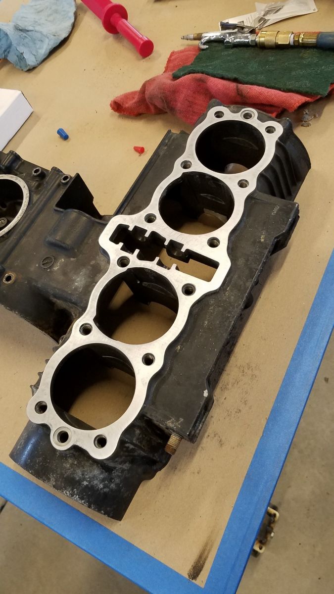

I put another coat of paint stripper on after getting 99% of the base gasket off. Hoping it will get it clean without too much abrasion.

My plan for the engine paint is to glass bead blast the entire exterior surface of the engine and cases. I feel the best approach is to using masking tape for make shift gaskets, use the old engine bolts, and put it back together without the internals. Then blast and paint the motor as one unit. Disassemble, clean, and start the assembly process. This will make the masking easier (less) instead of doing one part at a time.
The oil pan gasket should be easier to remove than the base gasket. Once I have that surface clean, I can start to tape off the sealing surfaces and start bolting it back together. I will use the old spark plugs to plug the head, stuff rags in the intake and exhaust ports, and tape those off as well. The cylinder block and head are already clean and ready for paint, so those won't get a direct blast while in the cabinet. Just the lower cases and covers.
