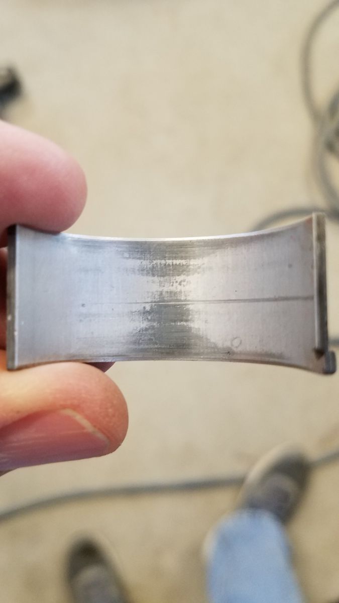

I did find two places in Europe that seem to have the big-end bearings in stock, but it would take quite a while for them to get to you. How bad are the bearings? I only saw the photos of the crank-case bearings - which is probably why I mixed things up. How big is the clearance?

Looks quite worn. Is the clearance past the service limit or is the bearing surface toast (hard to tell from the picture)?

That rod bearing looks pretty bad. How do the others look? You might be able to reuse some of them as long as there isn't too much wear. That's what I did on my 750 anyway. Picked the best bearings from two engines. Not because I'm cheap, rather the bearings only had minimal scuffing and measured fine as well.

The wear make me want to replace them. Monday I am picking up some Plastigage, but it will be for use on the new bearings. It is clear something got into it by the looks of that groove.

Since I am increasing the compression from 9:1 up to 10.5:1, I would like to reassemble with all new bearings on the bottom end. Re-using bearings from a 34k mile motor along with some new ones just doesn't sound good to me.

If you've managed to get 4 bearings it would be a shame to chuck some of the old ones back in - splitting the cases again to replace them would just be a PITA.
