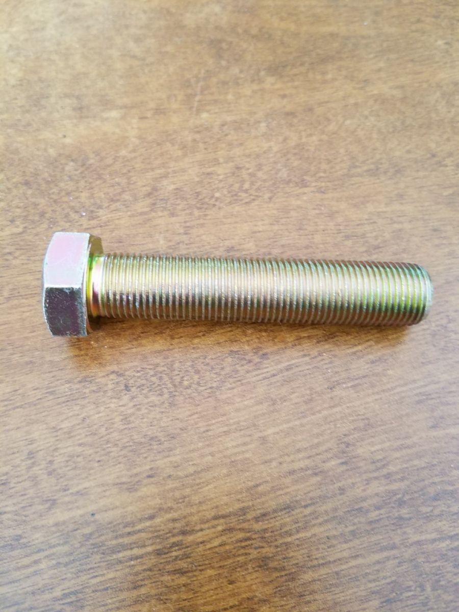

An M16 x 1.50 bolt at 80mm length is perfect for pulling the alternator rotor. No need to hunt down a used Kawasaki special tool.

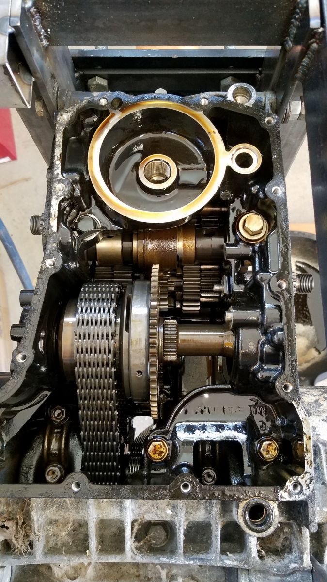

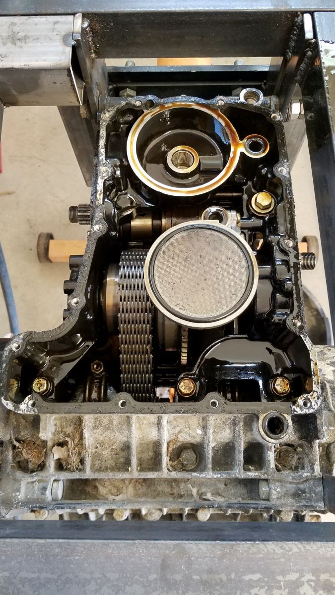

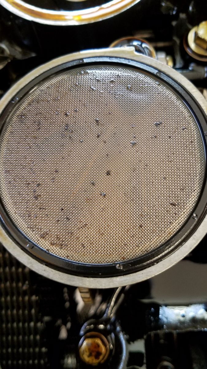

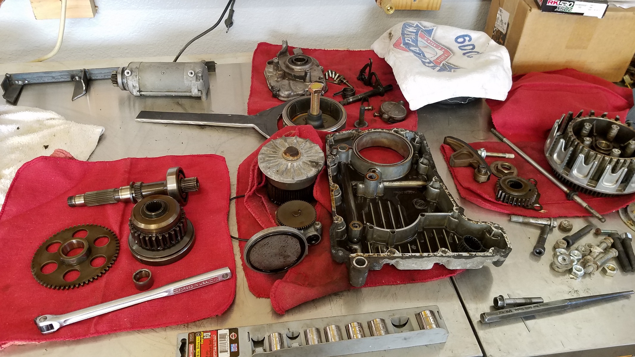

I finally got some time to mess with the bike. The motor is coming apart without issue. Some debris on the oil pump screen, which just further justifies my decision to take the bottom end apart and go through it.

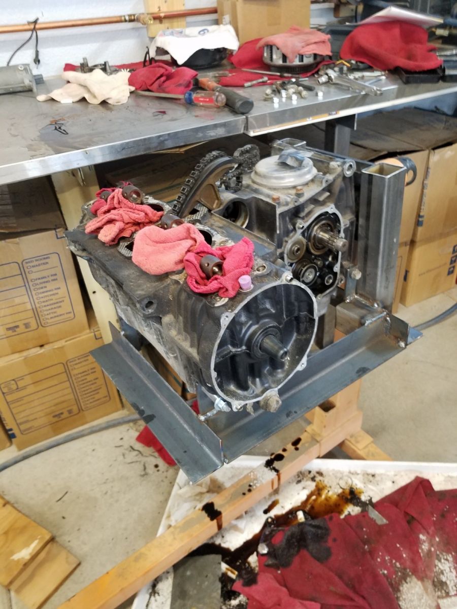

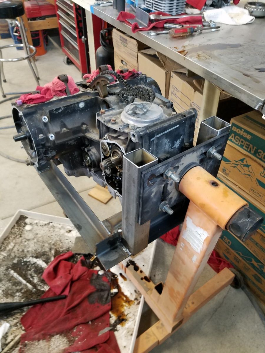

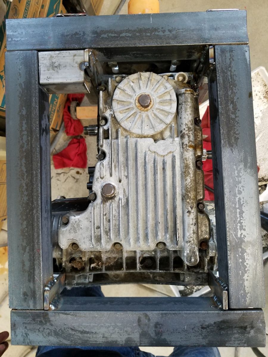

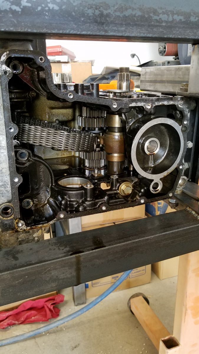

I guess I should have read the disassembly procedure more thoroughly - I am at the point of splitting the cases. It says to use the four pry points and lift off the lower case half. I built my engine stand to bolt to the lower half. Anyone see any issues with lifting the upper half off of the lower half? I need to do this upside down from the manual...
