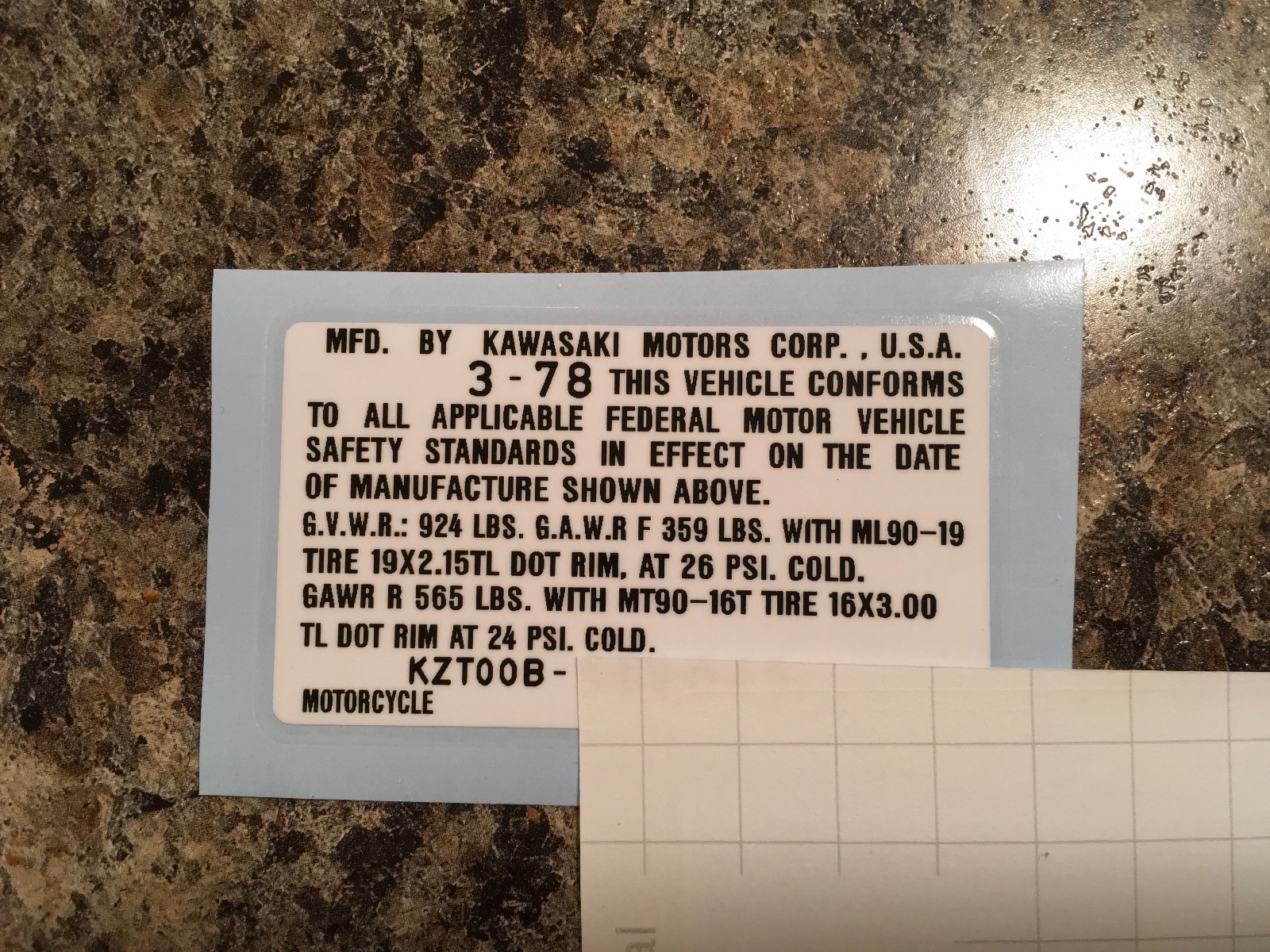

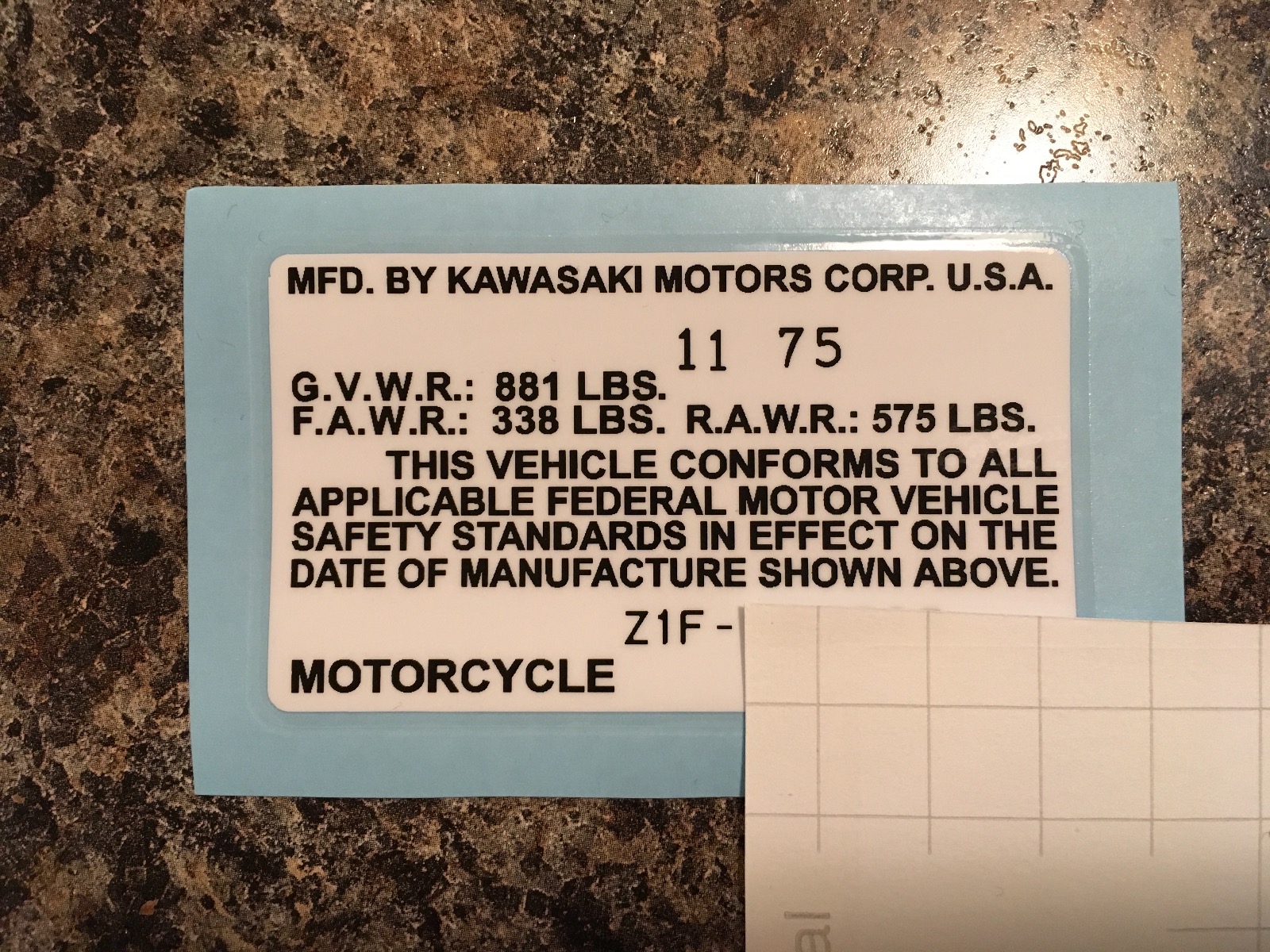

23 Jun 2020 14:22Scirocco wrote: I don´t know if Rick Brett (kawaparts@aol.com) and member Kidkawie are the same person.
For me Kidkawie made the best reproduction steering head VIN sticker!!!
I bet Kidkawie will know!
I’ll share a repop sticker after I get home. That darn responsibility thing called work is being a rock in my shoe right now.

Those look really good. I will put mine on the steering head when I remove the forks for the reseal. And since it's been a couple pages since this thread was green...

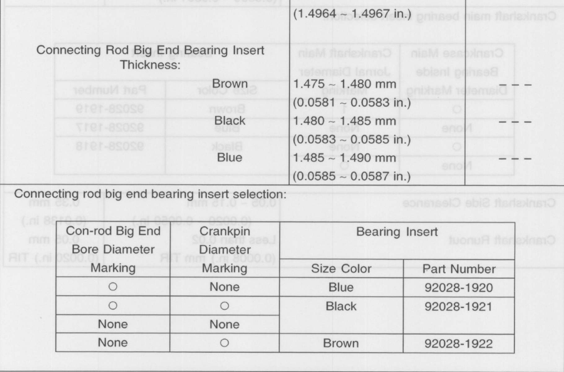

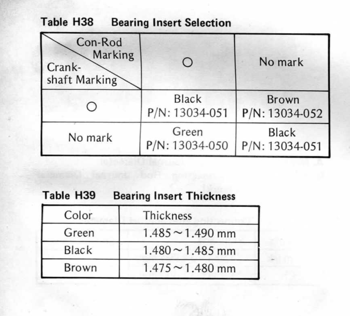

Skidmark,
Sorry, I just saw your private message today, which is probably way too late. But I will post up this info incase someone finds it useful.
I also had issues finding enough black rod bearing shells, so I found that Kawasaki changed the material content for the zr-7 rod bearings and gave them new part numbers and changed one of the color codes. I am currently using zr-7 Black connecting rod bearings (part # 92028-1921) in my kz750e motor and they are a direct replacement.
Keep up the good work, your entire project is AMAZING!
Kz750 connecting rod bearing thickness and color codes
zr-7 connecting rod bearing thickness and color codes

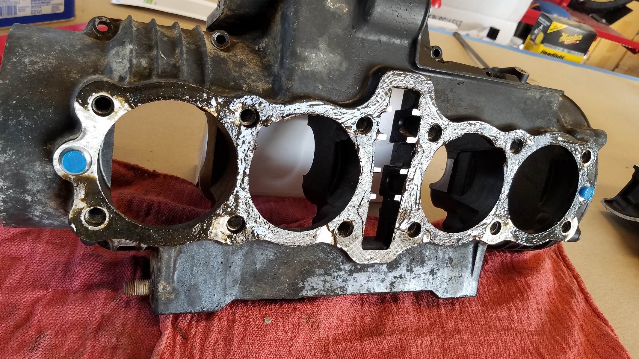

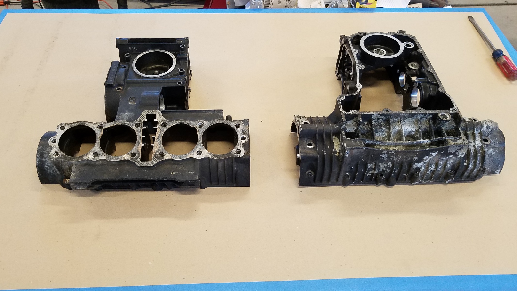

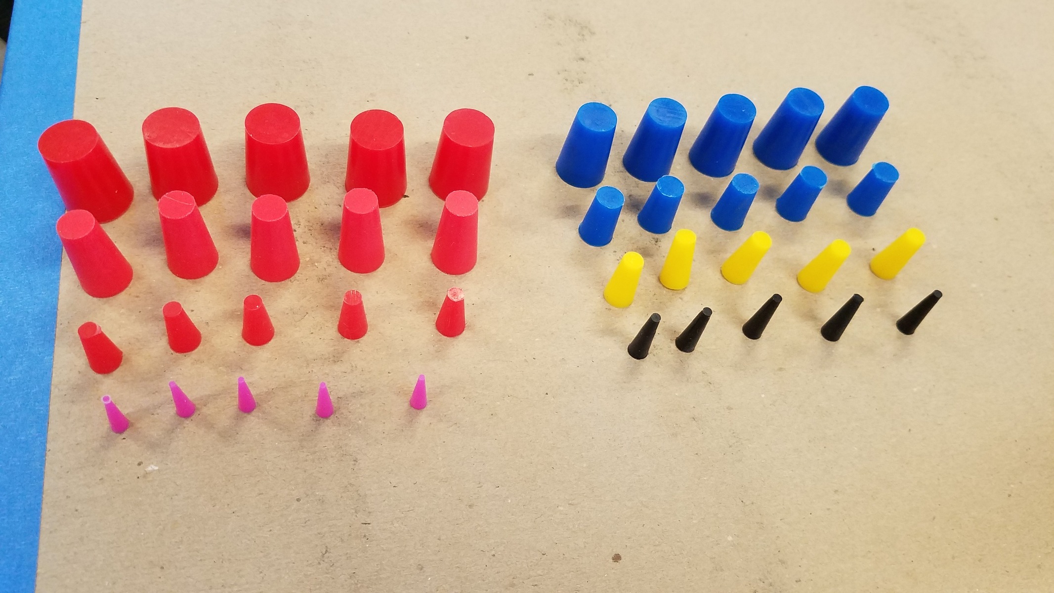

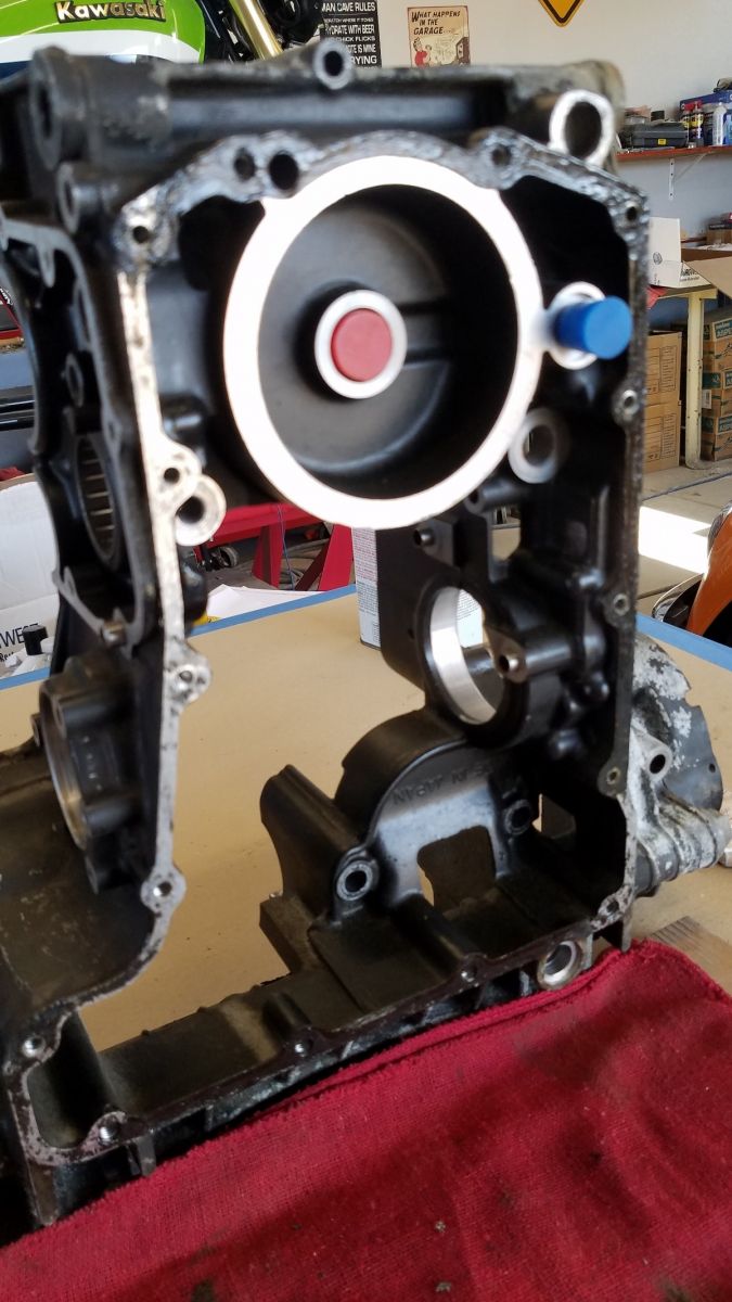

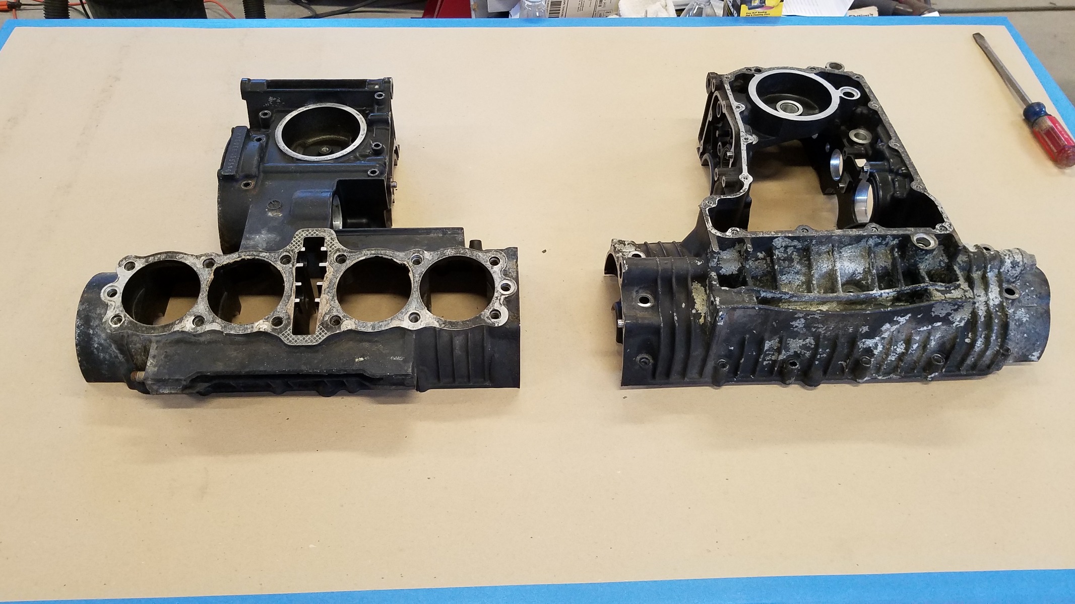

July just came and went... finally the schedule smoothed out back to normal. Finally made some Kawi time! Let's get this paint finish prep started. First step - masking the oil galleries. I got the high temp urethane masking plugs that was recommended on here.
The gaskets are getting paint stripper applied to soften them up. Once the sealing surfaces are clean, I will tape off the surfaces I don't want affected. I plan on using my blast cabinet, so everything needs really good protection.

Those plugs are a good fit... Nice find
