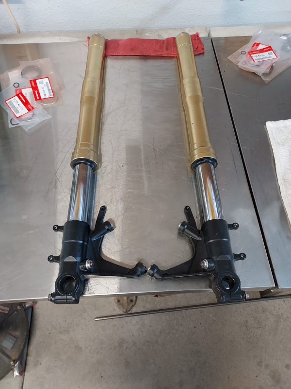

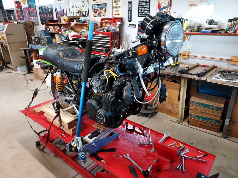

Back on the lift and back apart. While I have the forks off for a rebuild, I will pull the tach and see if the squeal can be fixed without opening the gage up. Before the forks and front wheel are back on I will remove the carbs and verify the float levels are still where I set them. In the picture you can see the run of oil down each caliper mount bracket on the forks.

That floor jack and board look a bit precarious with no front end. I bought a small scissor jack to use with my motorcycle lift. It has movable saddles that rest on the frame rails. I think it works very well. The bike is very stable.
www.amazon.com/gp/product/B076CSCLBY/
Edit: Hmm.. It was only $54 when I bought it. Maybe there is a cheaper option.
