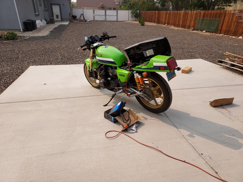

16 Sep 2022 15:16
Finally giving the Green Monster some love. About frickin' time... I removed the steering damper so I can figure out a better mounting method, and utilize the full travel (it was binding right before full turn on one side). I also improved the amount of steering by removing some material on each side of the steering stops. Having guessed at how much steering angle when it was only a frame, I left some extra material for adjustment purposes. Moving the bike around is much easier now. I also rechecked the float levels. So it was time to start it and see how that helped. Yeah, it's been too long since this bike got any attention - so much so the battery needs charging to fire it up.

Re: Saving a '81 KZ750-E
19 Sep 2022 13:09
I am pulling the carb bank off again. #2 cylinder is not running right. It fouled the plug, which makes me think that cylinder is running rich for some reason. Time to recheck the float levels and make sure the needle and seat are clean. They should be as they were installed new during the rebuild, but you never know. The carb sync wrench is arriving tomorrow - I was going to make my own, but found a really good deal online for one so I bought it. Bound and determined to get this motor broken in before winter!
