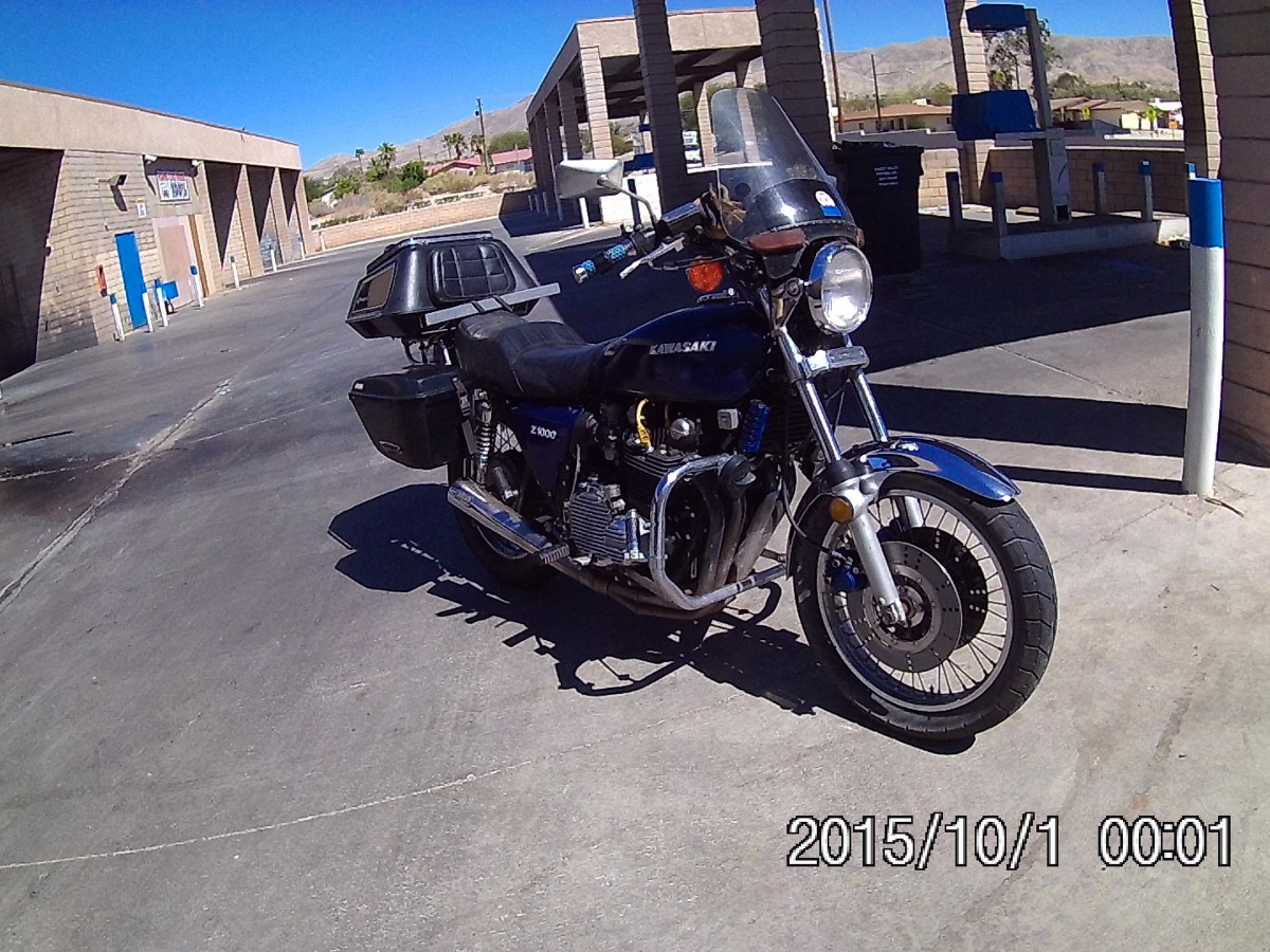

Started with this.
$3500 and counting.
Stopped counting.

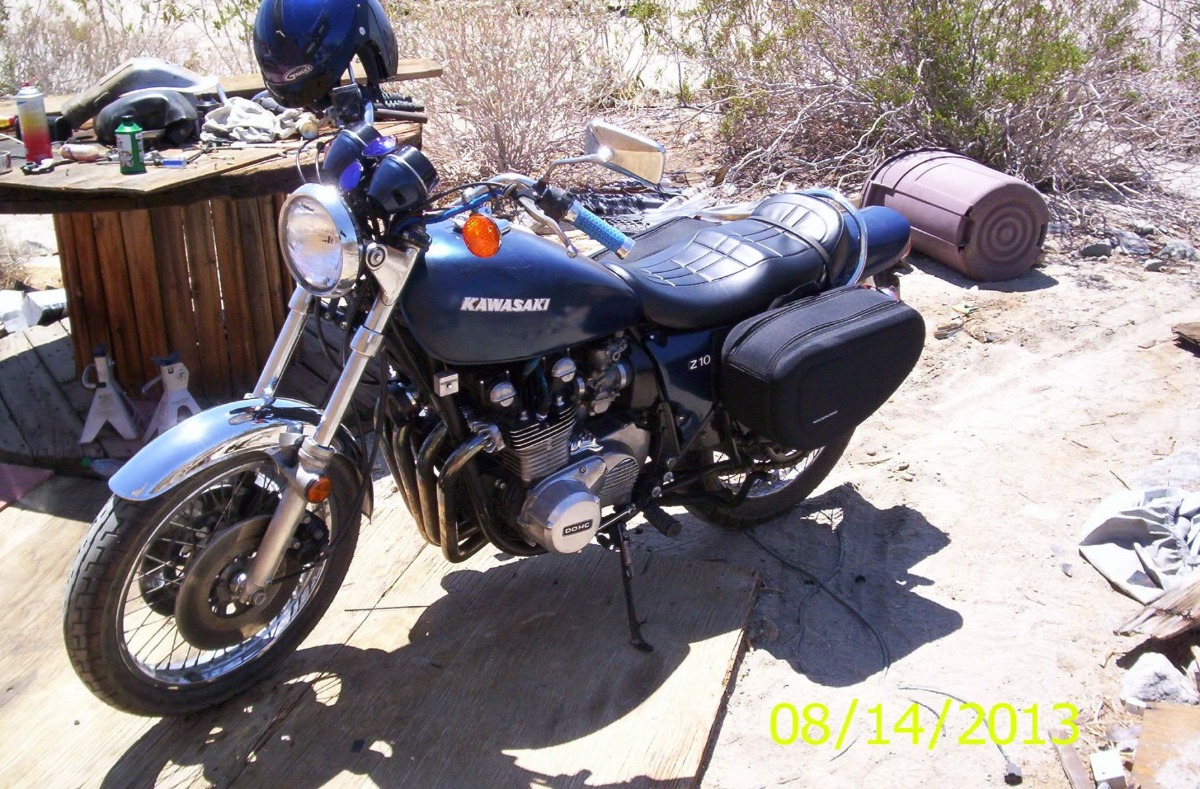

13 May 2018 18:00
#783308
So what do you guys think?

Re: 1977 1000A?
14 May 2018 07:05
#783326
Looks Nice !!!!
