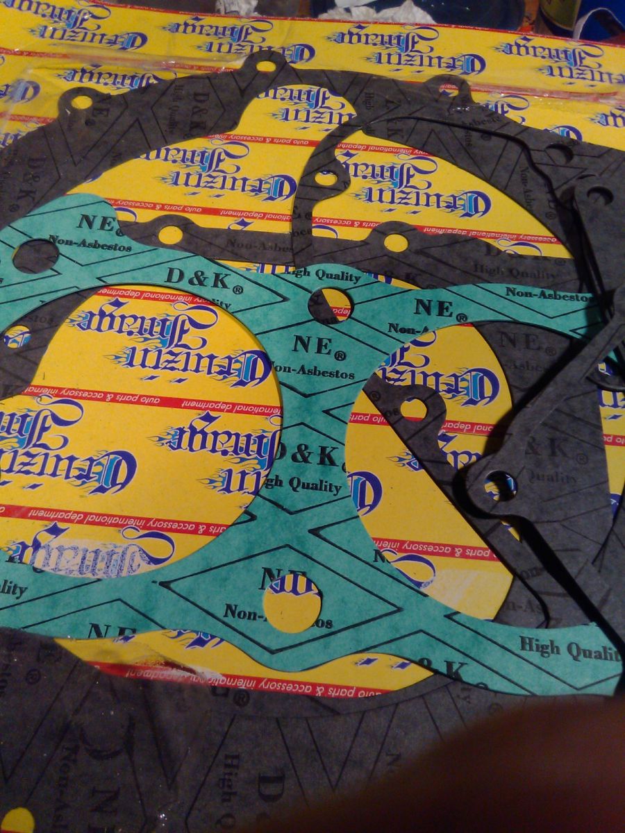

No eBay APP ID and/or Cert ID defined in Kunena configurationI got this set last spring and have only used the upper split cylinder gaskets , the cam chain O ring and the cam cover gasket and they are holding up fine .
Going to get into the lower stuff real soon
Good kit IMO from the mother country for not a lot of money
1 set left
1 set left

Athena gaskets suck. Stay clear of any green gaskets.

Yup. Spending all that money and cheap gaskets? Been using Cometic for years. No complaints.
